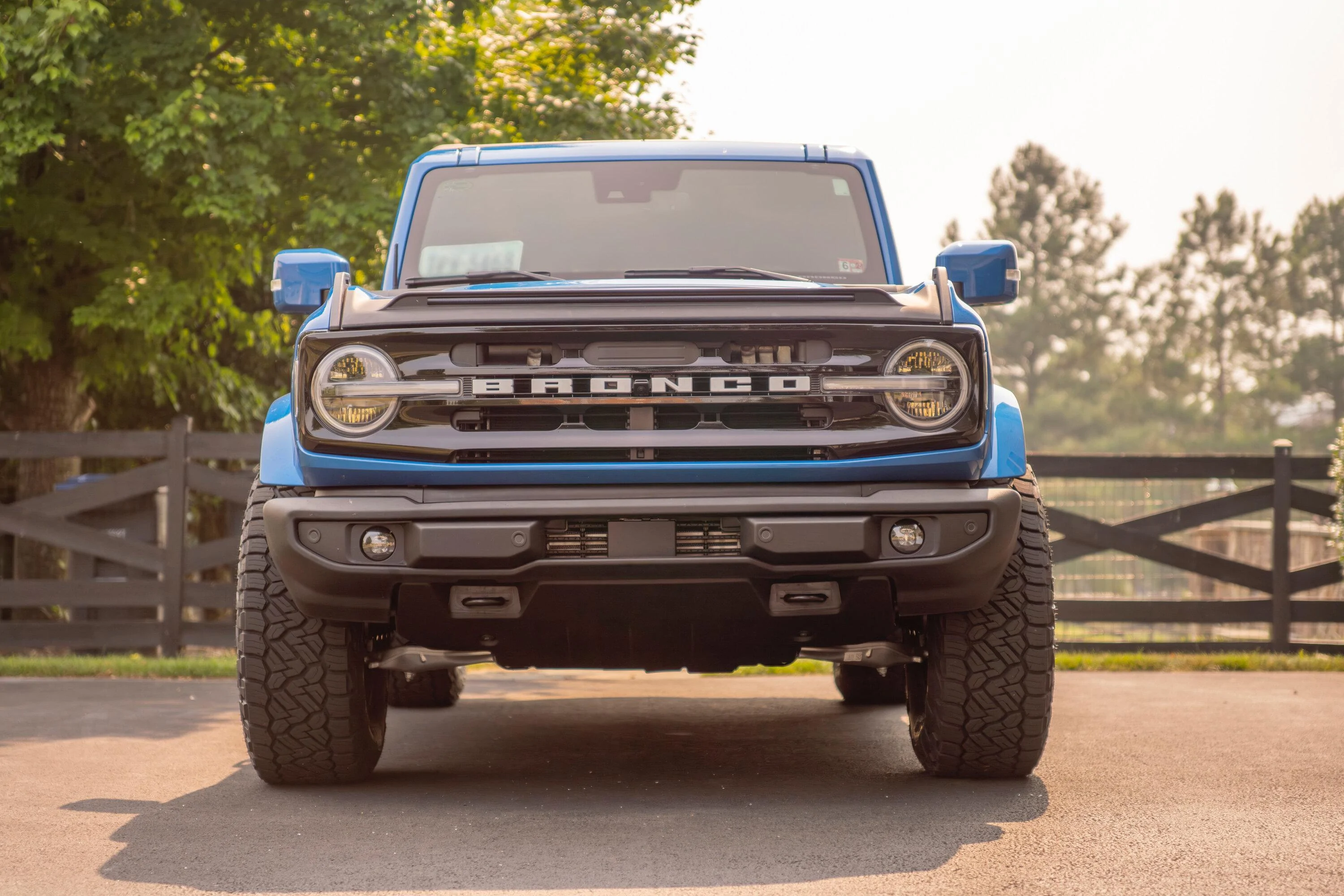

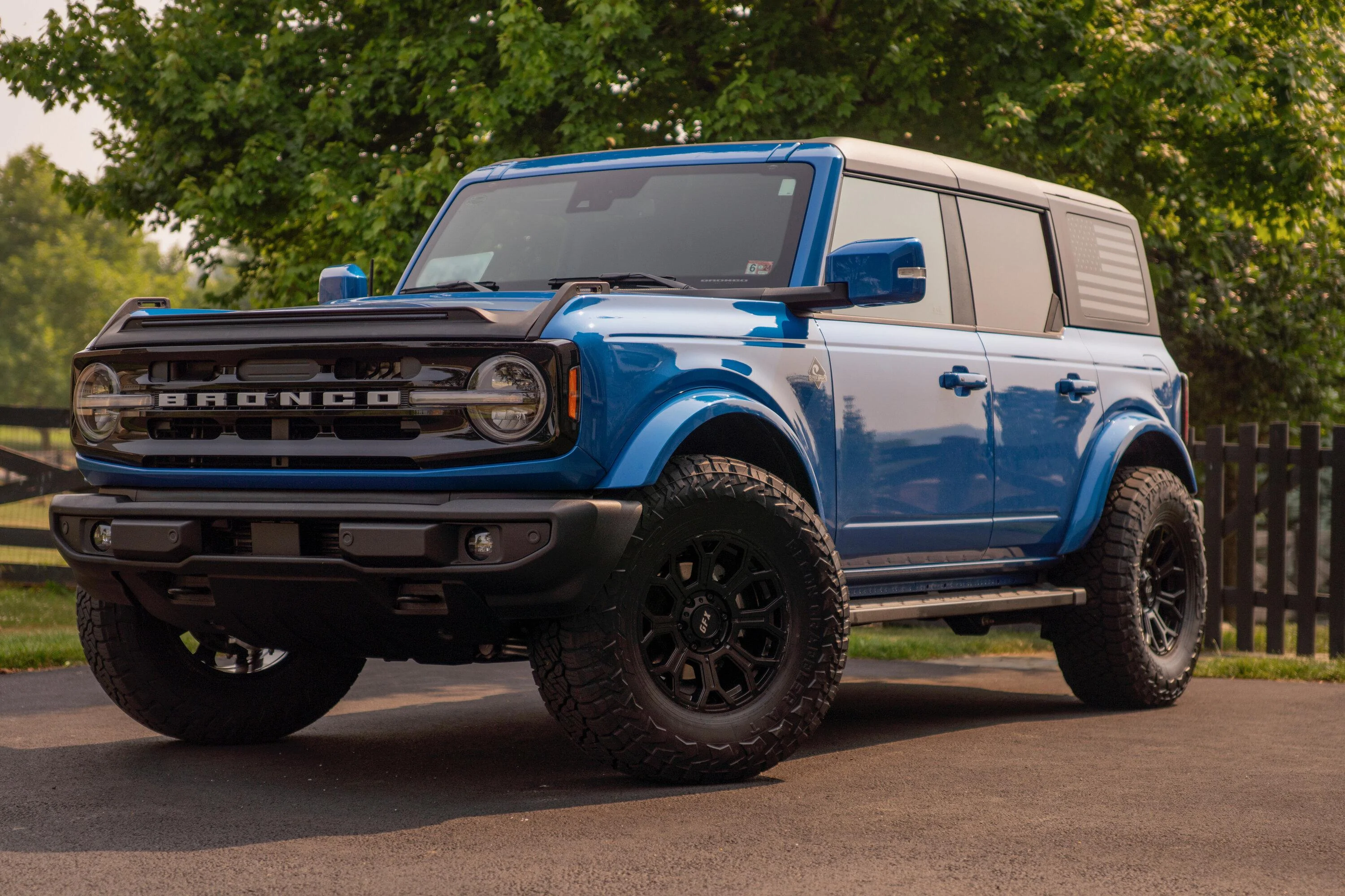

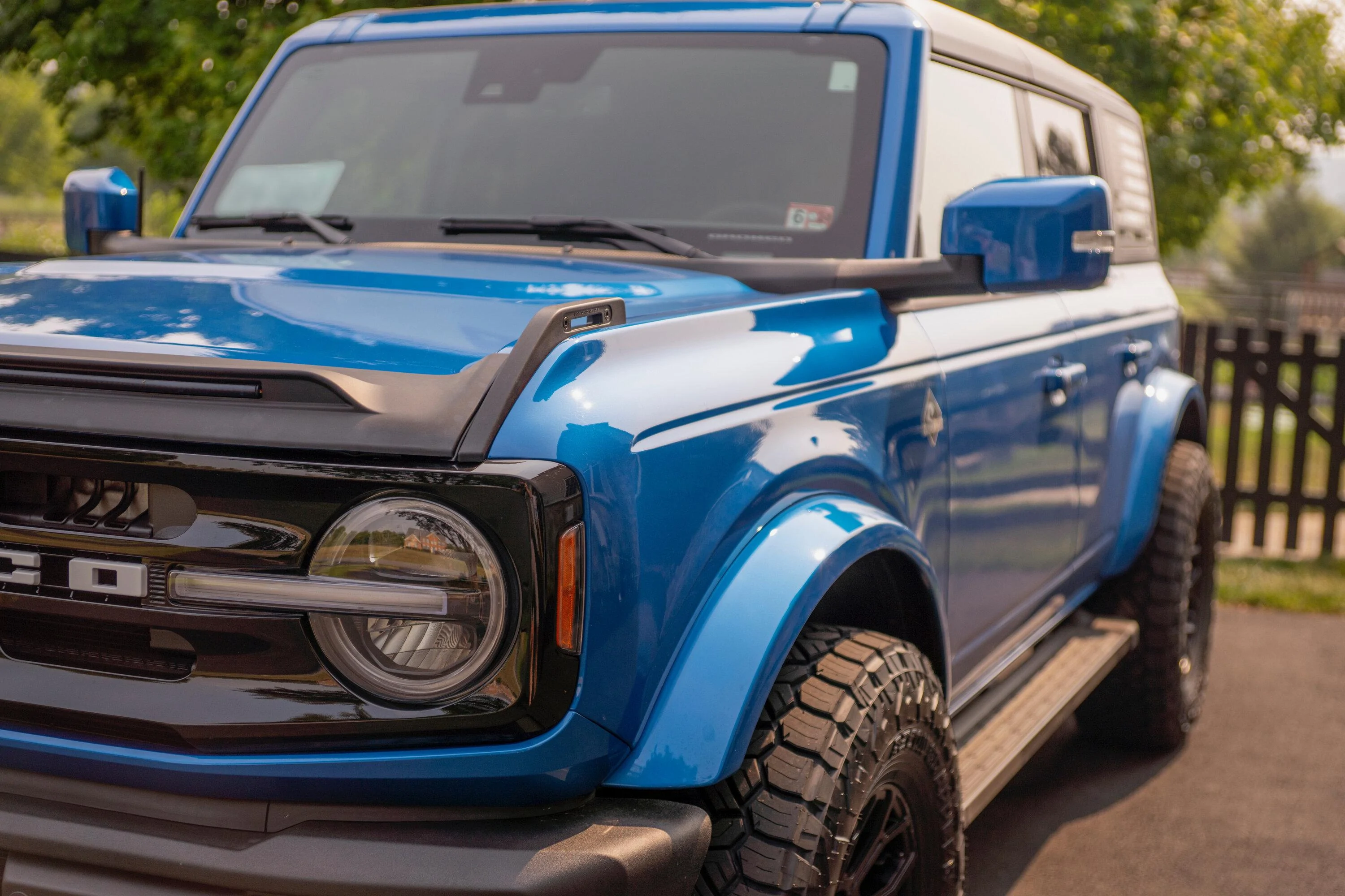

I have 0 offsets and a 12.5” wide tire, mine stick out about 1” from the Big Bend fender
JL8jeff
Jan 3, 2022
57
965
1,484
Ewing, NJ
Do you have a build thread? I am curious about your side steps and fender flares.
If you're asking me, no I don't have a build thread. My truck is a base Sasquatch with the factory hoop steps and brushguard. The wider flares are the stock Sas flares. I just went with different wheels/tires.
