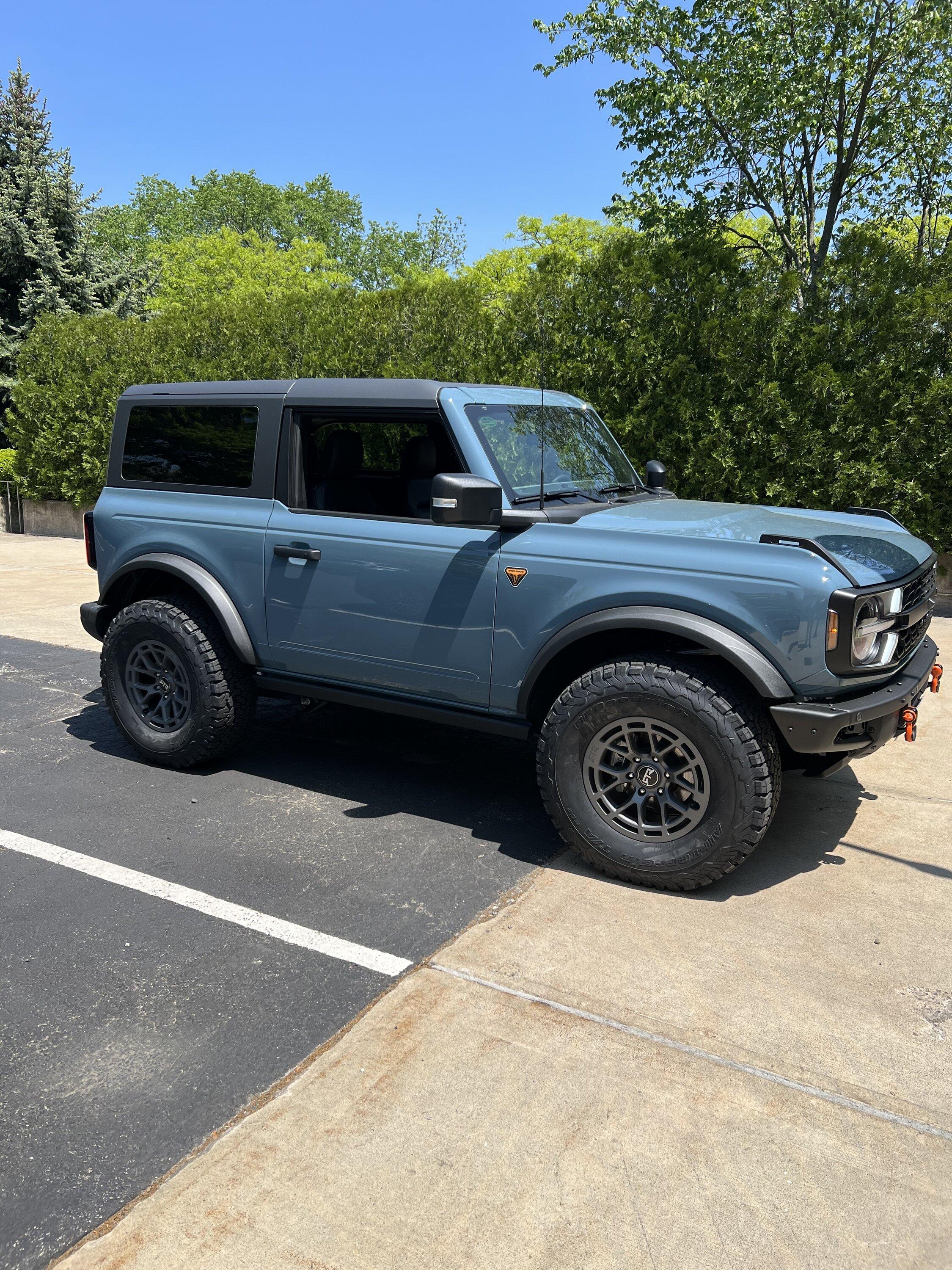

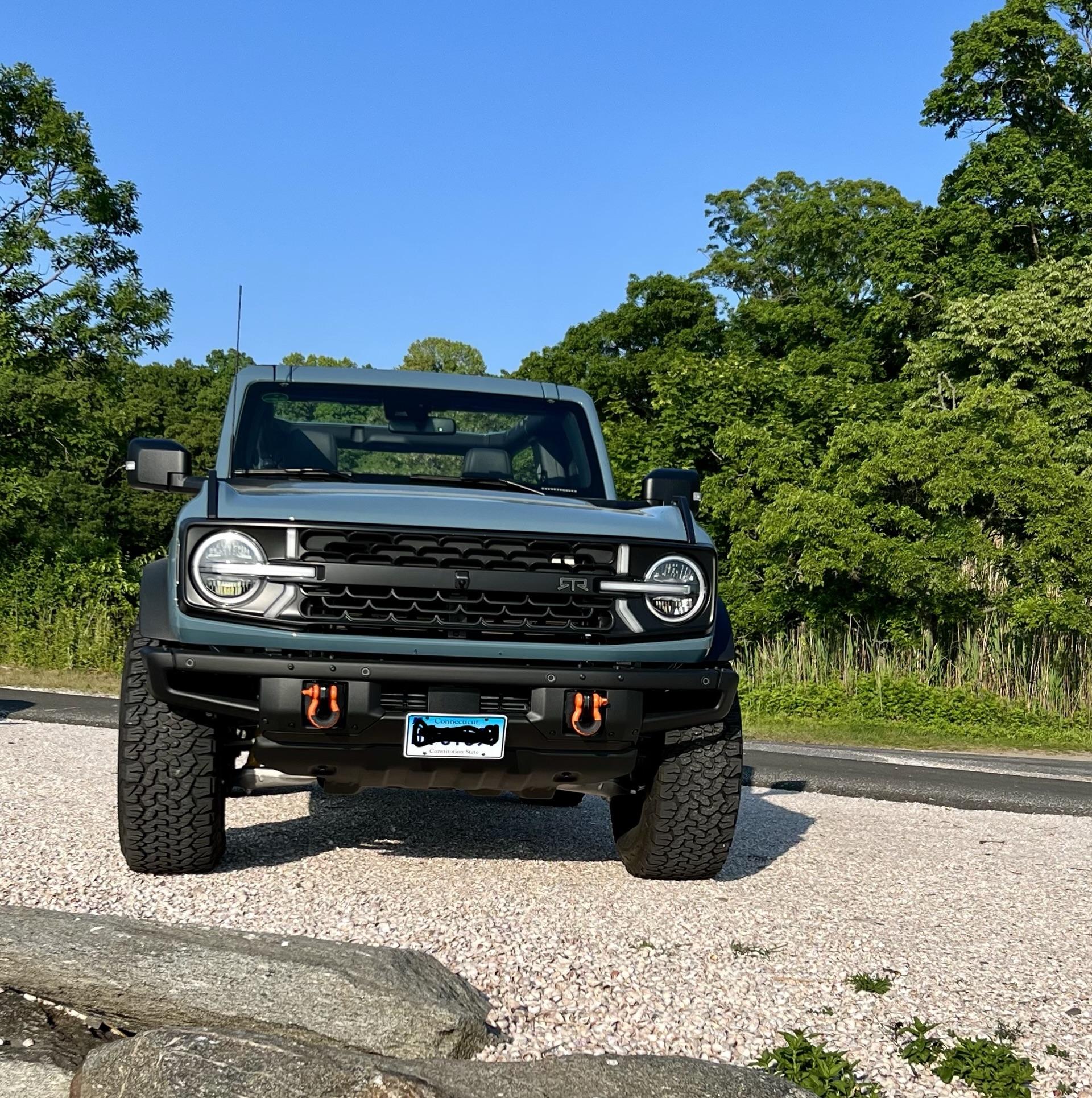

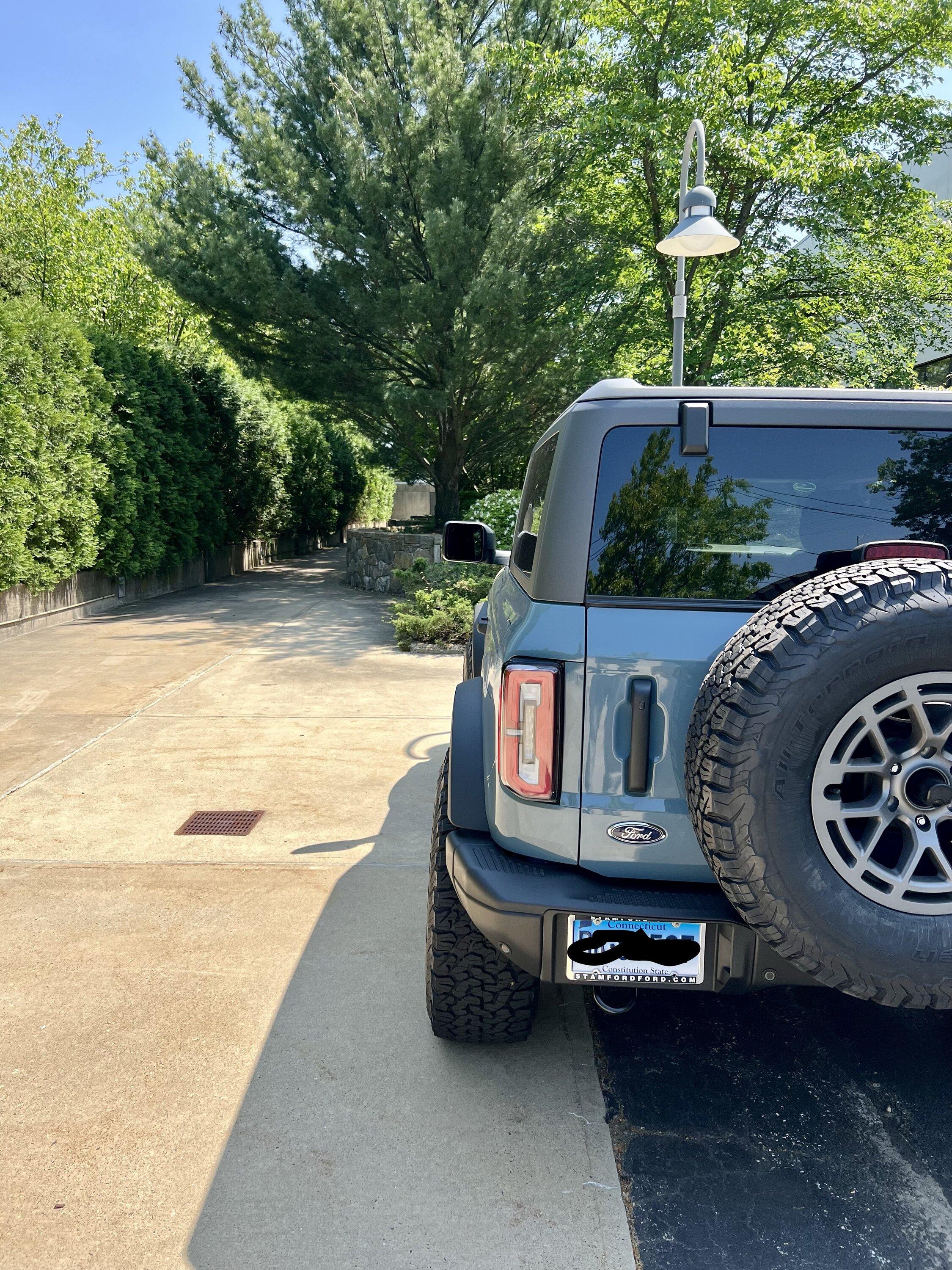

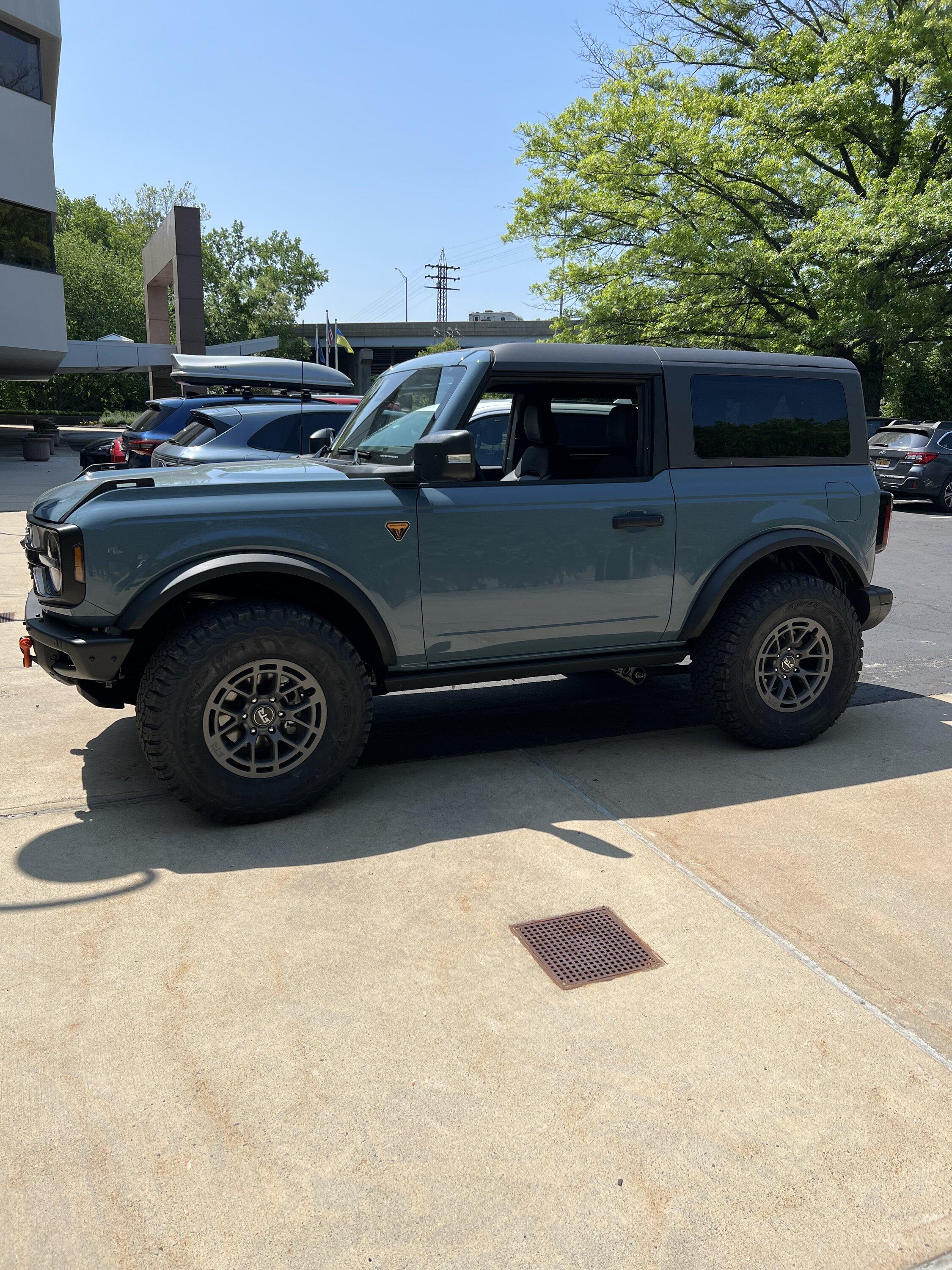

Hopefully these pics help you visually. Re your concerns. Crash bars out and I have no issues. While these are pics from my work parking lot, I spent a lot o time driving on the beach and off-road sand trails this summer with zero issues. I will say with the 2.7 I did not feel any concerns with power but I went with the RTR wheels because they are some of the lightest wheels in their price point along with load C BFG 315x70R17. BFG probably wouldn't be my first choice for Moab or more extreme off-roading but they are a great compromise for the off-roading I do and daily driver needs with snow here in the Northeast. Some people have issues with balancing but I have had none and have run this tire and 4 sets of other BFGs including the 37 on my F 150 Raptors since since 2012. A good road force balance is all that is needed. I was stuck between +30 offset and zero offset. I think with the stock flares, +30 is great-same as the Sas offset. If you go zero offset I think you are in for Sas flares for sure but YMMV. I run tire pressure at 32 PSI. 2 door is lighter so ride gets a bit stiff around town when the pressure is up. I would love to try a set of Falken Wildpeaks at some point or the Nitto but I just decided to go with what I know.
Good luck and have fun with the build!

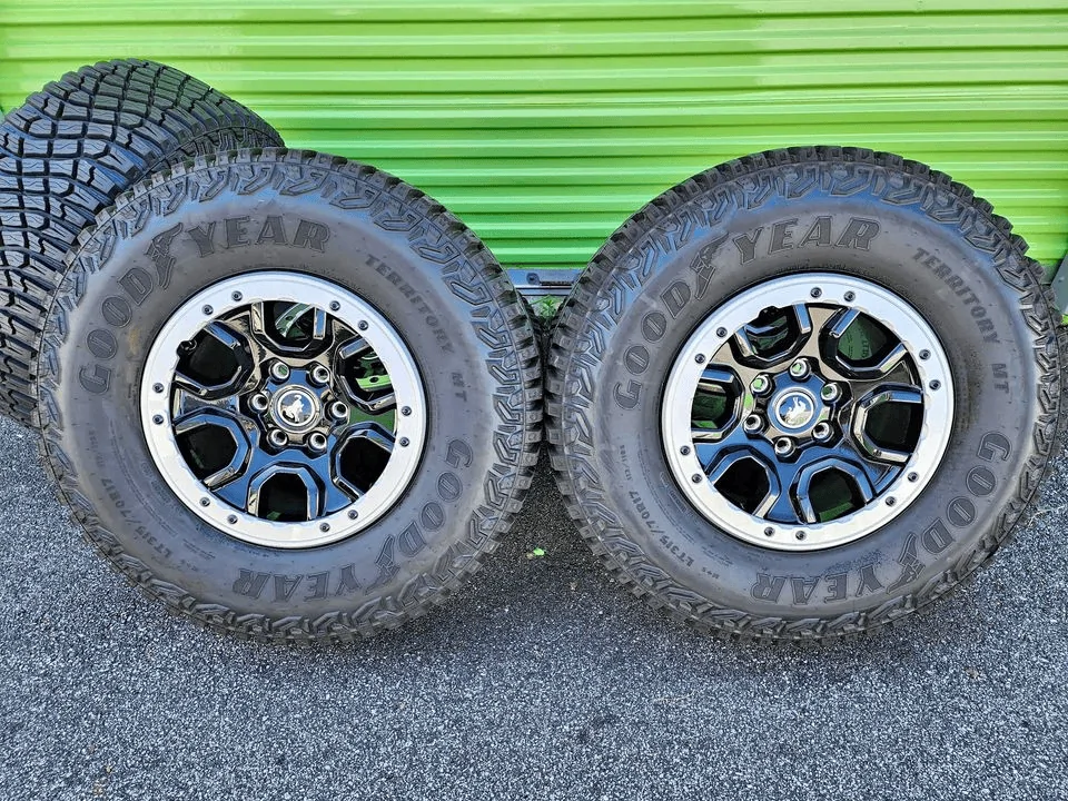

thank you for the responses, everyone. I was looking at the beadlocks that come as one of the options for the Broncos from Ford from factory. I am particularly enamored with these below
Ford Bronco New wheels/tires questions 1695258650863
as they offer the colored trim rings that my wife believes will make it look beautiful to go with everything. I get what I want and she gets to feel pretty riding around, win/win.

Yeah those aren't a bad option, they are the beadlock capable wheels. The rings on those are not the beadlock rings. Plenty for sale around the country as well for a great price.

So same +30 offset as mine on the pics above but 1/2 narrower. Only downside about the stock wheels is the weight.
