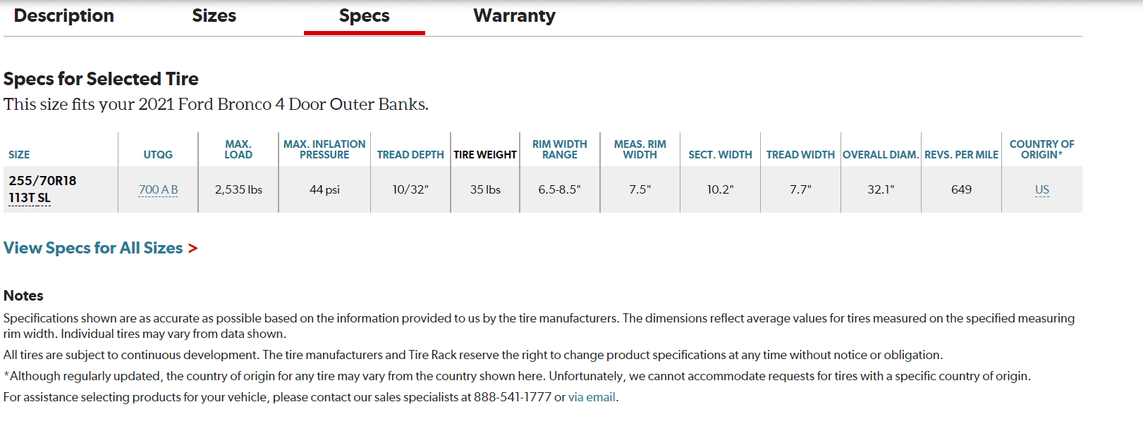

According to tirerack, the Firestone LE3 and the on/off road Bridgestone Dueler have identical tire diameter at 32.1" but tread width on the Firestone is .7" wider and weighs 5 pounds less. Identical load ratings but partially due to more street like pattern and 1/8" LESS tread depth the Firestone should last longer.
My additional thought other than wheel width (and why did OP not just buy rims since the oem tires are worth almost $500 more than what he bought, at retail) is that due to less agressive tread and visual appearance from side he only thinks vehicle sits lower. But he opted for what I think are "comfort" tires instead of mud/snow
I went to tirerack, before I ordered everything, to do some homework and pick out a tire that I thought would go well with the wheels I wanted. Tirerack had these rated the best in almost all categories and I figured everything else would be the same measurement/fitment wise. Lesson learned that's for sure.

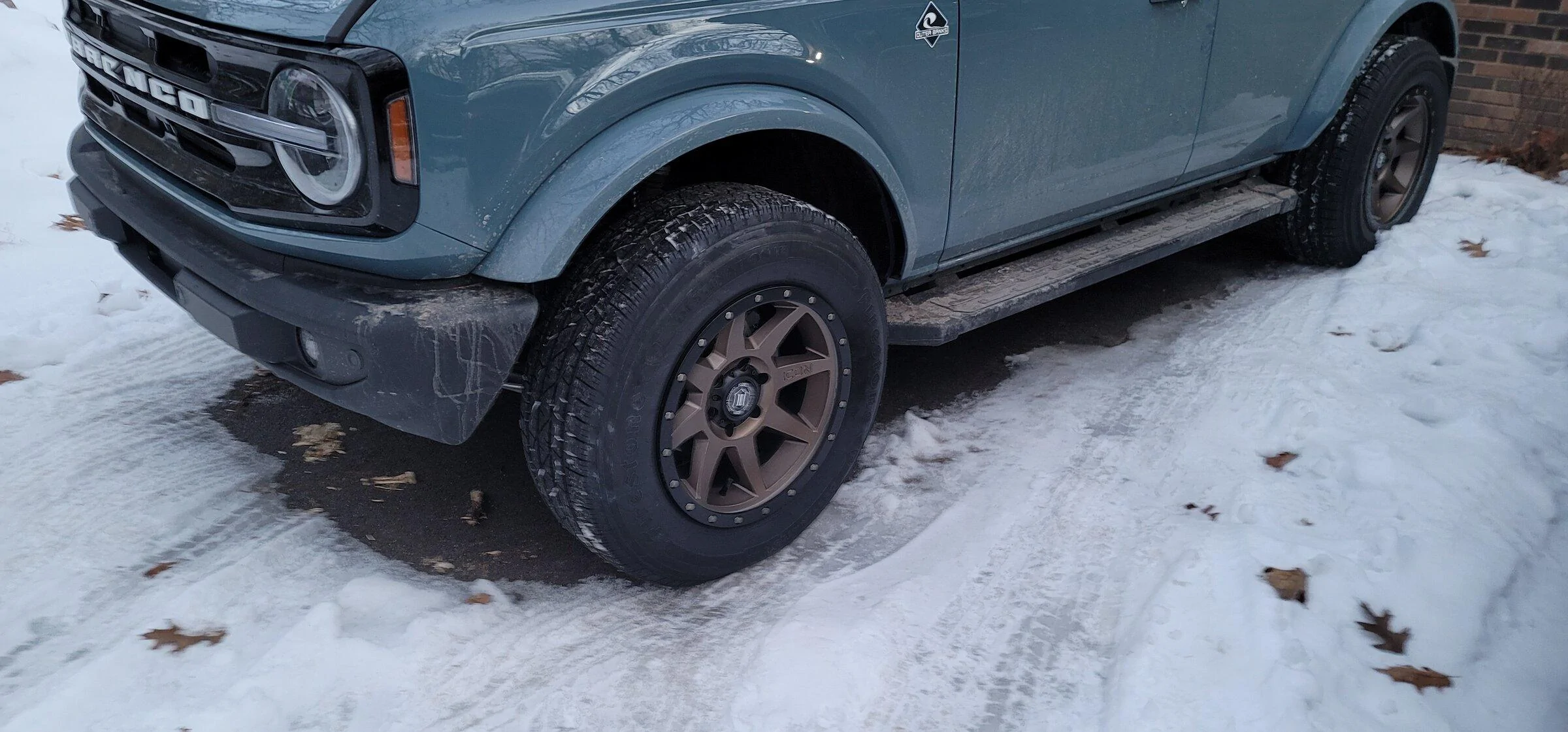

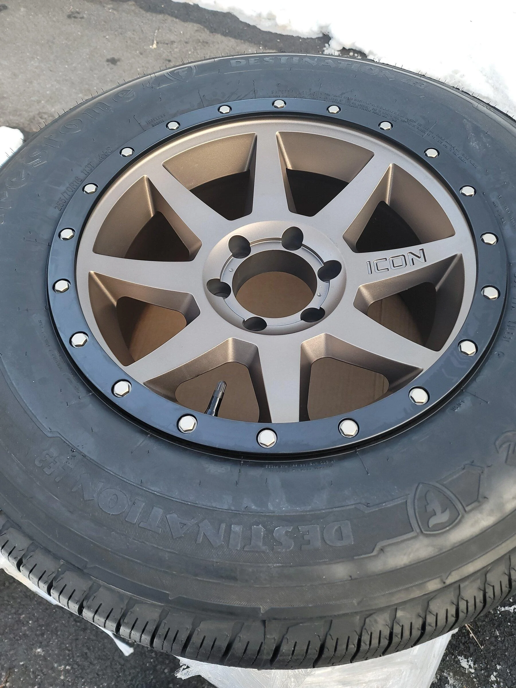

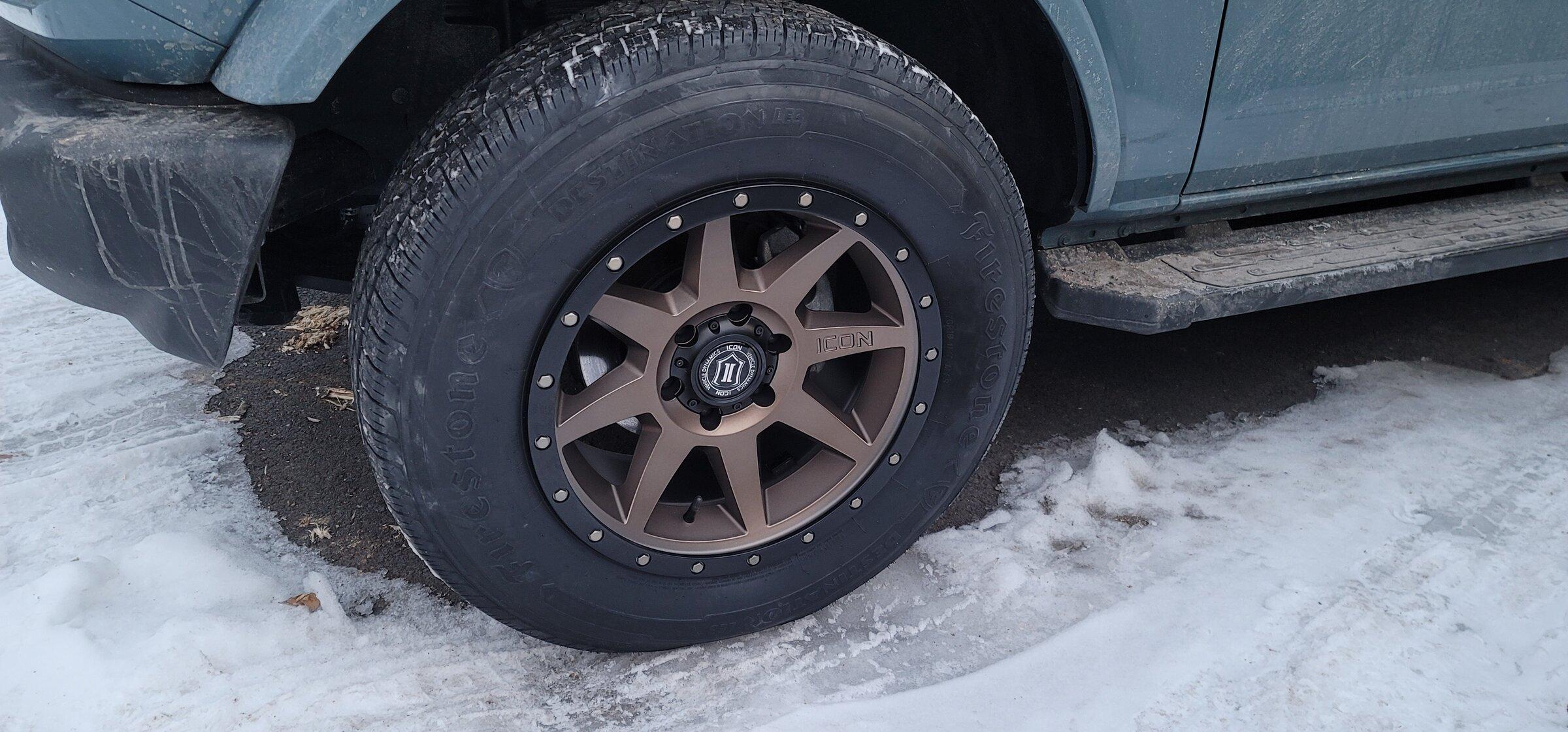

We really need a picture of these new wheels/tires.
BravoV4
BravoV4
Jay
Aug 4, 2020
251
898
Pennsylvania
2014 Honda Accord and a 2018 Ford F-150
Ford Bronco New Tires and Wheels, slight issue. 20220121_071831
@kodiakisland hopefully this helps. If you need different photos let me know.
