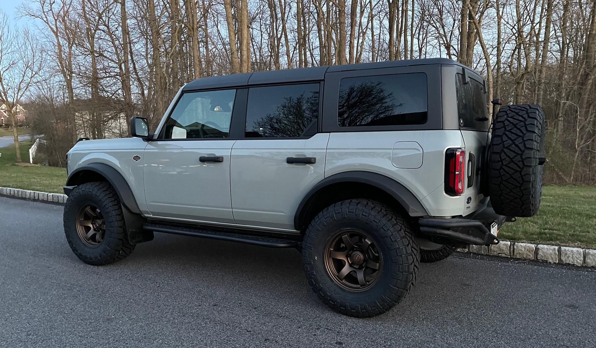

So, it's been a few weeks with my new wheel and tire setup - Grams Light 57DR-X (17x8.5 et 0) and Nitto Ridge Grappler tires (35x12.5) and so far I've had zero issues with vibration or any weird feeling (the tires are definitely quieter than the stock GY).
My buddy owns a BMW/Exotic repair business and he's the only one that touches any of my vehicles (I race with him in endurance series).
He mounted the tires and when he went to balance them, he said he didn't have a part that would allow him to fit such a large tire (to be fair, I'm the first person that's come to him to mount off-road tires - he's usually doing ultra high-performance tires or racing slicks).
He said give them a try and see how they are. So, it's been a few weeks with zero wheel weights on them and I have no issues at all. I've had it on the highway running up to around 75mph for an extended period and still nothing.
Thoughts on this? Could there be an imbalance that I'm not feeling that could effect the wheel bearings?
No, I've never had a vibration issue on any of my vehicles before and I know some people have had major issues.
