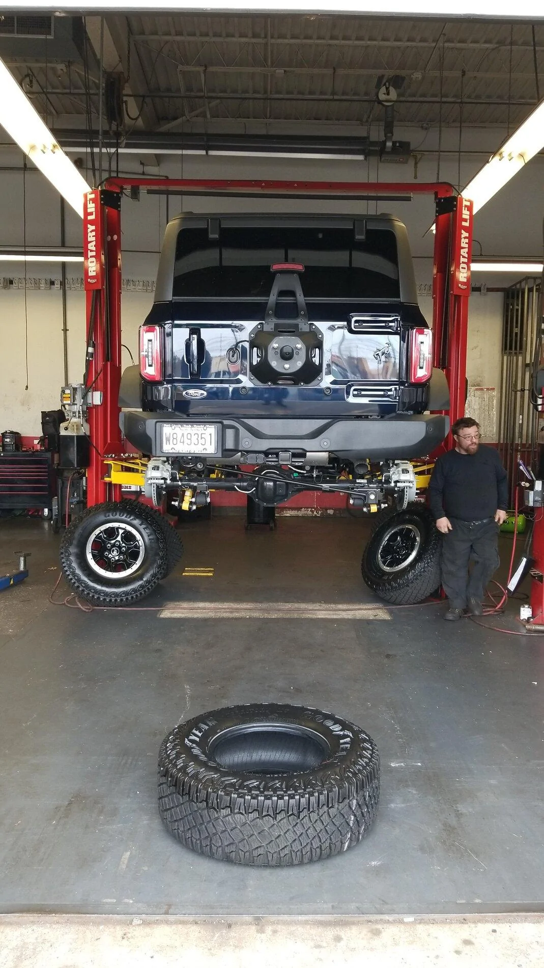

My 37" came in!!! Pulled the bead lock an headed to installer. Mounted the spare wheel with 37" but he was unable to stick the dynamic weights to the rim, would not stick! Clean with brake cleaner, no change.
Any thoughts or recommendations? Reaching out to Ford Monday.

There are no such things as Dynamic Weights. There is Dynamic and Static Balancing.
There are two general types of wheel weights. Tape Weights, which tape to the inside of the wheel barrel. And Clip On weights that clip to the edge of the wheel. Generally, tape weights are used with aluminum wheels and clip-on with steel.
I assume you are talking about tape weights since you said they wouldn't stick. It is possible that the tape weights are bad. It happens from time to time. The adhesive on the weights is pressure-sensitive. You must press hard on the weight across the entire surface to activate the adhesive. It won't stick like a vinyl sticker. They need pressure.
