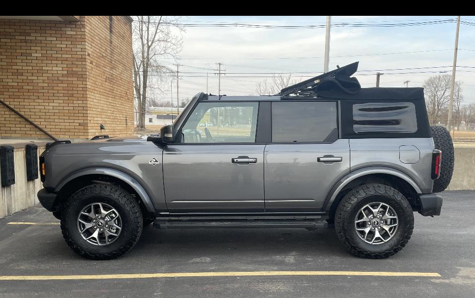

Here is 285/70/17 on stock suspension. It maybe less expensive to grab a set of takeoff badlands wheels if you like them. That’s what I did $1200 for the set of five with sensors.
Ford Bronco New Wheel Sizes 8D92E2B5-2B43-497D-B82D-0FDE5B8506EC

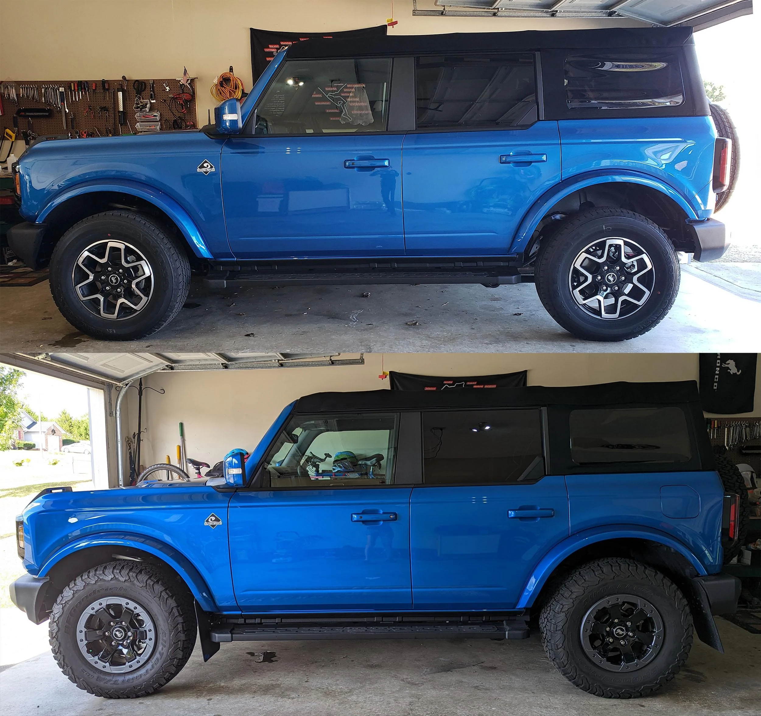

I went with badlands takeoffs: 285/70/17 on my Outer banks for the same reasons mentioned above. It's a good happy medium for improved appearance without giving up too much in consideration of the gear ratio, performance & fuel economy. You can totally throw on 35's but you are going to feel some performance loss. The 33s don't really feel any different & my gas mileage only lost about 1-1.5 MPG on average (combined).. but it looks worlds better.
Here is a before/after to show the improvement even 33s have.
Ford Bronco New Wheel Sizes BeforeAfterWheelssmall
