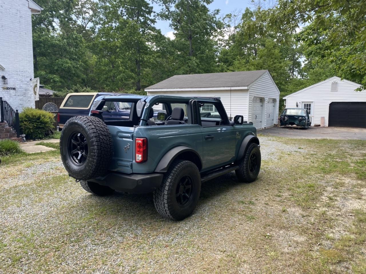

If you’re keeping the stock wheels you are limited on what will fit without a lift / level. Or ‘22 BB has 315/70/17s on 17x8.5 0 offset wheels. No lift or level. Remove crash bars. No rubbing. Fit and ride great
