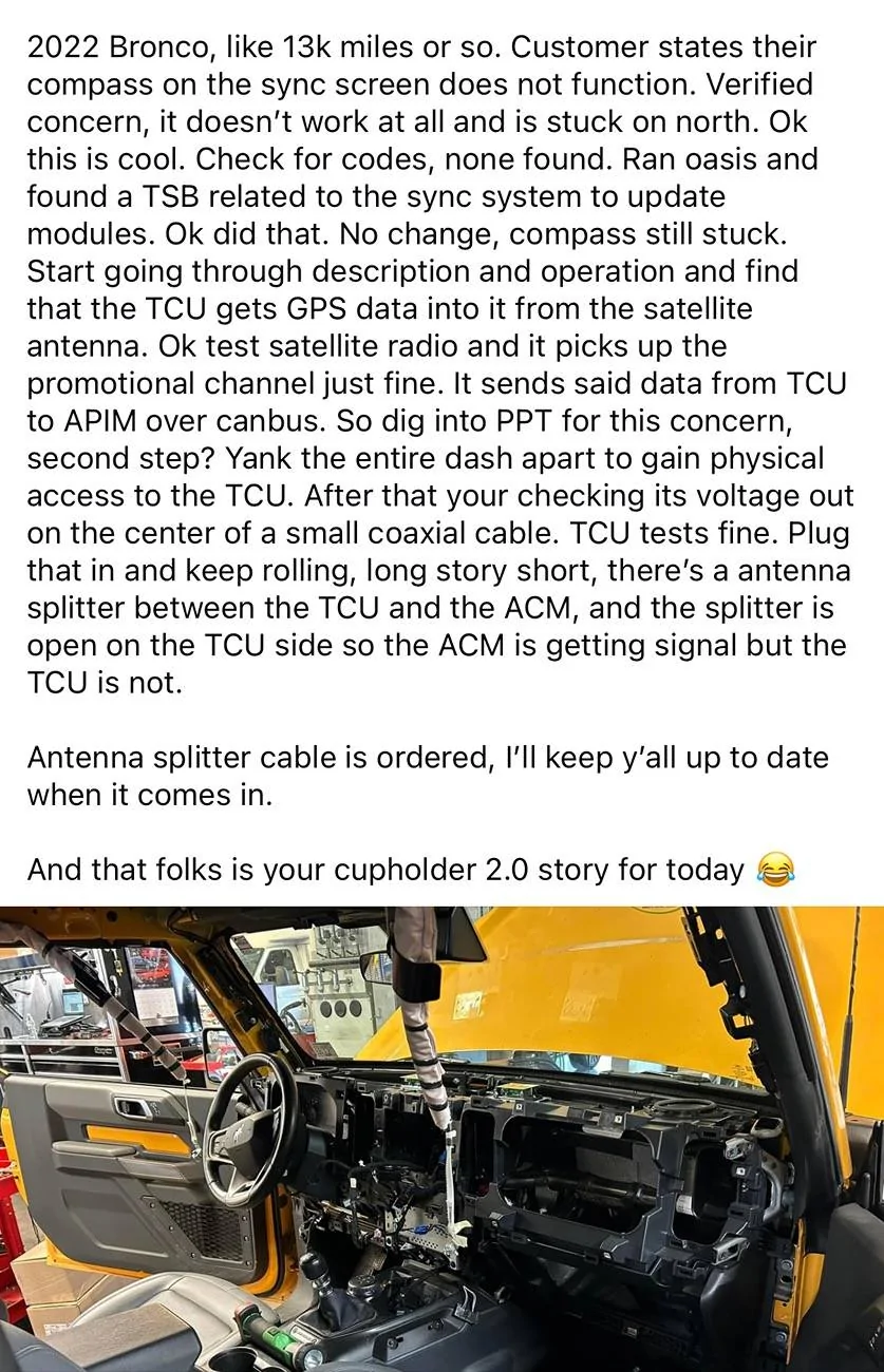

Weird. I got the new update and now I have the boulders back, they have been gone for 6-8 months.
Compass still points North no matter what though. (and no it's not the sending unit, it reads correctly on the dash display)
And it turned Hill Start Assist back on. Seriously, do I have to turn that stupid thing back off every single time it updates? At least it didn't set my clock to Greenwitch time this time.
My friend posted about this, he’s a ford tech and had to fix one. Involved tearing out the entire interior to replace a pinched wire or gps sensor thing. If you want I’ll dig through and find it but I would just leave it cause it’ll never be the same after that mess

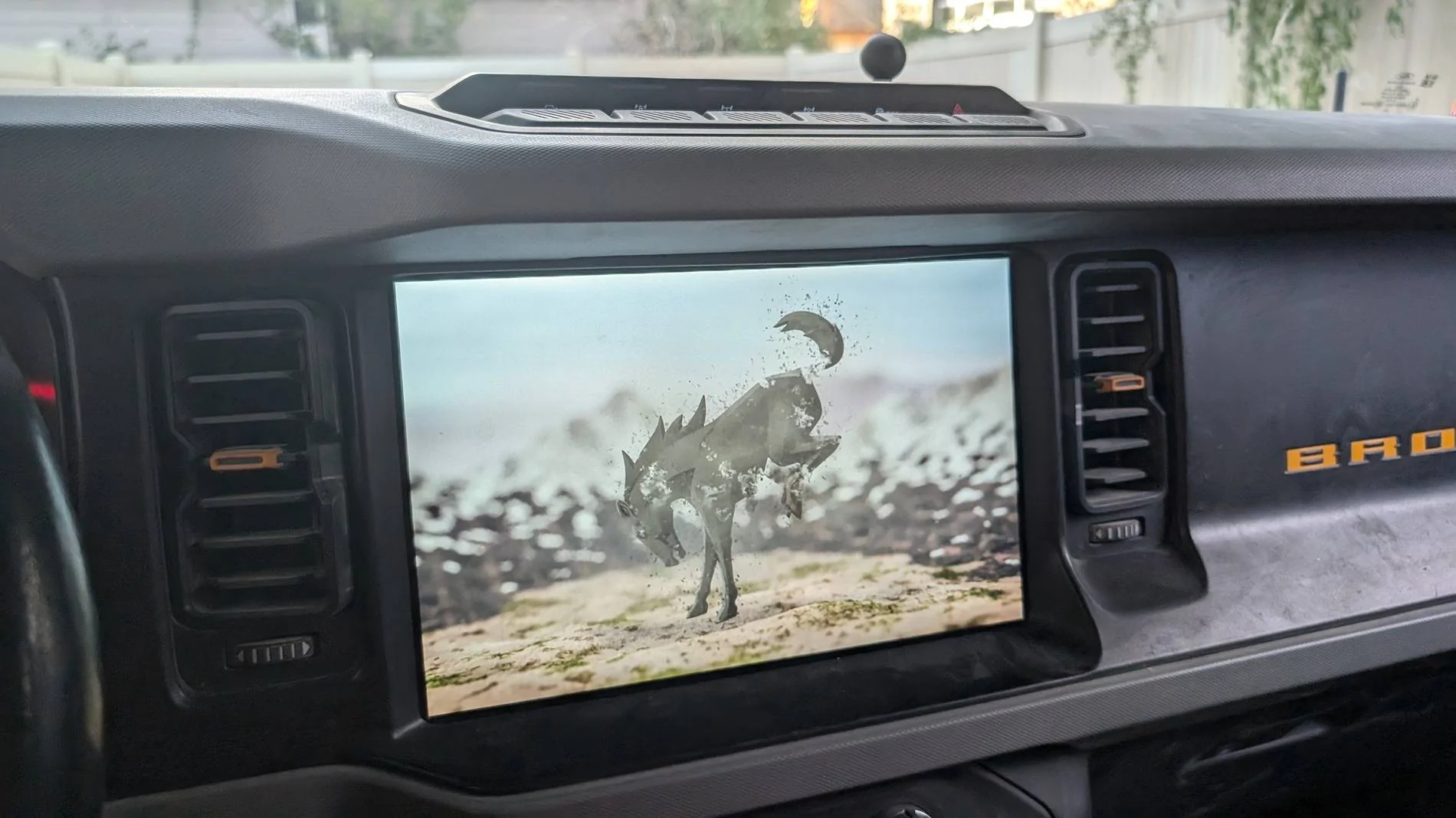

I still get the animation, just depends on the starting scenario. I just got in without starting it right away, and it did this while I was getting buckled
Ford Bronco New Start Up Animation PXL_20241022_234405328.MP

I think the timing of the animation was changed. It starts playing as soon as I open the driver's door. But before it didn't play until I was sitting in the driver's seat.

Hey Everyone, A recent software update has changed the start up sequence on the center screen that used to show the Bronco horse and the boulders. This new one is of a Bronco silhouette on a blue background. Anyone know how I can get the old animation back? It was way better than this new one in my opinion.
I get to enjoy both!
