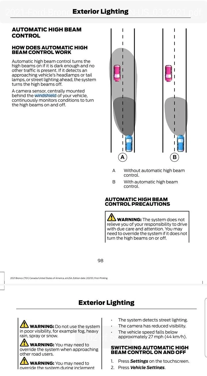

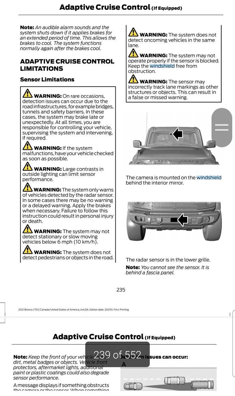

Hahaha...Lighten up. How about a serious Bronco Owner who purchases or downloads an "owners manual" for the $65K vehicle they just purchased, so that they can do the work themselves and not rely on the charity of others. A simple word search of, "windshield" and "mounted" produced these pages in the manual. Your welcome.
