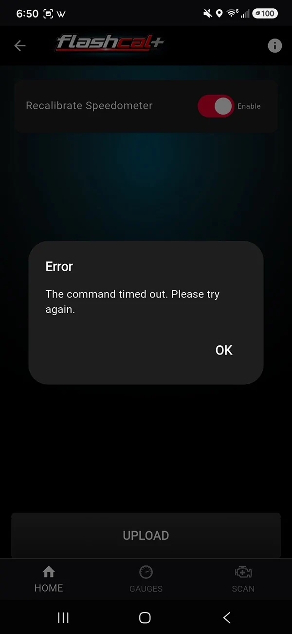

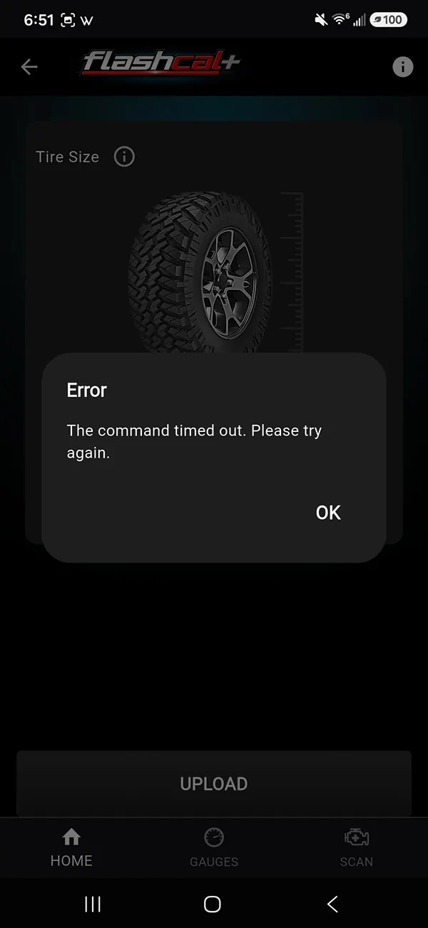

Probably something you already tried, but did you attempt to read the codes and clear them? and if so did they just come back right away? 🧐
and also when you were bringing up the error about adding maintenance to the Ford app, I was able to click on both modern fords and the screen came up to add something, but earlier I remembered it just saying no.. I have nothing to add but both of mine are bringing the screen up to add. Is yours at least doing that, or does it just give you an error when you tap the button to add?

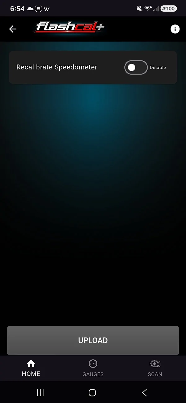

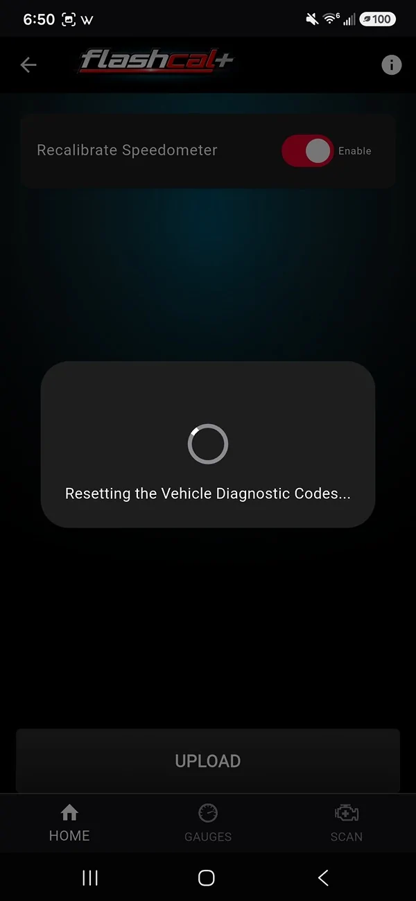

I cleared the codes via the Flash+ each time once it cleared up the "wrench" on the reload of tire info or Tire Wizard. It happened several times over a couple days trying to get the speedo to match GPS precisely. Wizard said the vehicle was at a speed slower than what was displayed and Google didn't agree either. 3 different speeds that didn't match the dash.
When I try to access my vehicle service records via the App, entered the tire change, then it no longer saves my entries. Then I noticed the several drive train error fault records in the service history. It was watching and recording the glitches.....hence my concern what the dealership may say soon at my 30K inspection. :oops: 😬

Ones that did receive directions did you have to manually enable speedometer recalibrate? Mine gets pissed off when i try and do any changes. It works but i get the damn wrench still. Im still in the debacle of issues with my device that even holley guys cant pin point it.
Sounds like you got some logs over to the team last night or this morning, so they're looking into what happened and will sort it out.
Thanks for being patient.

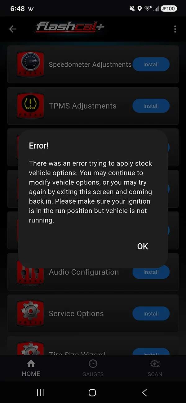

I updated the dongle and it worked. Took about 8 minutes to load up 43 files.
now have Sport mode!
wish the directions were more clear about this.
The update wont be necessary for any newer units built since we launched, its a byproduct of some devices that have been on the shelf or in distribution most likely. Moving forward, it should be a quick and easy affair anytime you want to make changes.

Alright! i finally received mine! I tried updating it which took longer than expected. so long that the bronco timed out and shut off and the app said there was an issue. I tried it all again and came up with an error. But it must have somehow worked because i was able to make changes. I shut off the chimes, added global up windows, WHICH WORKED!! Killed auto stop and the double honk. and added rock crawl. it worked pretty good. the only thing i noticed is that it reset my view in the das menus so i had to go in a reconfigure that and the tpms sensors weren't recognizing the tire PSI. a short drive and it all showed up. not a big deal.
