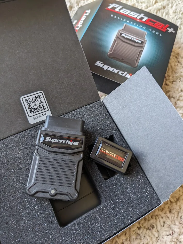

Ford Bronco NEW Flashcal+ Bronco Support! PXL_20260725_001447134.MP
The smaller device I think is only used for Jeeps.
The larger one I plugged in to my OBD2 port used the App to make some changes and unplugged it. I also ran a software update on the programer, that did take some time.
