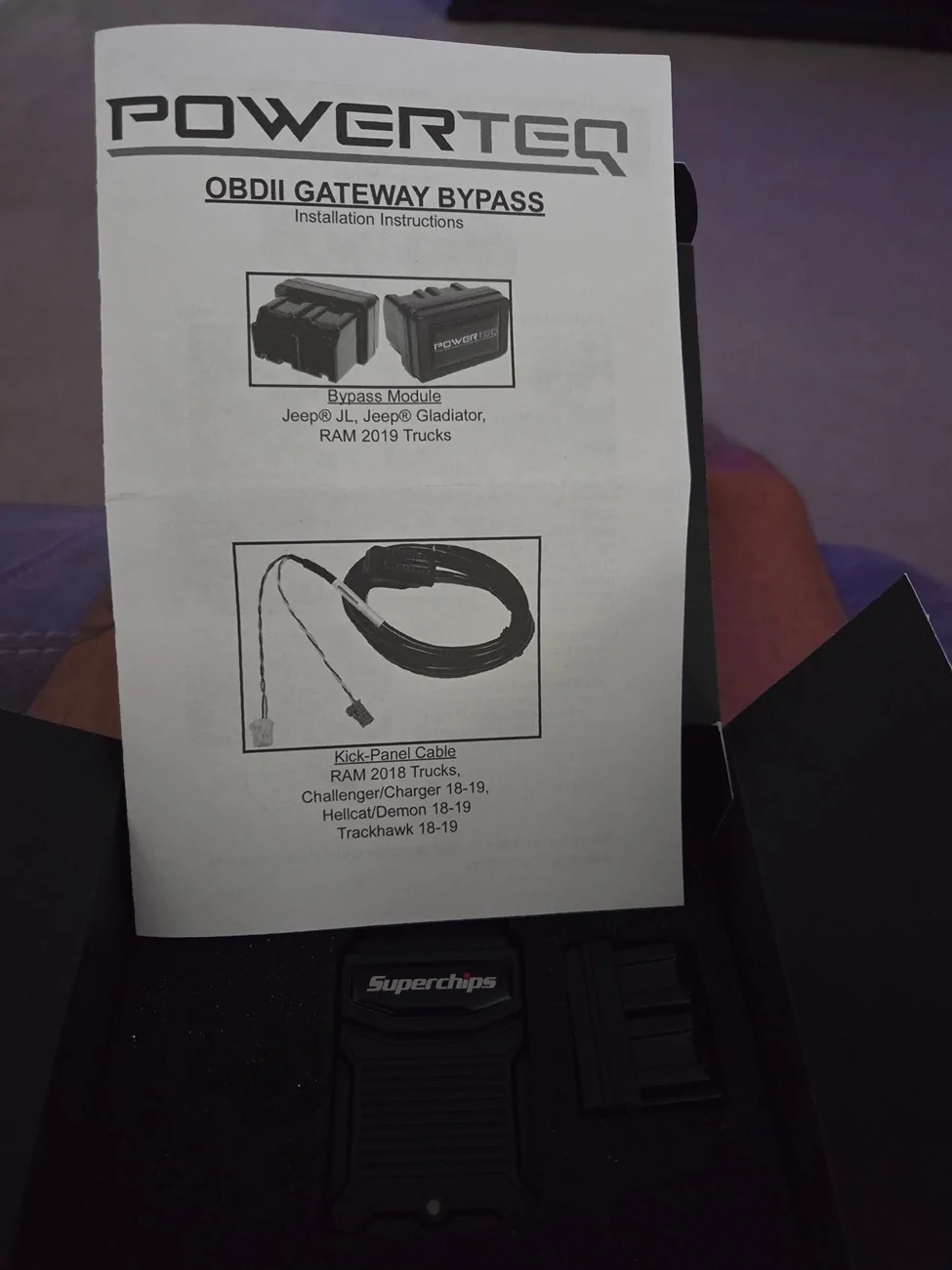

Tybh88
Tyler
Aug 12, 2025
198
276
Did everyone get this same paper. Nothing on it says ford. Dont want to plug in something thats only ment for mopar
Ford Bronco NEW Flashcal+ Bronco Support! 20260724_175648
Nick72
Nick
Nov 29, 2020
170
209
North GA
2021 Bronco Base(Traded), 2025 Bronco Outer Banks
Believe it is only for Jeep/Ram based on what it says.
I received mine today and programmed only using the large dongle.
