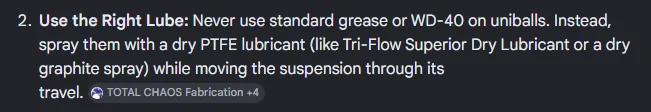

BDS uses a uni-ball joint not a traditional ball joint. They will squeak. Yes, they don't now because you sprayed it with WD40, keep that can handy, once that wears off it will squeak again. It is the nature of the beast.
Technically you should use a dry graphite lube. A "dry" lube does not "collect" dust/dirt, the enemy of a uni-ball.

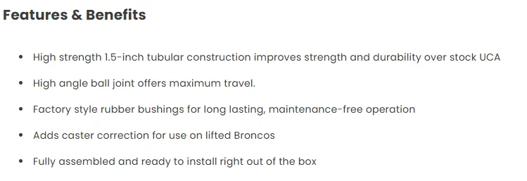

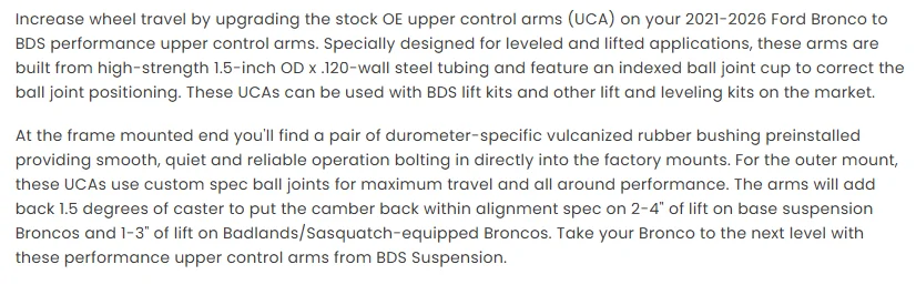

I actually got the BDS arms that have a ball joint for just that reason and easier maintenance of course at the expense of some performance. I didn't use normal WD-40, I used their silicon formula that acks like a dry lube and is safe on rubber. I'v been using silicone spray for years on door seals and such so I figured it wouldn't hurt. You are correct however, it might be a temporary fix. Didn't drive it today, but I did jump on the bumper some more and still not squeaking. I also read the instructions and the bushings do not call for lube on install.

Actually just re-read the instructions UCA only recommended if lifting over 2.5". So at least they look a little bit cooler if nothing else.

Most people do not know that info is why I posted. Good call on the "ball joint" arms. I'm surprised they are squeaking. That was the whole point as to why BDS gives you the option. Uni-balls for the hard core (dont care about the noise) and ball joints for everyday people (want them quiet).

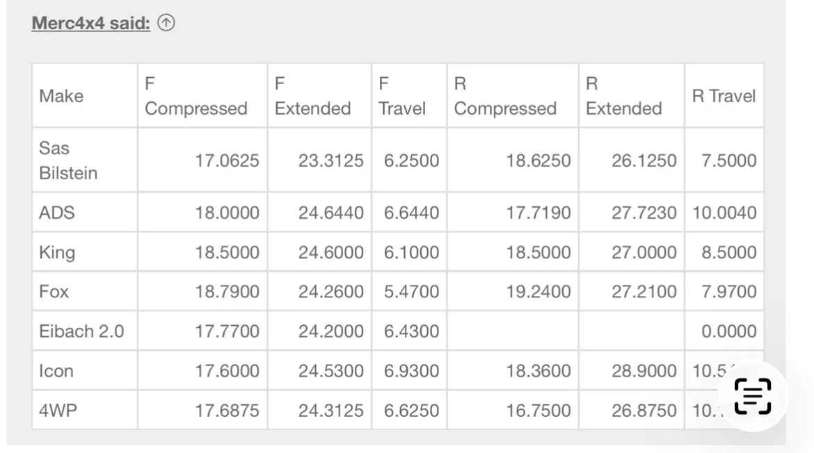

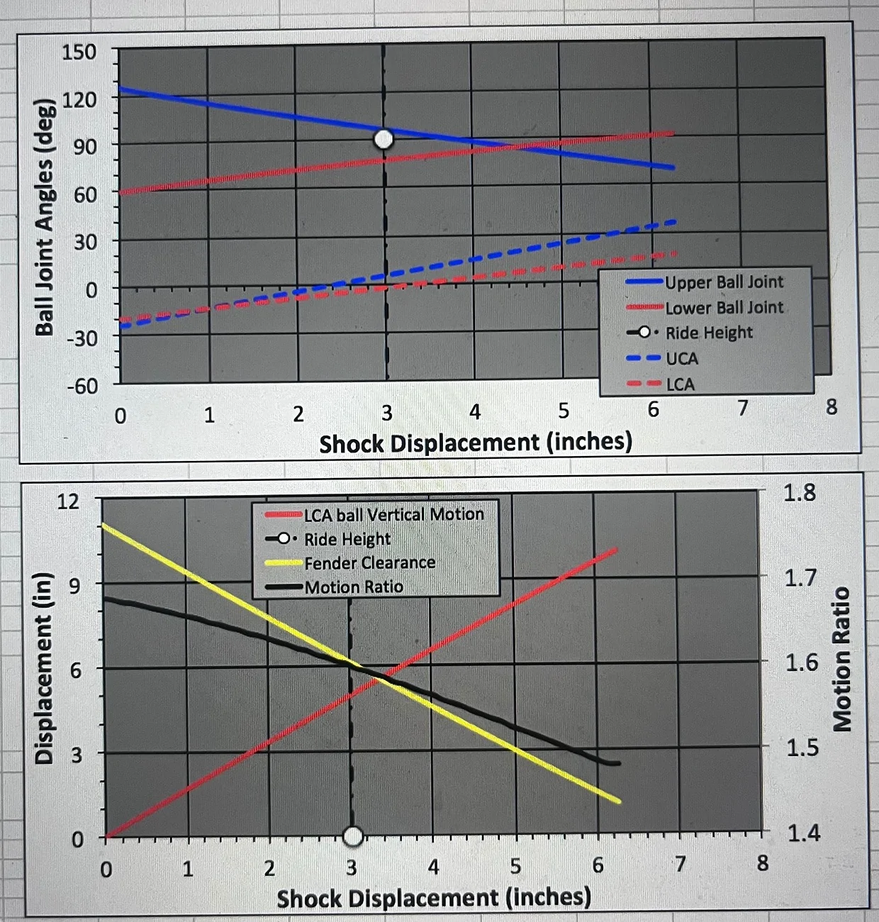

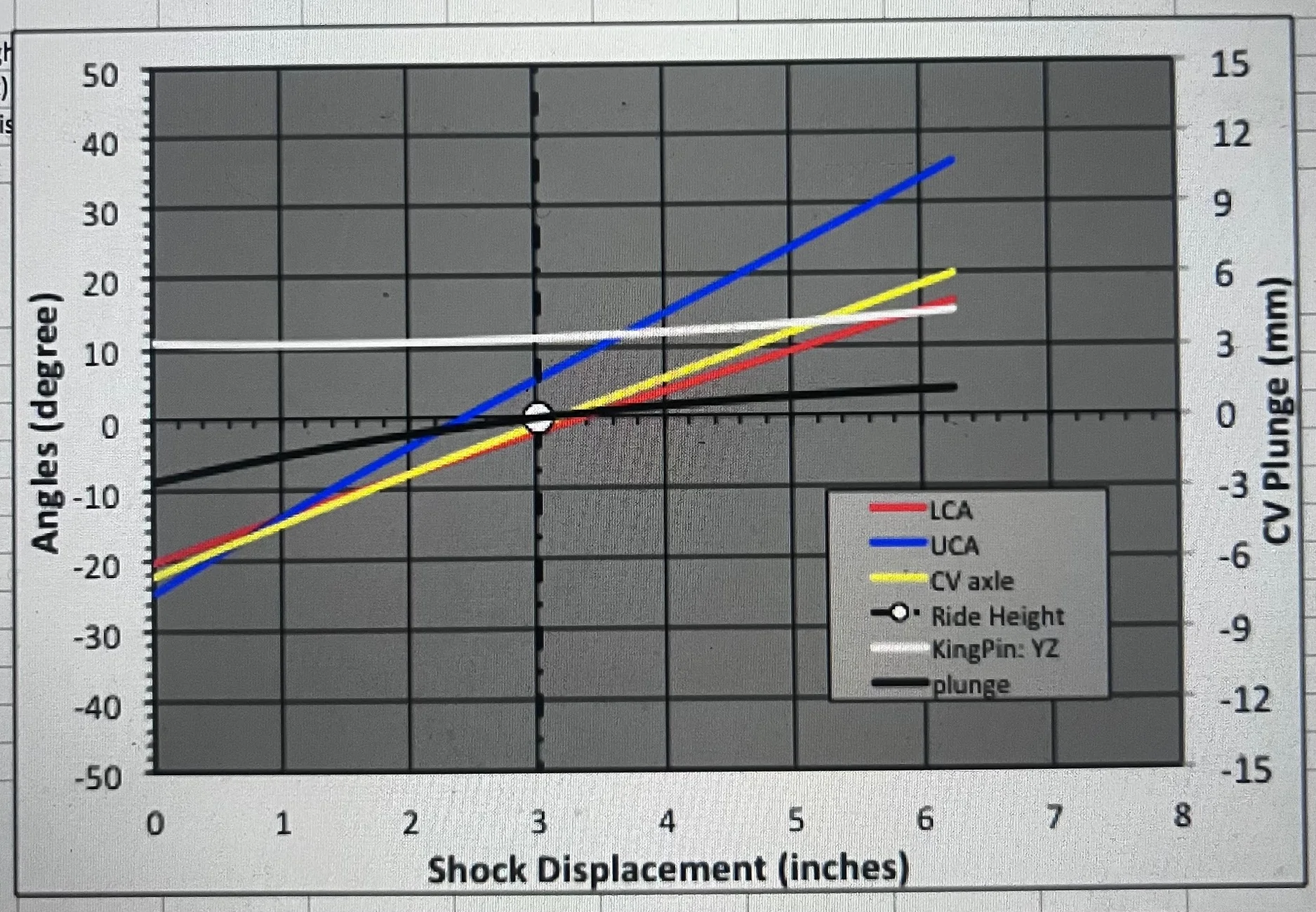

The 8112s have <6” of travel in the front and have an extended length of 23.4”. Squarely within OEM kinematic design parameters. See plot. They are position sensitive to provide serious hardcore damping as shock piston velocities and displacements increase while offering more mild and manageable shock response for minimal displacements near ride height. They are purposefully designed near oem kinematics for a ride height (shock equilibrium) near mid stroke with a mild lift (1” or so). This is probably ideal for 35s and high speed higher displacement shock response.
I just don’t see any advantage to running after market UCAs with these, perhaps only some maintenance disadvantages. Unless you really want to minimize control arm displacements by going from flexible bushings to steel on steel joints. Of course that comes with maintenance. UCA ball joint angles can never be a problem with these or a reason for new UCAs.

Yeah I'm about to get rid of my BDS uppers because I can't stand the uni-balls anymore. Living in Illinois and driving it year round, even constantly trying to keep them clean and add the PTFE dry lube, they just continue to rust out super bad. Just cant keep the salt and shit out of them. Tired of the noise lol
