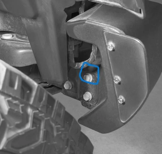

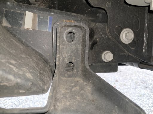

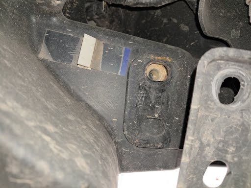

A while back I put on a set of Weathertech rear mudflaps on my 2024 Wildtrak. I noticed today that the factory bolt that you have to remove and re-use on the passenger side is missing.
I am hopeful that @Ducati1098 can get me the correct part #. I have attached a photo.

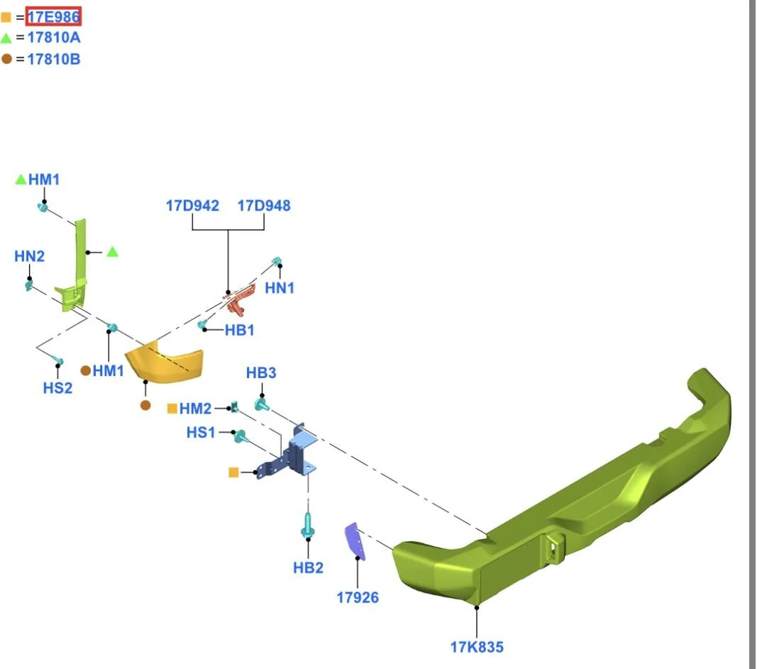

It 100% sure what I’m looking at in the picture. Here is the rear bumper diagram, do you see which bolt you need?

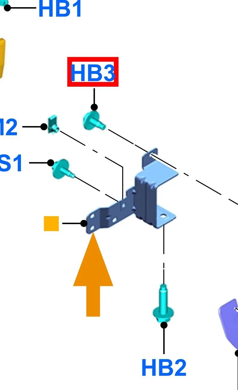

I think it is HB3. I attached the pic from the install sheet. It shows a little more detail than my pics did. The bolt I need is at the top. They say the bolt at the bottom wasn't used in my model.

It’s hard to tell if that’s the same bracket. I think it is, but the bolts your looking for go here:
Ford Bronco Need Bumper Bolt Part # IMG_6807
I can’t find those though. HB3 is W505442-S439
Ford Bronco Need Bumper Bolt Part # IMG_6808

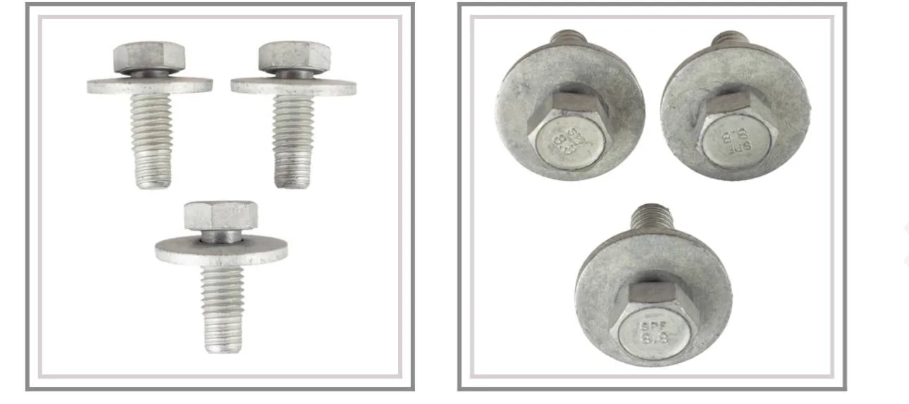

Catalog only says M10, but I took one of mine out really fast and it's M10x1.50 and roughly 25mm long
