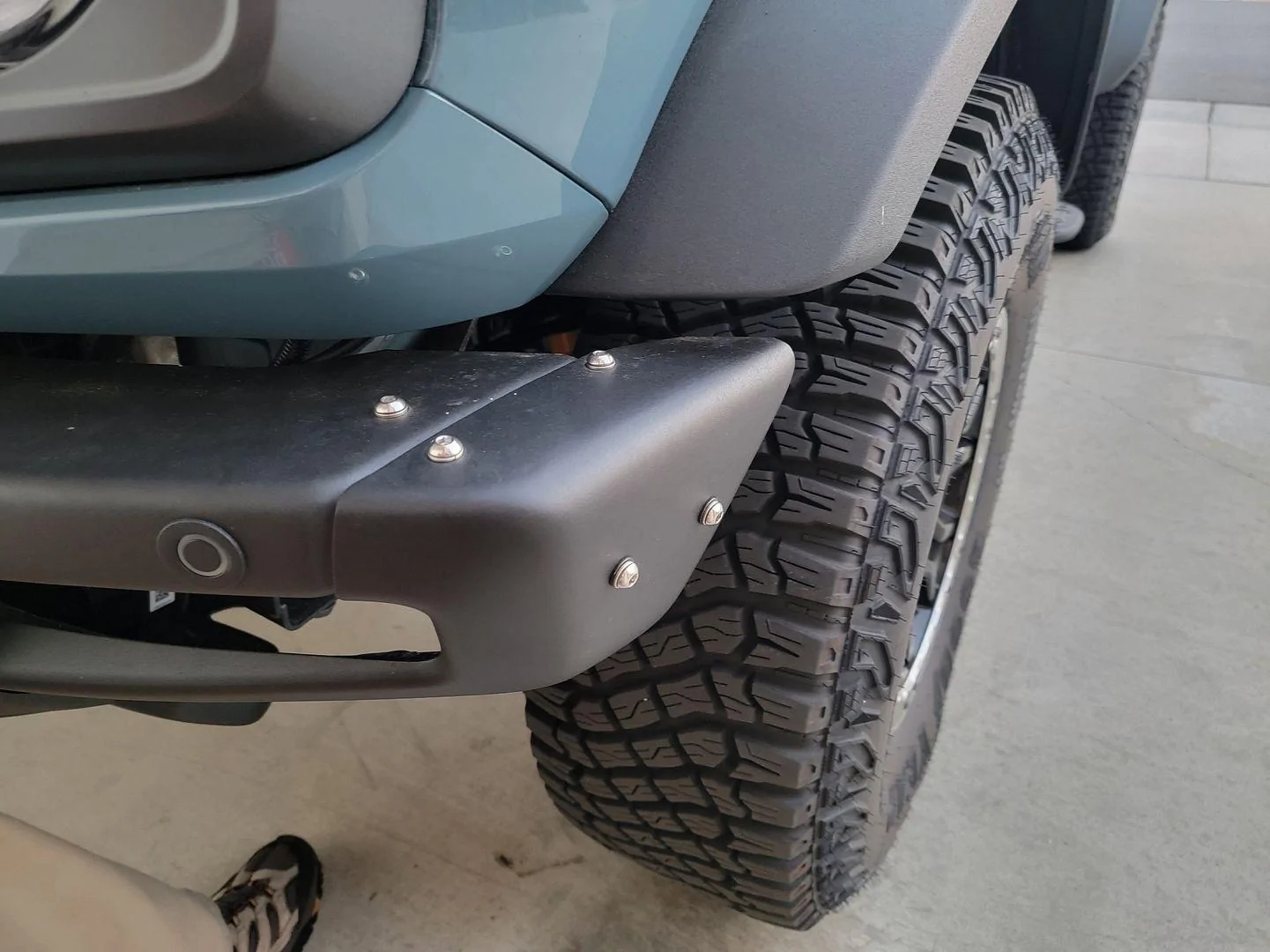

just... careful.
This is very true. The steel used to make the Bronco bolts is really soft and will easily cross-thread if you aren't careful.
I'm kicking around the idea of replacing them with some thing else. M8x25 (or longer as needed) fit perfectly:
Ford Bronco Modular bumper bolt sizes? Bronco_Bumper_Bolts_M8_01
