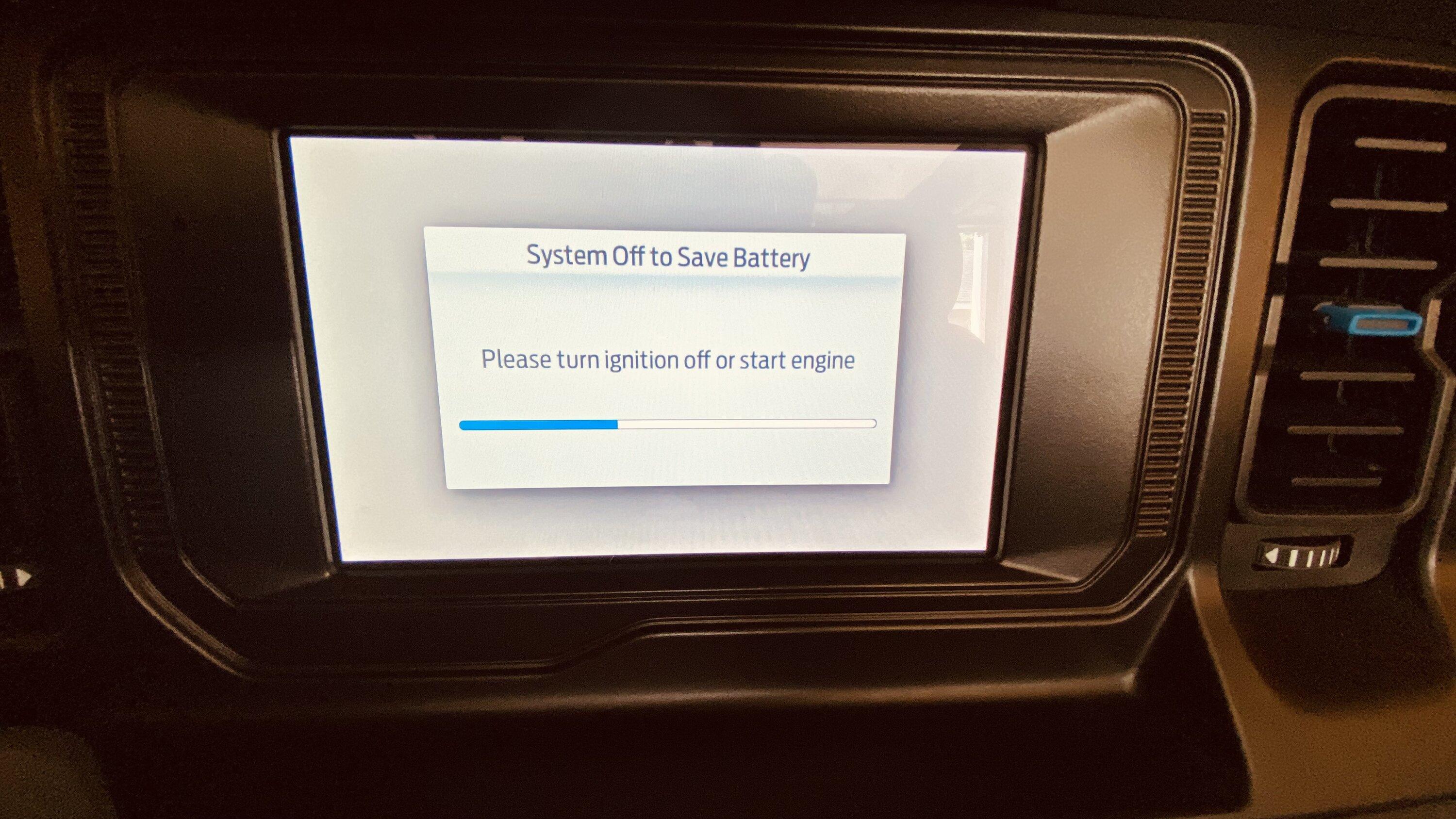

Got the "system off to save battery" message the past few days.
Passenger side door stopped opening with the key fob (have to actually hit the unlock button on the fob) and the interior lights don't come on automatically any longer.
The KC ditch lights that have been on the truck for almost 3 years won't turn on either.
Checked all the connections.
Battery voltage is reading 14.8.
Is the battery really going dead? I don't drive it much more than to work and back most weeks which is only around 20 miles total per day.
Dads_bronze_bronco
Feb 18, 2020
4,299
7,581
08 JKUR / x_x 00 TJ x_x
I just read if you don't lock the bronco the BCM may not enter sleep mode (thus the computer sounds when it is unlocked in the garage). If mine sits in the garage for several days I get the "system off to save battery" warning, and a quick diagnostic shows the battery at 65%.
So—not a fan of locking it in my own garage but—I am going to try locking it in my garage and see if I still get the problem.
