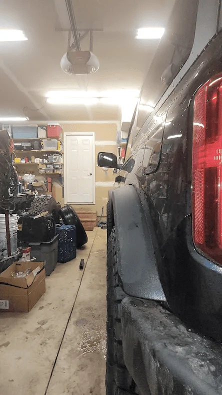

Here's 17x8 with 0 offset, not sure about the tire size but I think it was someone here. You might stick out about 1/4" more than this on stock flares, they would probably fit under Sasquatch flares.
Ok that's not too bad..
Looks good

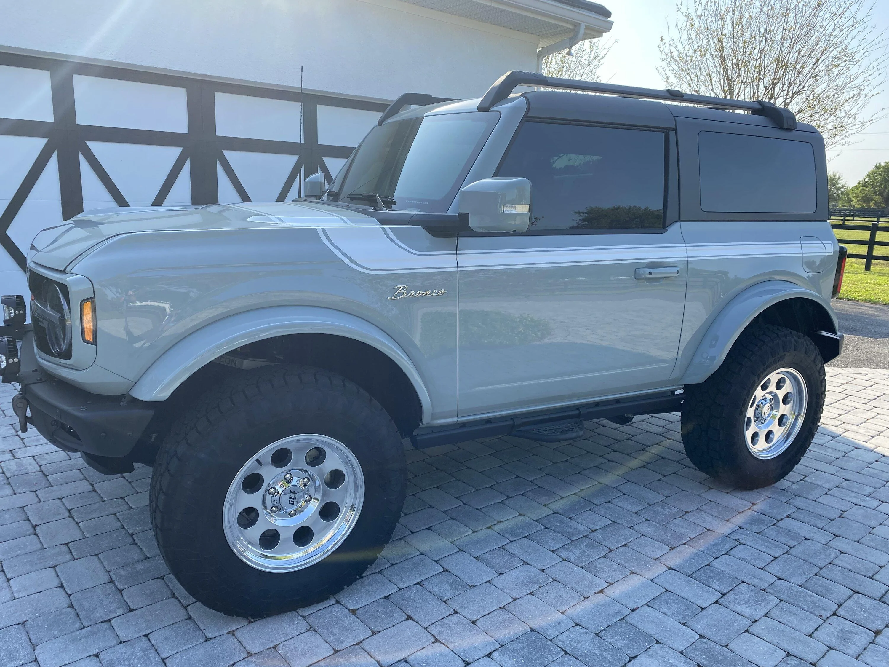

Here is a 285/75/18 tire (Taller than a Sasquatch Tire) on a 18x9 with a +12 Offset. They do not stick out past the Sasquatch Flare.
Sasquatch Suspension and 1" Level Lift up front.
Voxx 18x9s are one of the very few Old School looking Polished Aluminum wheels with a Positive Offset.

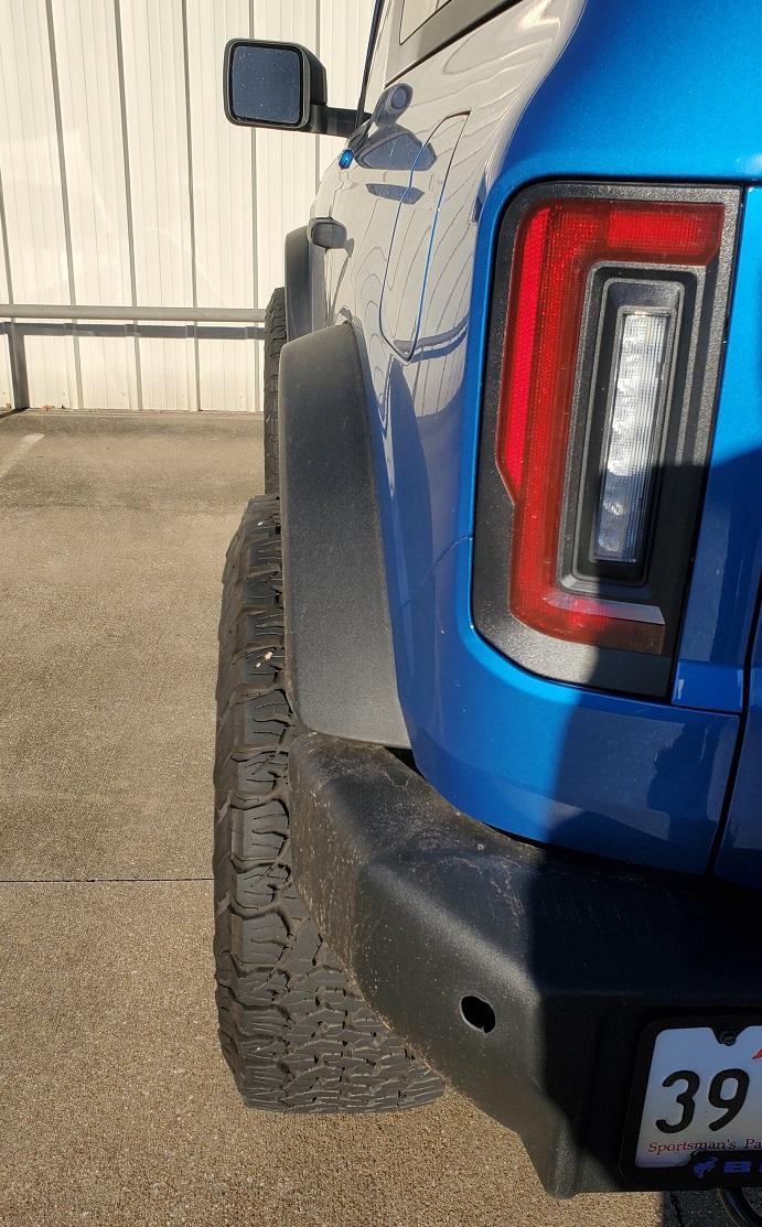

I'm trying to plan out my wheel tire combo for my BB non-sas getting built next month. I'm planning on...
Wheels - American Racing AR172 BAJA
Size - 17 X 9 -12
Tires - 295 R70 X 17" BFGoodrich KO2 All-Terrain
Suspension - 2" lift
does this look ok? Will the tires stick out past the fender flares? Do I need 17x8 instead?

Here's a picture of someone here that has 17x9 with -6 offset and 295 tires. The -12 would stick out another 1/4" so you would probably want Sas fender flares for more coverage.

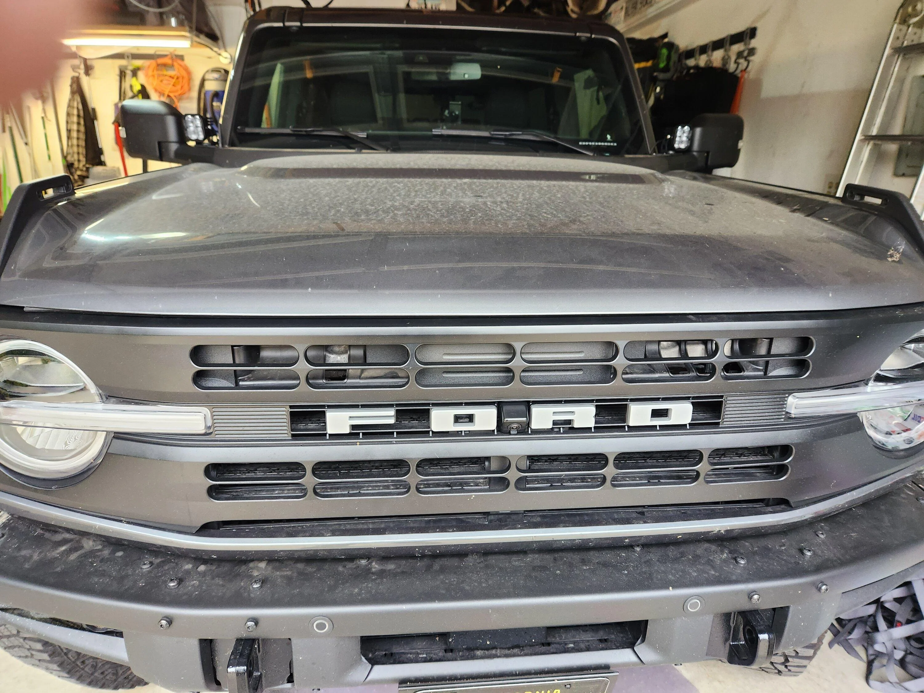

I bought the Heritage grille from an online Ford dealer for much less than MSRP...and I painted it hot rod black (2k rattle can). I then got tired of the red letters...too red for me...and painted them to match my Archetype Racing Bronco emblems (silver).
No offense, took me a second to even catch on seeing the picture that this wasn't a Black Diamond/Base grille and I'm an HE order. Which AR script did you get? I got the base base in silver and red so, at least for mine, the red will tie with the letters and I'll probably go red with the shackles.
