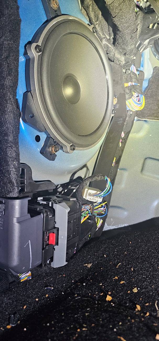

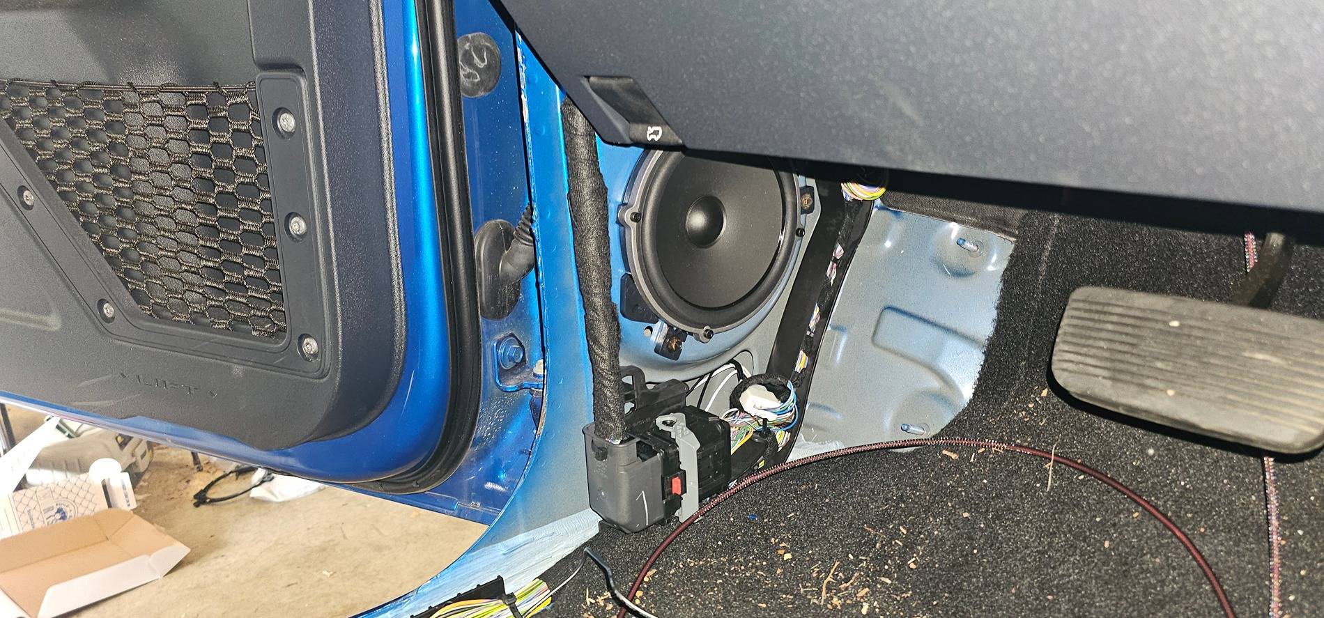

2. GS60's in the kick panels - I went a slightly different install route than I had seen others do. Curious what the group thinks about this, and if it can impact the sound volume/quality from the nether regions of the pant legs!) I utilized the adapters that came in the box with the speakers. I had purchased the Metra kick panel speaker adapters, and left them unopened. This is all primarily to other reviews I read that mentioned woofer travel could contact the speaker grills. See Pic #1 & 2 below on installed kick panel speaker.

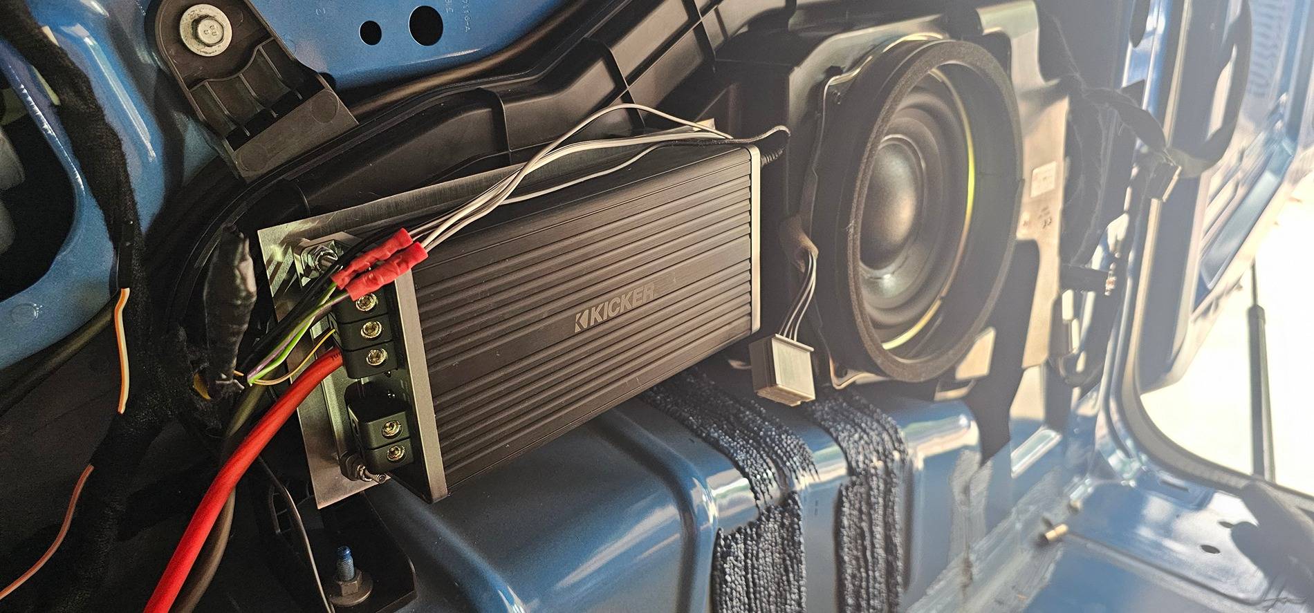

4. Kicker 500.1 Install - Using a sheet of aluminum, I created a mockup and used washers as spacers to install the new amp to the old amp location. Since I'm not using the existing sub, I haven't noticed any vibration coming from that direction. See Pic #3 for my NON PROFESSIONAL install. PS, if anyone needs a template, I digitized it in Cad, to-scale, and can email you a pdf on 8 1/2" x 11" paper. PPS, note the low-level feed connections... looks janky, but I believe sufficient.

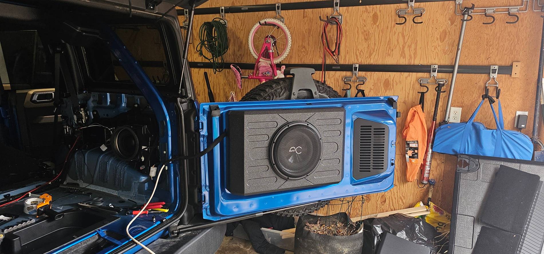

5. Tailgate Sub - Using the socket technique for the nut-setter was a PITA, but 20 minutes later, and thanks to my son's extra pair of hands, we had the sub installed nice and snug. See Pic #4.
