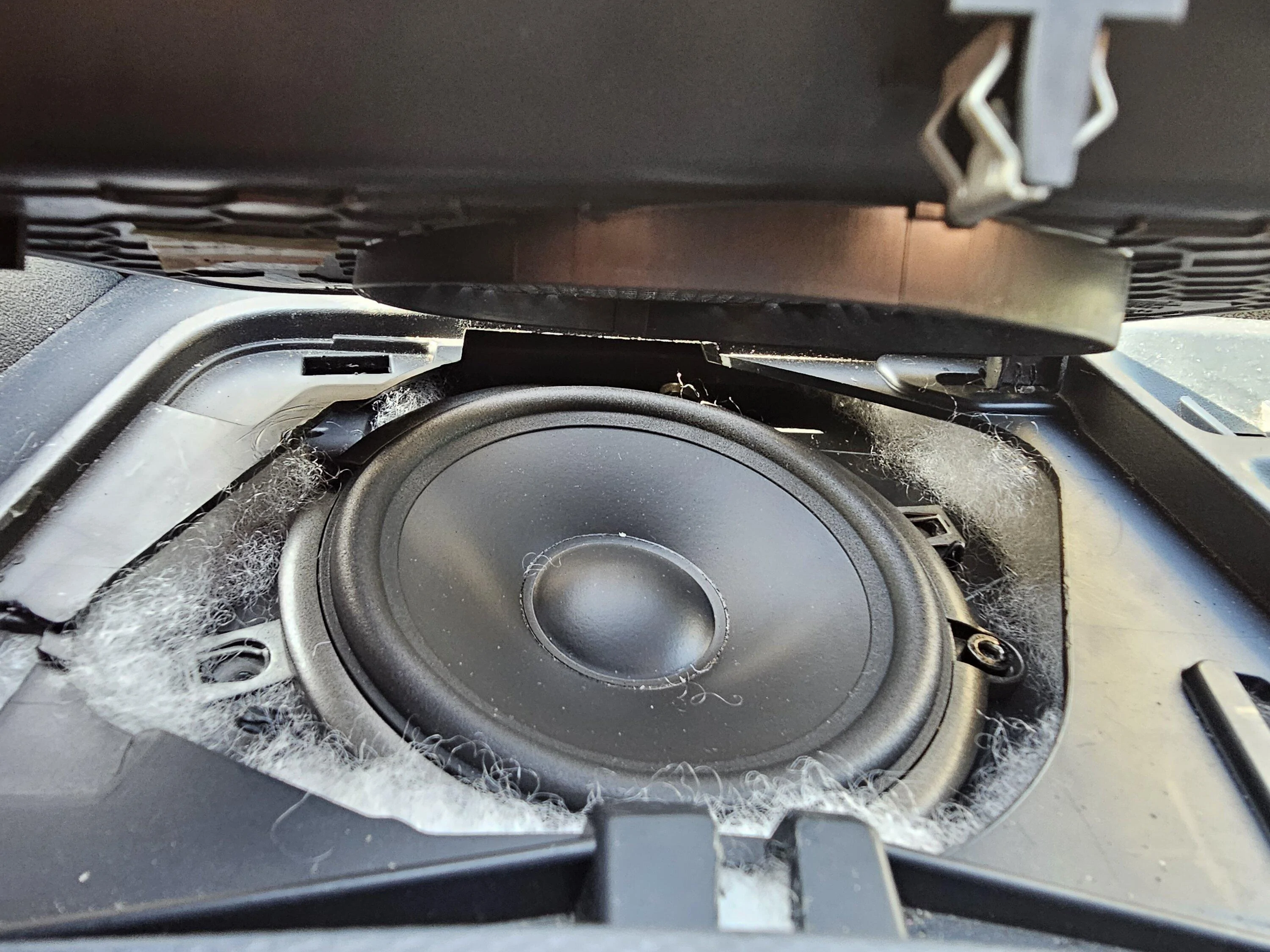

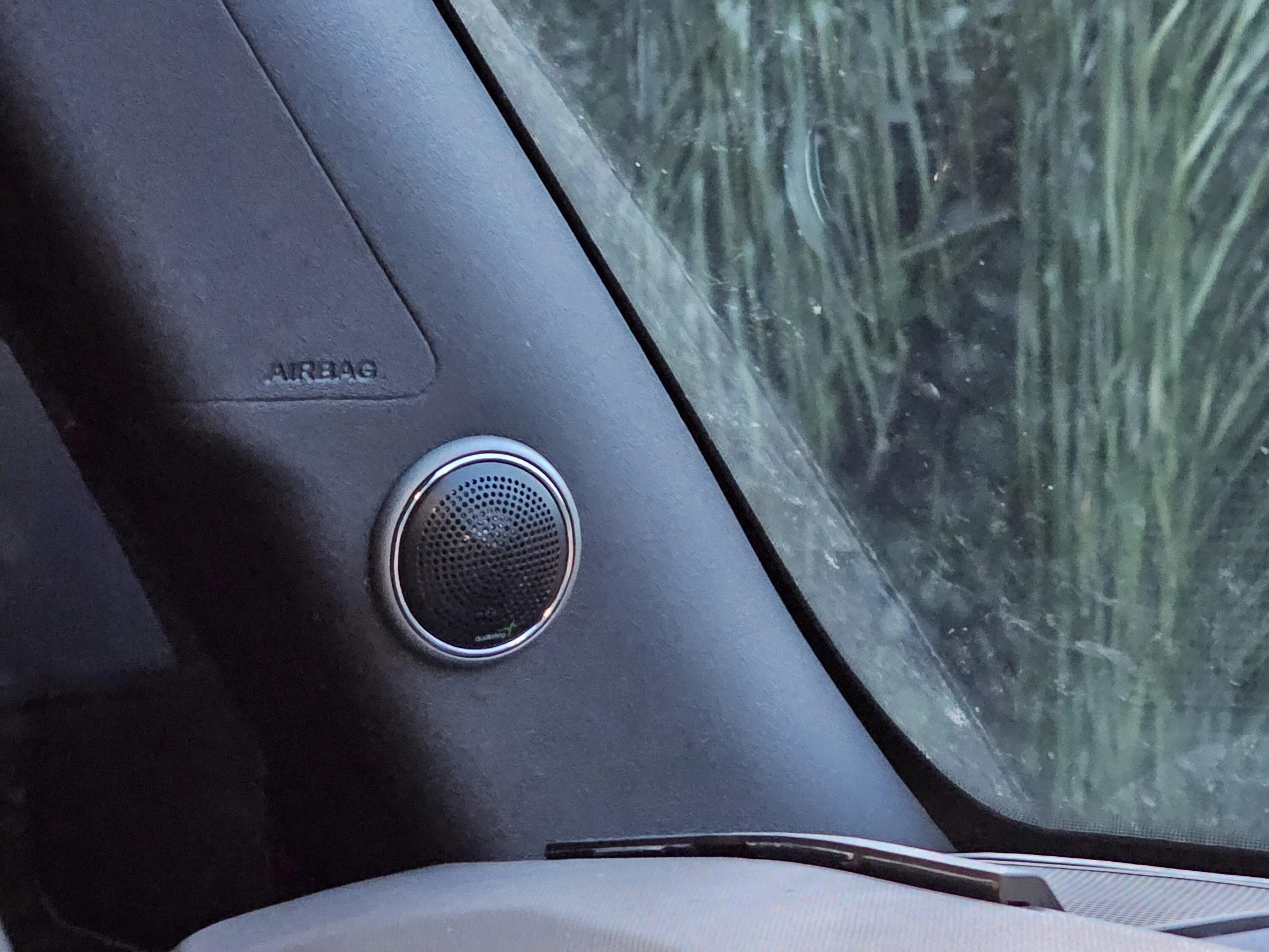

BACKGROUND
I recently upgraded (my already upgraded) base audio system in my 4 door BD.
I am now running Audiofrog GB-10 Tweeters in the A-pillars, a pair of GB-40 the factory dash locations, a pair of GB-60 in the kick panels, and a pair of GB-60 in Mabett rear pods. The Audiofrogs are powered by an Audiocontrol D-6.1200: GB-10s / GB-40s on 2 channels using a GB-410 crossover, and then a pair of GB-60 on each if the remaining 2 channel sets. I also have a 12 inch JL sub powered by a JL RD 500 amp. Aside from constantly tweaking the DSP to find the perfect settings, the quality of sound coming out of the Audiofrog speakers is mind blowing.
Thanks for the info - what do you have your GB40's tuned to?
I'm trying to work out the 250 hz bump and 300 hz valley by using the GB-40s in dash and tuning down to 200hz.
