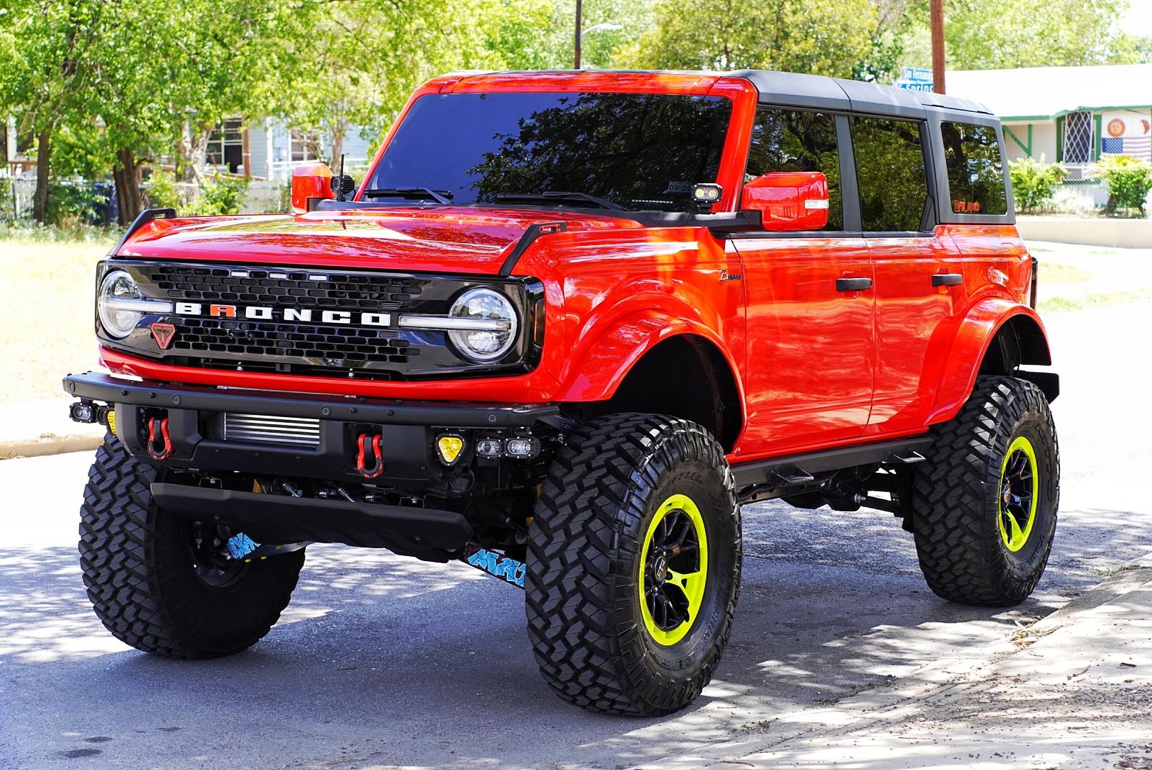

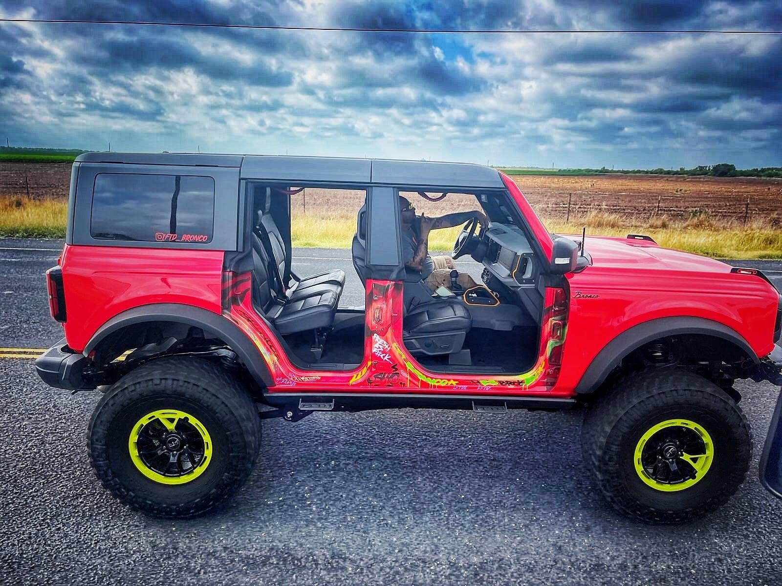

So there’s 3” of body lift plus the 4.5” suspension 😳. Interesting. What all extra needed to happen for the body lift? It’s a pretty wild setup 👍. Keep her rubber side down and have fun!
It's the bronc buster 3 inch body lift

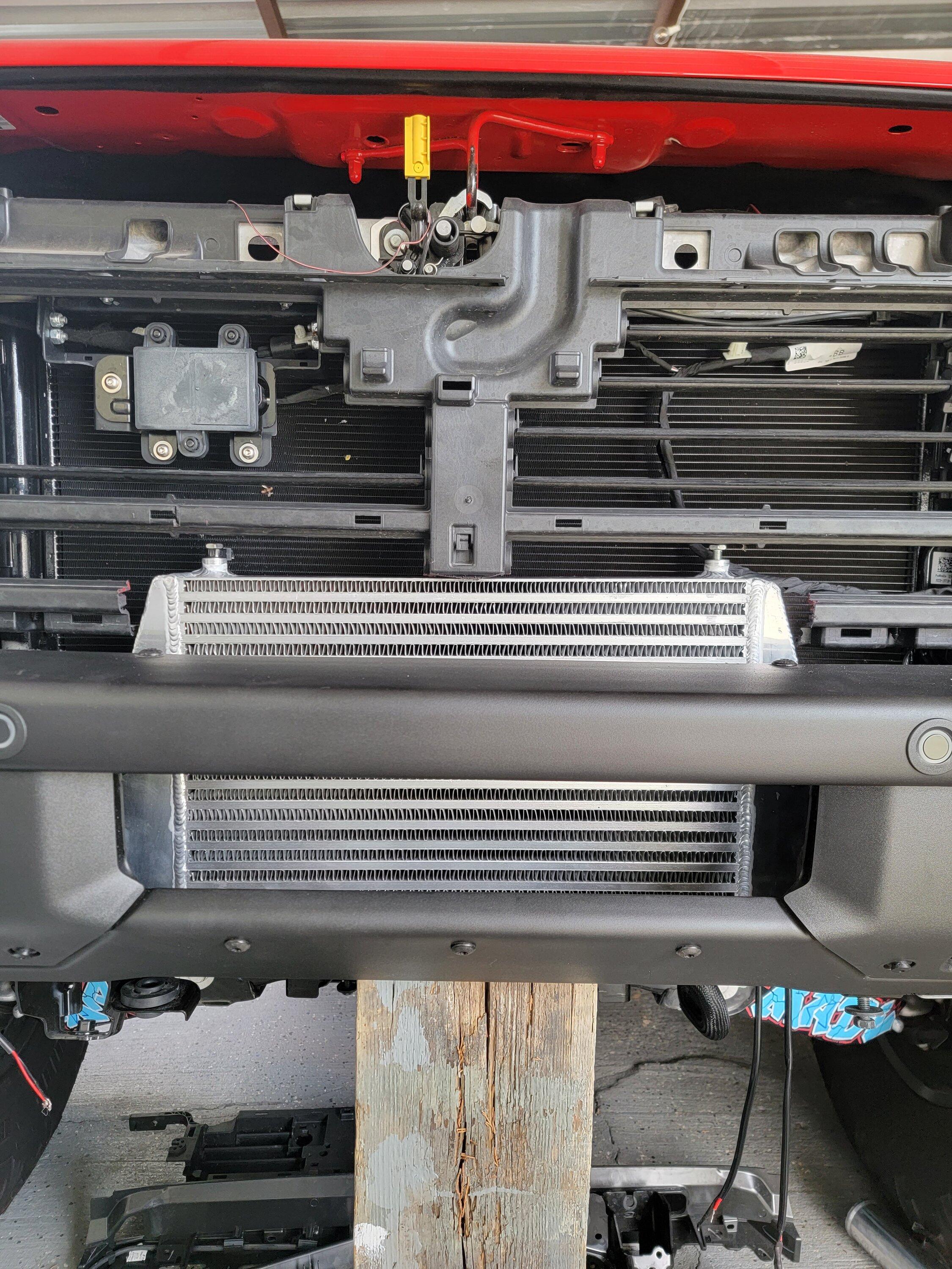

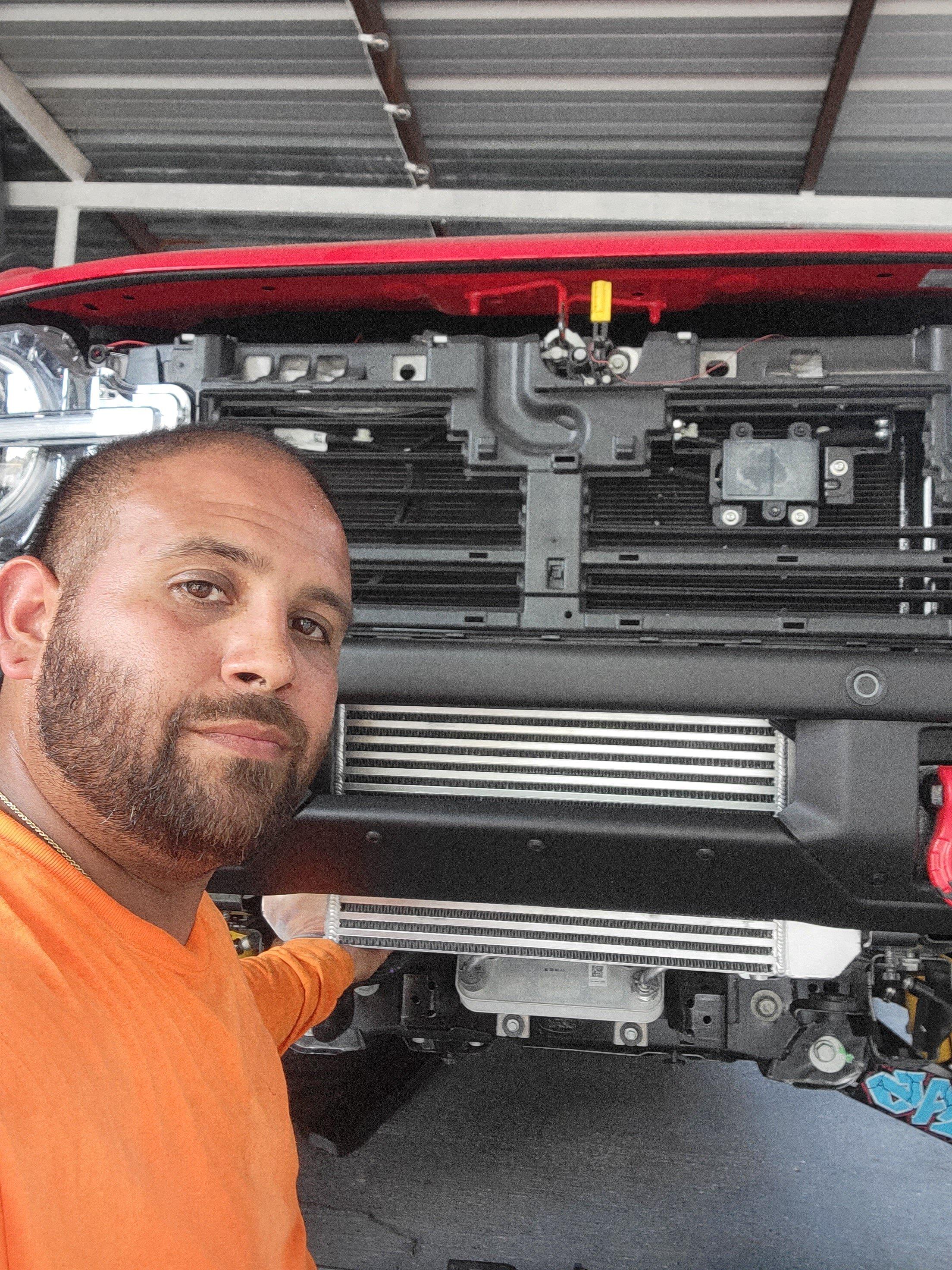

question: Fmic ? Ford Motor inter cooler?
That's why I clicked on the link, I wanted to know what a FMIC is! Otherwise, this beautifully done rig is about a foot too tall for my use!!
Right I was getting at did a bunch of stuff have to be extended? Looks like it’s gonna be a blast off road. I’m only 3.5” lift on 37’s at least until it’s not my daily driver lol!

2022 bronco badlands lux package
4.5 inch custom lift done by American elite outfitters
3 inch body lift from broncbuster
bronc bushing
bronc billet steering
replacement jks tie rod sleeves
jks lower control arm skids
jb4 tuner on e30 fuel
k&n filter
38x13.50r17 rtr wheels
mic tuning rock lights.
Custom large front mount intercooler.
I like it!! I’m at least wanting to pull the damn shutters. I want as much flow as I can get across the intercooler!
I installed a body lift also. Only one group of wires needed to be moved from the outside of the body mount to the inside. One ground wire needs a extension. The intercooler needs to be moved up if you want it lined up with the bumper after being raised. New intercooler hoses need to be replaced or shortened. Also the front skid plate needs to be rebuilt or added to. If you don’t want the gap and exposed oil cooler between the bumper and front skid plate as this build has.
It's just short for front mount intercooler my brother I just saw ur question it's all good nothing wrong with asking

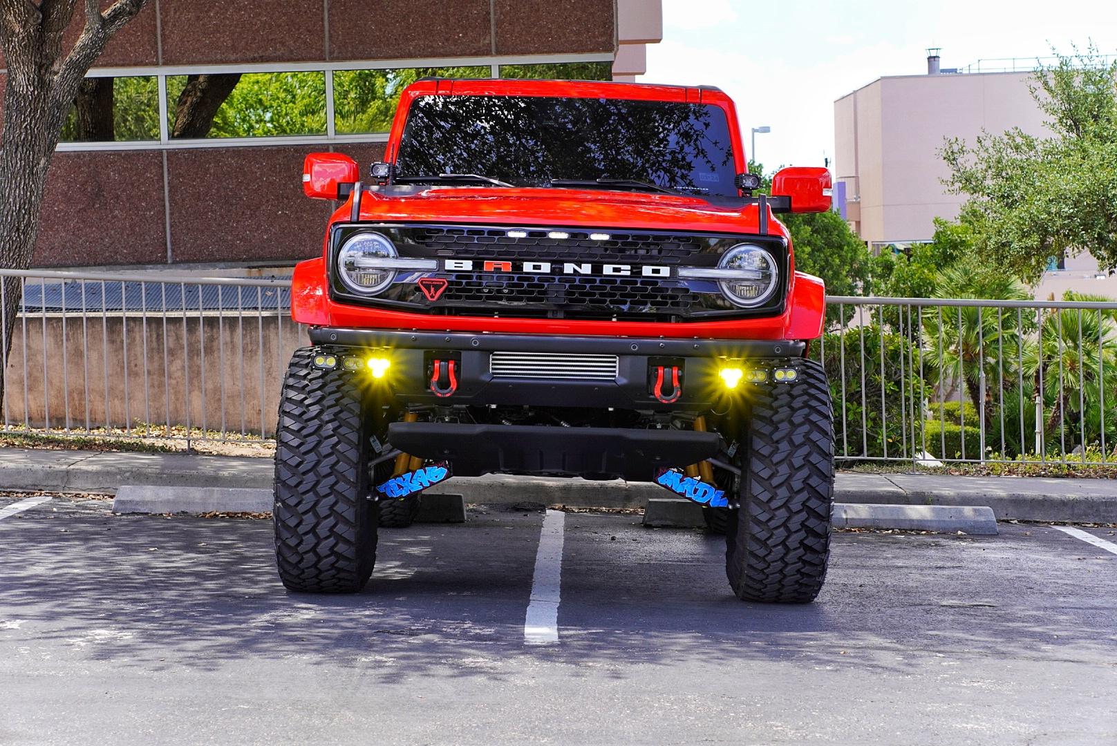

Looks good. I liked it better without the 3" body lift and with the black flares. It still looks good. Nice work.
Does the 2.7 in the Bronco have heat soak issues? I’m asking because I haven’t heard of any yet.

The intercooler looks great, but why did you take it so far but did not add a front winch? We talked on the forum early on about someone doing a larger intercooler to help clear the winch area in order to install a winch.

That sucker is LARGE and IN CHARGE! Hope to see some action shots soon!
