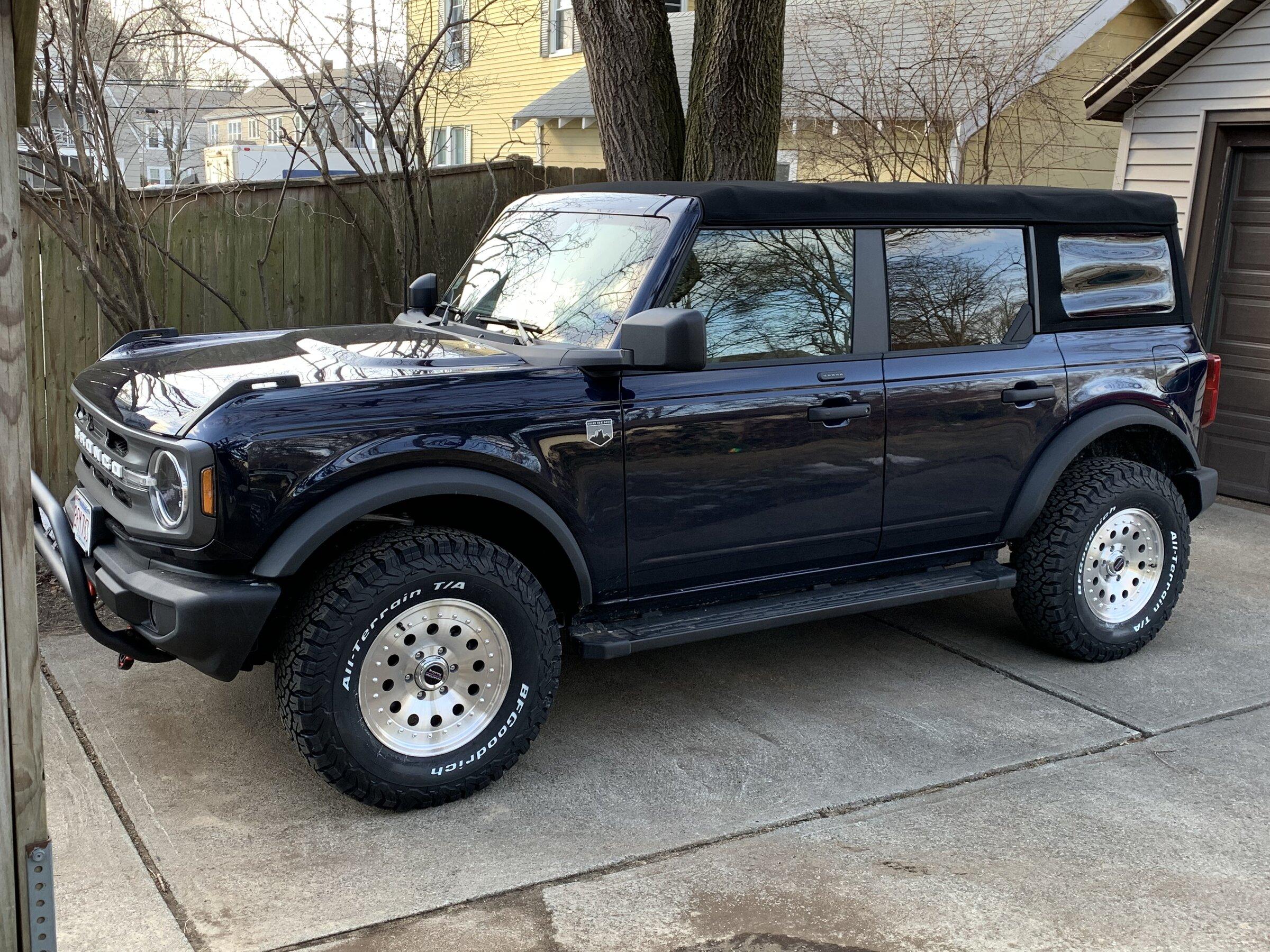

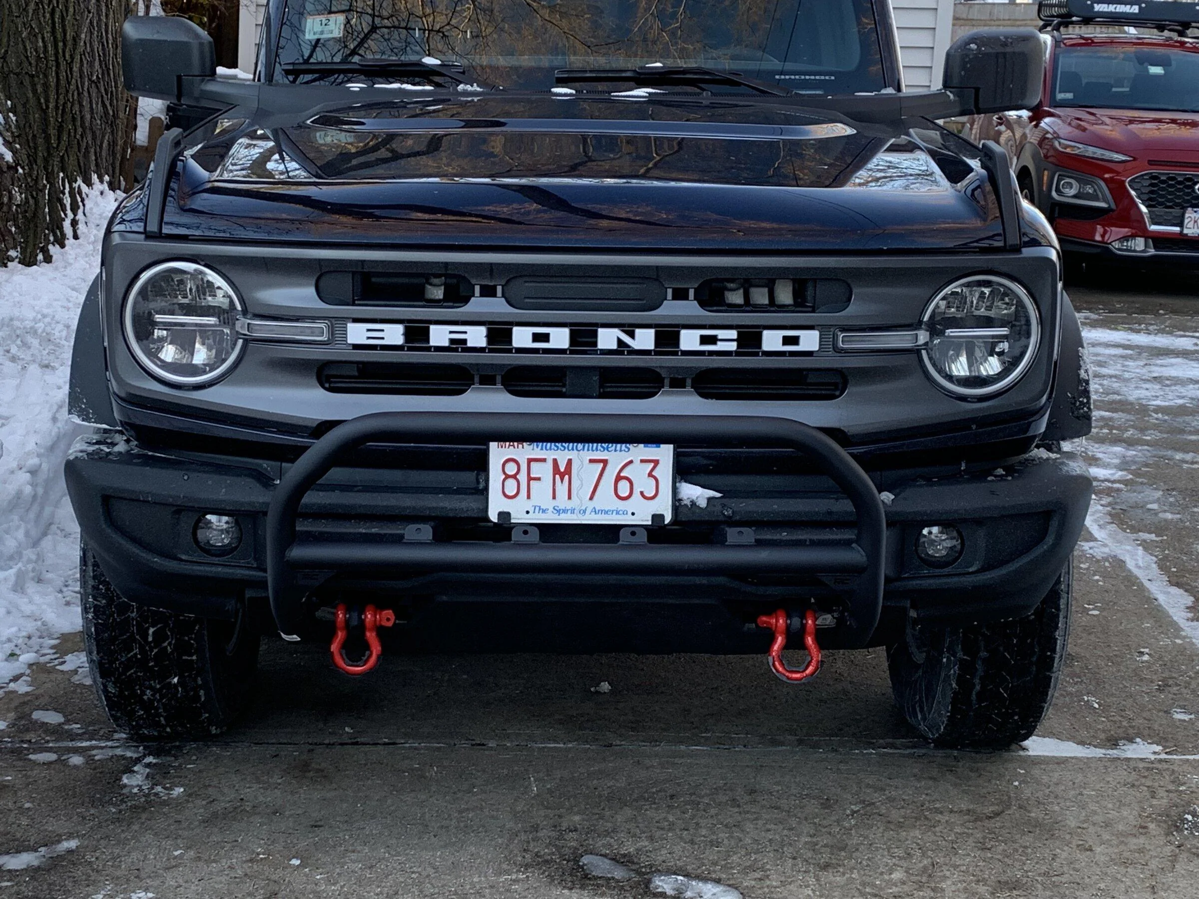

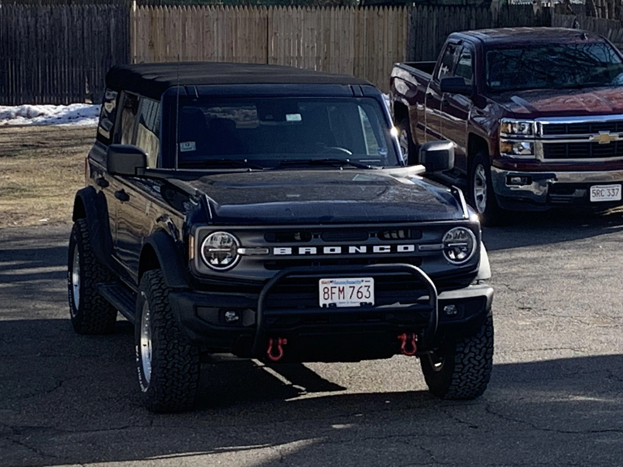

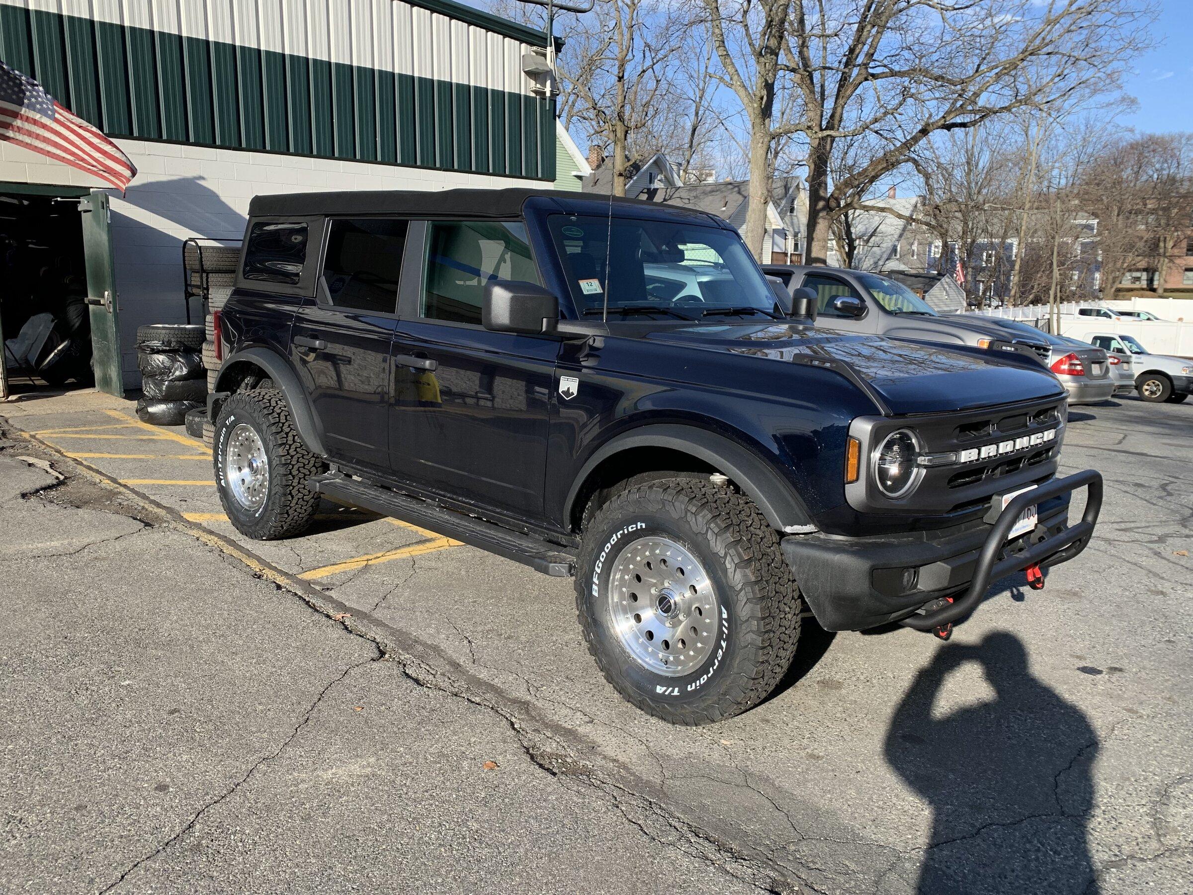

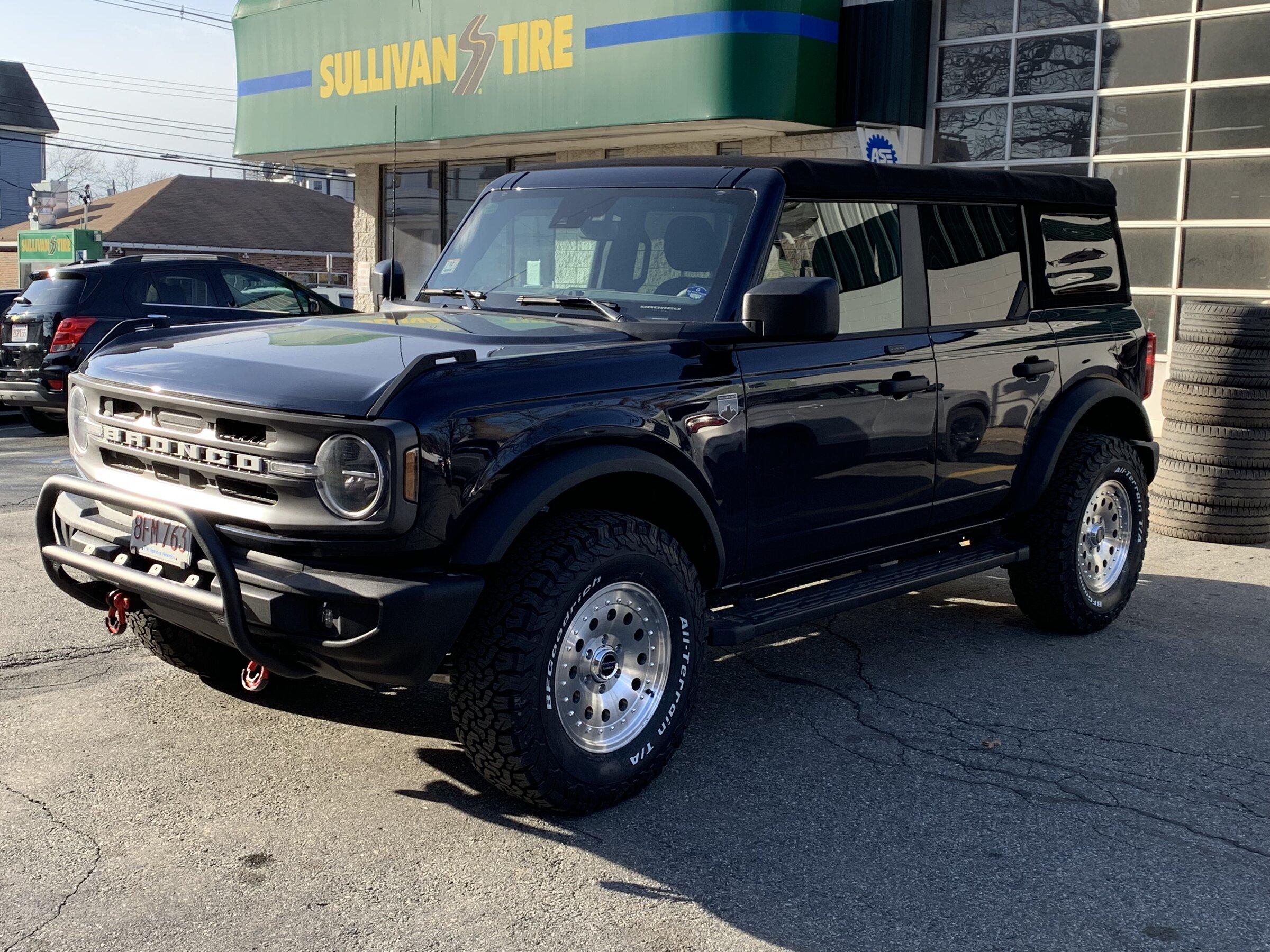

So the mods have officially started. Today I installed a Rough Country tow shackle conversion along with their nudge bar. Took a few hours just because I did it in my driveway in 28 degree weather laying on snow and ice. I did have to use a Dremmel on one of the brackets to open the hole for the shackle pin. I'm assuming it was a manufacturing defect.
My wheels were supposed to come today as well. According to UPS they were on the truck for delivery at 7:00 AM and by 7:00 PM the tracking info just stated there was a problem and they are working on updating an estimated a delivery date. Considering the UPS location where they were is about 10 miles from my house I'm not sure how they screwed that up.

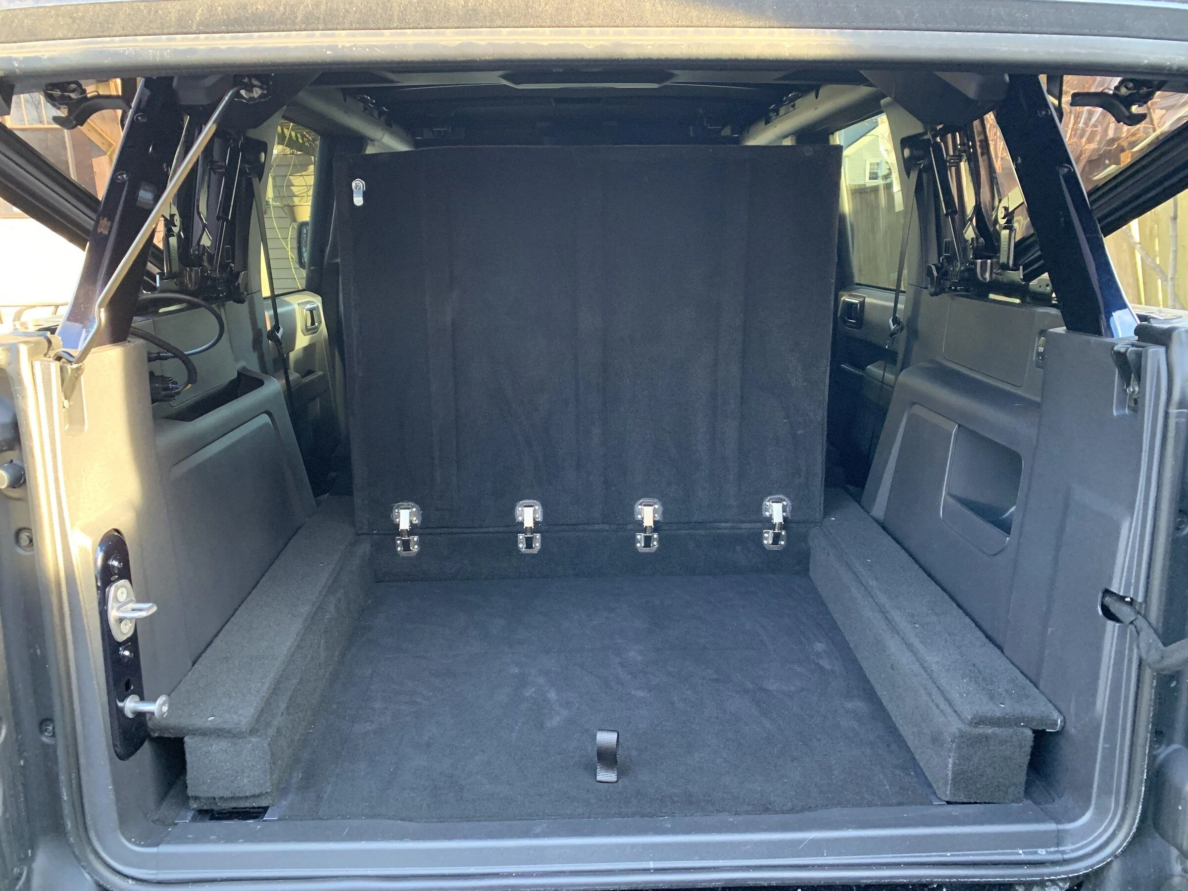

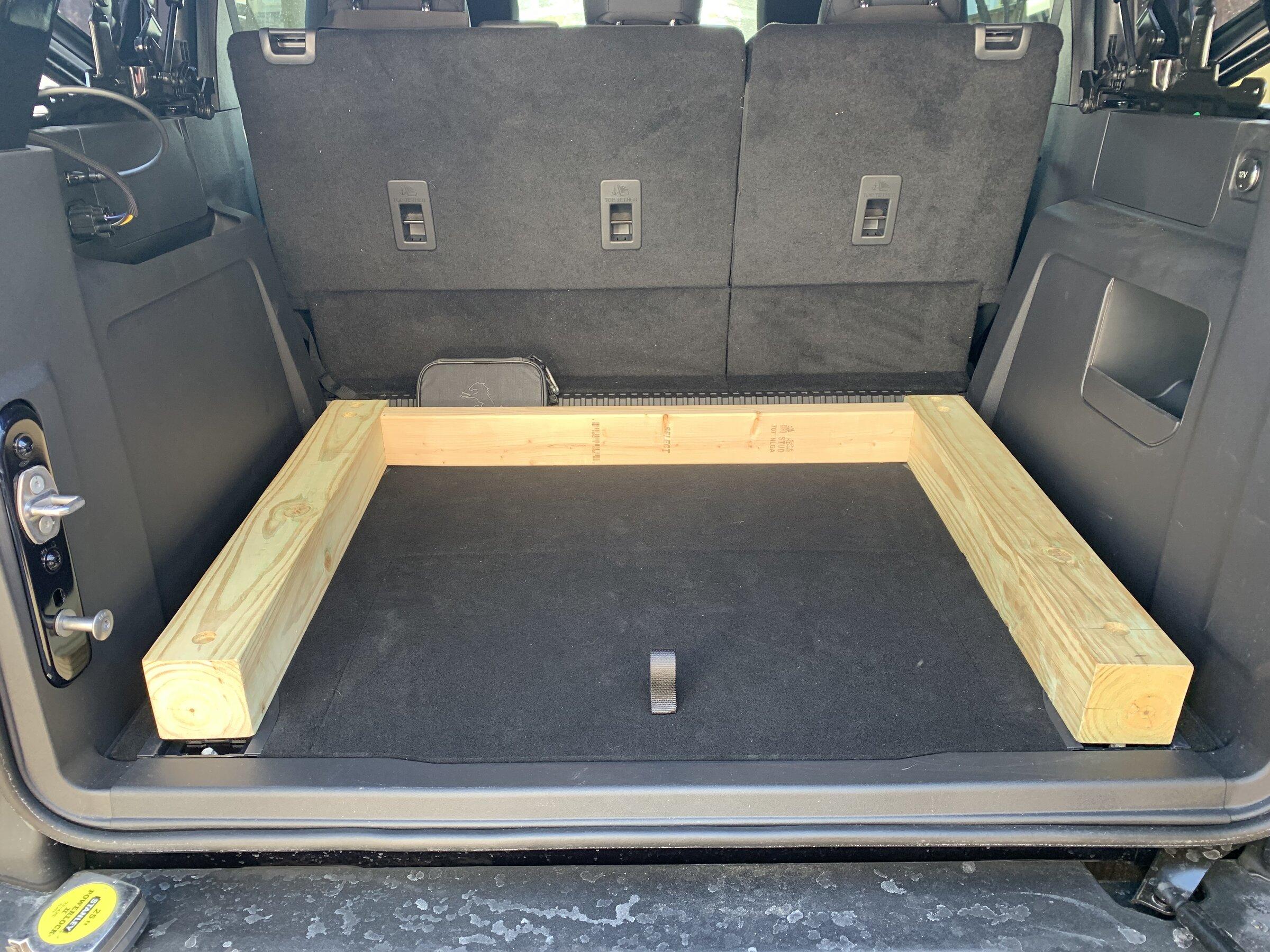

Finished up the main work (cutting, fitting, adjusting, repeat) on my rear cargo storage box thingy.
Ford Bronco My Own Tribute Build IMG_6439
The frame is 4x4 with a 2x4 connector at the rear seat back. The holes are countersunk with hardware to bolt it to the stock cargo tie down holes. I'm also going to put 5/8" nylon spacers underneath to help protect the OEM carpet insert and give it more stability.
Ford Bronco My Own Tribute Build IMG_6442

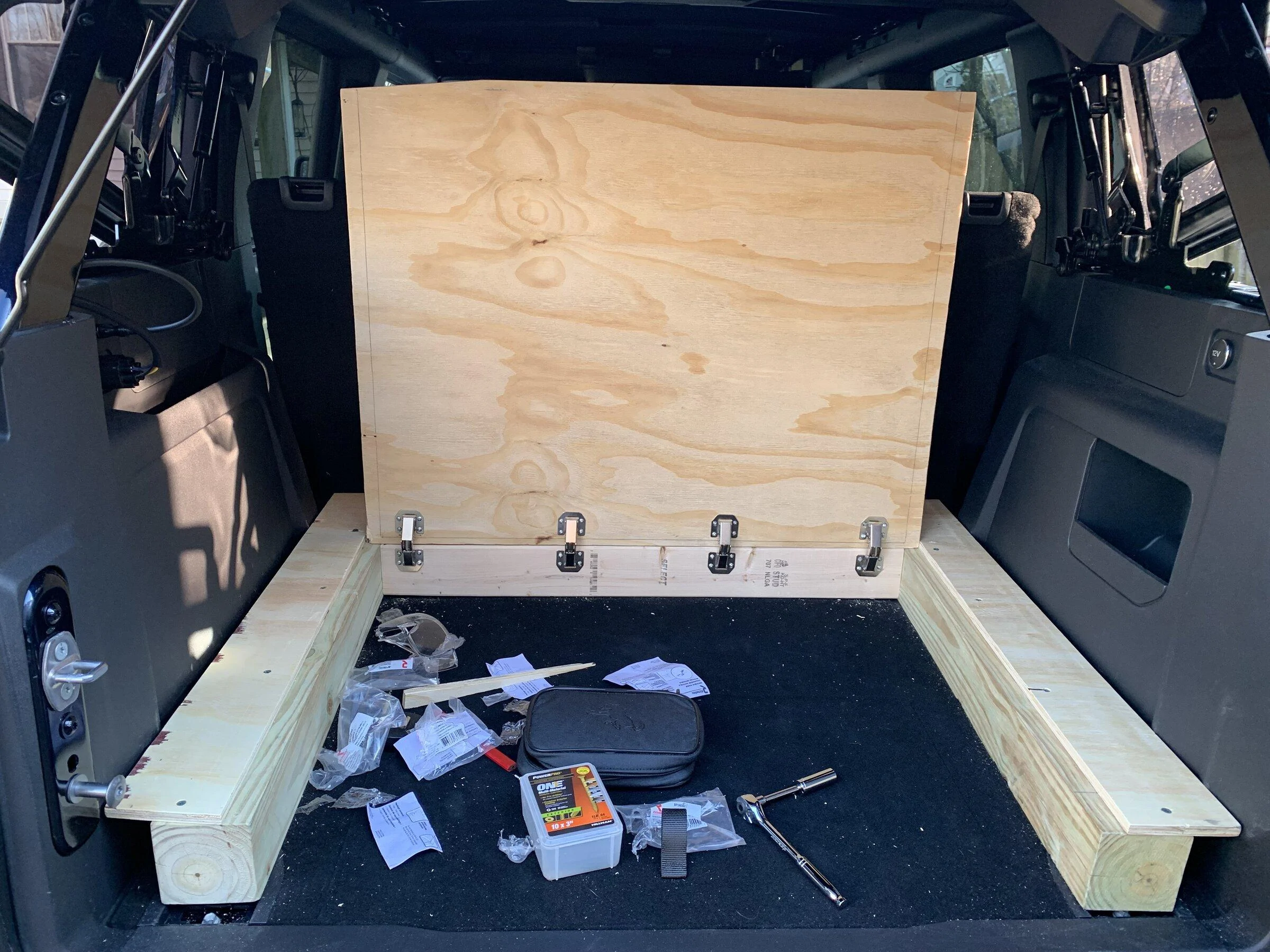

Raised floor is 1/2" plywood with hidden hinges underneath. The hinges are strong enough that with the four of them installed, it holds the lid open at 90 degrees with no need to prop it up.
Ford Bronco My Own Tribute Build IMG_6443
The only thing left to do is wrap it in carpet and add some flat metal strips to the bottom side of the lid to help keep the top from bowing. I'm also thinking of adding another piece of wood to the lid at the tailgate side to make it completely enclosed and adding a lock to the drivers side frame rail to make it a little more secure.
I mainly just wanted something to help level out the floor with the rear seats down and a place to securely store things like a window bag, folding chair, etc. when not in use while also still being able to access the OEM storage underneath. Will also be adding the factory cargo tie downs to the new "floor" when it's done. It won't be Fort Knox but it will help deter smash and grab theft and give me some piece of mind if I take the top and.or doors off for extended periods of time.

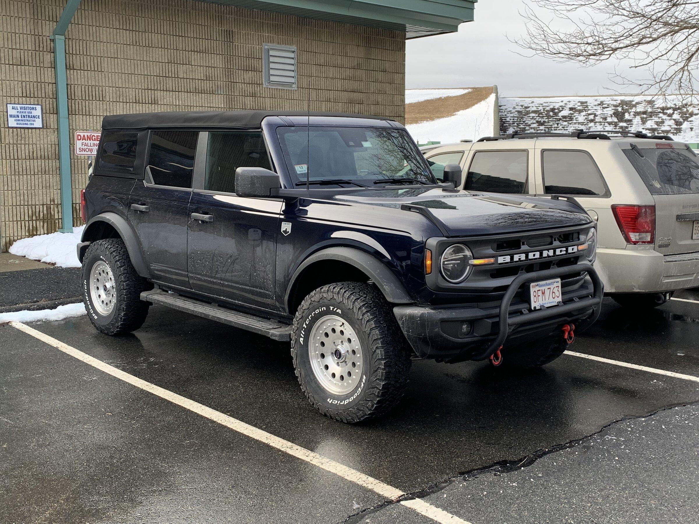

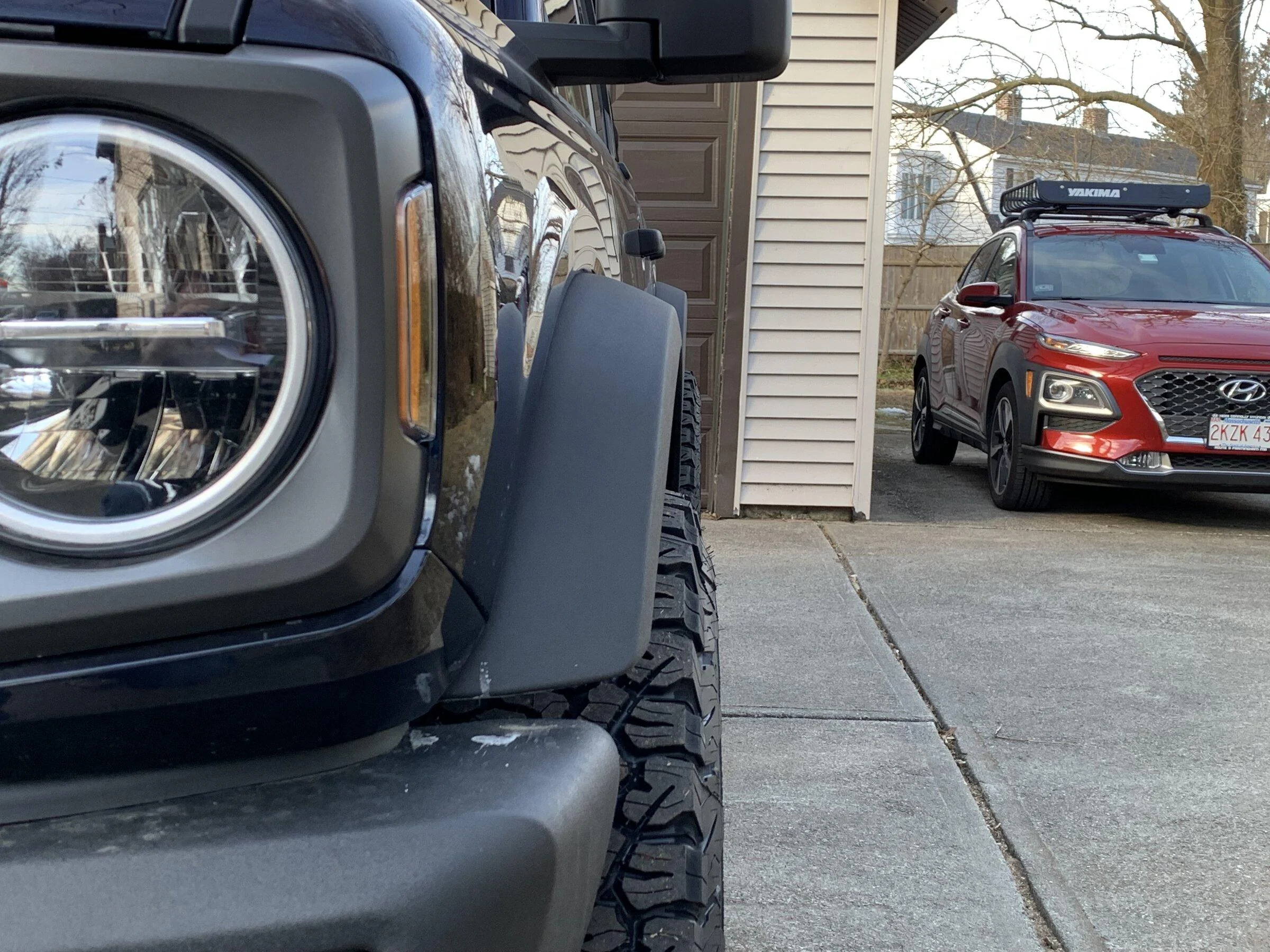

Yesterday the Rough Country 1" leveling kit went in.
Before:
After:
I was looking at those exact same wheels to swap out my black diamond wheels when it arrives. How do you like them have you encountered any issues? Your bronco looks sweet!

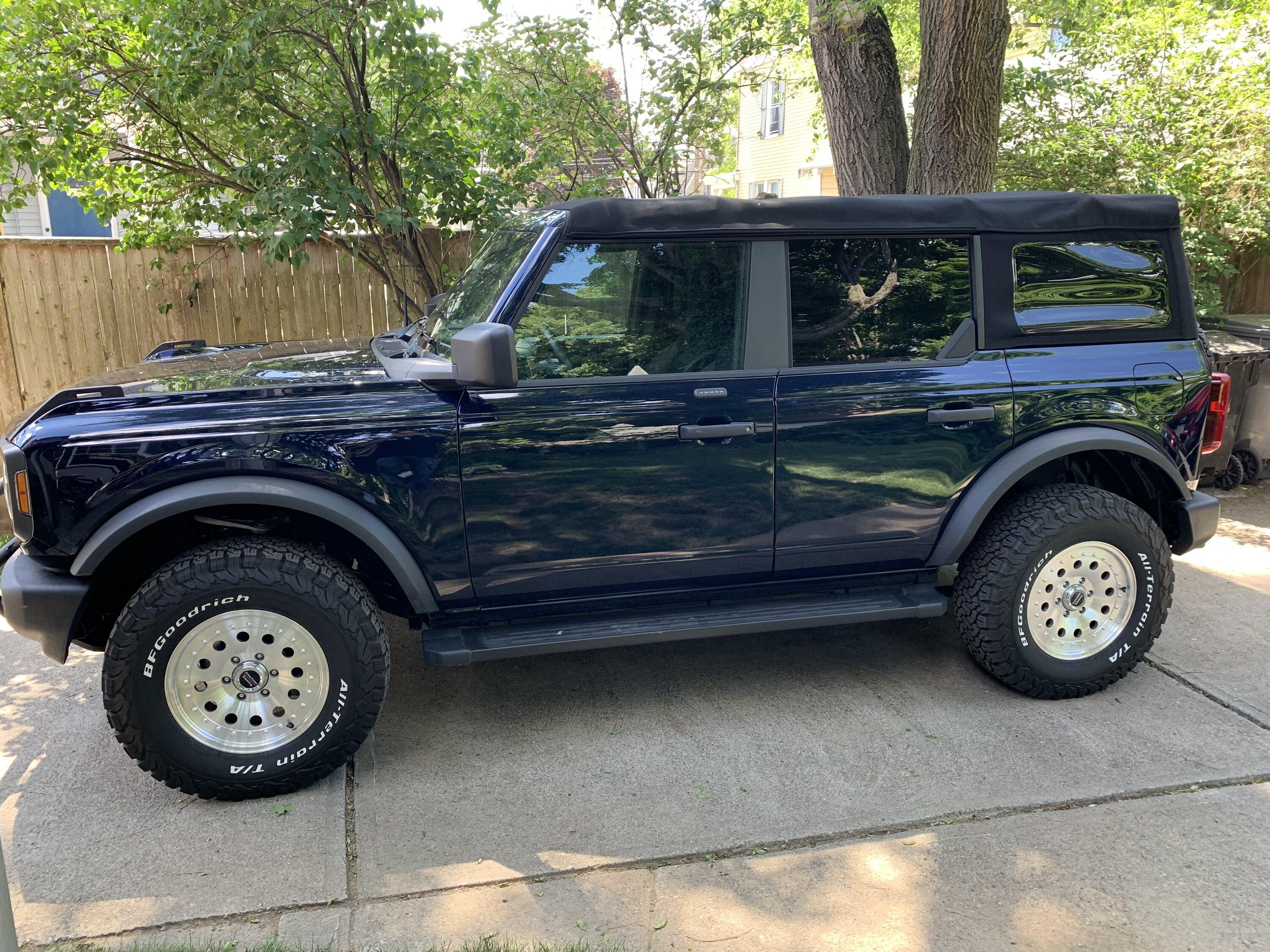

Thanks. I love the wheels. This has come up in a few other threads here lately but if you are going to get the Outlaw II's you need to get the +18mm offset. They have a +30 but the hub bore size is too small for the OEM hub. The +18's are bigger than OEM but with the correct lug nuts it hasn't been an issue for me. You can't use hub rings since the center caps are installed from the back.
Thanks for the reply, what issues came up with the lug nuts? I take it you cant use factory ones
The factory lug nuts are too short so you won't be able to get the wheel to sit flush. At a minimum you'll need 1/2" longer acorn style lug nuts. I used what are called "ET Style bulge acorn" lug nuts. They have a 60 degree taper (to match the same taper in the wheel lug holes) and also a shank below that which helps to center each hole on the stud. They look like this.

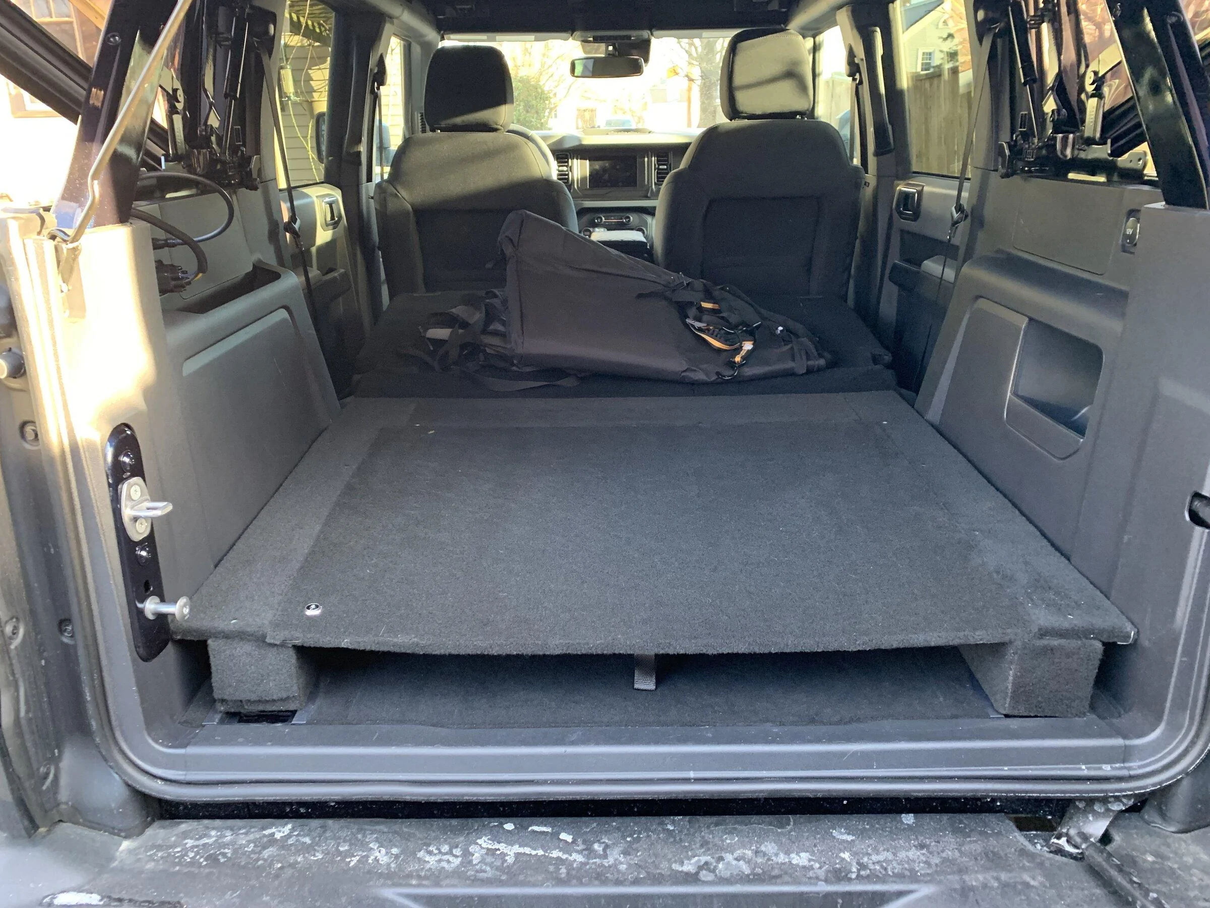

Finally finished and installed the rear floor leveling platform. Wasn't really interested in putting in a drawer although I could later if I decide. The hidden hinges are strong enough to hold the cover at a 90 degree angle. There's a lock on the driver's side as well to prevent people from walking off with anything in the back and to help keep the cover from bouncing up and down while driving. It also still allows easy access to the jack and under floor storage.
I'll be bolting the factory tie downs to the cover at some point.

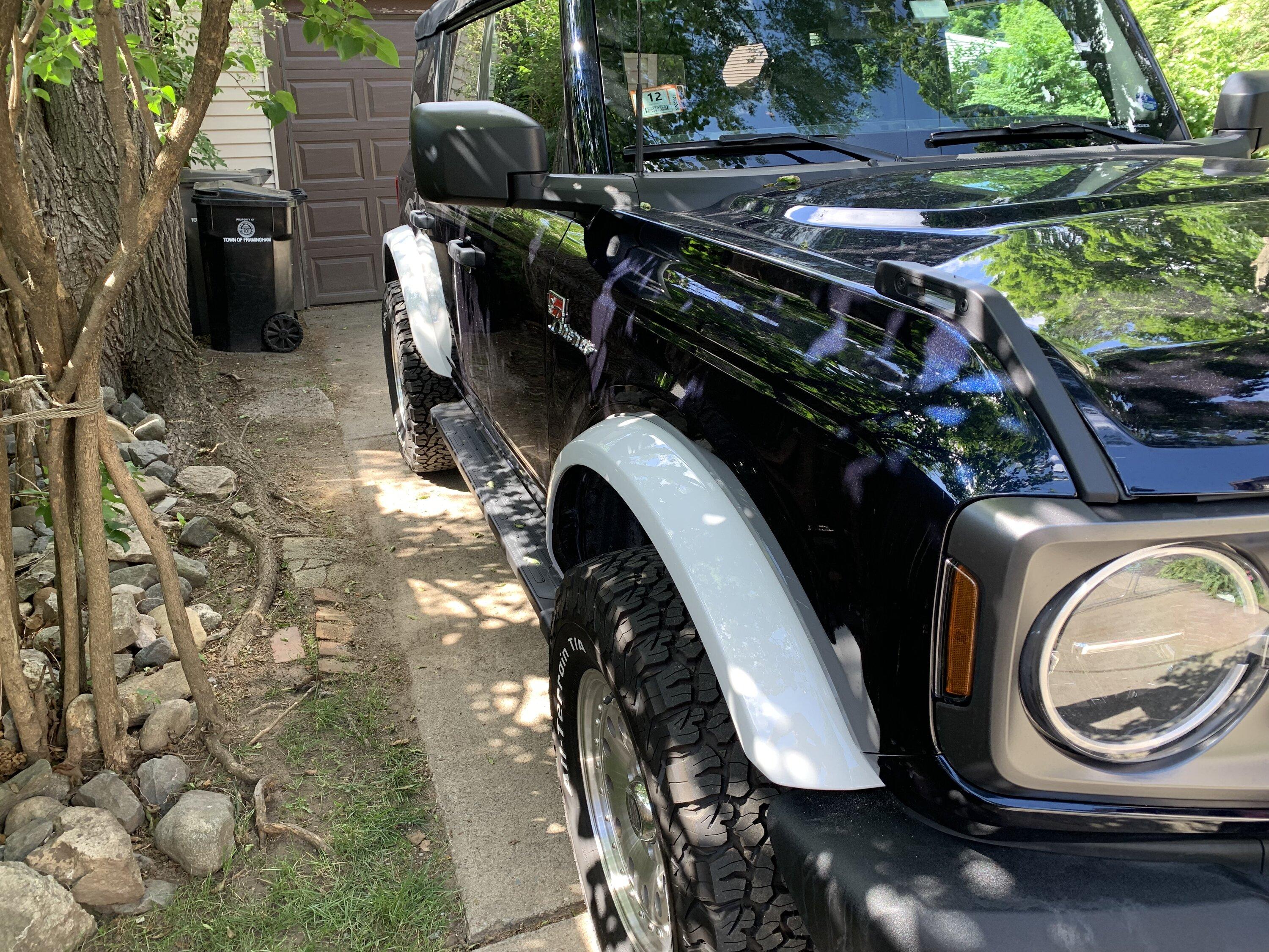

Finally have another major update after getting my Bronco back a few weeks ago (body shop purgatory for two months after a small fender bender).
I've done some small things (adding a trailer hitch and getting lights ready to wire in) but today I got some large, noticeable items installed.
I bought some Cyber Orange OBX flares from another member and had them painted Oxford White. Got them back today and installed them right away. I still have my original flares so can change back easily if I want to.

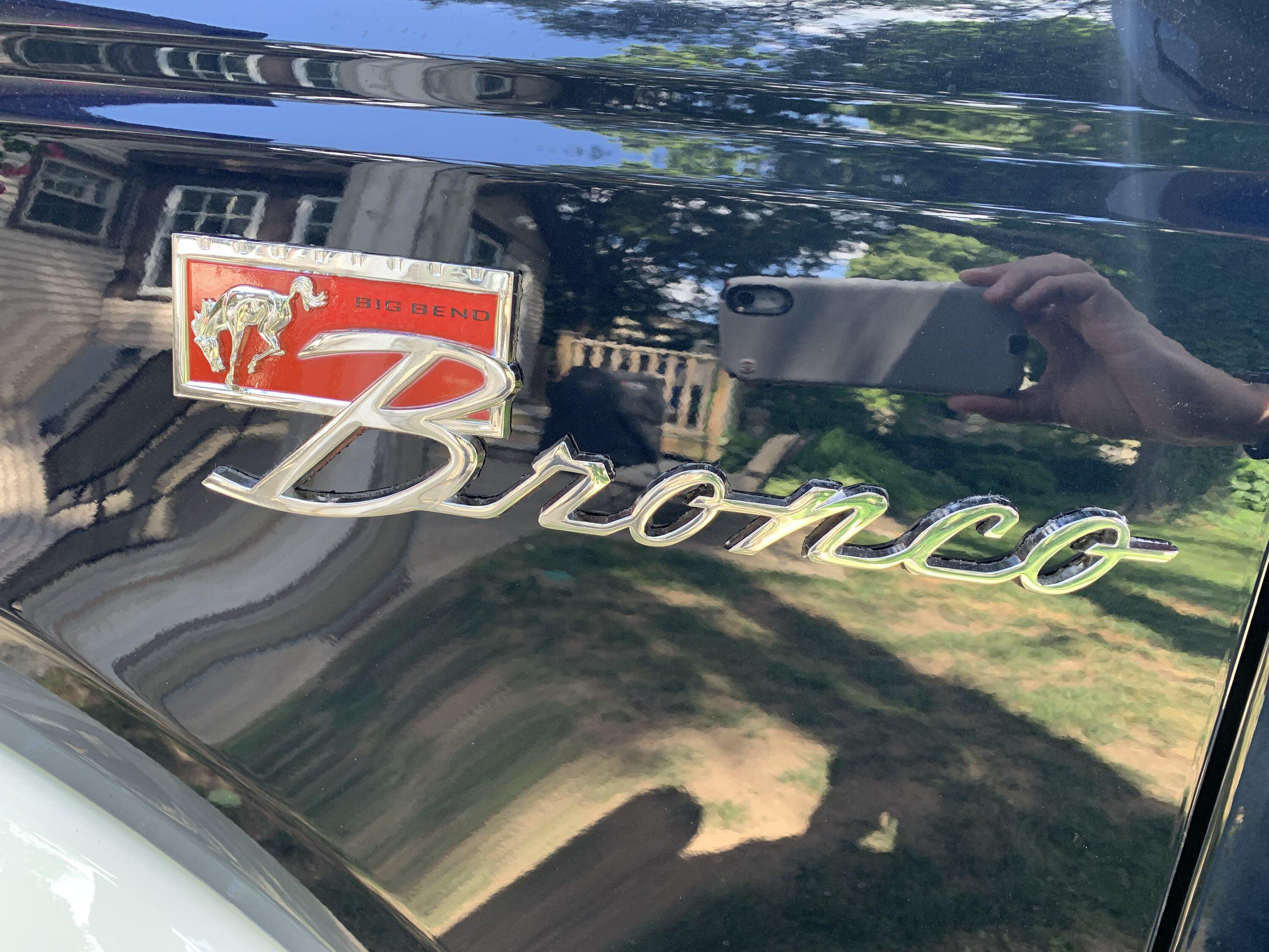

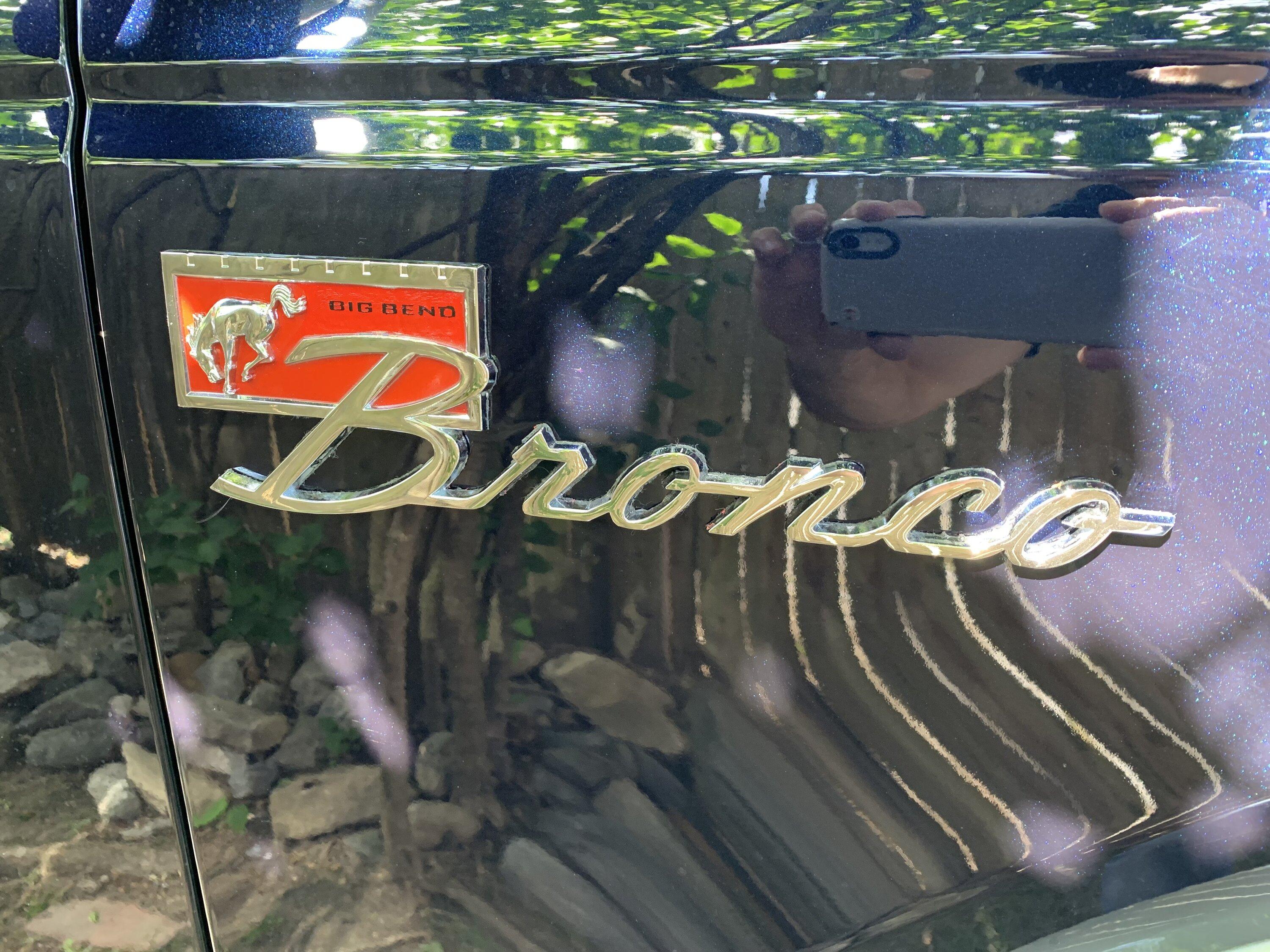

I also installed my OE sport emblems that were modified by removing the "sport" and painting in Big Bend. Trying to blend the old with new.

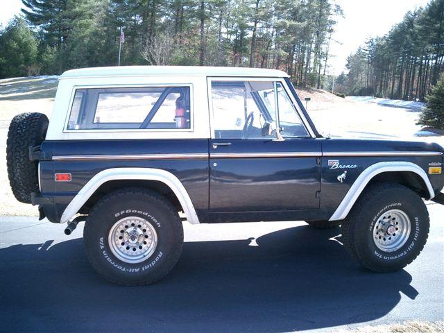

I know I'll probably get crap for the white flares and retro badges from some but I personally like the white flares because they make the AMB pop more than the black. My goal was also to recreate my old '71 which had a ton of sentimental value to me even before it went up in flames. I think I've accomplished that pretty well.
