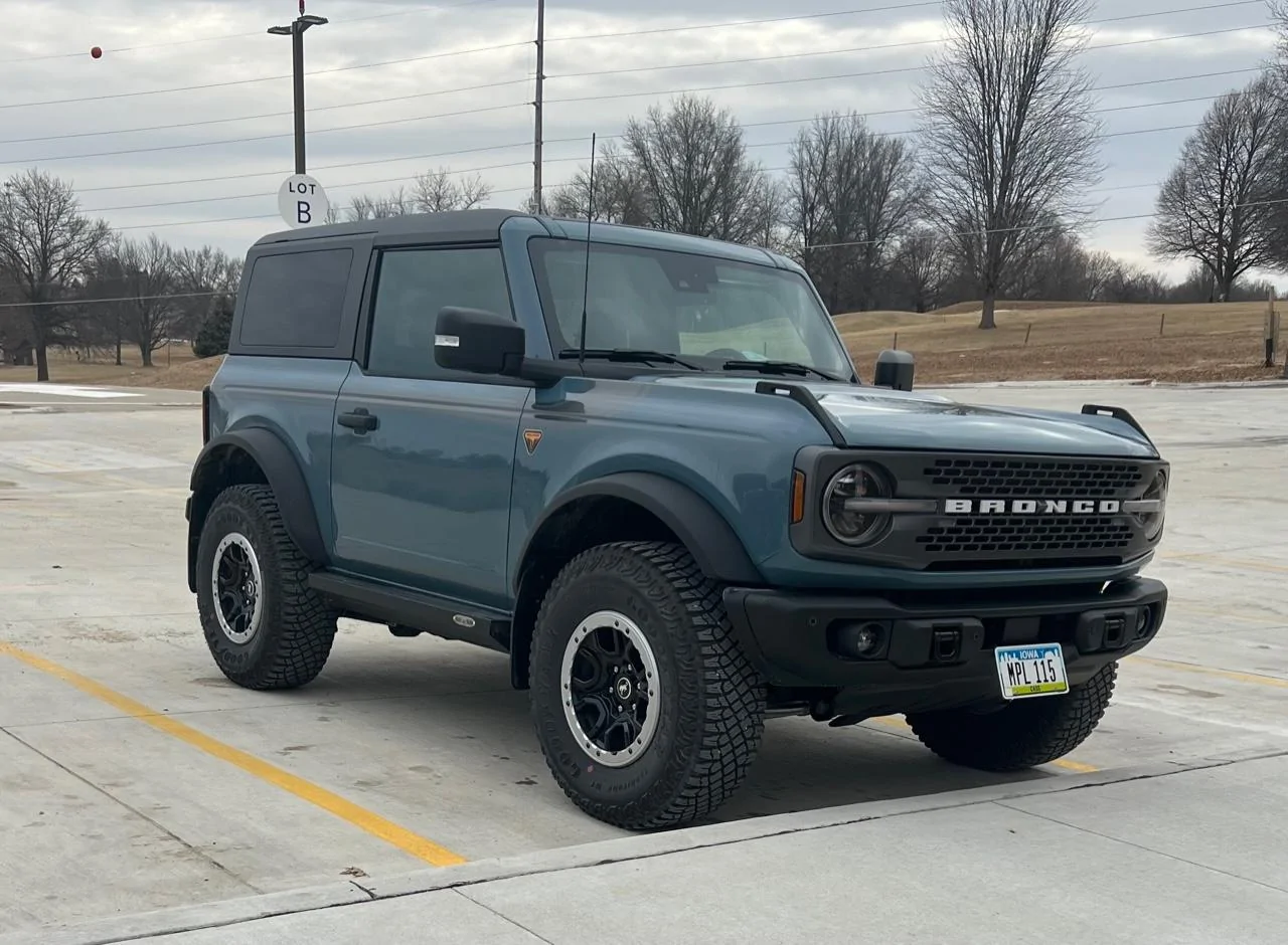

well, since my last issue, I got my new RSE stepslider steps. I put them on the 30th of december about 2 weeks after I took delivery. to install them I had to run the power and ground wires directly to the battery. and I had to bolt the on off rocker to a bolt near the fuse block under the steering wheel. I made sure all my connections were secure. the ground wire on the battery was not super tight, but it wasn't loose really, and I pressed on all the fuses under the steering wheel also. I don't know what was going on, but since the installation I have had not one glitch. the full screen apple carplay download happened thursday with no incident, and I have taken the bronco on several long drives and over some relatively rough roads and so far it has been over 2 weeks without a glitch. I am guessing that battery ground was just not quite tight enough. either way I am optimistic. I guess I will cancel my appointment in the morning. I am loving this thing. it is a blast to drive. and I am so impressed with how the suspension handles the rough roads.
