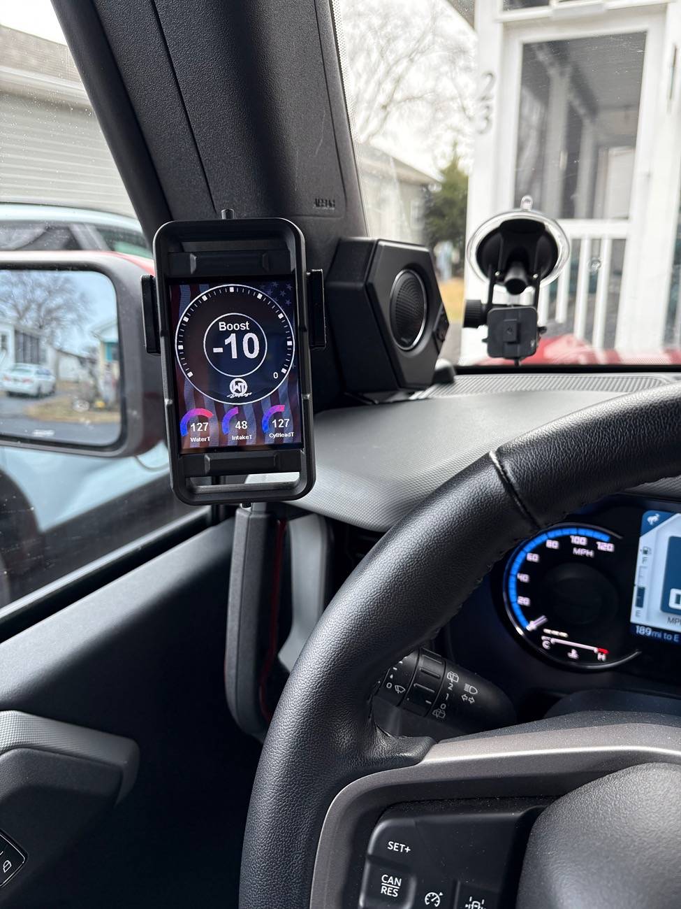

very nice. I just edited the images in the backgrounds. A lot of customization with the program which is pretty cool. Need to replace their logo with a horse or sasquatch ha

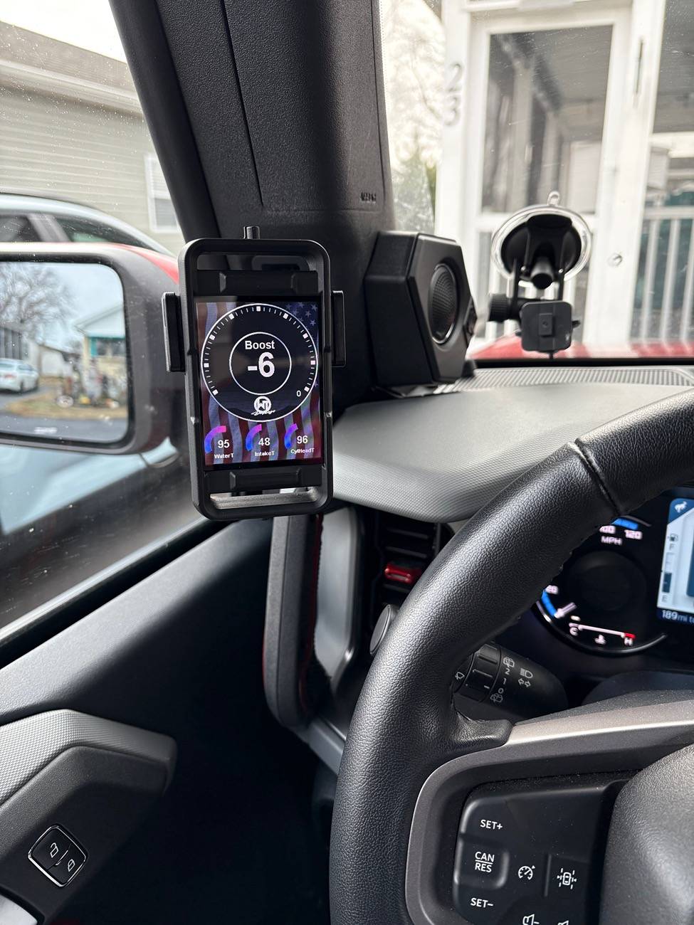

My MacGyver job. I mounted it to my procal until my cell phone mount arrives. I had to use a Micro fuse tap. I used fuse 2 under the steering column. I know it's hot on ignition. I placed a piece of foam between the display and the pro cal to account for the wire connectors and cut out a channel for the OBD cable. Now to figure out how to set it up.

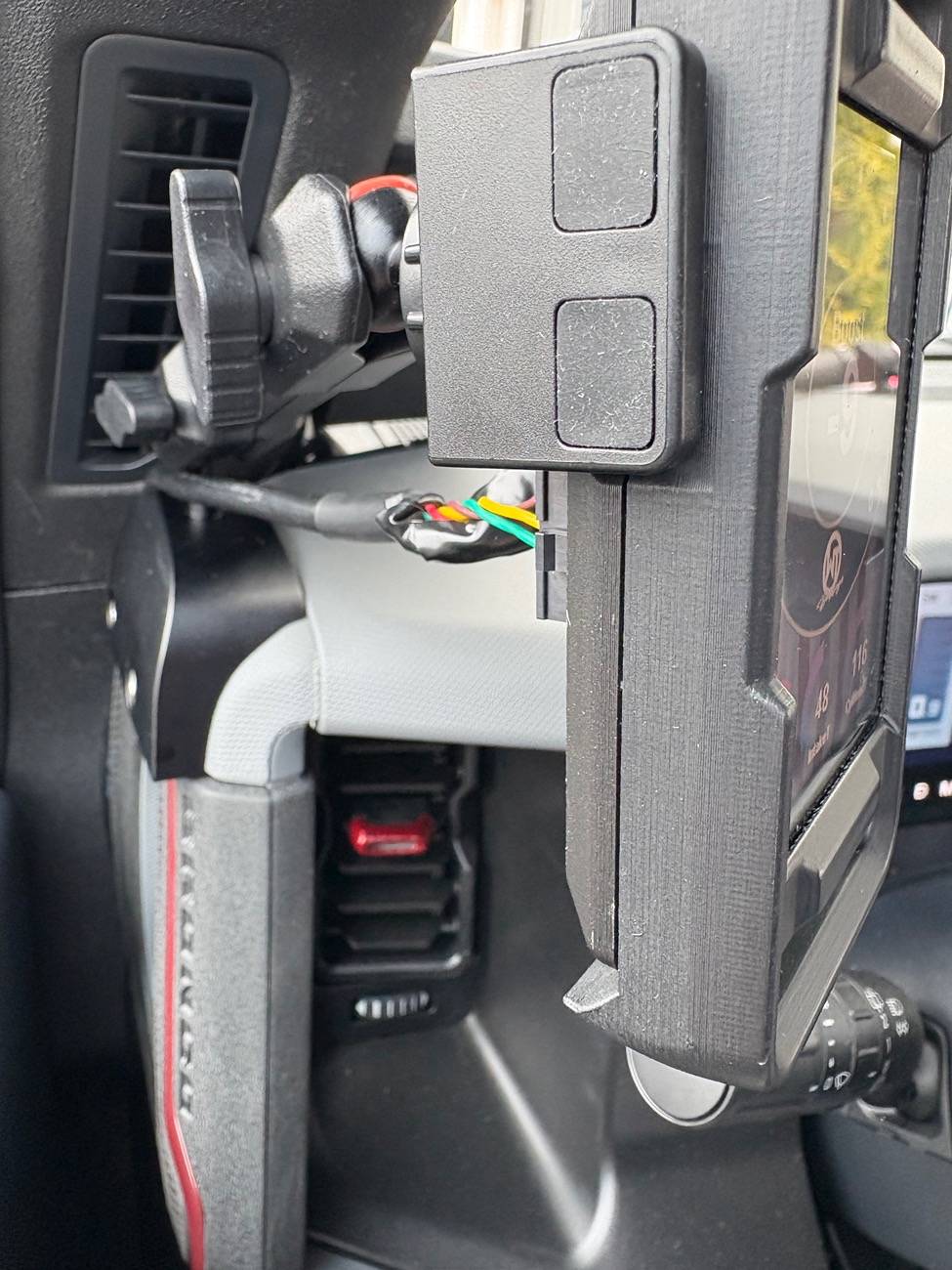

Can you expand your wiring setup. I see the OBD cable and the red wire with a separate crimp on fuse-wire in the kit.

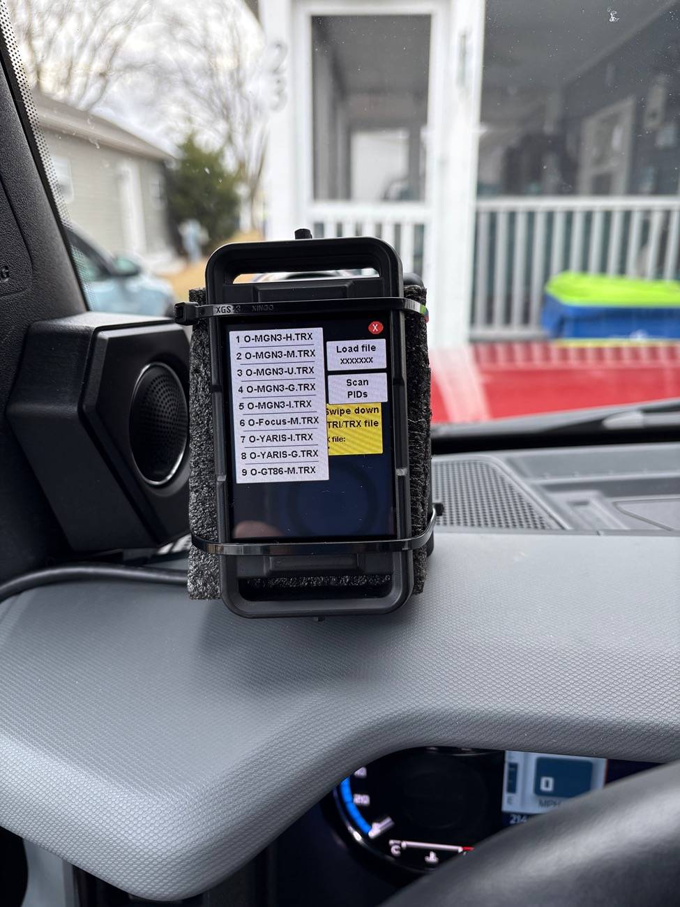

And I see a bunch of TRX files that look like they might be right when I plug it in to my computer. Any idea what the differences are between:
66 O-BRNC-G.TRX German Language, Metric
67 O-BRNC-H.TRX Canada, English, Metric + Imperial
68 O-BRNC-I.TRX US-English, Imperial
69 O-BRNC-M.TRX US-English, Metric
70 O-BRNC-U.TRX UK-English, Metric + Imperial
RESOLVED.
I ran the red wire from the OBD connector to Fuse 2 on the BCM. I needed a mini fuse connector I could not use the supplied pigtail. There are not many ACC fuses in the BCM.

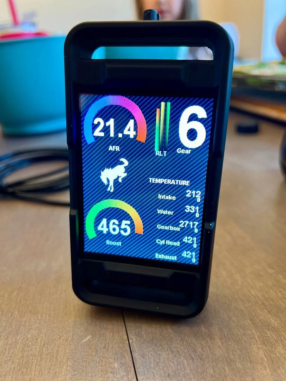

Gents this thing is neato. I’ve got more of the waiting game re my bronco but with the software, here’s what I’ve configured so far - not sure which sensor options are dead ends or not for now though.

That looks great. I have played a little with a new page but haven't with the colors or added logos.
