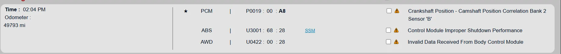

These codes popped up again today. Idle sounds clean. Not noticing a loss of power or unusual noise under acceleration.
Plan is to check the Crankshaft position sensor, possible I missed cleaning it on the first sweep. That a sound 1st step for this code?
