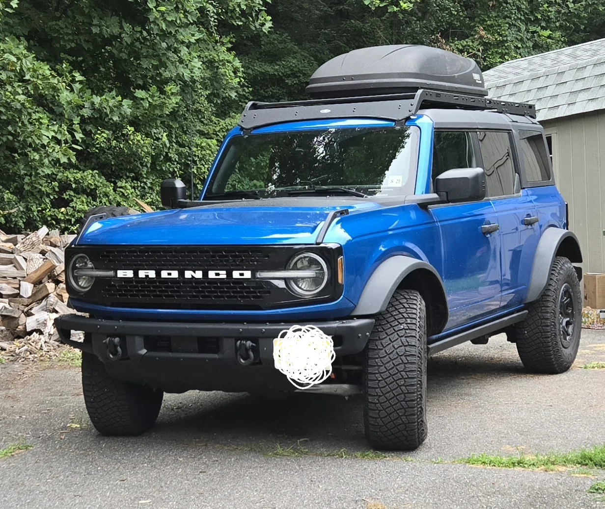

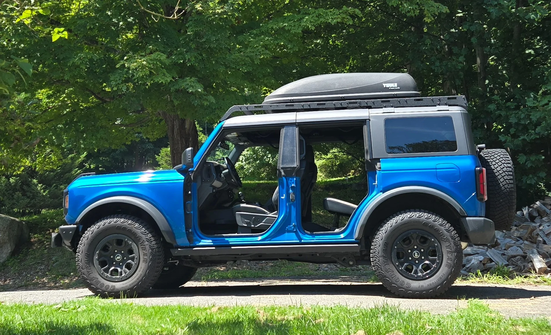

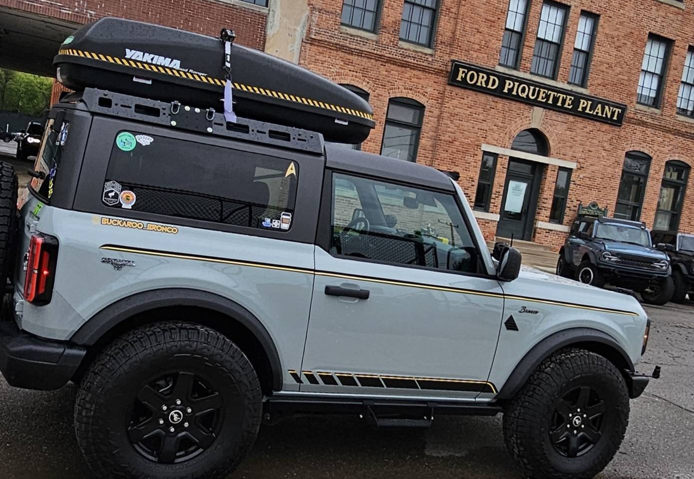

Yup! I have a Yakima box on a TurnOffRoad half rack and I love it. However, I admit to some nervousness regarding having a box on the roof. Past experience seeing a box get ripped off a roof (no rack involved) and a general lack of faith regarding how racks are mounted to Bronco roofs. To offset those issues I keep a ratchet strap over the box (for what its worth). Also, the box will affect your gas mileage considerably. At long duration highway speeds I get as little as 13mpg with a 2.3L.

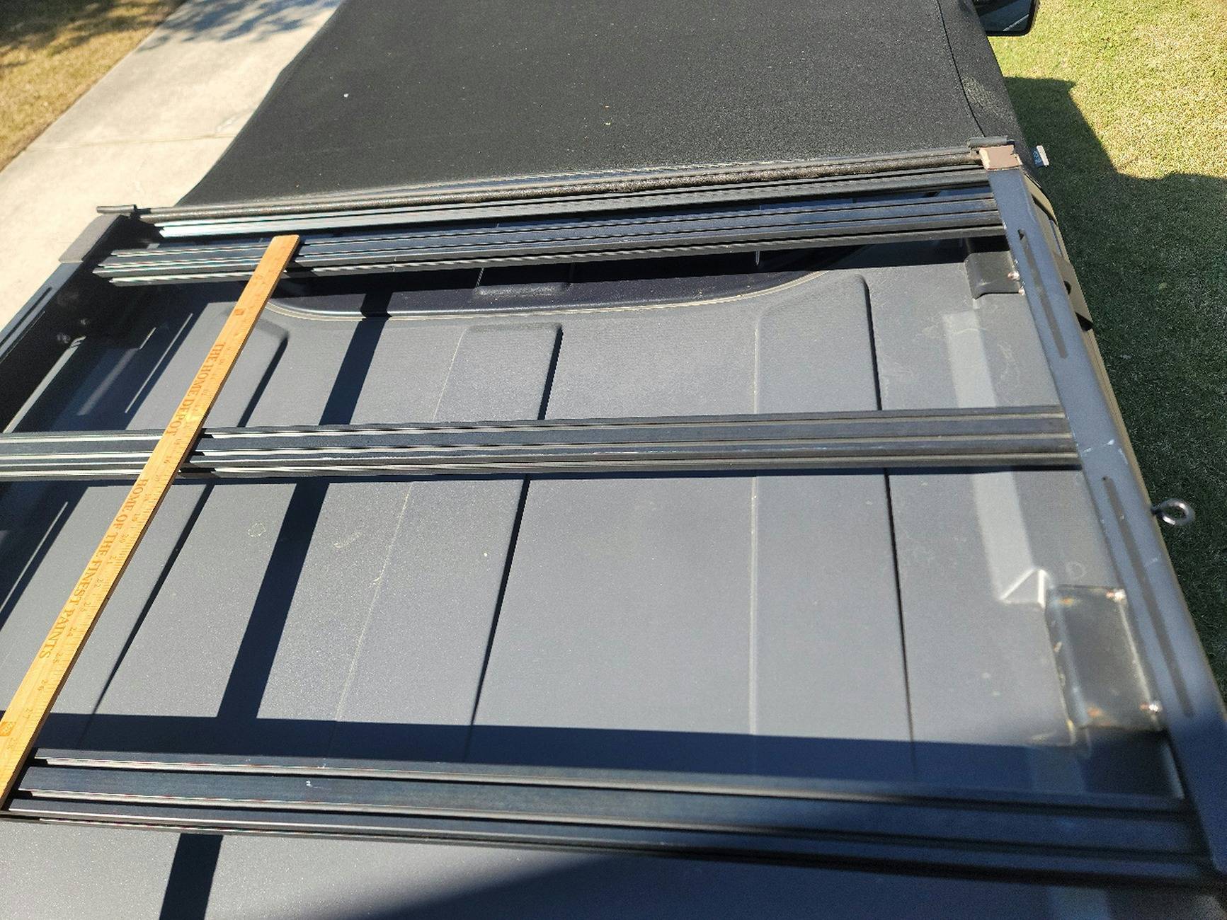

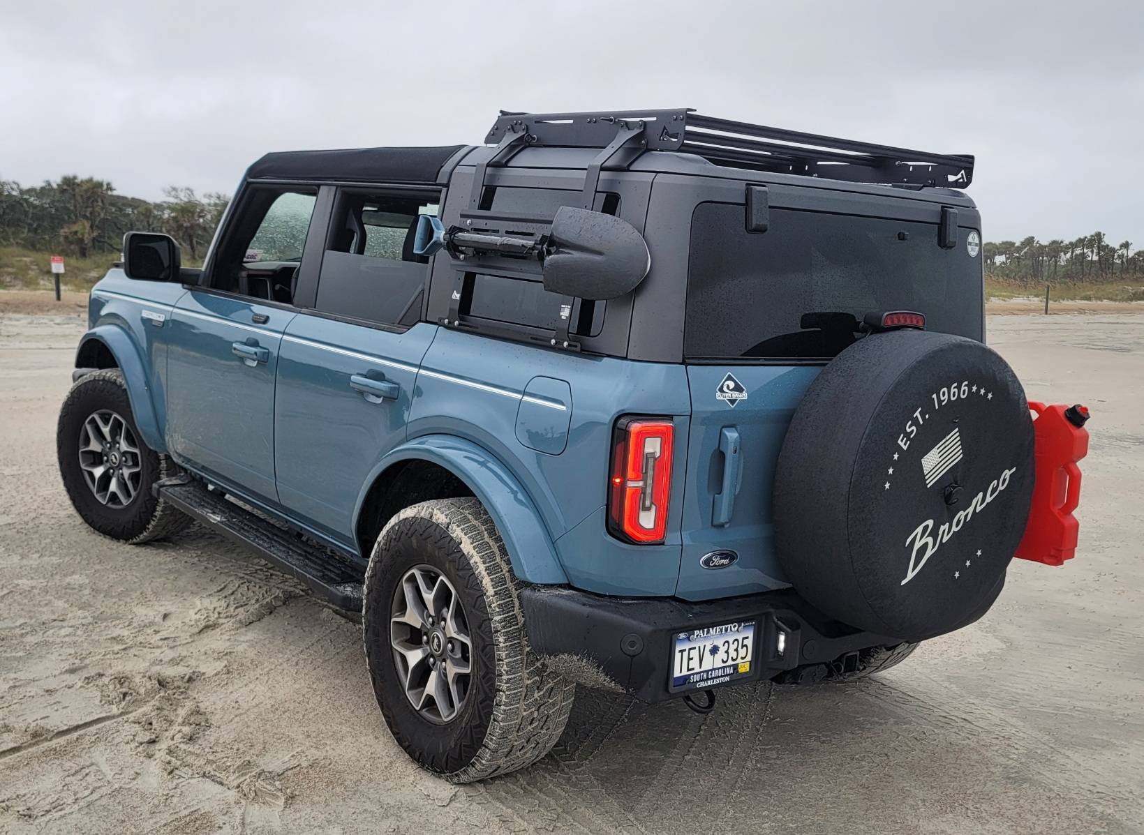

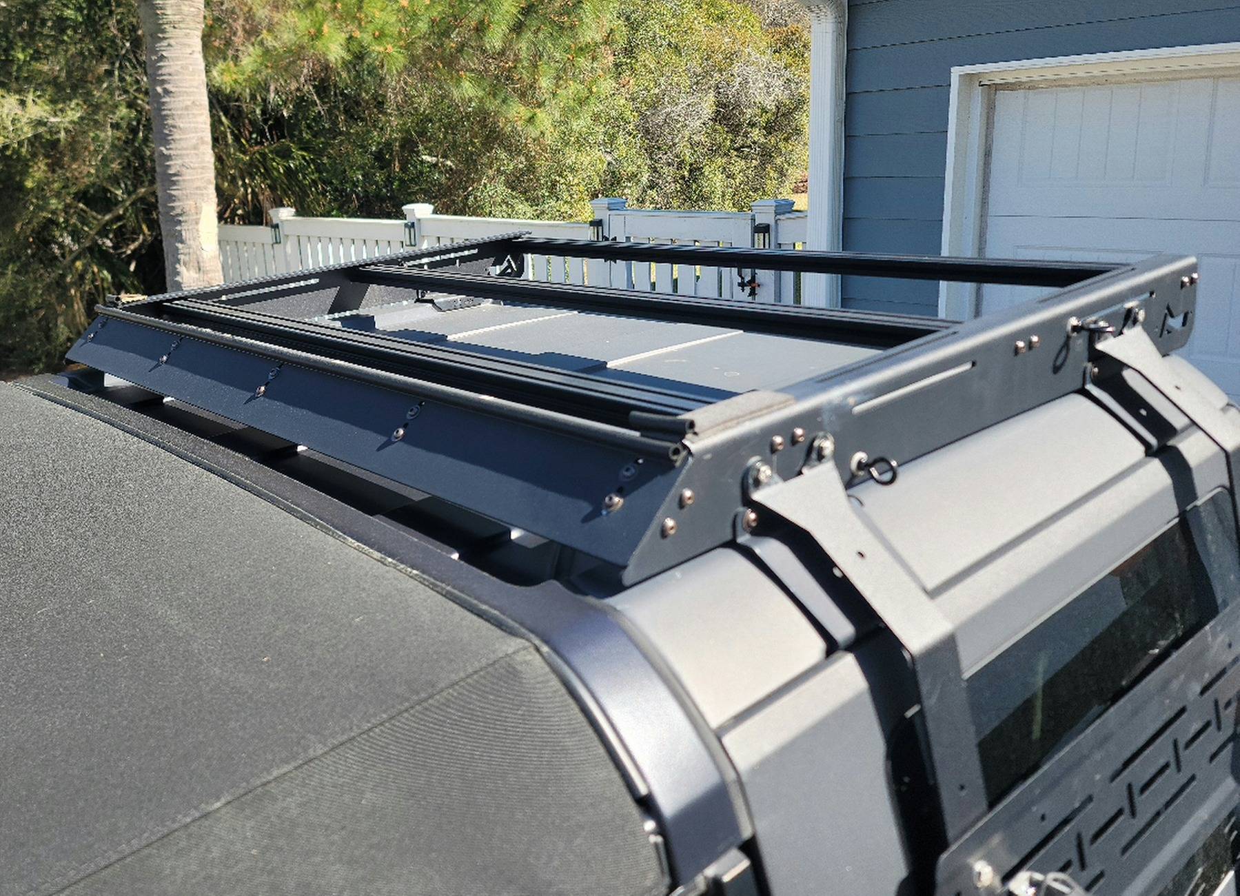

Which half-rack are you talking about? There's the OEM rails, and what I have, the TrailRax Half Rack. Then there's the rack space above - how much do you want to use, as well as weight capacity/load stability. When you put a container above, you also impose on the midpanel and the ability to remove it. With the TrailRax, the side racks add additional weight capacity and load stability, as well as storage for tools.
The Top of the TrailRax is 48" x 36". But the front rail supports the wind foil. Attachment space from the front of the second rail to the back of the 4th rail is 30".

Good luck, and post what you do. I have not installed a box on my TrailRax half-rack so far, but I wanted you to see the dimensions. I use it for side-saddles and tools, to tie items to on the beach, and I plan to semi-permanently mount a solar panel for my Dometic Frig and PLB40 battery which live in the back.
In 2021/2022, TrailRax was the only rack available. There are others now, which others give good report on. Such things are very specific to the owners needs. For me, this unit is perfect. When I don't have the Skyrider installed, I can store the mid-panel on the half-rack when on the beach.

I’m late as hell but what model box is this?
Umichigan1
Sep 13, 2022
384
345
2022 2-Door Bronco
To be honest, this model of box is not likely sold anymore. It's at least 20 years old. It has had a long life on a few of my vehicles.
