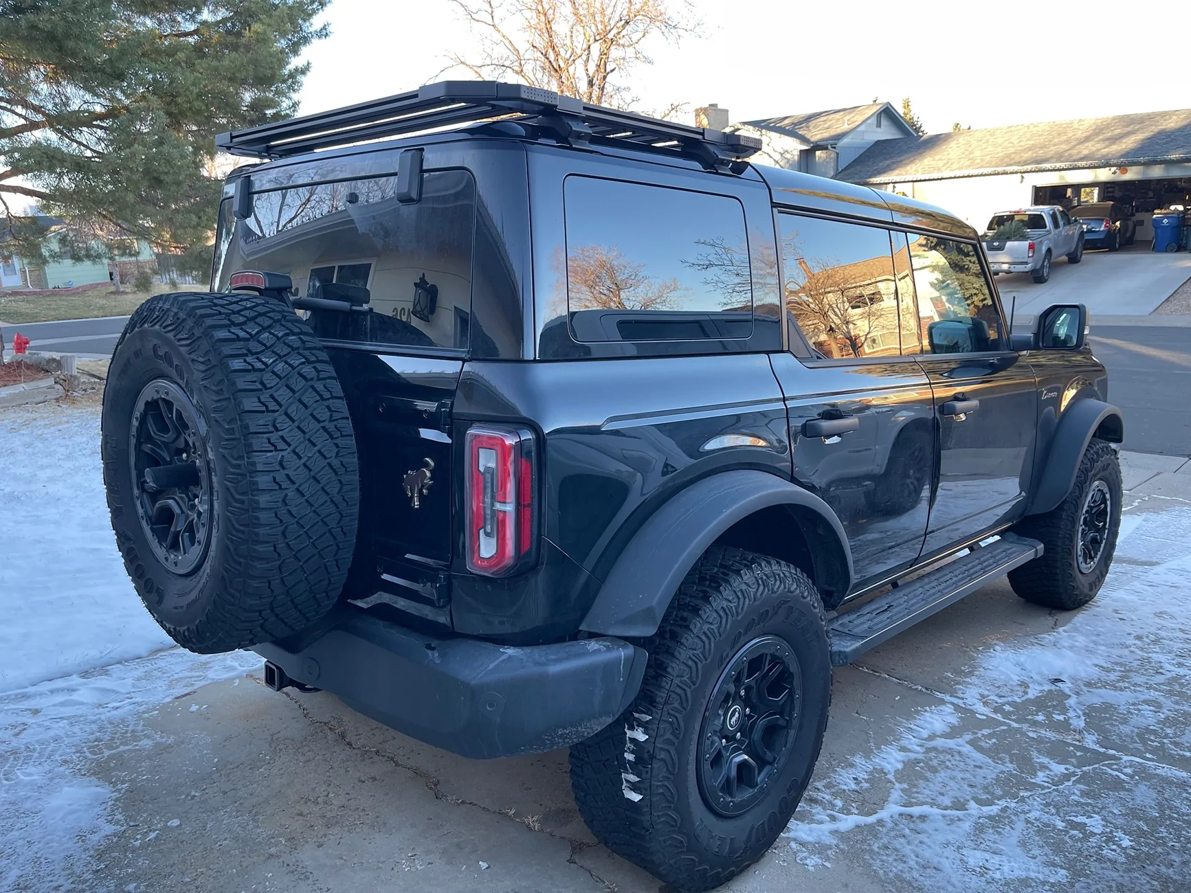

We have this half rack https://a.co/d/e9SjH22as I didn’t want to make it difficult to remove top when we wanted to. Haven’t put our Yakima box up there yet but I have used it for ski/snowboard rack and my snowboard sticking off the back some didn’t cause any issues with rear window. The Yakima box we have also has forward/rearward adjustment so should be zero issues when we use it. You are correct about standing more on rear tire but this rack has handles and makes it super easy to climb up onto rear tire of our wildtrak!

I have that same rack. Easy to put on and take off. I step on the corner of the bumper and can reach stuff with the hand holds. But it does create wind noise. I only put it on when I need it.

I also have this rack and have been very impressed. At the price point I don’t think it can be beat. Install was easy and I could easily remove it by myself if needed.
