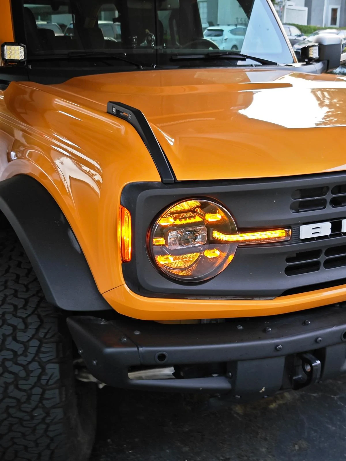

Update.
I got the XB (with deposit)and installed it. The XRGB has been returned and today I get a refund. In general, their customer service is good.
I cannot say I like the XB style better than XRGB but should be more reliable.
BTW, XB wiring is a bit different than XRGB, it is not 100% plug-and-play. You need to connect them to the battery.

Ford Bronco Morimoto XRGB lights shaking IMG_20240608_192448
Oh, one more thing, the height adjustment knob is hard to reach in the XB light. XRGB is way easier.
That.style looks better than I thought they would. If I have any issues with my new ones I may just go with those.
