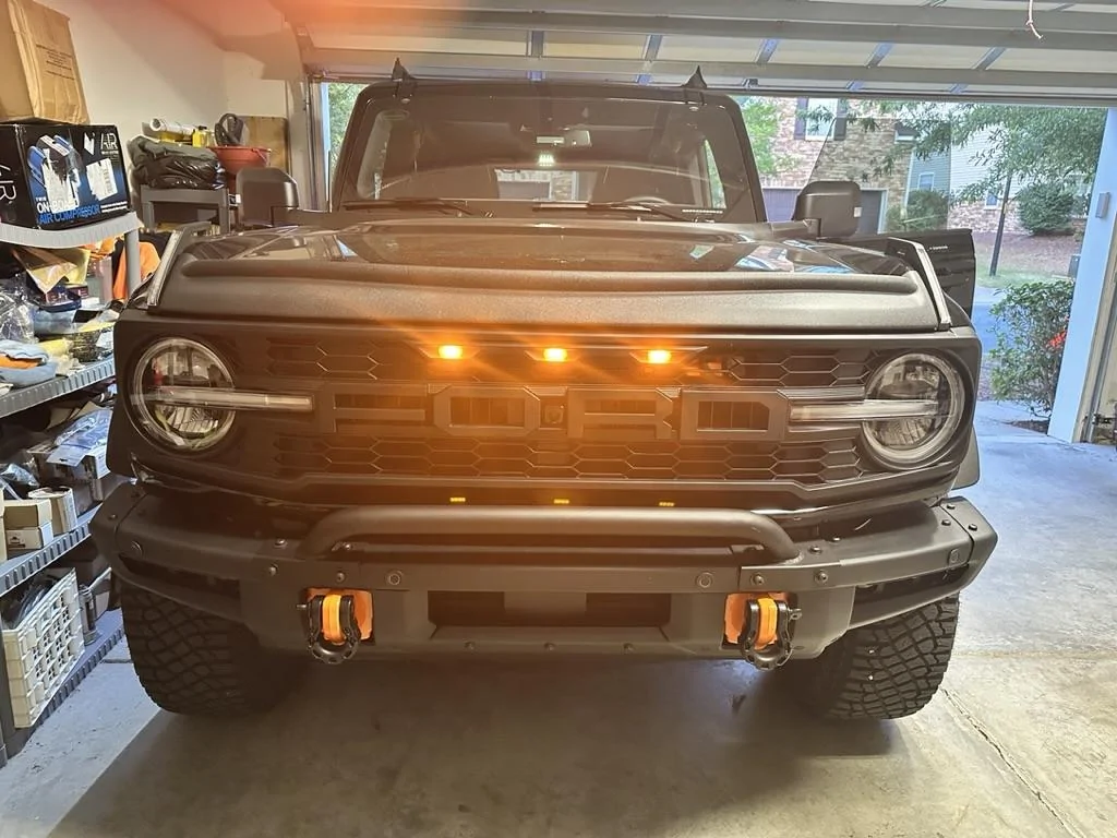

Mine is holding up just fine, I did replace the front hooks with orange ones from Ford Performance.
Ford Bronco Modular Front Bumper Option....sort of B715A4A9-69AE-4F81-B194-5706B13FDA16_1_105_c
The photo also highlights my $165 Chinese knockoff Raptor grille.

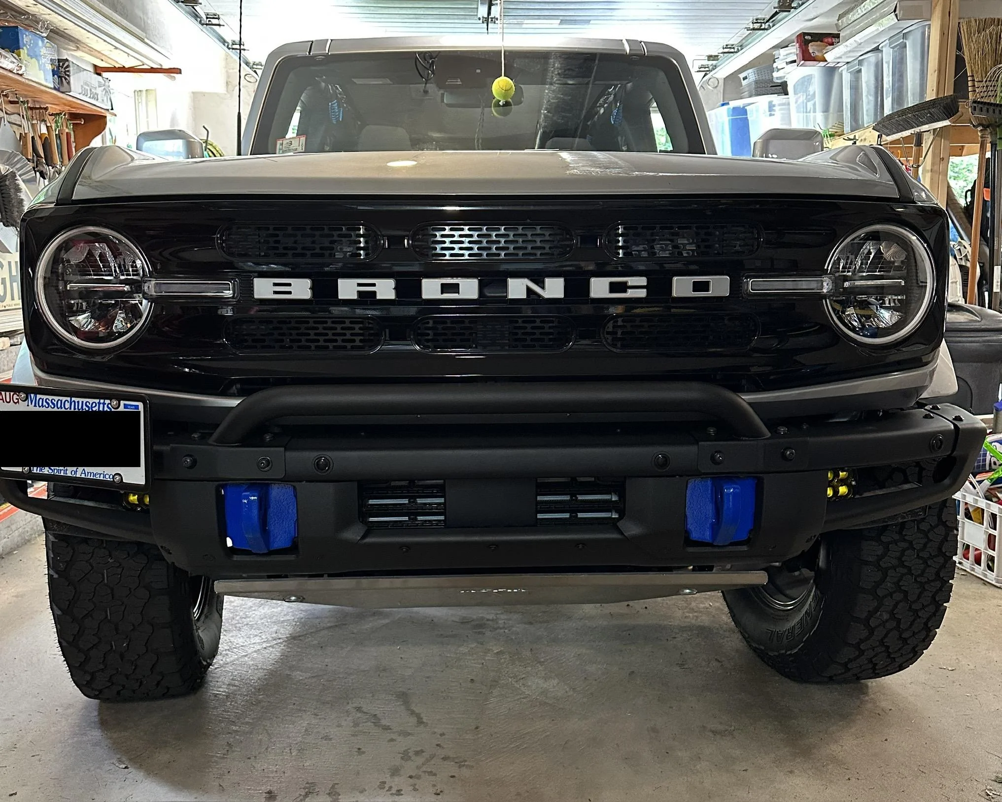

Did the install on an eBay bumper today. Everything lined up nice and quality seems decent.
went with a mabett bar, mishimoto plate mount, ford recovery hooks, asfir aluminum skid, and lights on the factory fog harness(not working yet).

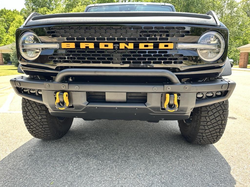

Looks like there are two versions of the aftermarket mod bumper. The first picture is one from EBay that cost 325. The end caps on these are not like the factory ones as in the whole piece comes off instead of leaving the top bar all the way across. I ordered the one in the second pic off Amazon which looks like the factory one.
Ford Bronco Modular Front Bumper Option....sort of IMG_0168
Ford Bronco Modular Front Bumper Option....sort of IMG_0169
j_anderson
Jason
Jan 24, 2021
844
1,479
Fort Wayne, IN
www.instagram.com
full review when you get it installed please!
