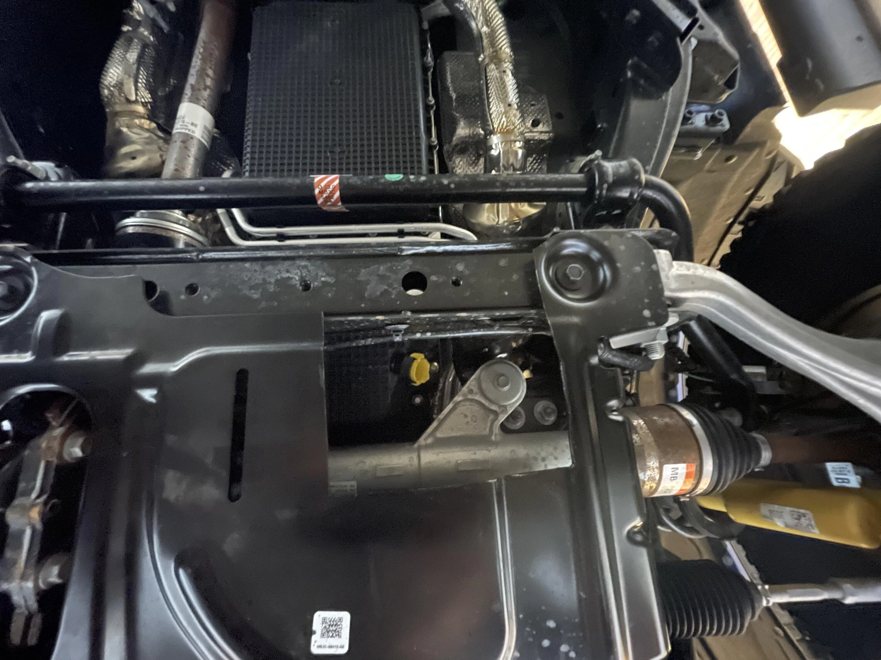

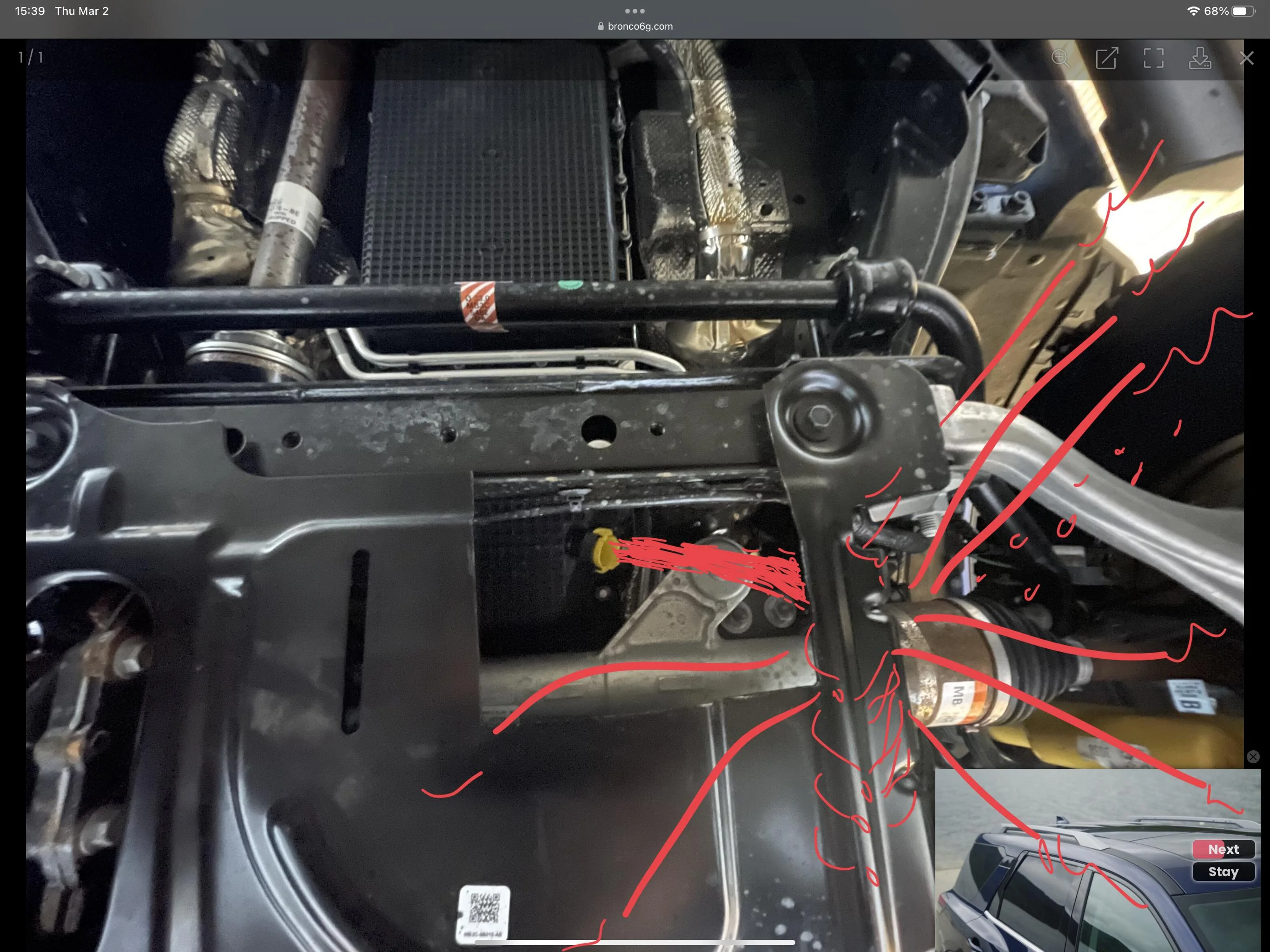

Have you actually changed the oil in this thing yet? With the stock plug (and warm oil) I can tell you from experience you’re not going to get a cute little run down into your drain pan directly underneath the plug. It’s going to end up all over the remaining slim section of skid plate and go everywhere as it comes out like a fire hydrant.. makes it dang near to the wheel.. It comes out so fast I had to modify my drain pan to fill faster. EDIT: added a more realistic photo for you
Yeah, it was a dumb idea, puttting it back like it was.

The drain out happens much slower if you leave the fill cap and dipstick on. If both of those are removed it will drain significantly faster and making much more of a mess.
