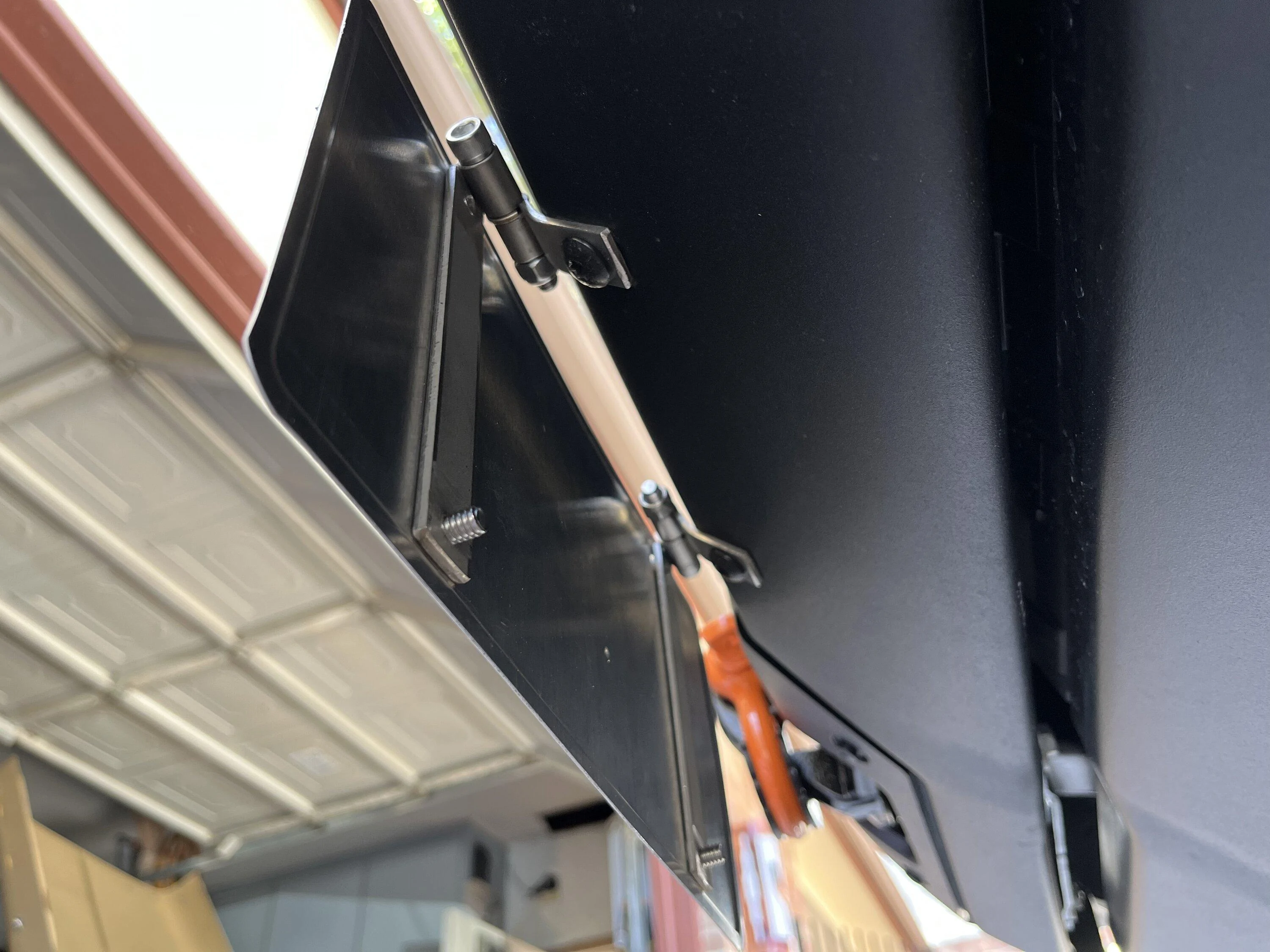

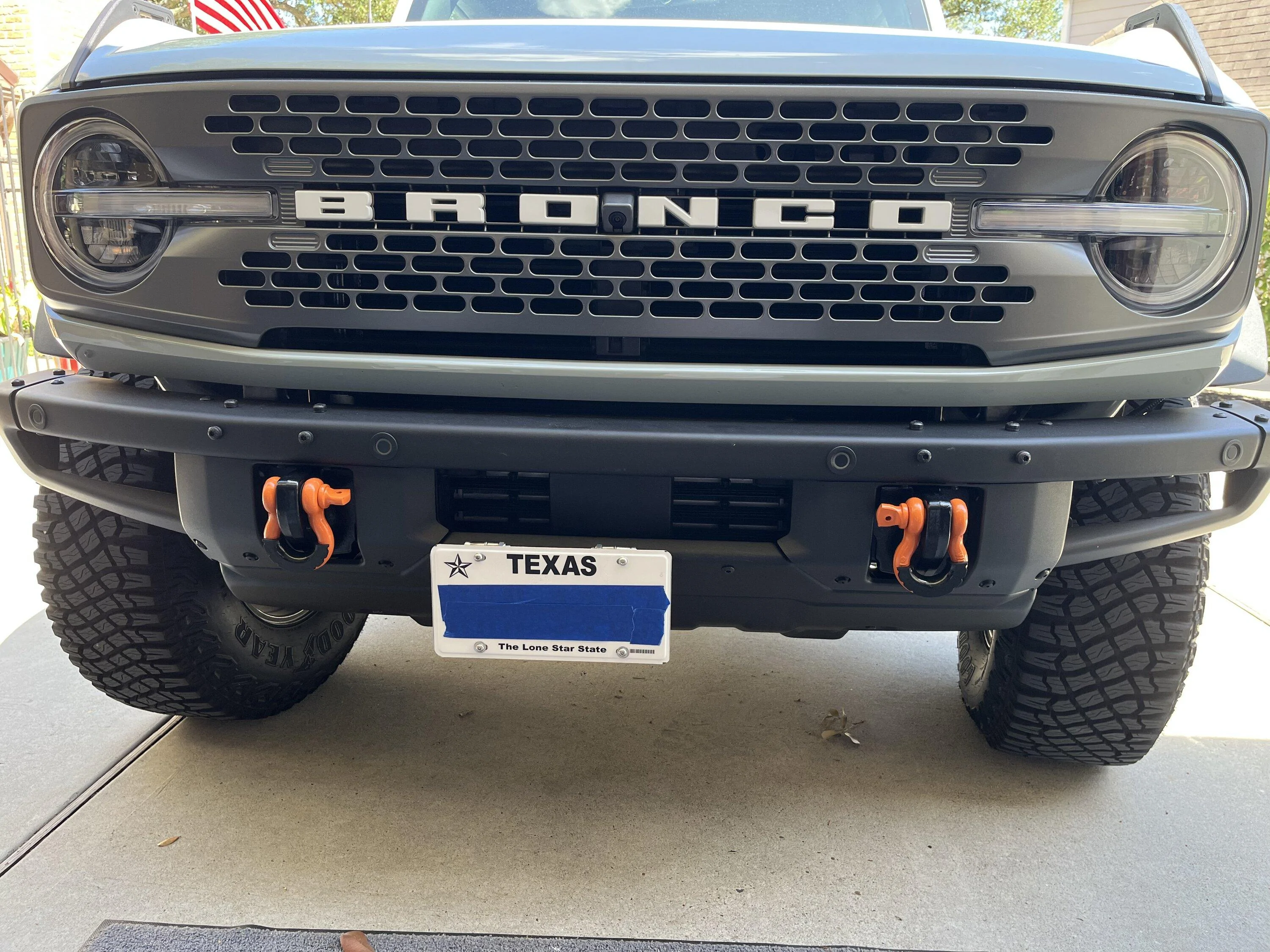

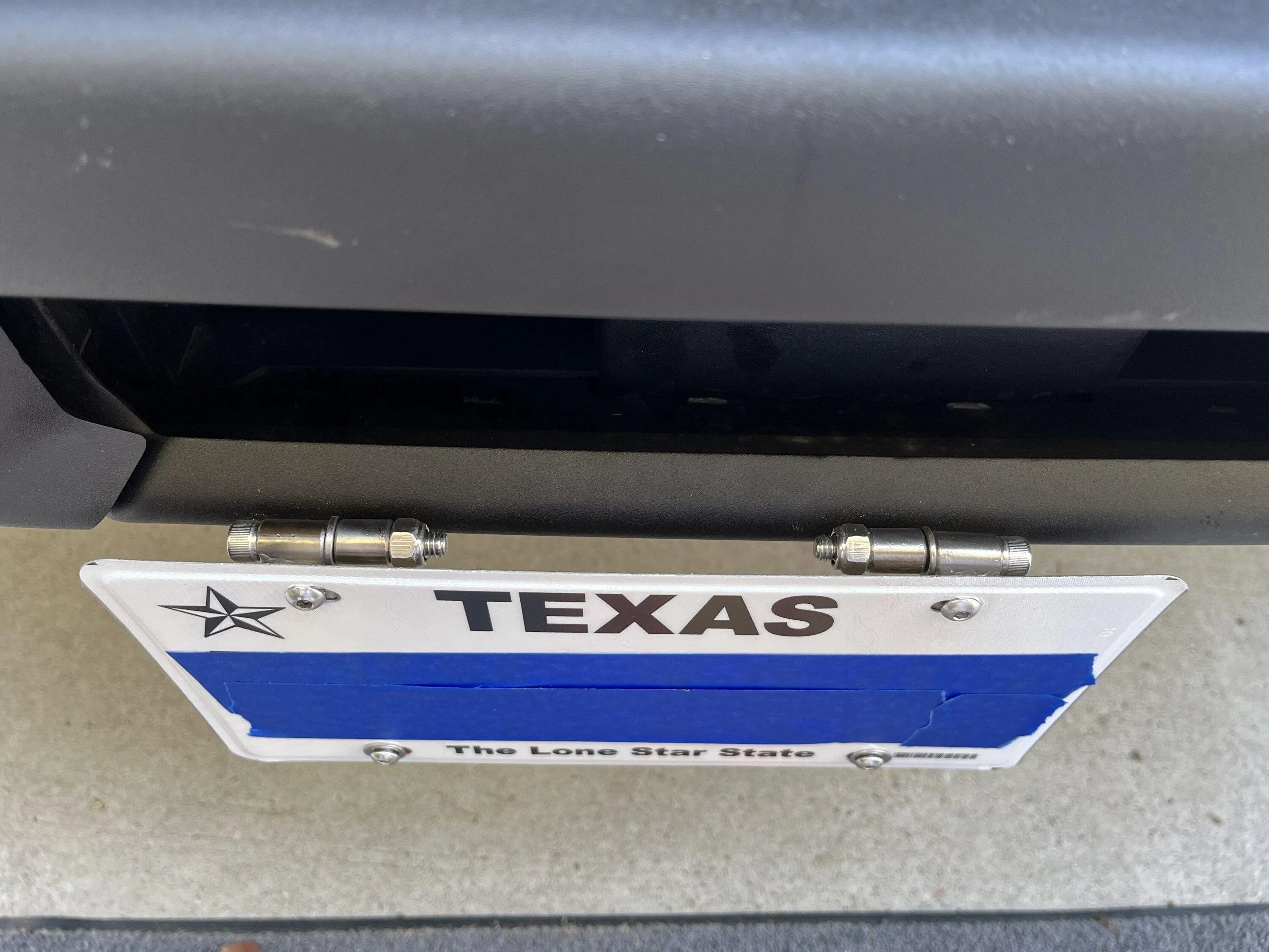

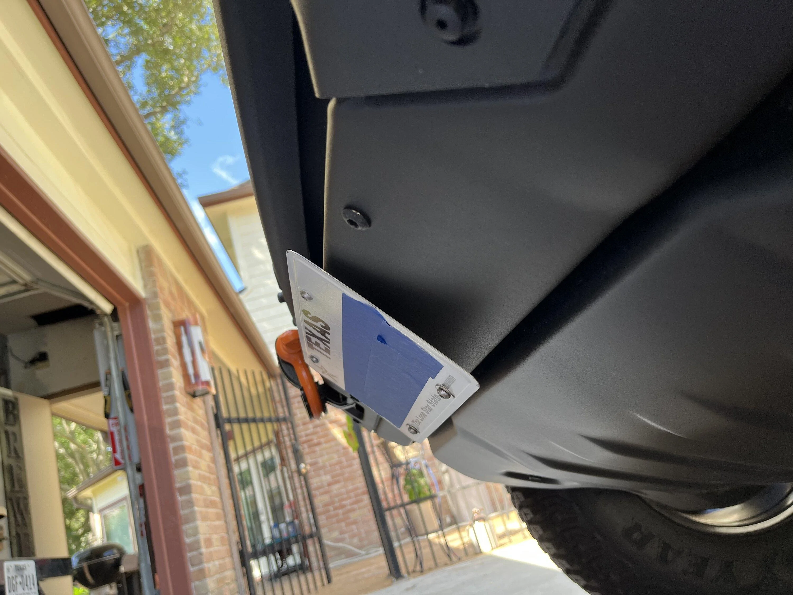

Ordered some stainless flat bar and fabricated my own. My design criteria:
a) Use the existing bolts in the Mod bumper
b) Build a mount that will push back out of the way when required rather than just smash (bash???) the license plate.
Here’s what I came up with:
Ford Bronco Mod Bumper License Plate Mount DIY BB32053C-6FA5-4591-BEB7-233ACF5F8FD7
Ford Bronco Mod Bumper License Plate Mount DIY 48717838-BD75-4C0D-8071-AD7578E04090
Ford Bronco Mod Bumper License Plate Mount DIY D7560BB0-6B22-40E5-9C72-3CB46DCDBC67
Ford Bronco Mod Bumper License Plate Mount DIY 541BDBA5-0815-4169-BD14-6273AC3A13D1
Looks like it will work well.

Clever hinged attachment. You might want to have a license plate sized backer for the plate though - otherwise I can see your plate getting all kinds of bends/creases over time.

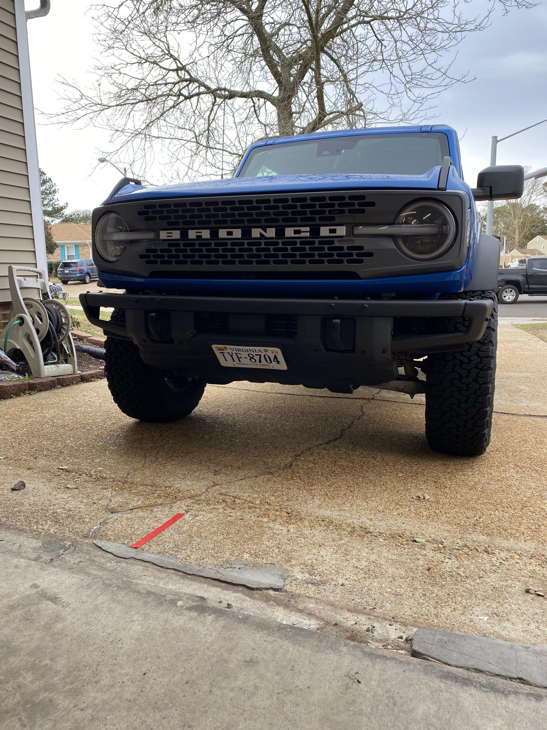

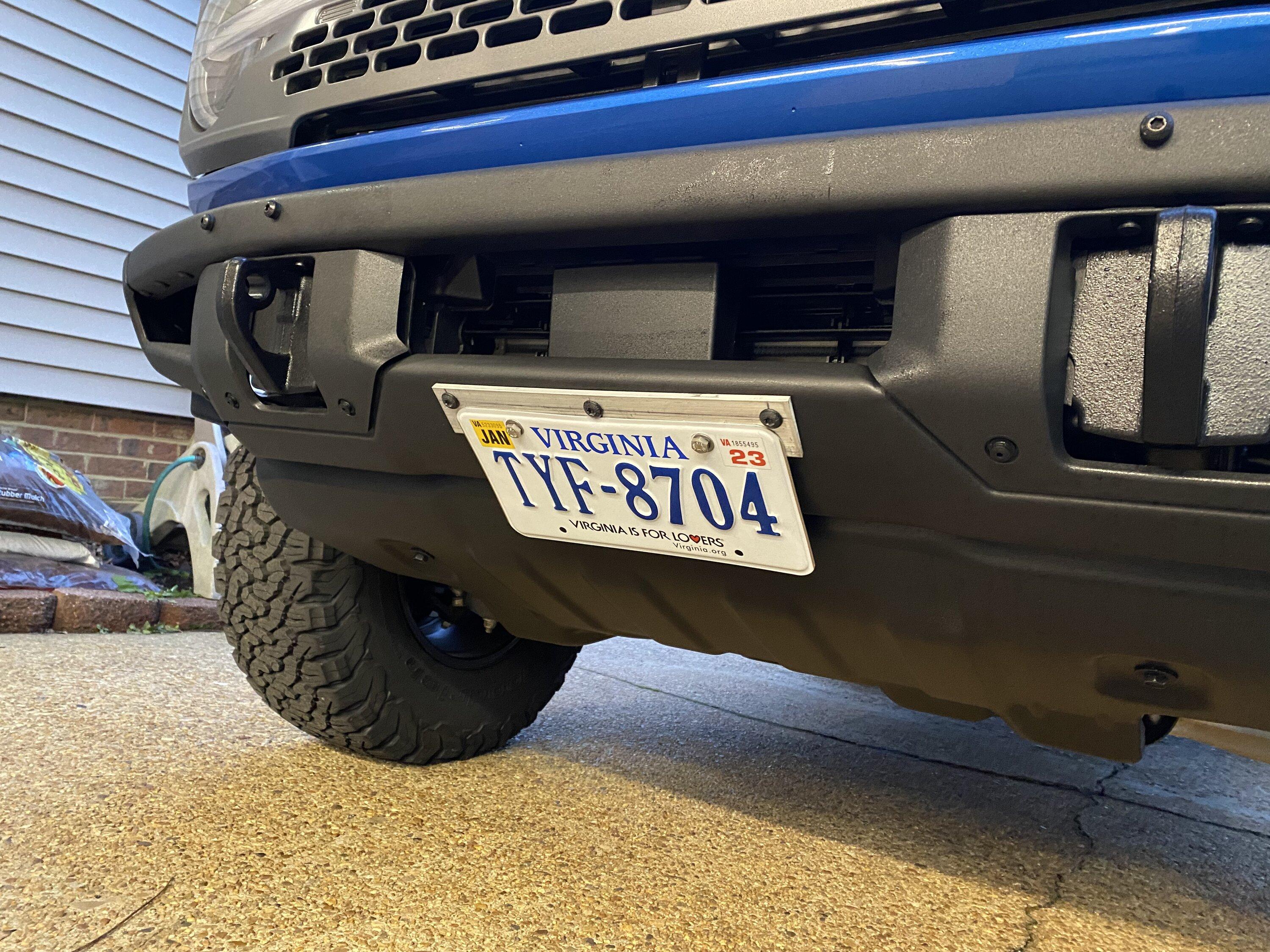

Similar to what I did, but no hinge, just bolted flat.
Ford Bronco Mod Bumper License Plate Mount DIY E736597F-59E0-478B-85B0-397D9651B05E
Ford Bronco Mod Bumper License Plate Mount DIY BB9930BB-8E97-4C08-912B-AB17C80C7D17

Cover up the ends of the bolts attaching the plate to the bracket.

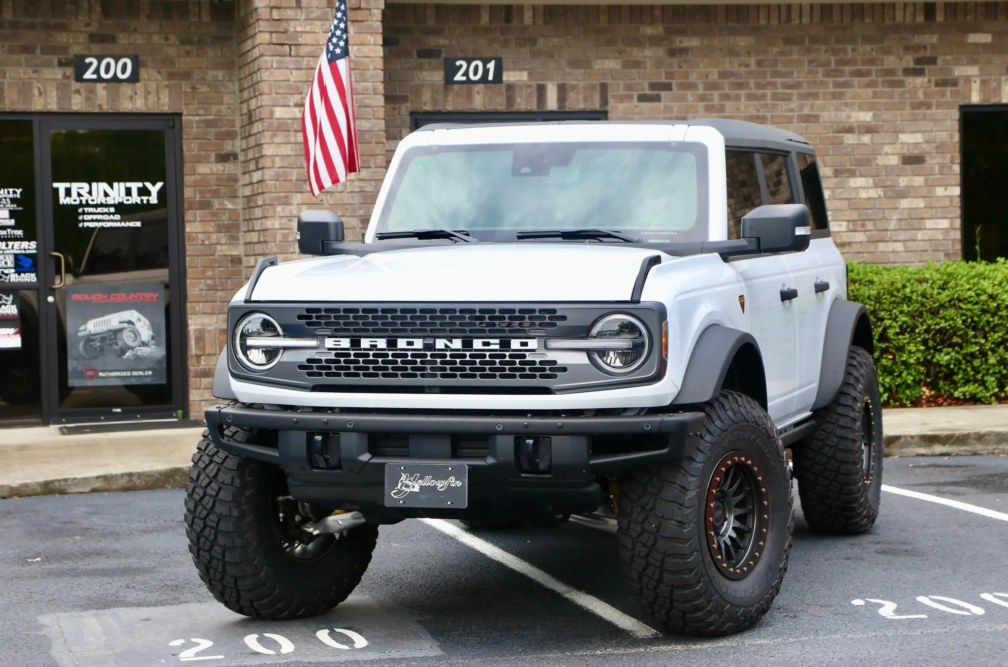

This is what I chose to do to mount the license plate to the mod bumper:
