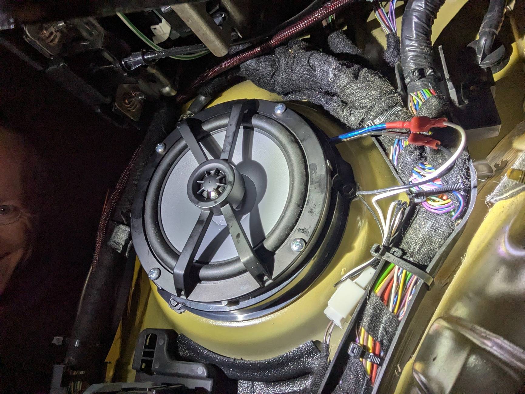

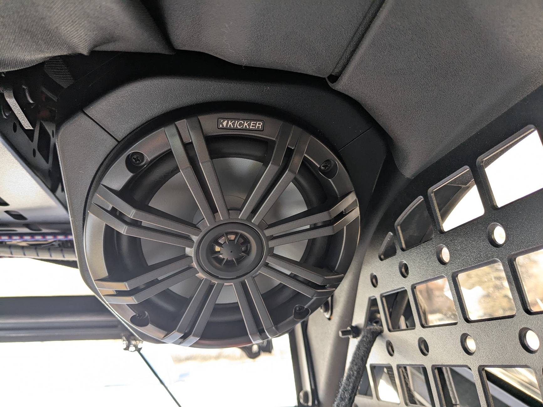

Kick panels got new speakers
Ford Bronco mObridge B&O Stereo Upgrade Installation Video PXL_20250225_011030579
Buttoned up the SSV speaker pods
Ford Bronco mObridge B&O Stereo Upgrade Installation Video Rear_SSV_Pod

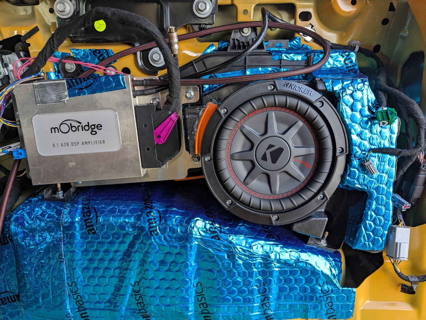

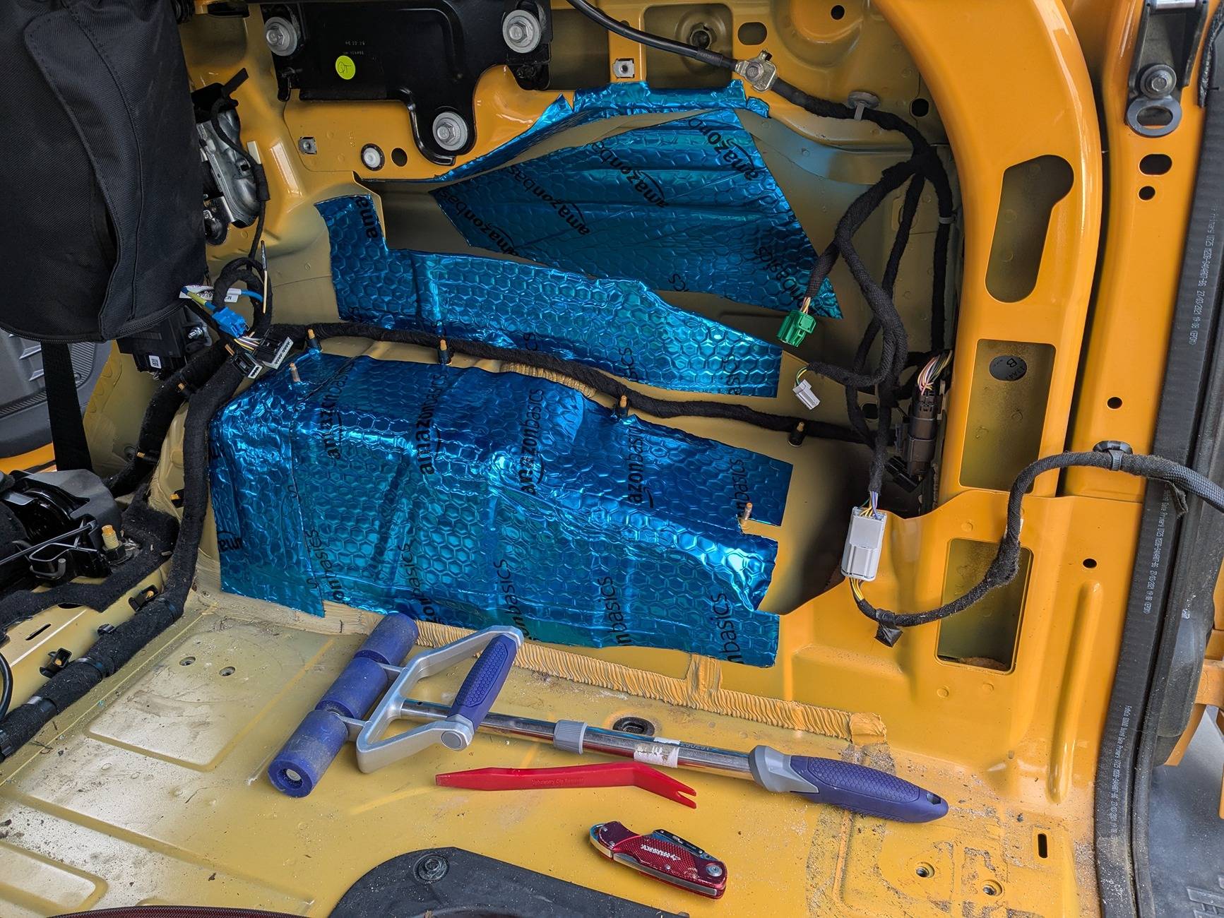

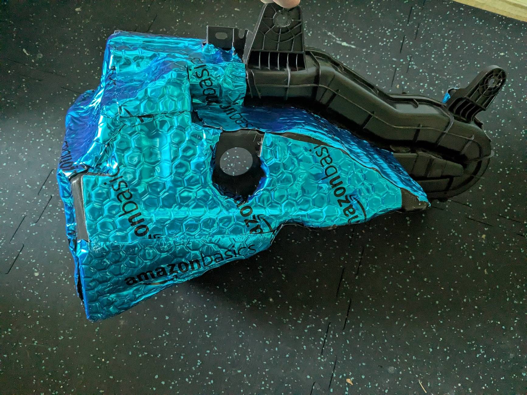

Installed sound deadening in the truck and around the subwoofer box
Ford Bronco mObridge B&O Stereo Upgrade Installation Video PXL_20250223_212747149
Ford Bronco mObridge B&O Stereo Upgrade Installation Video PXL_20250228_152246158

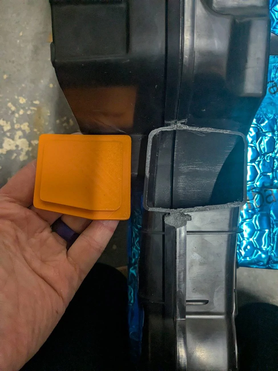

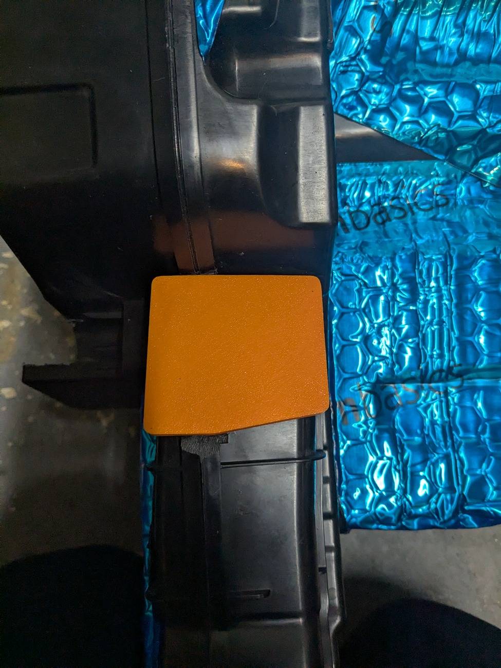

Designed, printed, and installed block-off plates to seal the subwoofer box (downloadable from Maker World https://makerworld.com/en/models/1207442-bronco-subwoofer-box-port-caps)
Ford Bronco mObridge B&O Stereo Upgrade Installation Video PXL_20250228_010236603.MP
Ford Bronco mObridge B&O Stereo Upgrade Installation Video PXL_20250228_010244938
Ford Bronco mObridge B&O Stereo Upgrade Installation Video PXL_20250228_010310722
Ford Bronco mObridge B&O Stereo Upgrade Installation Video PXL_20250228_152217823

The final install has sound deadening between the subwoofer and the mounting surface and has Poly-fil in the sub box.

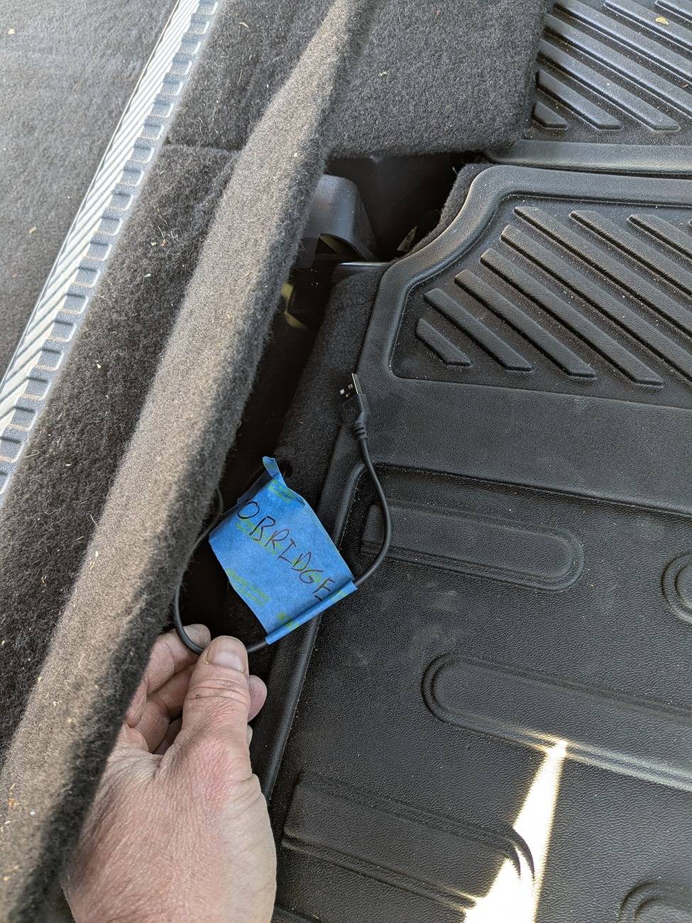

Reinstalled the interior and left the programming cable accessible for future tweaks
Ford Bronco mObridge B&O Stereo Upgrade Installation Video PXL_20250302_204255656.MP
Ford Bronco mObridge B&O Stereo Upgrade Installation Video PXL_20250302_204337242

- frequency response by individual speaker (I now have coax speakers in the kick panels so I increased the upper frequencies going to those speakers)

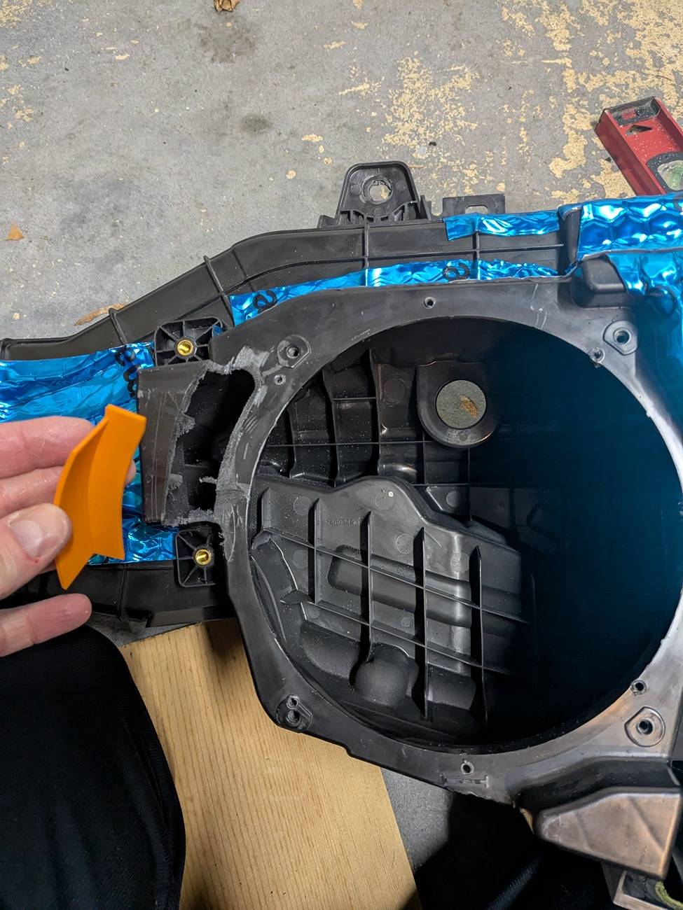

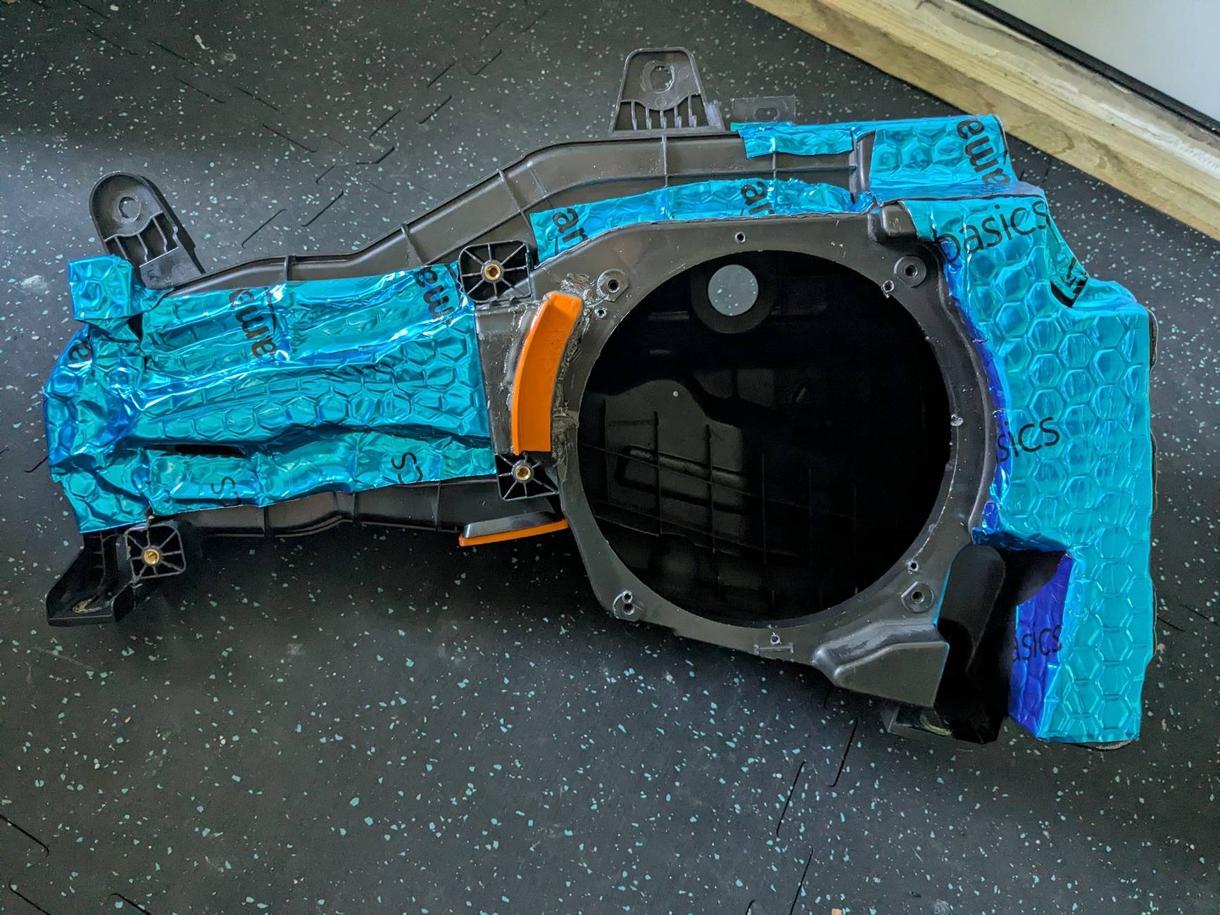

In addition to replacing the stock paper woofer I found that adding sound deadening to the subwoofer box helped a lot. It made it no longer sound like I was trying to get big sound out of a plastic box.
Cover the big areas, but also work the material into the nooks and crannies. The more surface area making contact, the better. I used a plastic panel popper to get into the creases.
And definitely add a layer between the speaker and the box itself. You'll need to trim a plastic tab off the face of the mounting surface (see the bottom area in the pic @RagnarKon quoted) and sound deadening material helps ensure a sealed, vibration-free fit when mounting the speaker.
