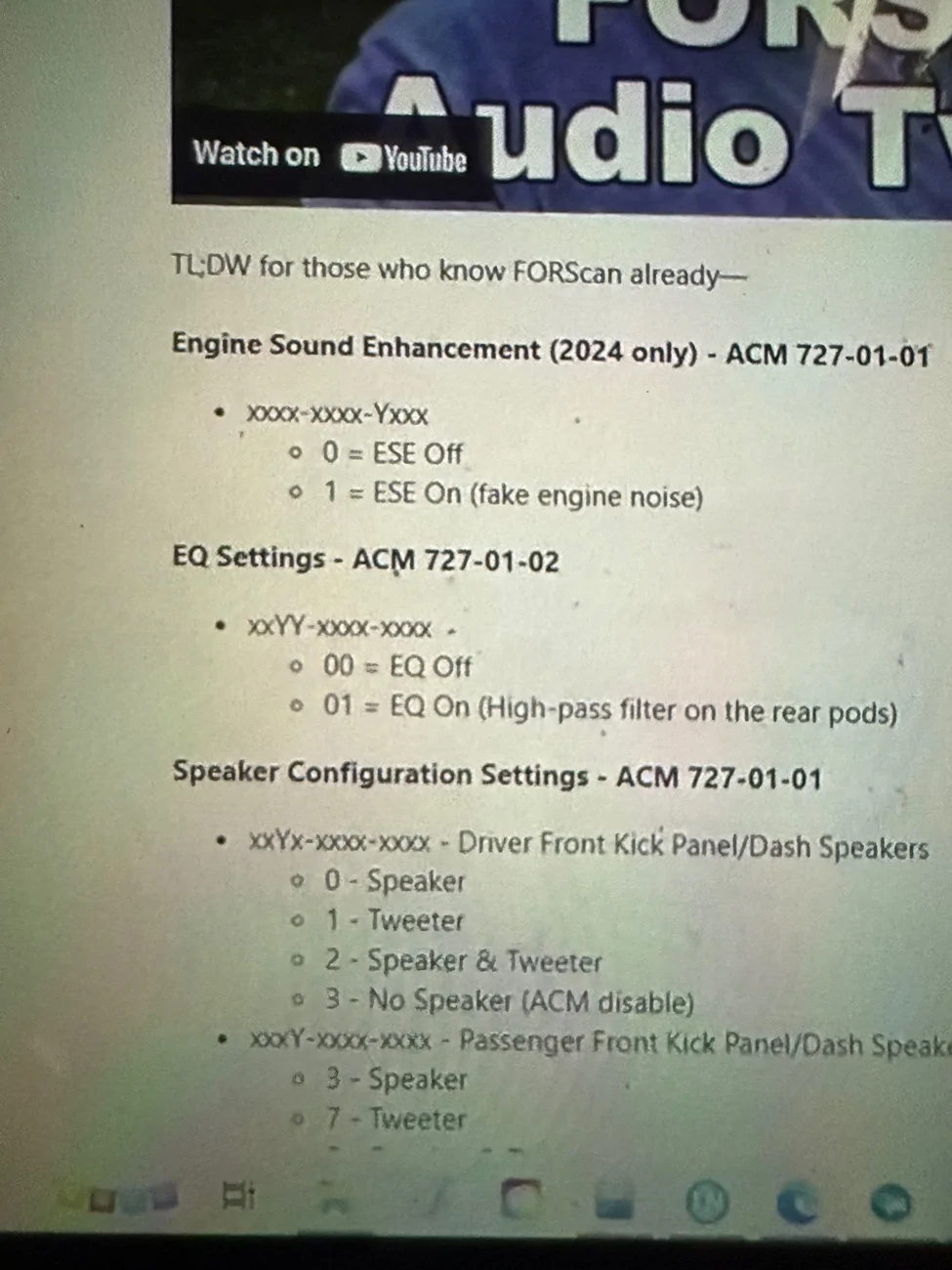

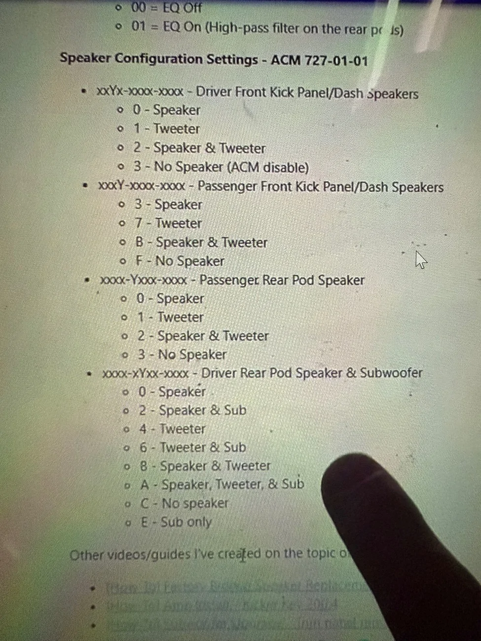

Looks like this thread has been silent for a while. I recently upgraded the speakers in my 2024 Badlands with the B&O system. I started with replacing the rear PODS and upgrading to 6.5" Kicker CS. I also upgraded the front dash speakers (3) with 4.5" Kicker CS. I drove it for a few days and then decided to make the recommended FORScan changes and that opened up the sound field like I was expecting after the speaker upgrade without replacing the kick panel speakers. The next upgrade I made was the subwoofer. I purchased the 8" Kicker CompRT and copied what the sub enclosure modifications made by Rangnar.Kon. I planned for the sub replacement to be more of a project, but it was relatively simple because of the time I spent researching. The only thing I did different for the sub was cut the OEM wiring harness and pull out the wiring leads just to have a little extra length...and it worked perfectly. With everything in phase I was pleasantly surprised with the outcome. Yes, the Kicker sub could use a little more power at lower volumes. I have only driven with the driver and passenger front tops off and windows down...no top off/doors off driving yet. Still shopping for door storage solutions...I have limited space and really want to make the wall hanger option work. I am impressed with the sound but am looking for a little more mid bass from the kick panel speakers so that will be my next move. I do not want to dump a lot of $ into the Bronco because it's a company vehicle. I am already considering purchasing the Bronco when it's time for a replacement (typically three years) to use for a Turo rental. I have not experienced the "fall off" of the sub at volumes of 15+ as mentioned earlier in this thread. I will add that I only listen to music streamed from the phone via Apple CarPlay. Sirius, Spotify, and Apple Music...the field of sound is SO MUCH bigger (especially the lows) over the head unit. Sportify even give a little extra fine tuning with an EQ in the app. I believe this to be a true budget upgrade. One more FORScan modification I made was turning off the fake engine sound. So, no engine noise now coming through the speakers. This also made a difference (small but noticeable to me) in the sound quality...no competing sounds coming from the speakers. and a noticeably less noise in the cabin especially when accelerating.

What changes to Forscan did you do for the B&O ? Would love a link if you have it. Also, the key to getting the most out of the B&O amp is using speakers with the highest sensitivity ratings. Based on my research and others from the forum on the B&O system, the 2 suggested speakers are Infinity Reference REF407F and the Hertz DCX 100.3. I have not tested the CS series (and I am a huge fan of Kicker - especially their subwoofers) Bottom line if you are happy with your upgrade, that is all that matters. Here is a link to my write up with retaining the B&O amp as your primary amp if it helps any. (43) B&O System Speaker Upgrade Options - Back to basics and keeping stock amplifiers and subwoofer | Bronco6G - 2021+ Ford Bronco & Bronco Raptor Forum, News, Blog & Owners Community The only amp I have added is the Kicker Key 500.1 for the sub. I used the PlugnPlay harness before the B&O amp to send signal the the Kicker amp - this eliminates the rolloff you mentioned. Let us know if you move ahead on the Kick panel speakers. I tried the Memphis but went back to stock. I have also not heard glowing reviews on too many kick panel replacement speakers running off the B&O amp. There are other threads on the Hertx C165 and C165L but the consensus is they need more power than the B&O can deliver to get them moving. I am tempted to try the Hertx DCX 165.3 in the kicks (staying with the same brand and same sensitivity as my other speakers) but I worry I will come away unimpressed......

Attaching screen shots of the guide I used to make changes.

I've made these mods on ForScan and it's way better. I upgraded speakers all around to Alpine S-Type with the Trail Seven kit, no amp. I do not have the B&O and no sub. So just upgraded speakers and ForScan tweaks.
I set all speakers in ForScan to just "Speaker." Is there a consensus on whether just speaker or speaker and tweeter is the way to go? Each of the new speakers has a built-in tweeter but I did speaker only because at the time I did it I hadn't upgraded speakers yet and also because I believe I read that the speaker only setting sounded a bit louder. I've got plenty of volume now (for me), so wondering if it might be worth changing.
