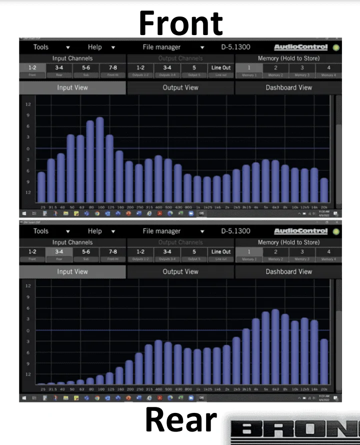

So I will be getting a 2 door with the base system. Rear seats will be coming out.
My first thoughts are - this sucks...
Ford Bronco Base Stereo Upgrade - Options 1662571403925
Next thought is that the front can be worked with, but without some kind of channel summing DSP there is no hope for the back channel. I'm in my 50's, have done this a few times (with varing degrees of sucess) and do not intend to go down the Forescan, JBL flash, computer driven DSP tuner rabbit hole. So...
Working backwards. There will be a JL 10 or 12 inch sub right behind the drivers seat. Therefore, either a single four way amp (front + briged for the subwoofer) or a two way amp in the front with a mono for the sub. Up front would be upper mid level replacements that fit (JL or Focal). If I do the two way amp I would most likely pick the Kicker Key for the base level DSP correction built in.
Now for my sticking point. Do I put high sensitivity (Infinity Ref) in the rear pods on the factory head unit for some fill. Or just chuck the rear pods entirely and only have a front soundstage. This is what I am leaning towards, but I have not heard of anyone else considering front only.
Given the noisy platform, it seems like a mid level punchy system would be fine without a rear soundstage.
What say you???
