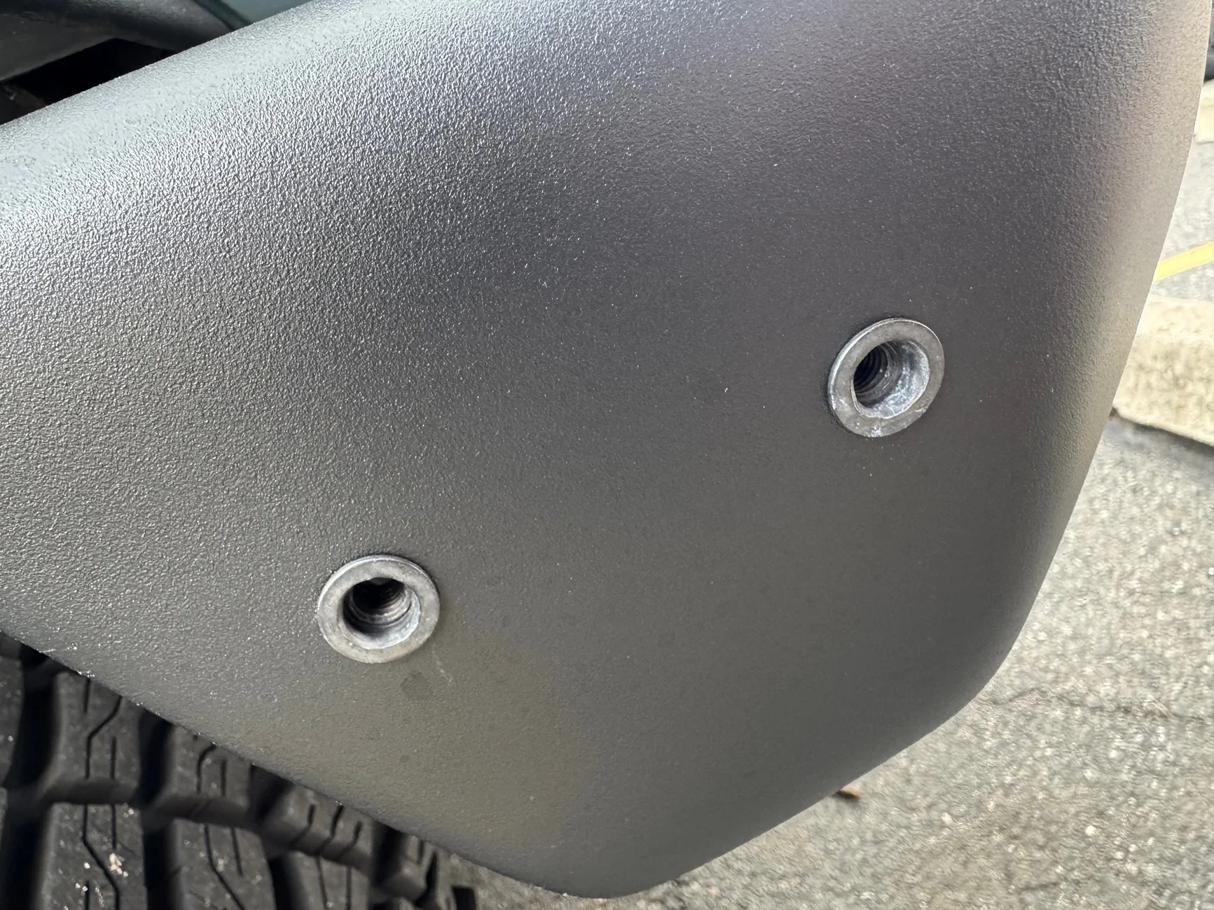

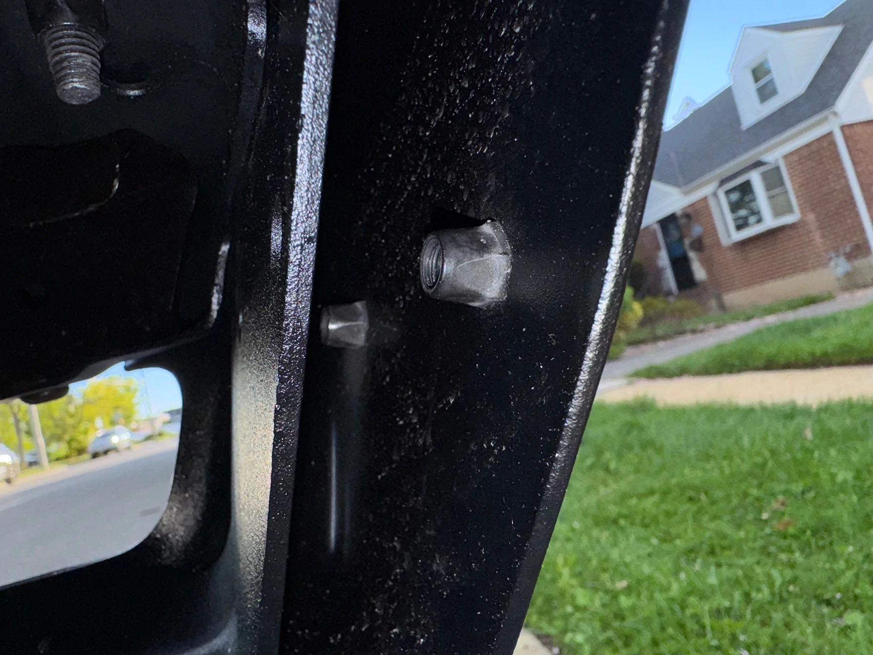

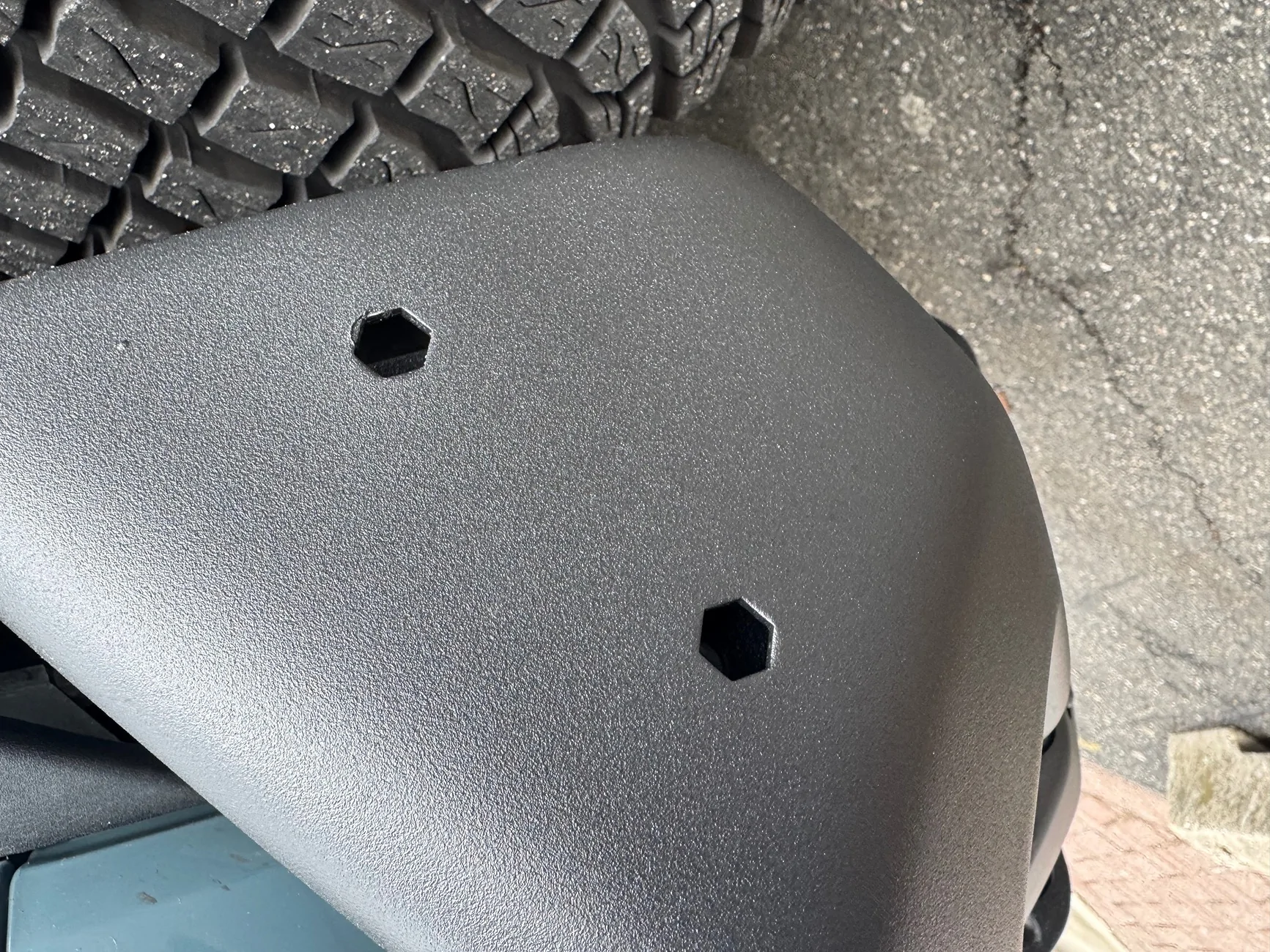

Hoping someone can help me identify and find couple missing Front Modular Bumper Parts. Left side end cap is missing the two female inserts and also missing the 4 actual bolts for both caps. Trying to get via a warranty claim after the install but it’s like pulling teeth. So would rather source and buy them myself. See pics below. You will see the one cap has the female sleeves, the other does not. Also missing the bolts that go in them.

Good chance regular round riv-nuts aren't going to fill that hex hole. Make sure to pick up hex rivet nuts.
... And be glad you have the holes.. the hex punch tool bit alone is like $430
