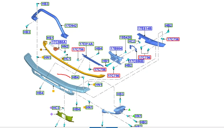

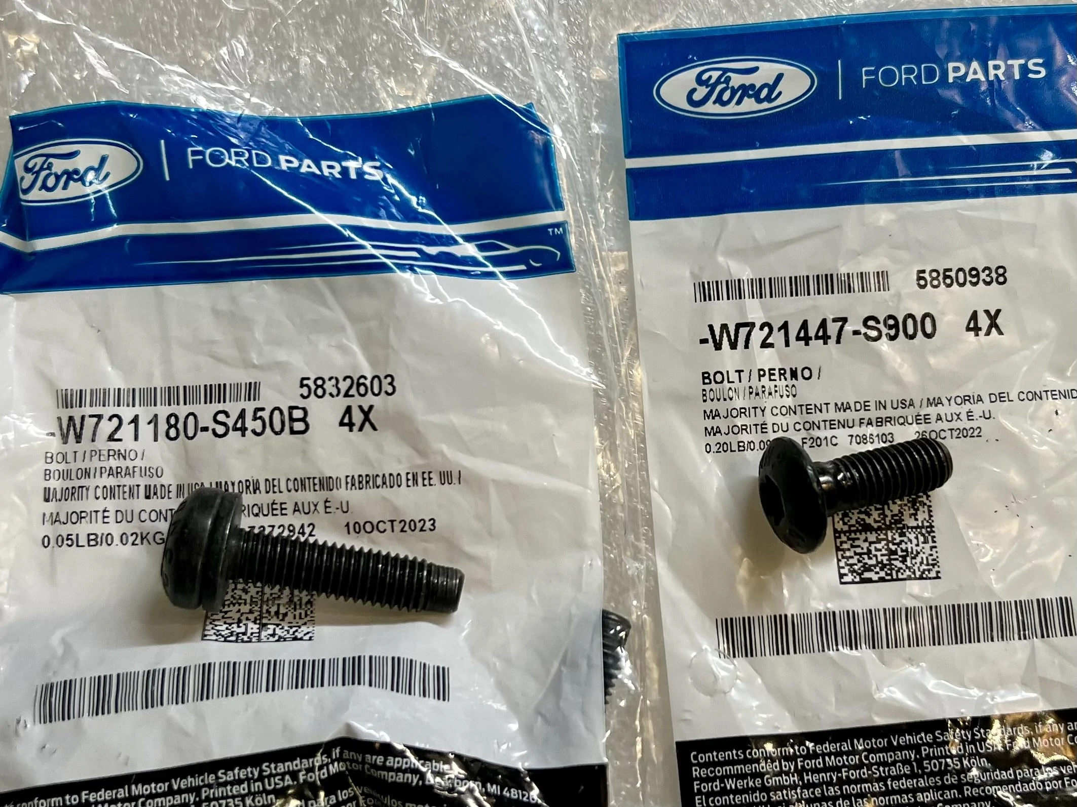

The W72221447-S900 is the bolts marked as HB4, M8 X 23MM. The first link is the bronco bolts marked as HB3 in the pic. and M8 X 30. I really don't think 7mm is going to make much of a difference in the grand scheme of things.

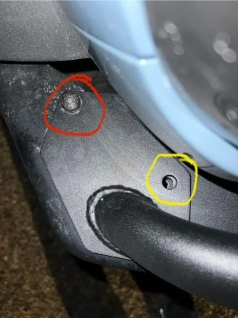

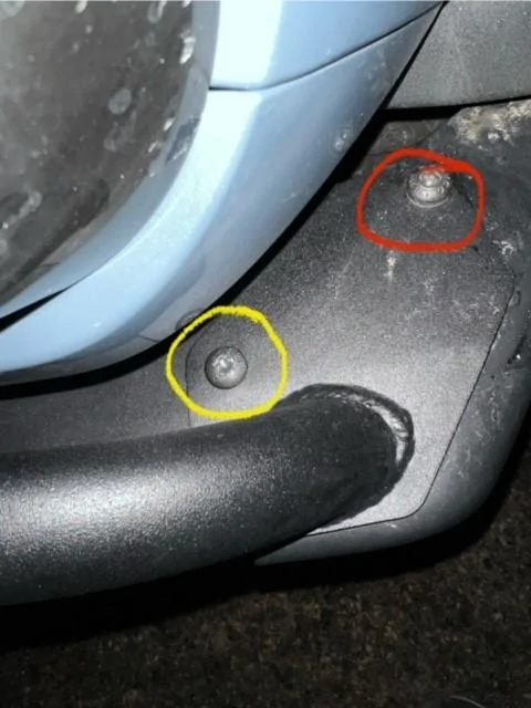

Just realized I somehow lost a bolt on my front bumper. Are the bolts I circled in yellow the HB3 and the ones circled in red the HB4? The one circled in red has a washer and the one circled in yellow does not have a washer with it.

W721180-S450B is HB3. HB3 is 30mm long, HB4 is 23mm.

Just to confirm before I place an order with you is that the HB3 (W721180-S450B) is the bolt below circled in red and is 30mm long and has a washer with it. The hole below circled in yellow that is missing the bolt is for the HB4 (W72221447-S900) and that is 23mm long with no washer.
If you want the one with captive washer, go with the HB3 W721180-S450B.

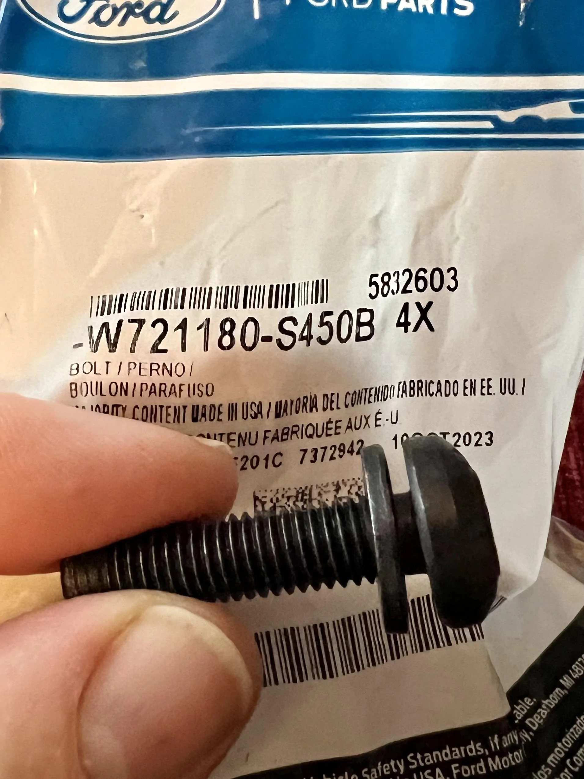

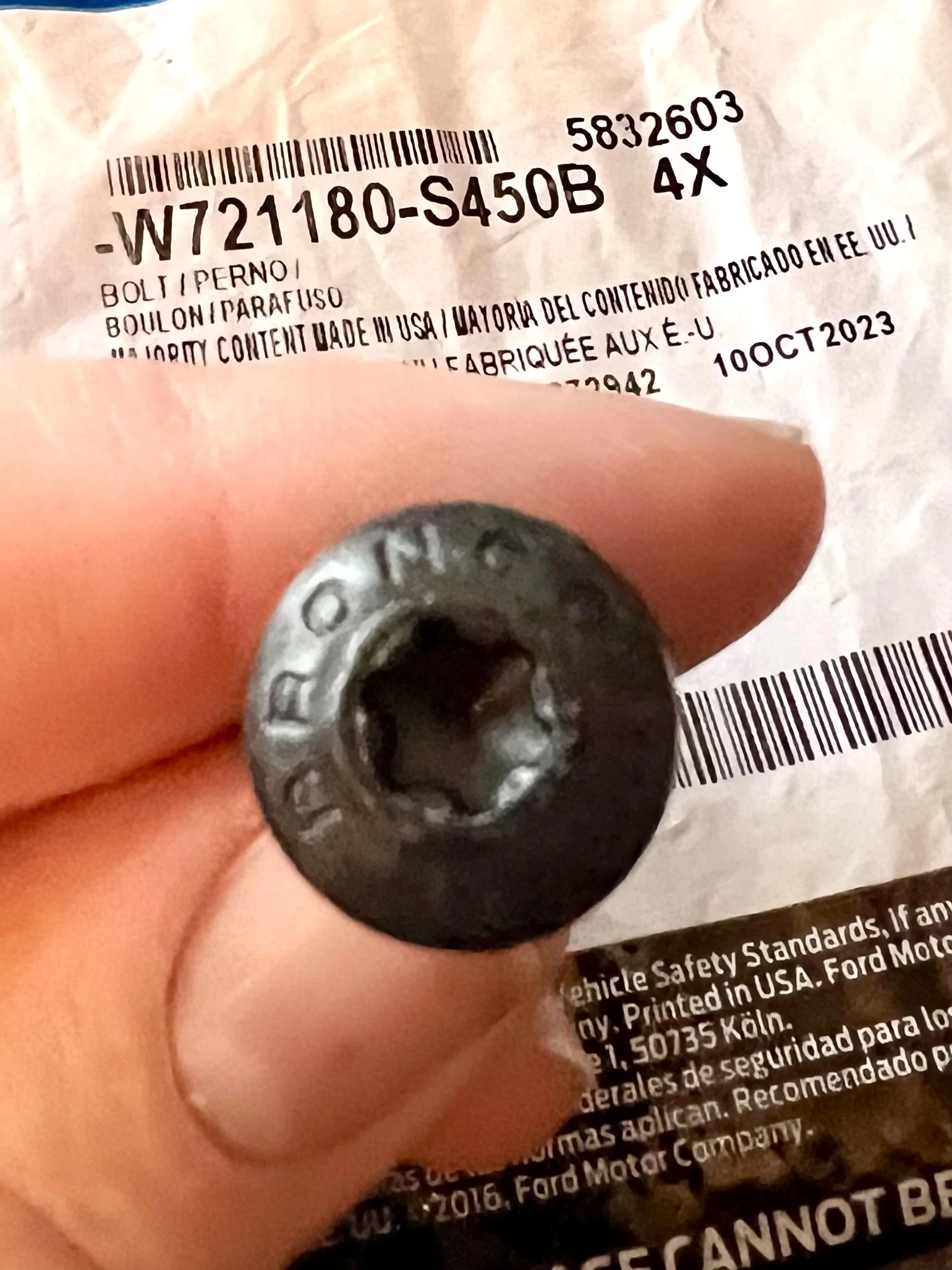

If you’re looking for the bolts that have Bronco stamped on them, this is what you’re looking for.
The s900 part number is similar, but they are a few mm shorter, have no washer, and don’t have Bronco stamped on them. I spent a lot of money ordering the wrong ones. Just trying to save others some hassle.
