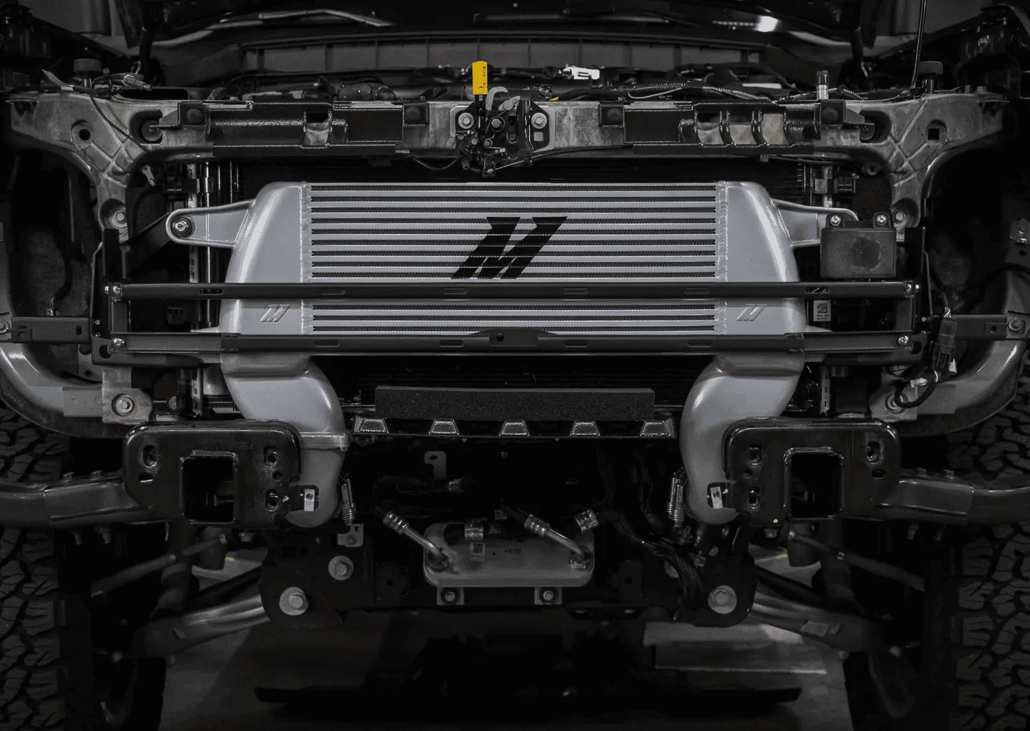

Based on the shared pictures I agree with you (and hope that's true). The only reason I ask is because in their first update back in November of 21' it was mentioned they would be relocating the ACC radar. "So, to clear some space for our new design, we’re opting to delete the active grille shutters and relocate the radar cruise control in the name of increased performance. " So figured I'd ask just to get some clarification. I'm also interested to see how radiator temps are effected with the high mount location.
Yeah it looks like you are correct. From this picture it looks like the have moved it to the left (drivers) side of the new intercooler.
Ahh good find didn't catch that when I looked through the photos before. @Mishimoto will this be the final relocation spot for the ACC?
Increased coolant temperatures are inevitable when you are installing an intercooler, light bars, winches, or other items in front of the radiator. Through our testing, we saw increased coolant temperatures, but still within a normal range.
Hi @Bcol2012 - yes, the image @Ducati1098 shared is the final relocation spot for the ACC. We spent many miles on the road ensuring that location would function properly. It worked well for us, although occasionally with less accuracy. From my understanding, this is common across relocating ACC sensors on other Ford vehicles, too.

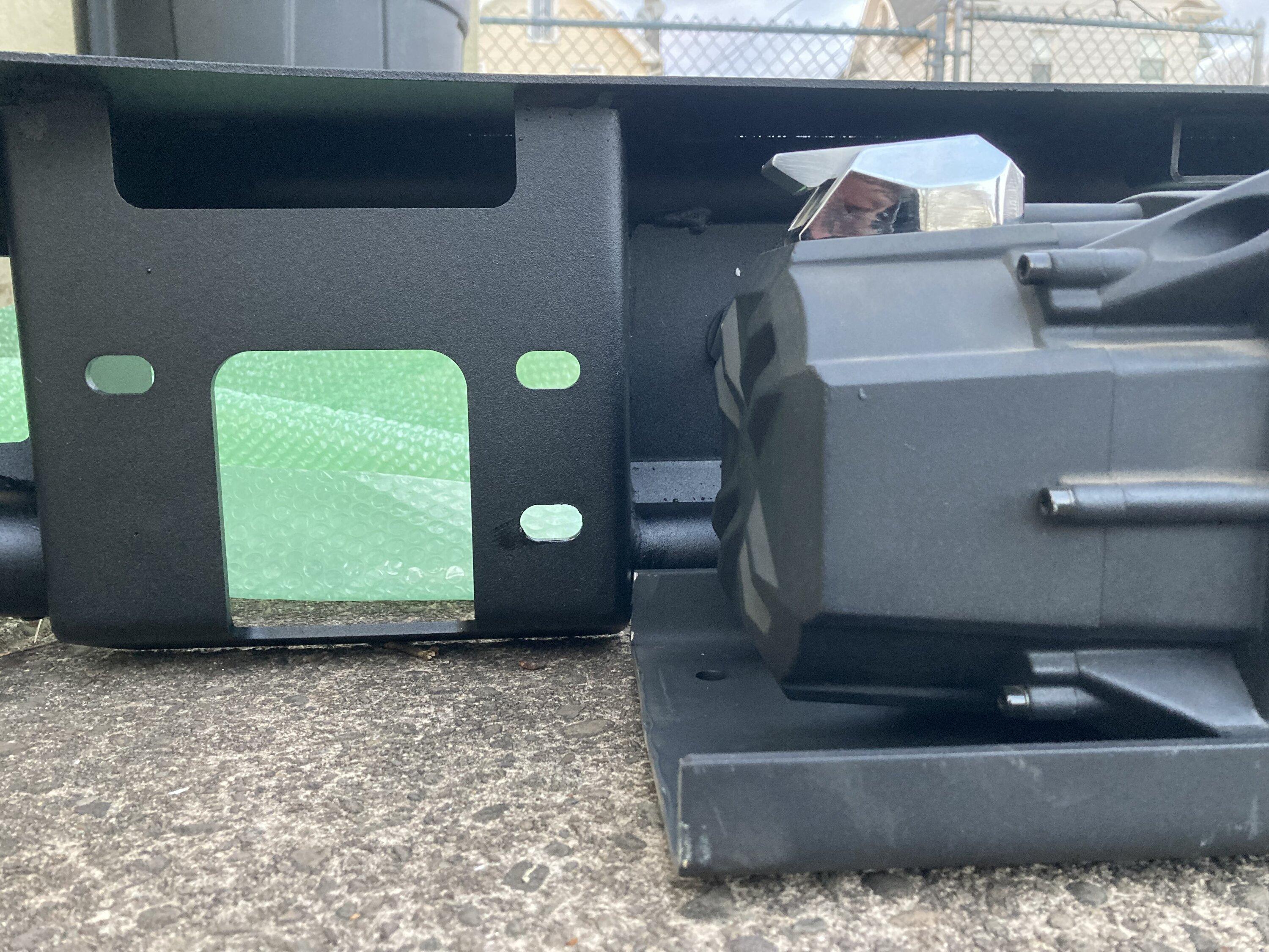

Hey Nick, it got to almost 50 degrees today in central PA. I dug out some Bronc stuff to measure up some things. 😁
Winch fits between the bumper pads, might lose/have to move the bar in the middle. All good.

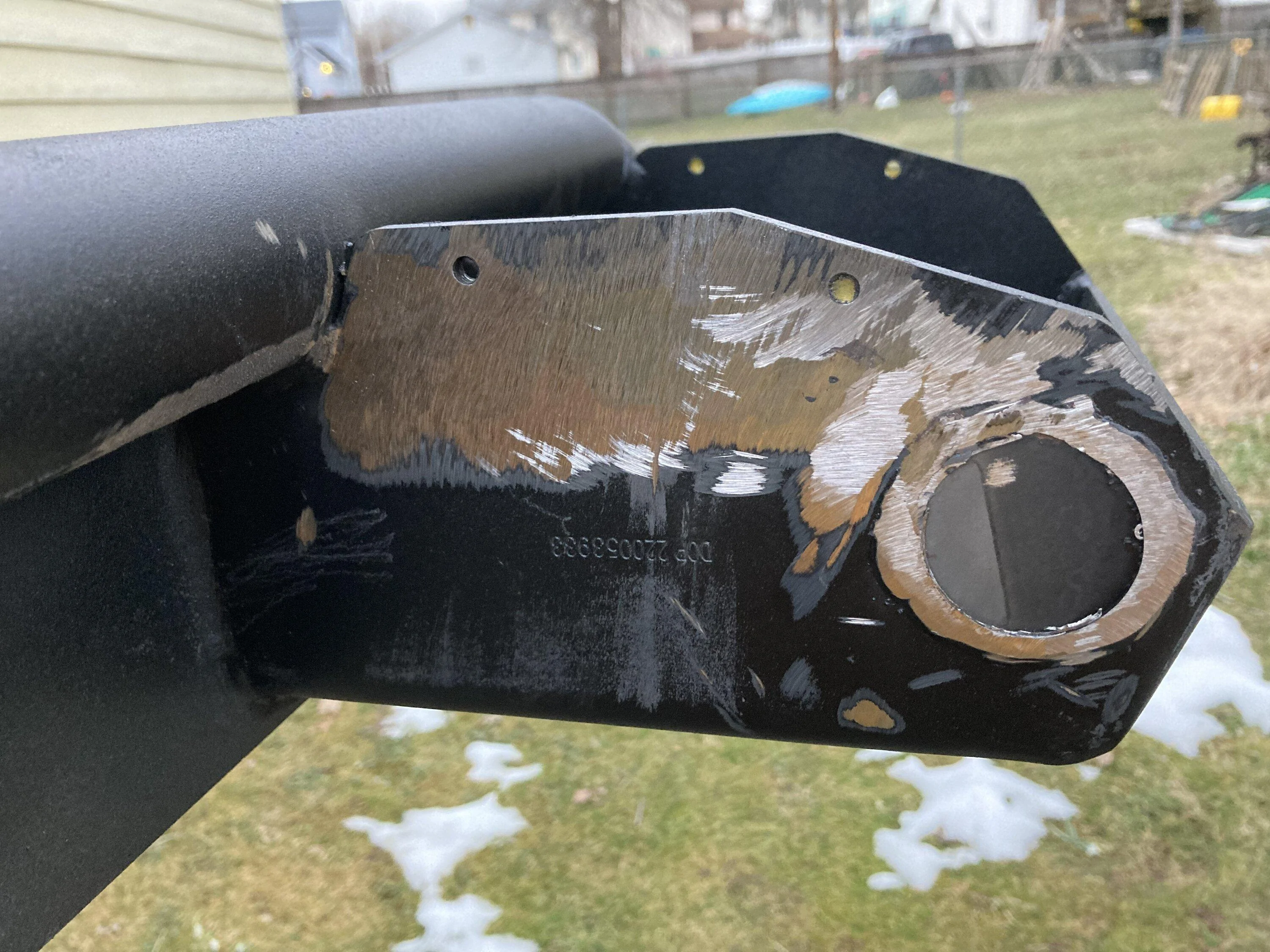

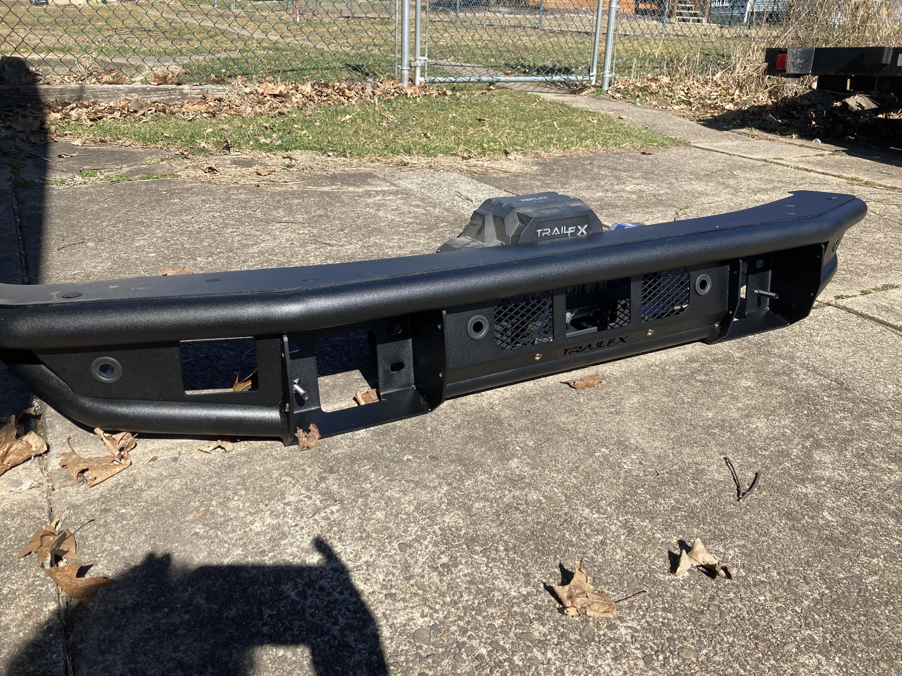

Yesterday I trimmed the winch plate so I know it will fit between the bumper horns on the bumper side. Which should be the same as the Bronc.

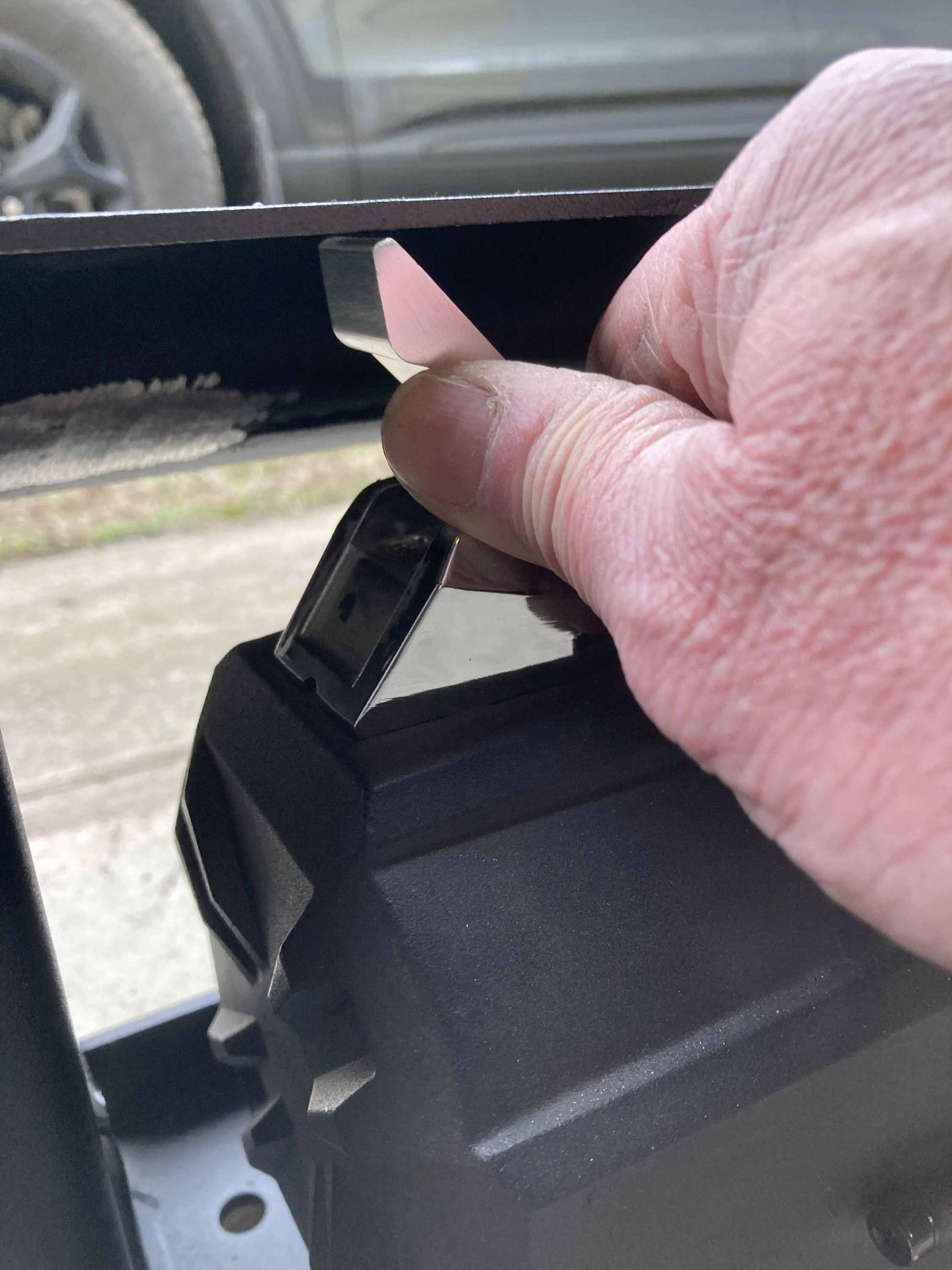

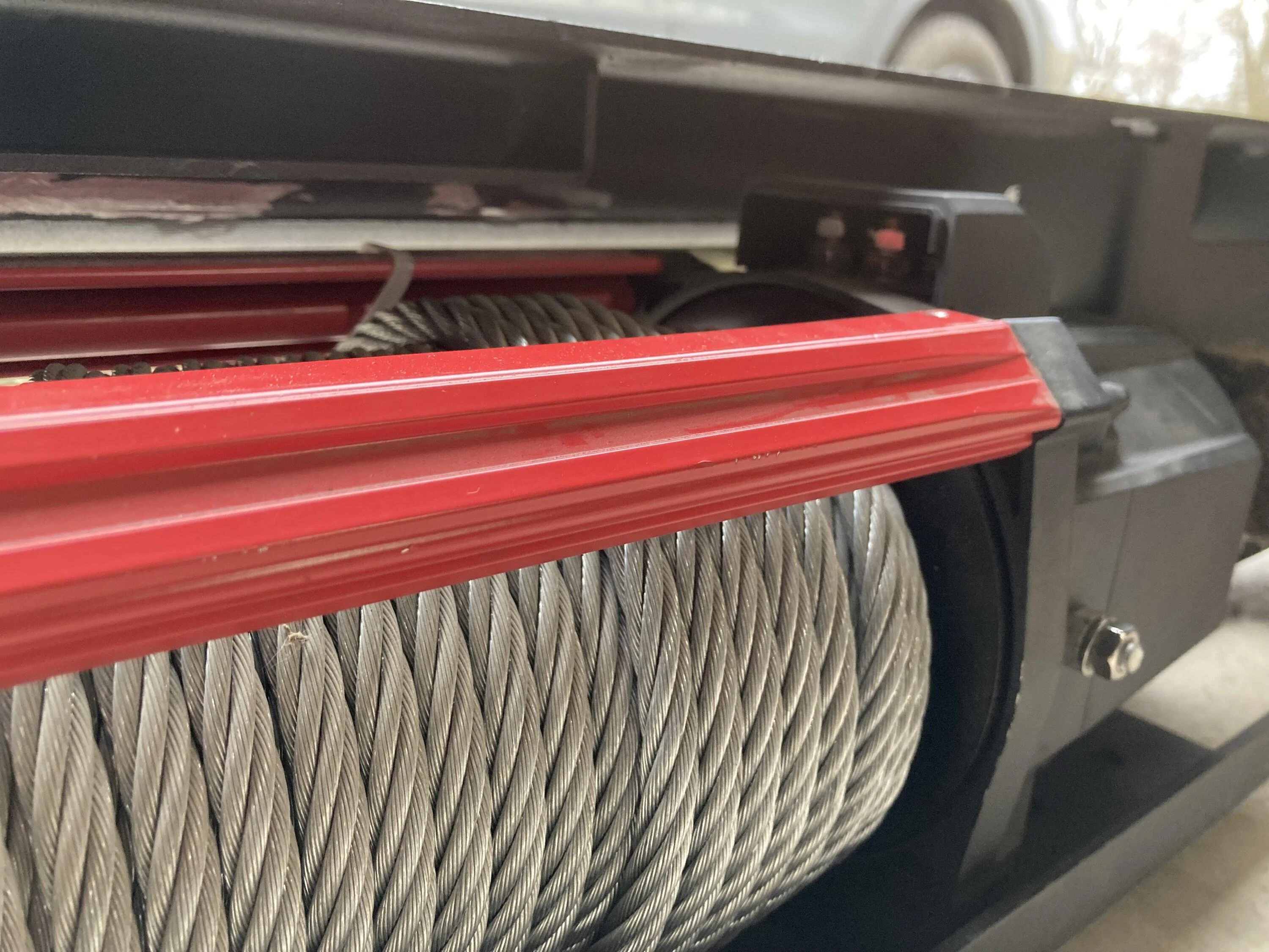

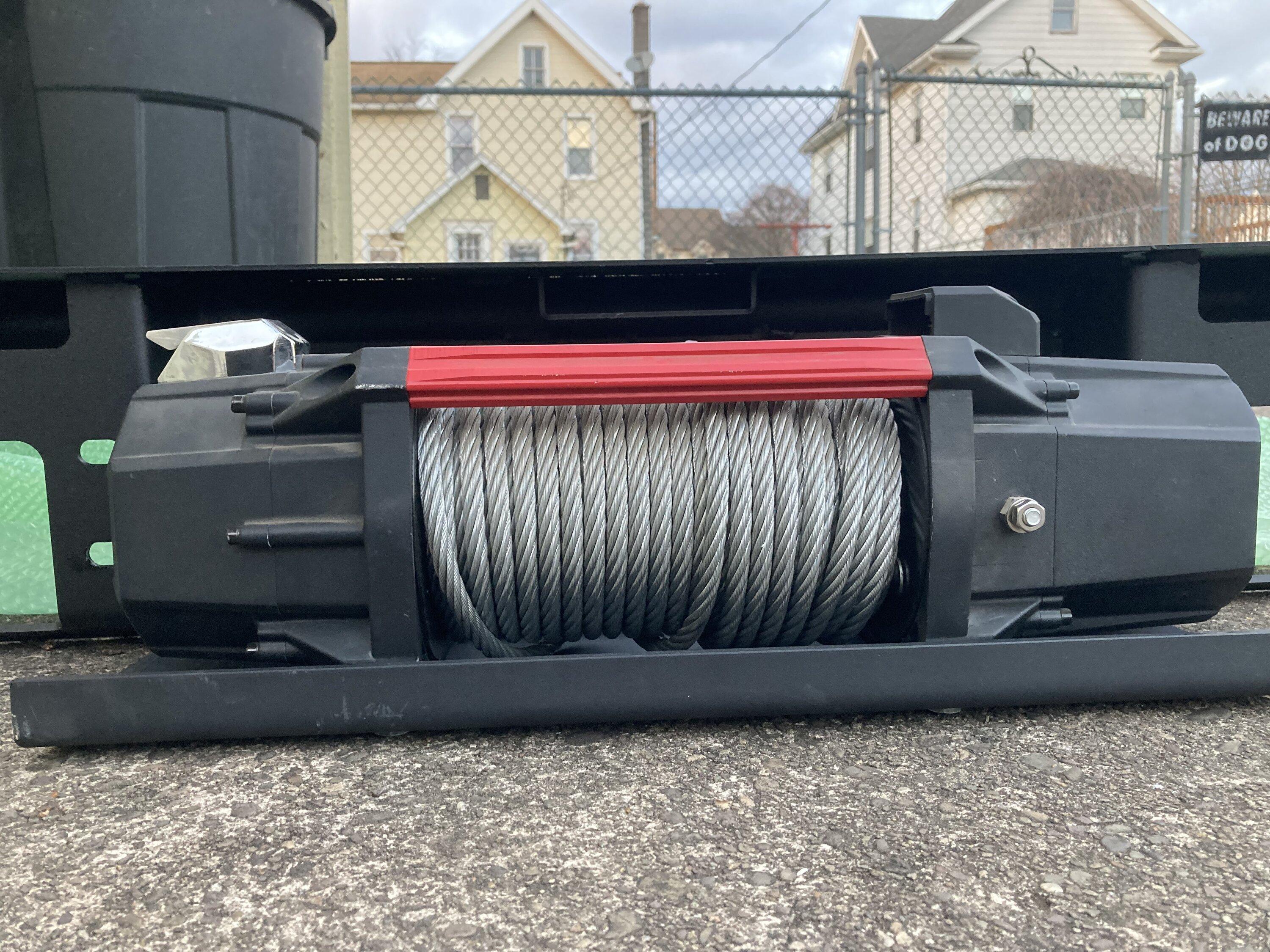

Upon further investigation you were correct the control box was removeable. The winch will fit under the top plate of the bumper now. My cut off wheel died and I need to get a new one so I can cut out the center grille of the bumper. More on that later. Should be able to push it far enough forward to clear the intercooler piping.

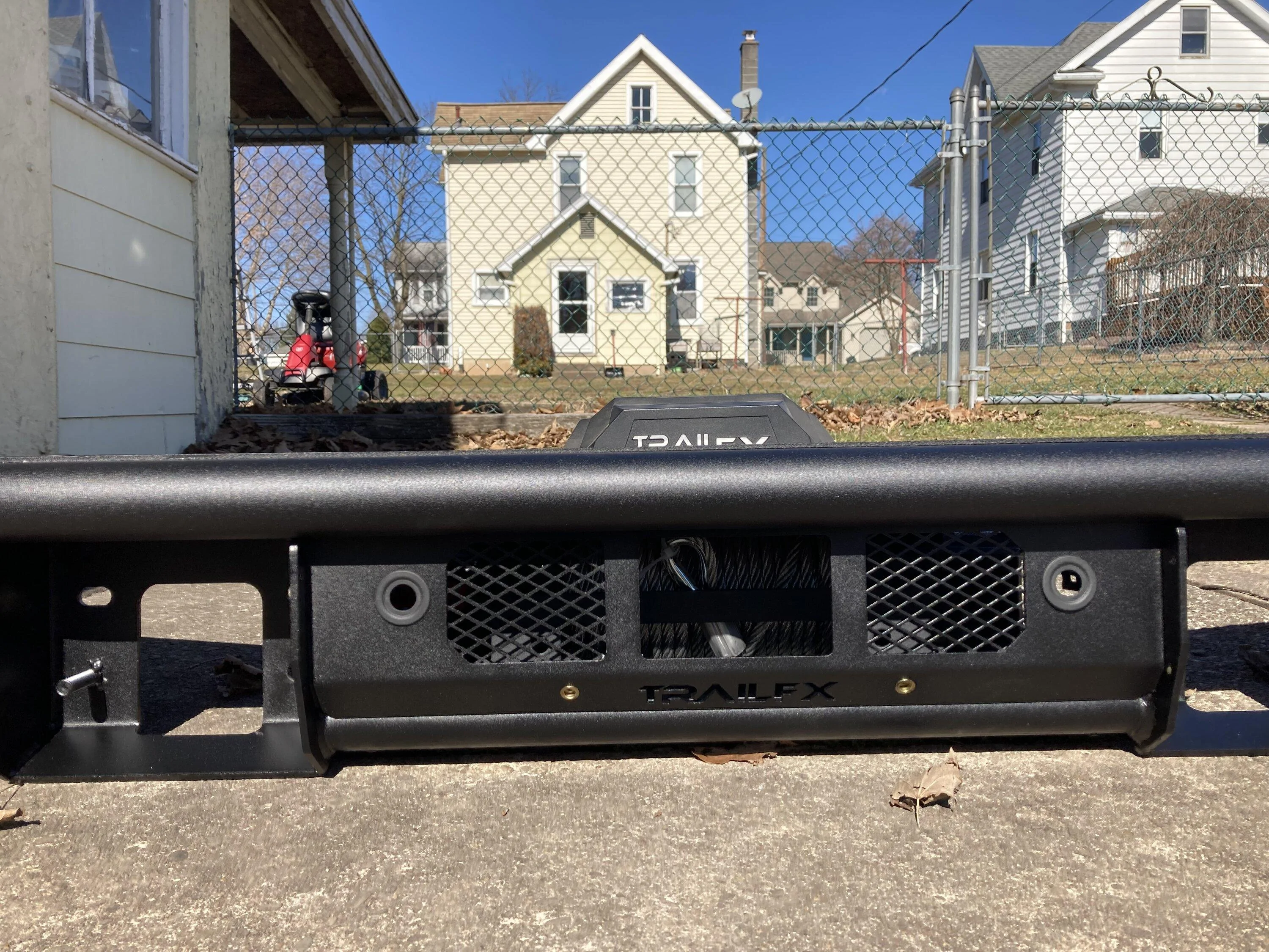

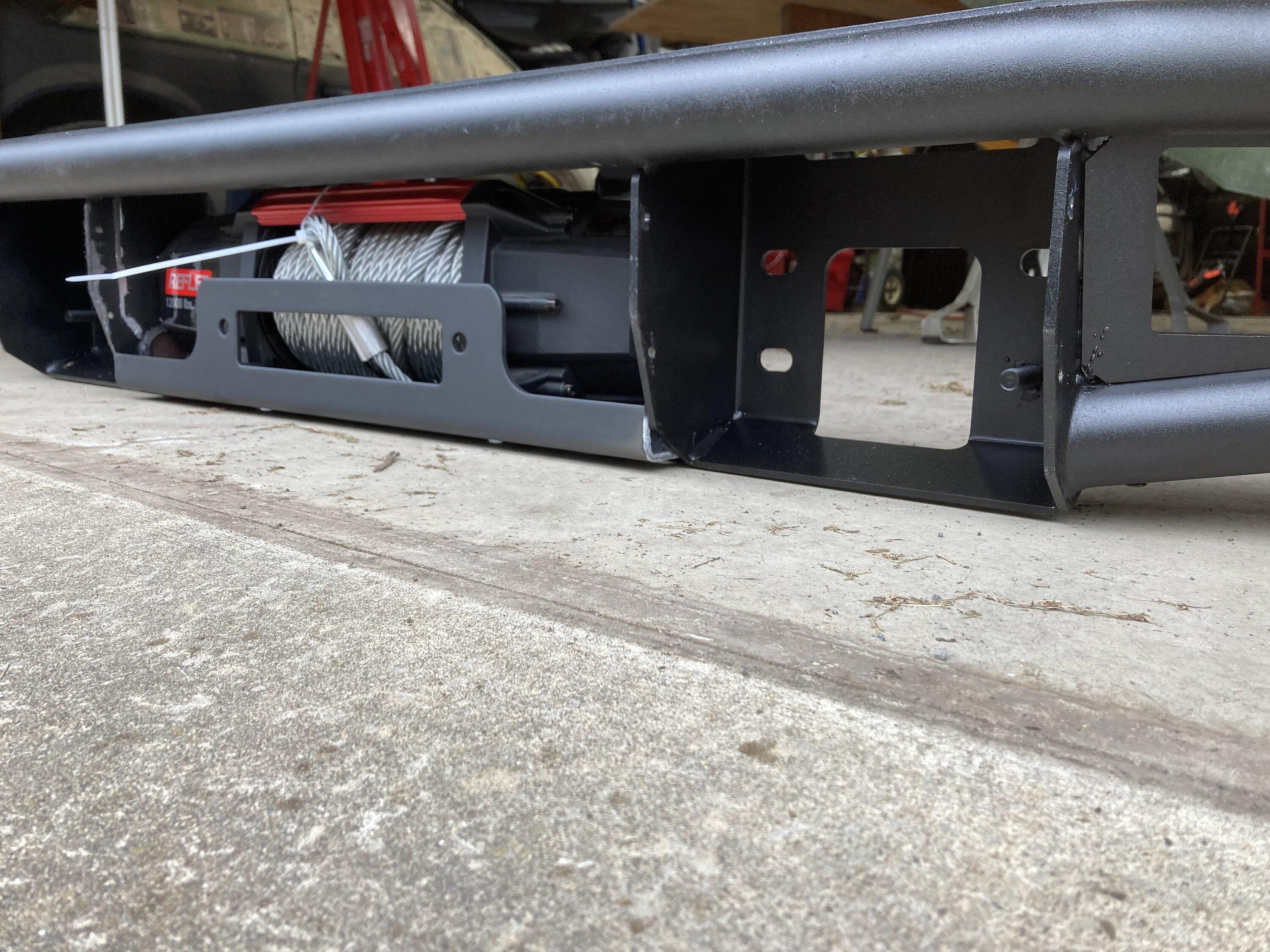

Got the bumper cutout just need to finish cleaning it up.
Ford Bronco Mishimoto's Performance Intercooler R&D Thread IMG_0187

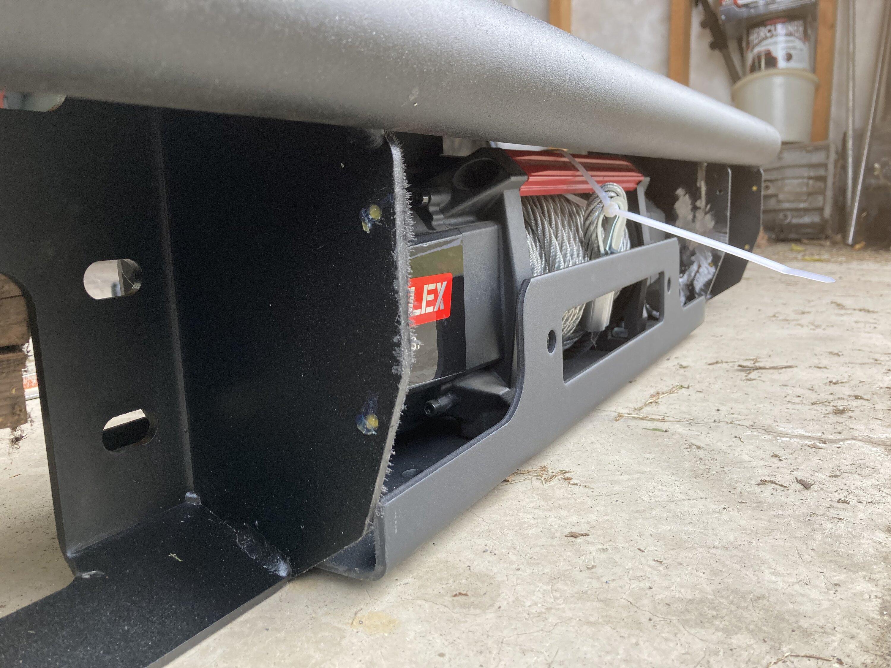

Just throwing it together to get some idea on what it might look like. Plenty of room for the wires.

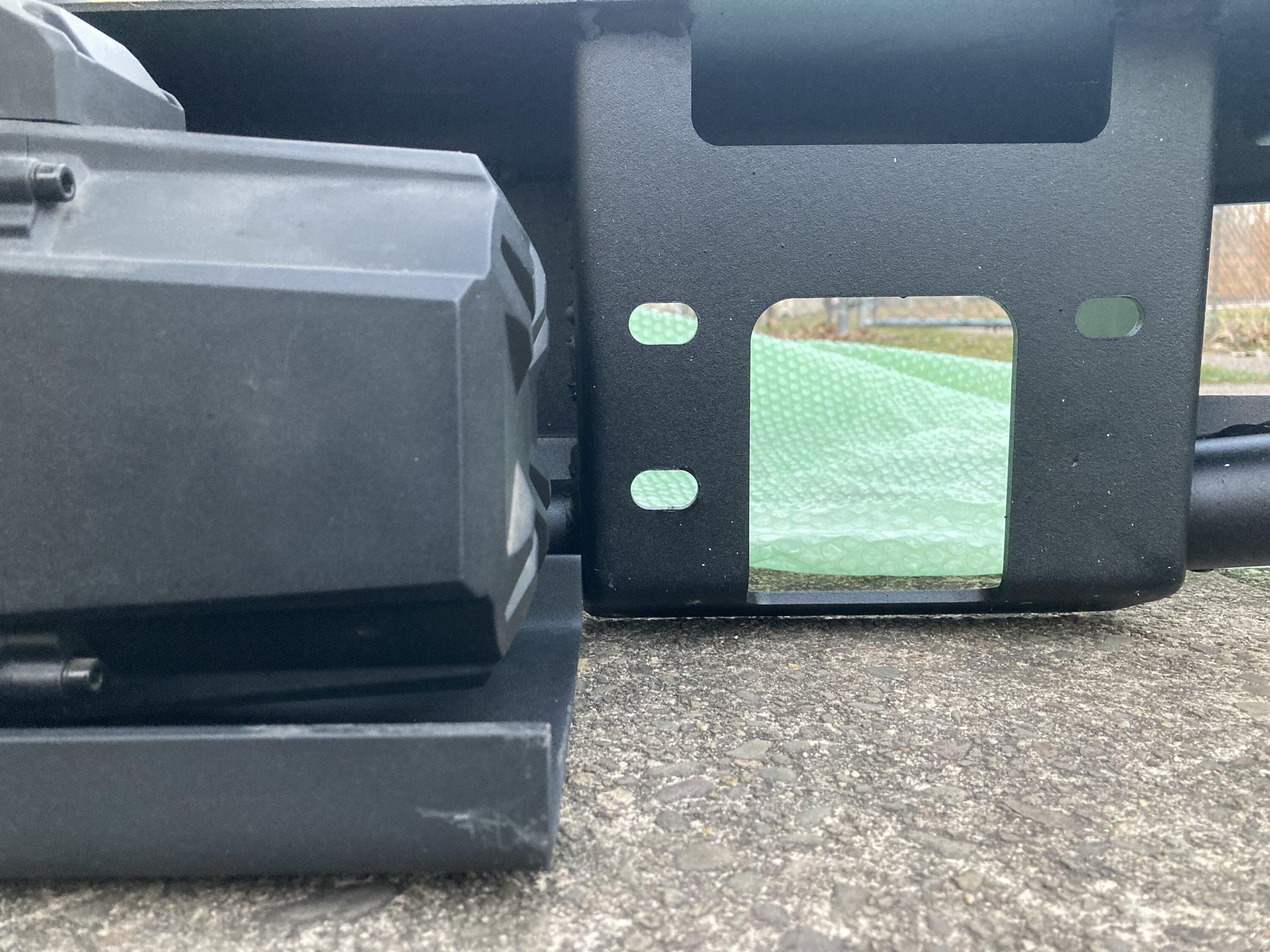

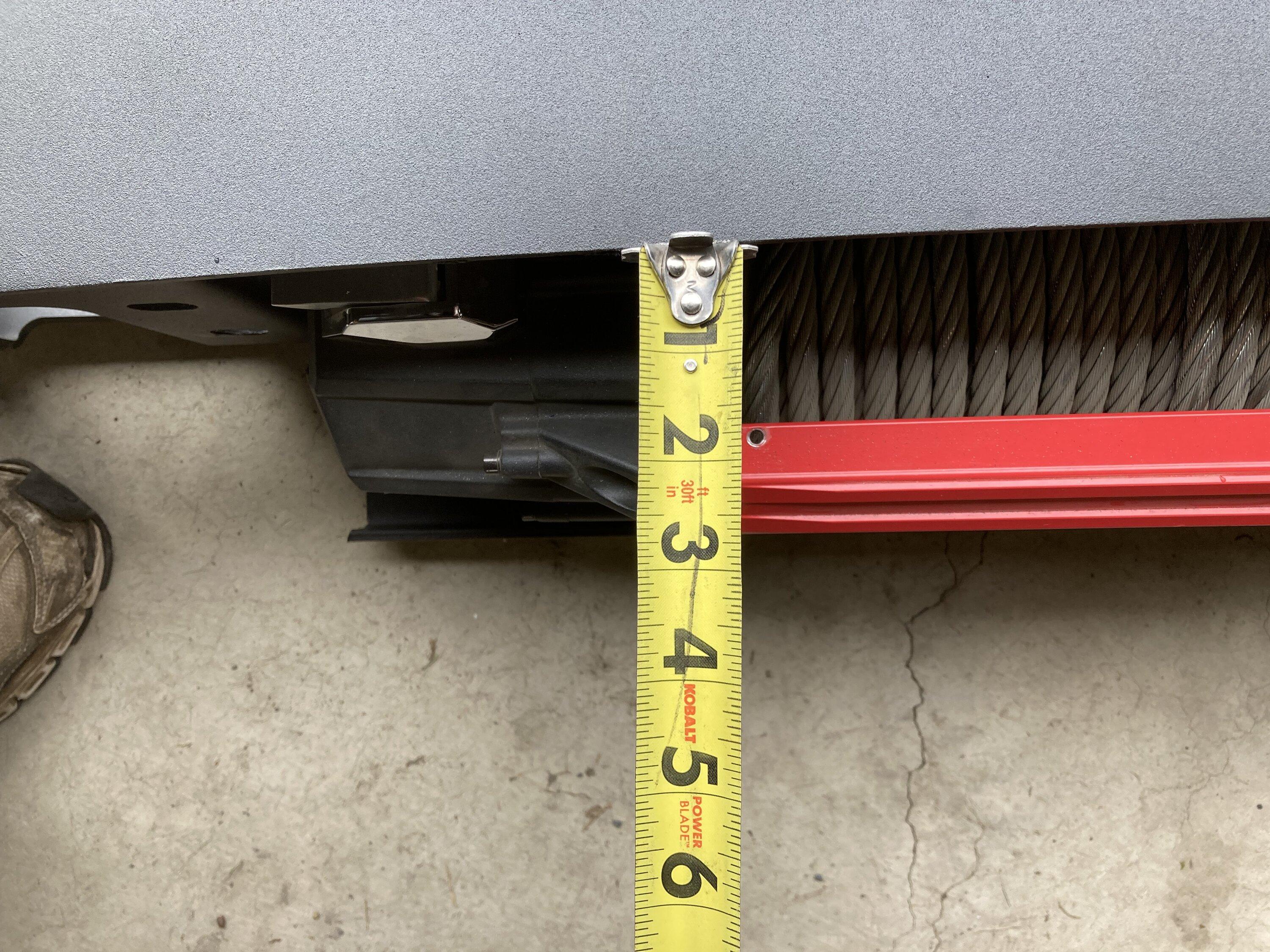

With the winch basically flush with the front of the bumper horn pockets, I have 2 3/4 inches to the back of the winch. Hopefully the winch will be able to reside about in this location and not interfere with the intercoolers piping.

I will need to make a cutout in the top of the bumper for the free spool lever.
Ford Bronco Mishimoto's Performance Intercooler R&D Thread IMG_0183
