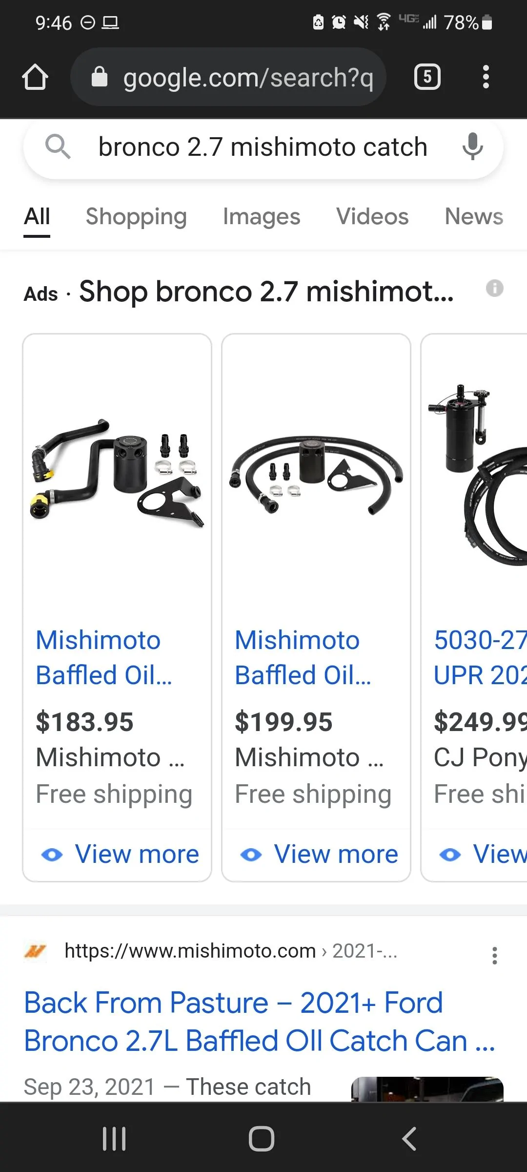

1st friken hit. Even gave the DaVinci code of secret words to try so you can go forth and do justice in your own town.
The troll is you, my friend.

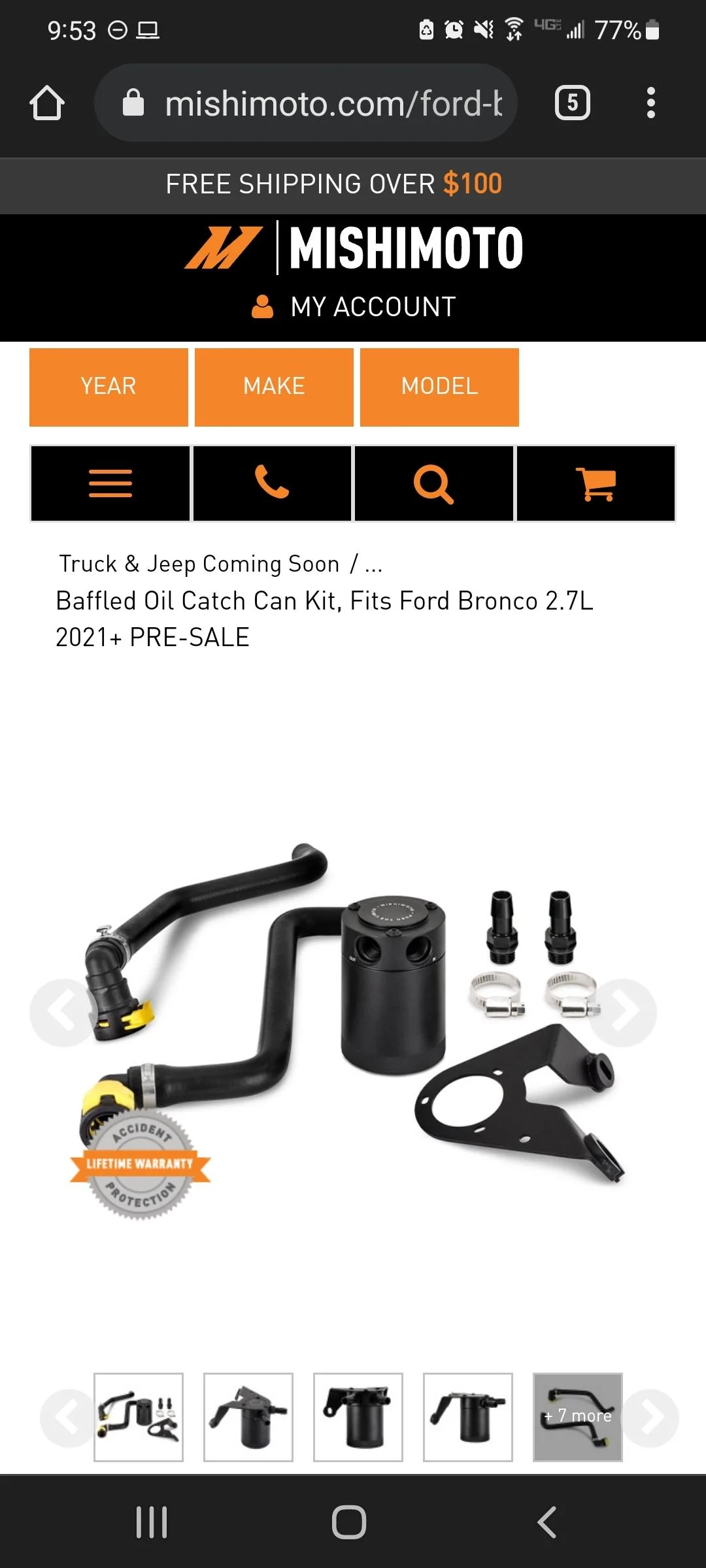

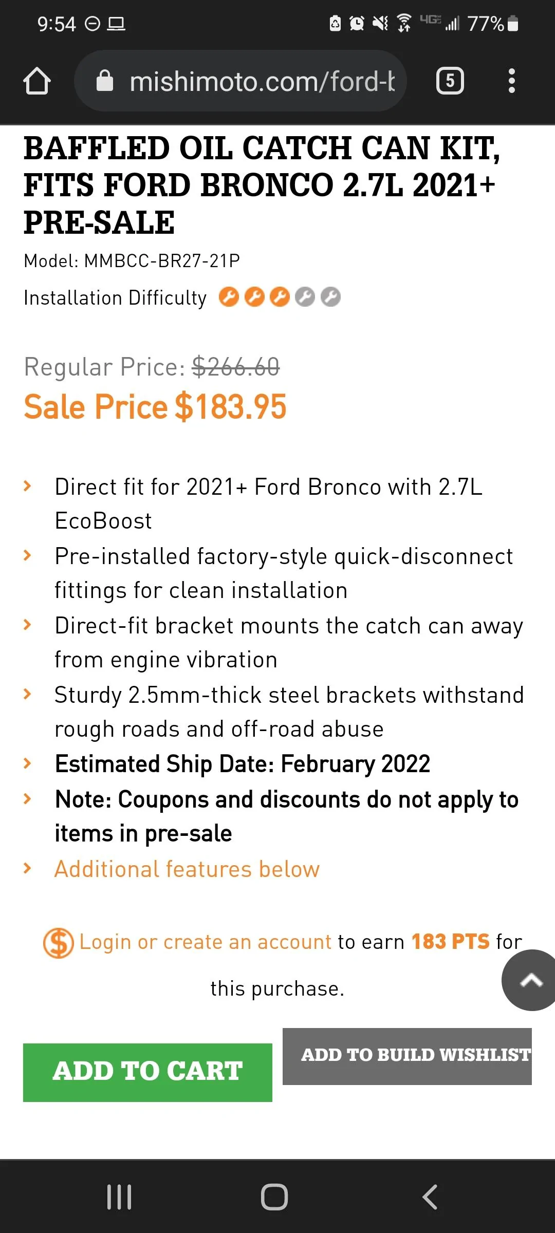

Yes, I did click the first link.
Ford Bronco Mishimoto catch can install with pics, tips and tricks Screenshot_20220226-095347_Chrom
Ford Bronco Mishimoto catch can install with pics, tips and tricks Screenshot_20220226-095424_Chrom
Look, at this point you seem pretty difficult to help further so I will leave you to whatever world it is that's so difficult.
