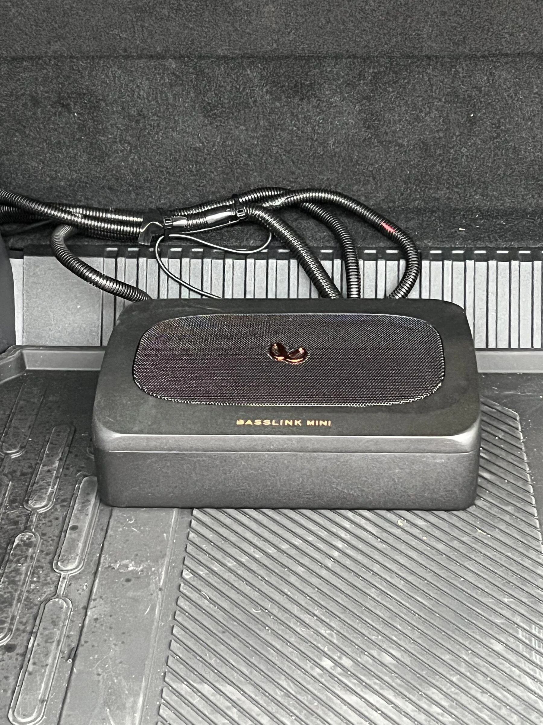

Nice! I installed an Infinity Basslink Mini in mine to enhance the sound and add some bass and I am impressed, it is shoebox size. It is in the cargo area.
Ford Bronco Mini Sub Install 0E138A36-090F-4F2B-91A6-2BF91C1864CE
