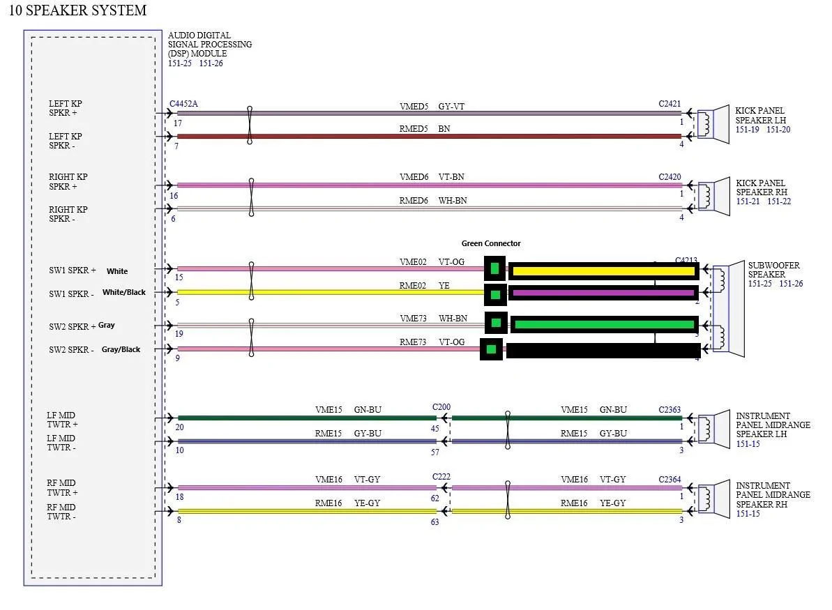

Hey all,
Installed the mobridge amp and will be replacing the OEM sub with an Alpine RS-SB10 in the back. If I want to use the wires from the OEM sub (Dual coil, 4 OHM) to my new one (single coil, 2 OHM) should I be joining the 2 positive wires (yellow/green in diagram below) as well as the 2 negative wires (purple/black) then hooking up? Appreciate any guidance here!

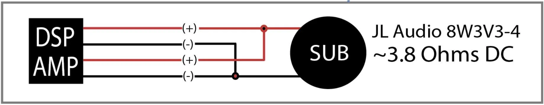

The Mobridge sub channels are bridged at the amplifier.
Single Coil Driver, don't need both pairs in this configuration but I use them anyhow for current carrying capacity:
Ford Bronco Mobridge - Non OEM Sub Install Help 1719869792465-fy
For a driver with dual coils, both channels are connected separately, in a similar fashion as the stock driver, instead of parallel as shown above. The resultant impedance would be 2 ohms at the amp for dual 4 ohm coils, as an example.

Thanks for the speedy response. Fraser from Mobridge happened to call me as well and confirmed this is the right approach. Cheers!
Dual Coil Driver:
It's been a long time since I messed with subs and they were all DVCs and the amps I used were never bridged at the amp... For the OP's Alpine RS-SB10, it's noted the subwoofer's dual 4Ω voice coils are internally wired to present a 2Ω load at the spring posts.
I just ordered the JL Stealthbox and the Mobridge setup... Just triple confirming it's the same wiring scenario as the OP, as it appears the stealthbox uses a TW1-2 10" 2-ohm subwoofer, which appears to be a single voice coil @ 2-ohm, so I'd wire like the first diagram...

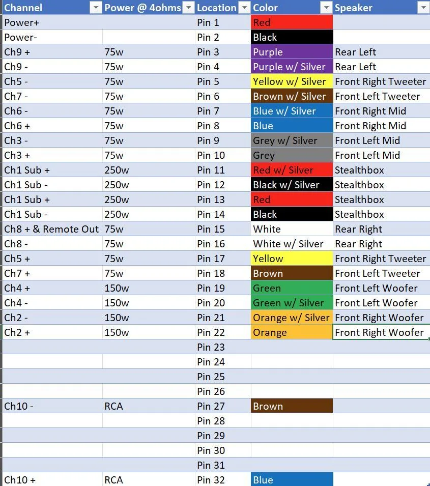

Should these just be soldered together and then use banana plugs to connect the box?
BlarneyStoned
Mar 25, 2021
243
291
Apple-at-cha
Bronco, Land Rover
Yes.
The sub channels are already connected internally in the amp (e.g. mono only), just connect the + wires (11 + 13) and the - wires (12+ 14) in the harness for a stealthbox. If you had a DVC you could wire one set to each coil, but electrically it's the same as combining the wires - you're either splitting the current across terminals for DVC or all together for a SVC. This is how I ran my channels for a 3 way active front + rear fill + stealthbox:
