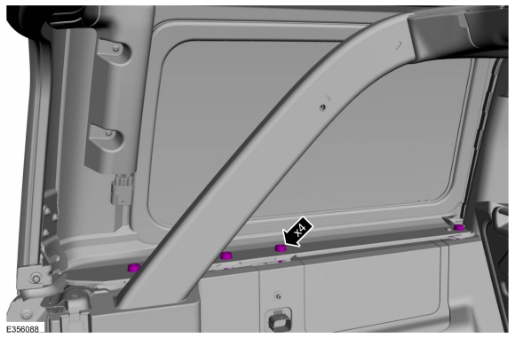

Ducati1098
10,002
23,258
Midwest
  1. Remove the hard top rear cap mounting bolts on C-piller.
    Torque: 106 lb.in (12 Nm)

  1. NOTE: LH side shown, RH similar.
    Remove the 4 bolts from each side.

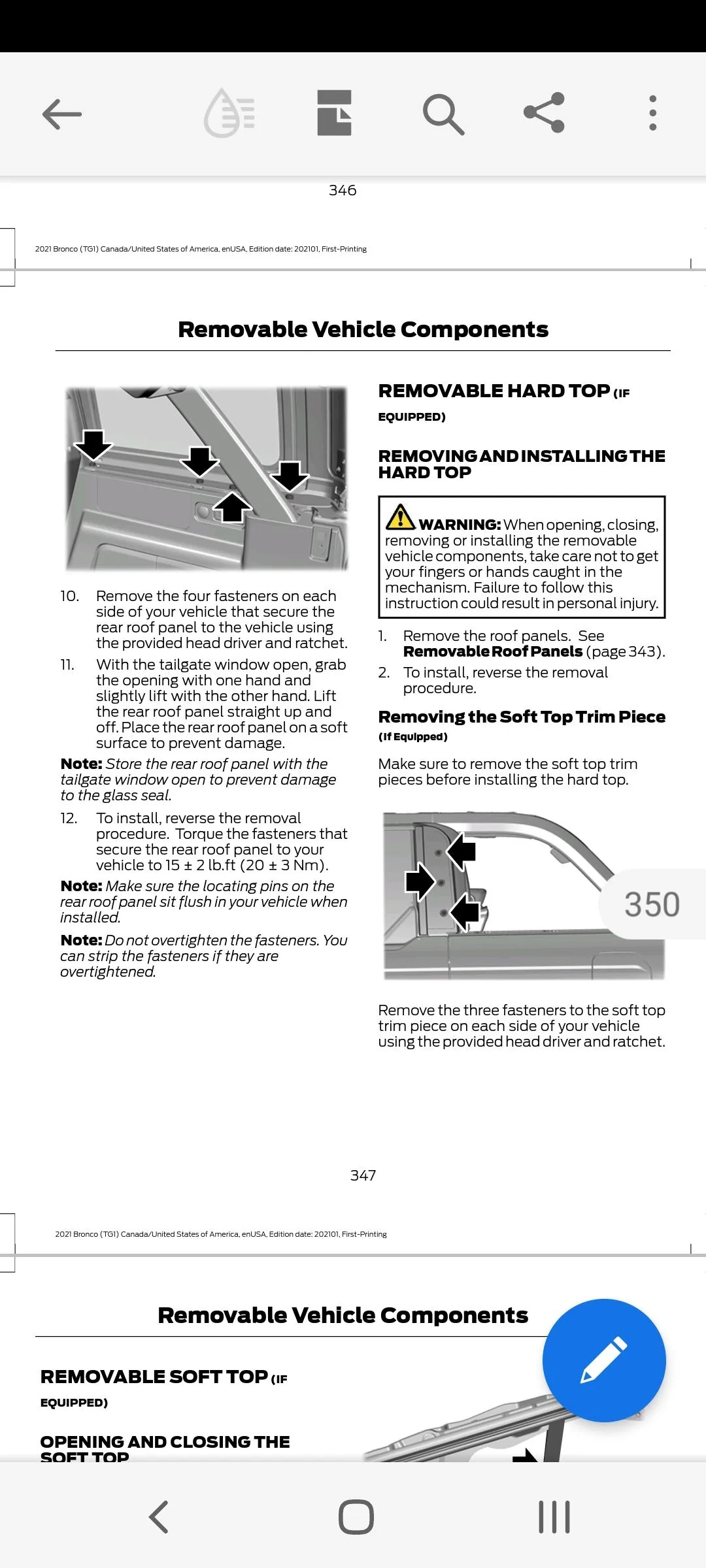

That is way lower than I expected. So only 9 ft Lbs?

Weird soft top side trim piece? Don't think I removed it for the hardtop install and I wonder why it needs to be removed?
I’m wondering the same thing. The soft price doesn’t seem to be built in a way it even comes close to touching the hard top. I’d like to just leave the soft top piece in all the time.
All the videos I watched never mention the softtop piece. Must be fine to leave in.
