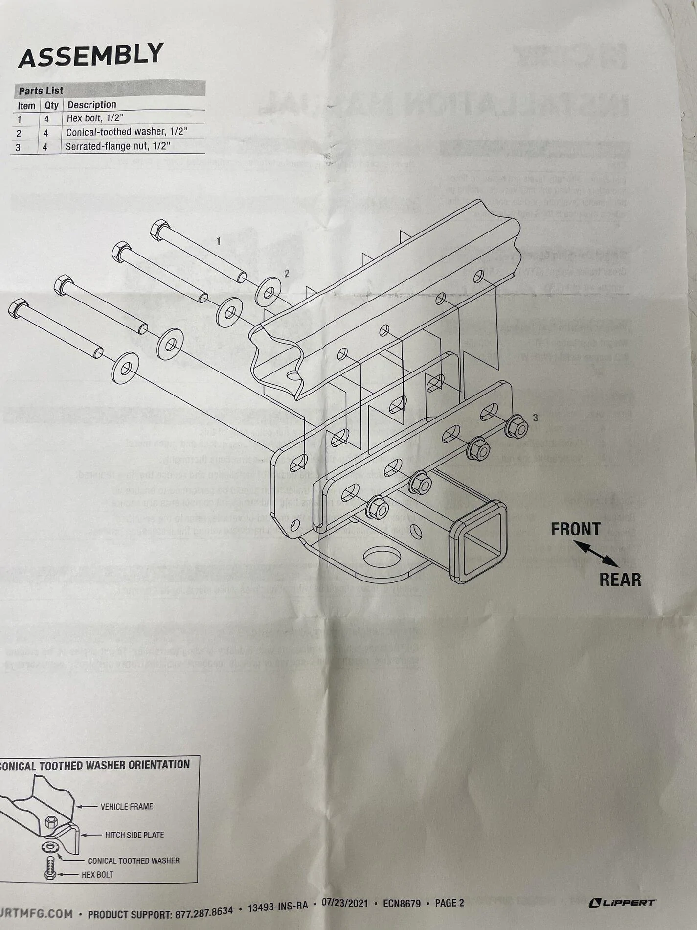

You don’t need to with the Curt hitch…110 ft-lbs. ~$120 from Realtruck.com

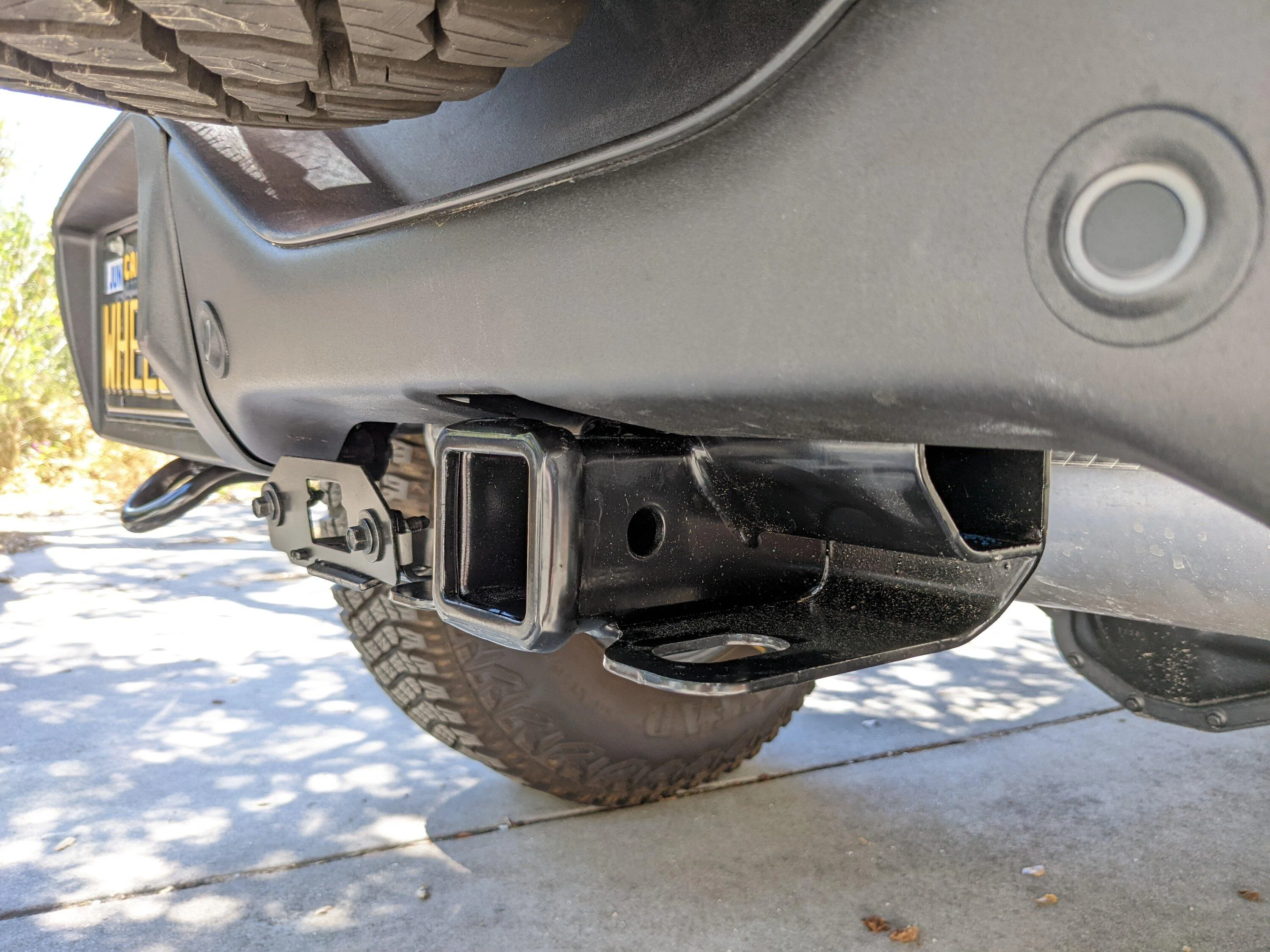

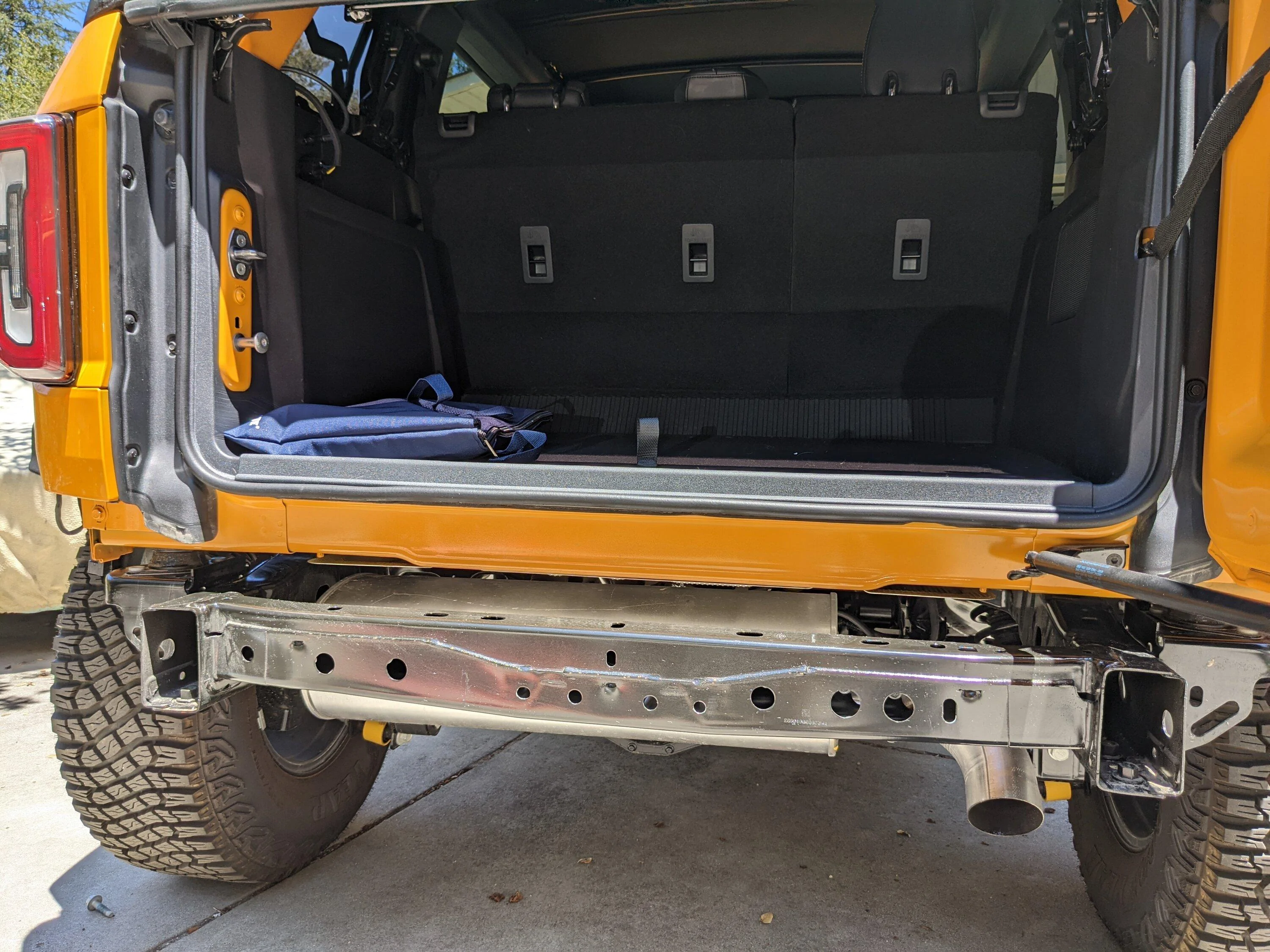

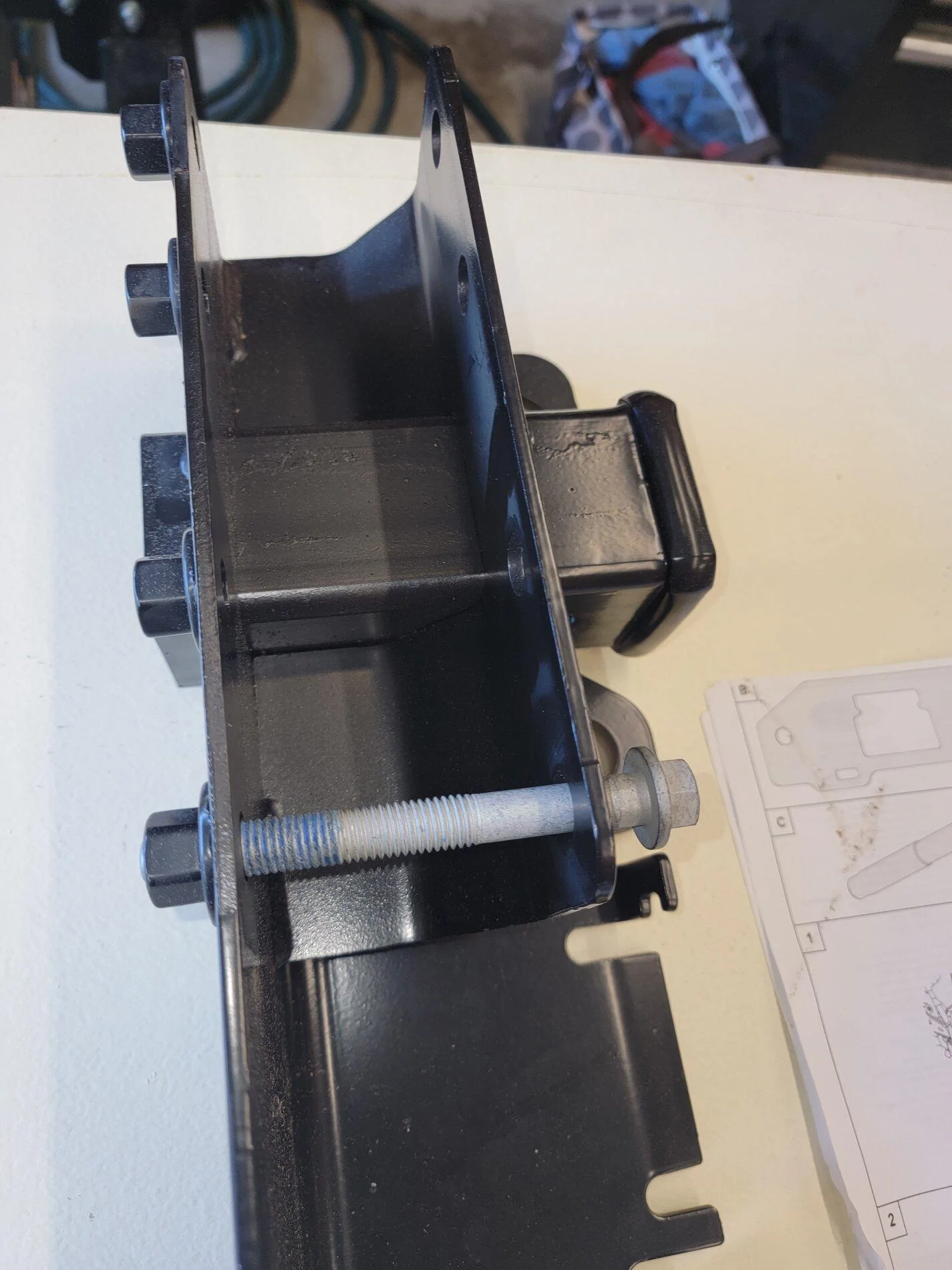

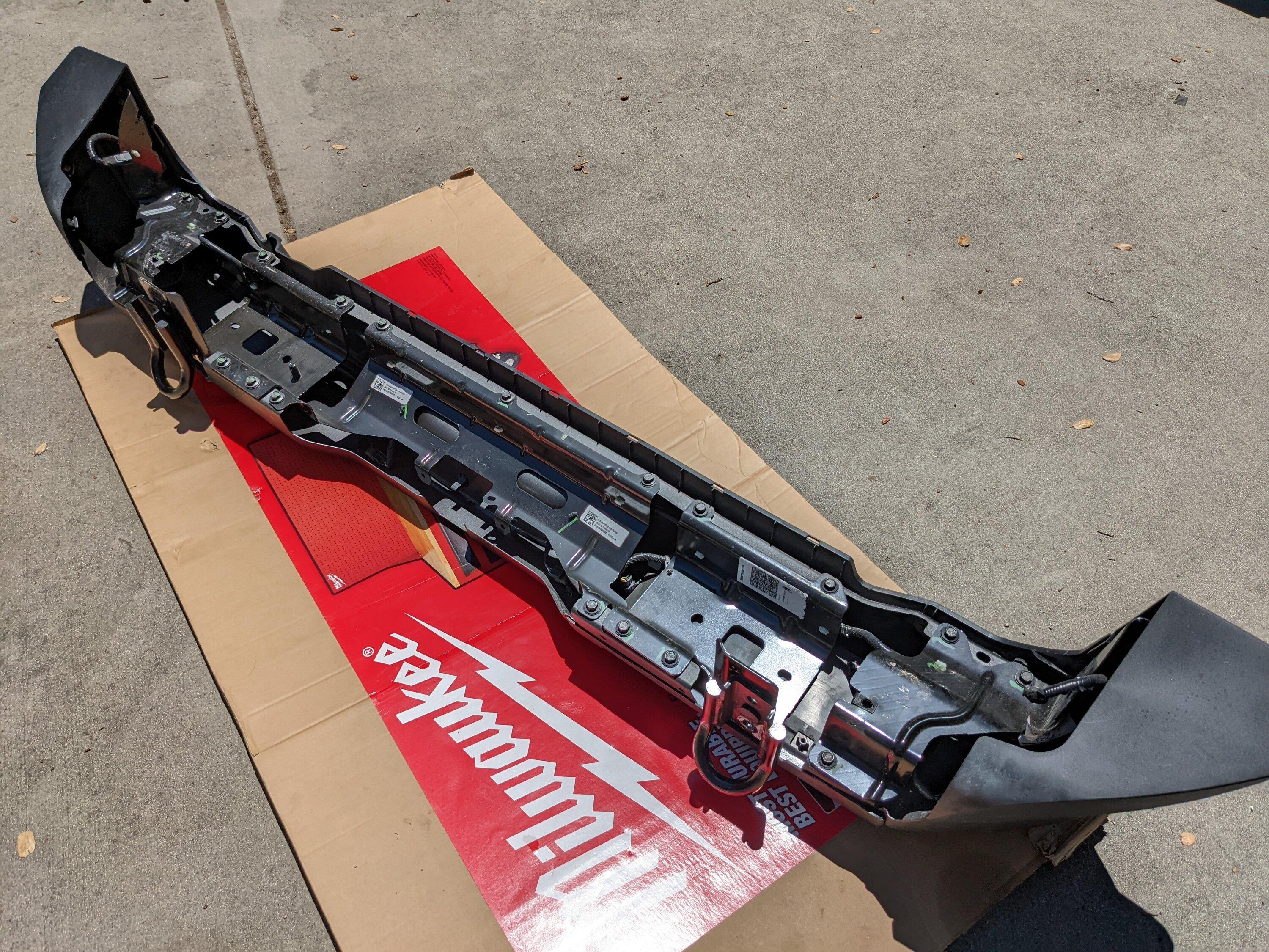

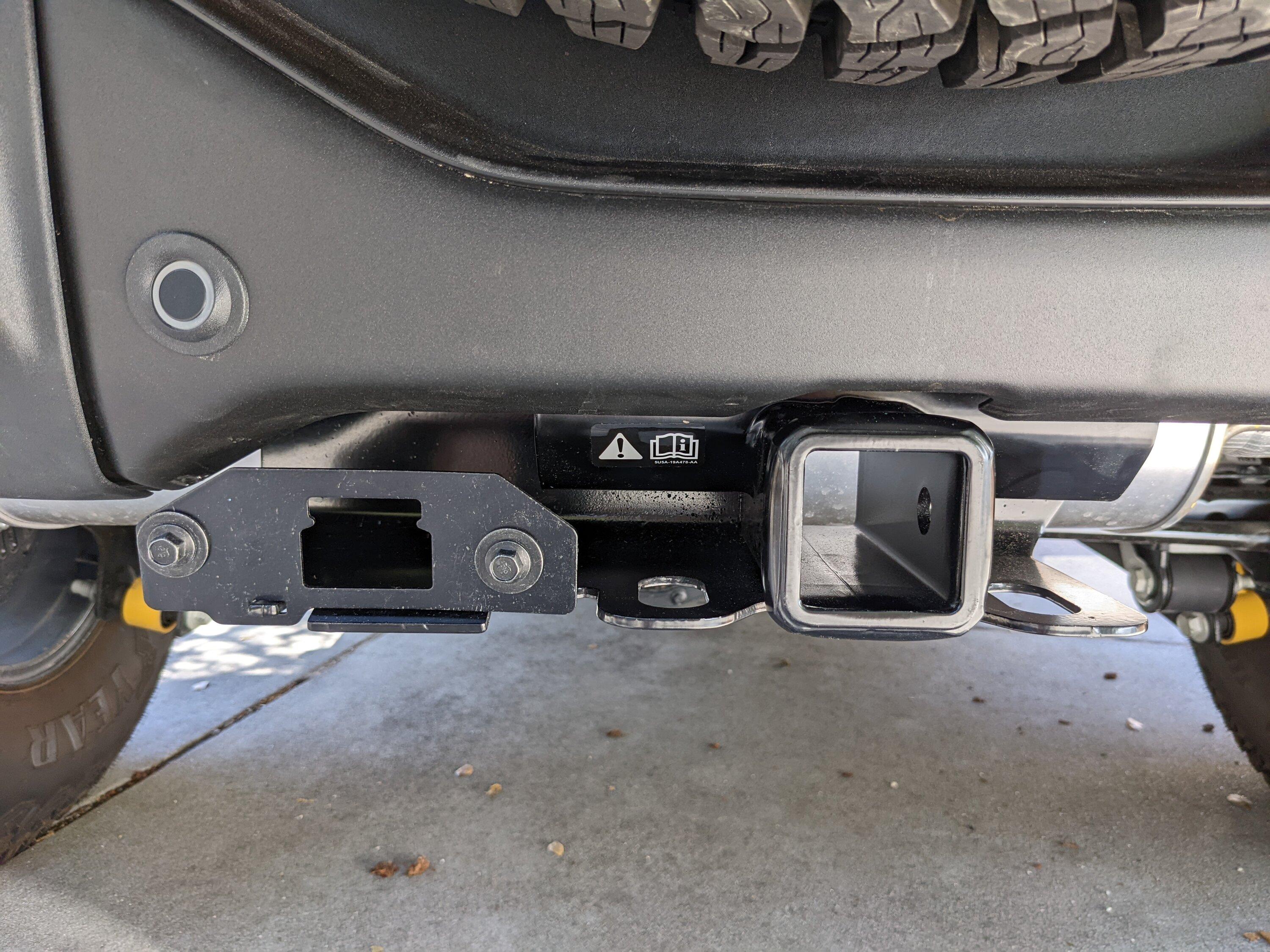

Just installed this - it's sturdy. Removal was fairly easy, but installation took two people holding each end, while a third person lines up the holes to insert the bolts. Not bad overall, and great factory fit and look.
Now on to figuring out how to connect the trailer tow harness to the tail lights.
Ford Bronco Installing tow hitch.  Rear bumper torque specs? PXL_20220709_193232656
Ford Bronco Installing tow hitch.  Rear bumper torque specs? PXL_20220709_220621324
Ford Bronco Installing tow hitch.  Rear bumper torque specs? PXL_20220709_220613887
Ford Bronco Installing tow hitch.  Rear bumper torque specs? PXL_20220709_193253507
