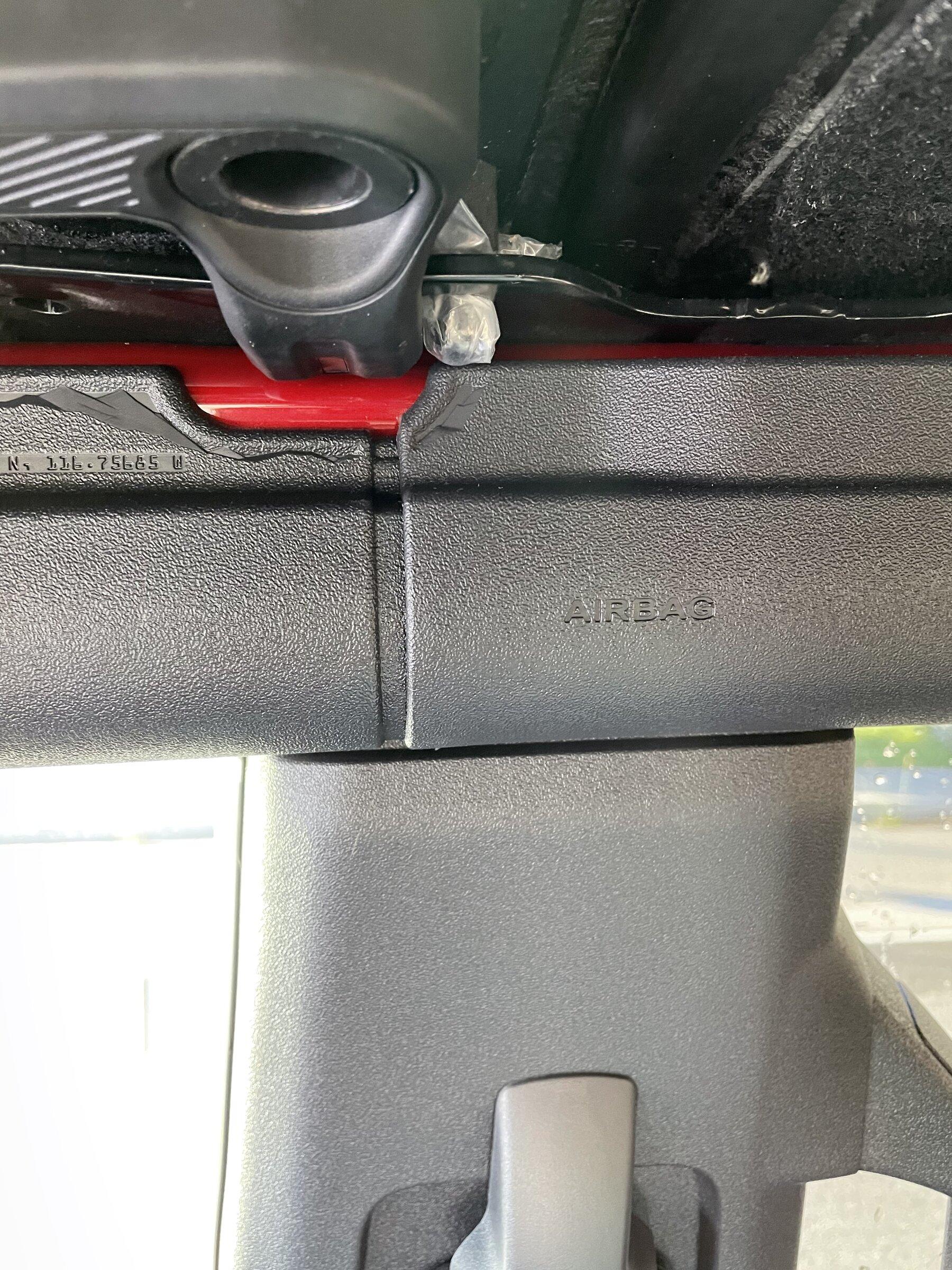

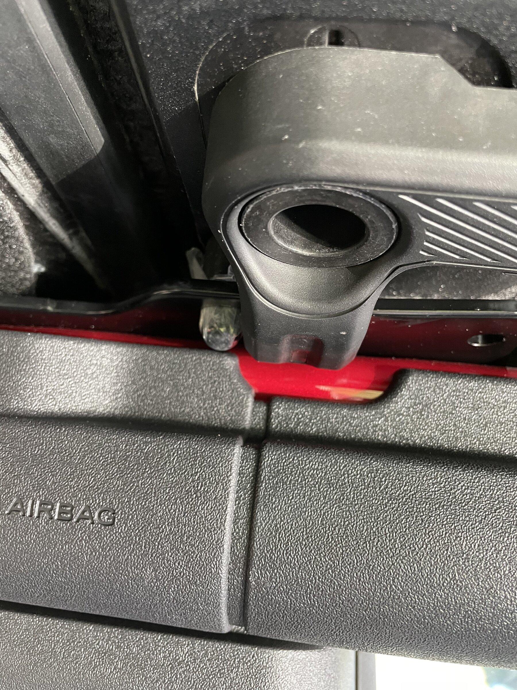

The popping noises can easily be fixed. It’s the guide pins. I made some condoms for them out of plastic wrapper and the noises are completely gone. It was driving me crazy. I will eventually do a more permanent fix somehow, or I suspect someone will release a silicon condom etc.

Temps in the PNW have been really low (upper 20s), which I suspected contributed to the front roof panels rattling. I saw your post and thought I'd investigate. I tried to use heat shrink tubing over the two outboard side posts but even with a tight fit the shrink tube is slightly too thick and would require replacement every time the panels are removed. And I'm not wild about exposing the roof panel to more heat.
When I replaced the panels, after my heat shrink tube experiment, I noticed the front header latch w/ metal hook (not the 3 "L" shaped latches) has a plastic trim piece on the end. I can shake it and it rattles horribly, both side-to-side and front-to-back. The one on the passenger side isn't as bad and only rattles slightly side-to-side.
I removed both roof panels again and used a small thin pry tool to spread the plastic trim piece on the latch. Then I wedged two cut pieces of heat shrink tube inside. No more plastic trim piece rattle. I haven't test driven it, yet, but I suspect that was the source of my rattle b/c the noise always seemed to originate from the pillar area while I was driving.
Maybe this will help someone.
