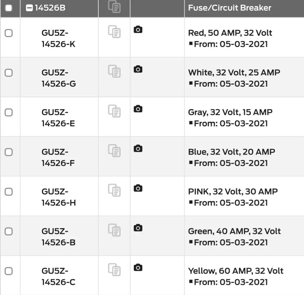

Not a multipack, but the correct part numbers for individual fuses.
You are the Best!!! Ur always here for us... Thank you !
If I find a multi variety pack, I'll add it to this post.

Hey, thanks! Did they fit the Bronco? I have a kit arriving Tuesday using PN's.
I'll compare them with ur kits dimensions and post it.
Fit just fine in the half-size holes. I took one out to check. I don't understand why there has to be so many different sizes (3?4?) in a Ford nowadays. Good luck!

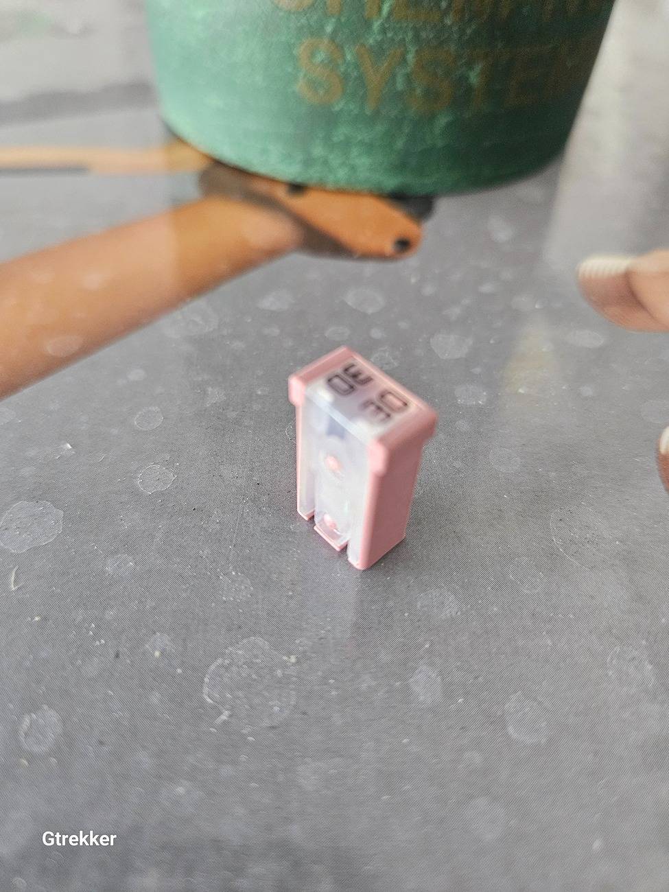

Update to original post...
The kit i ordered fit n compared to the ones that were recommended so all do work n just a matter of preference.
https://a.co/d/4QAuV1C
These are the ones that came in, 3rd attempt from Amazon.
I also layed the others inside the fuse box as spares, nice fit.
There appear to be more 30amps used so a few extra would be good to have available.
