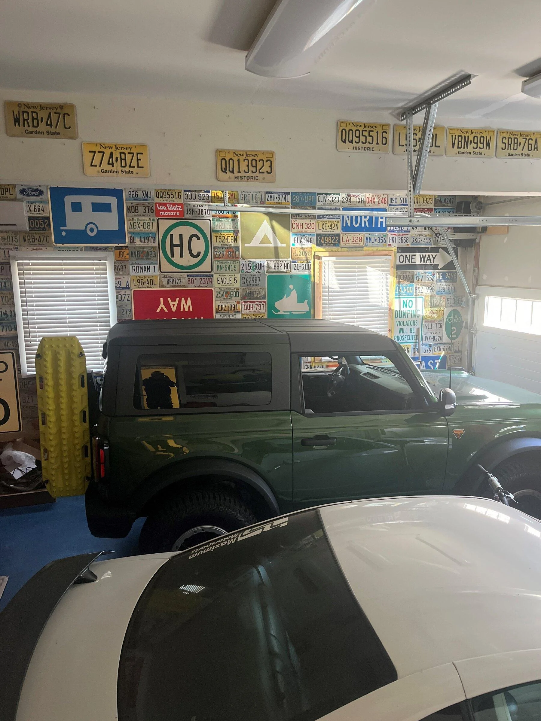

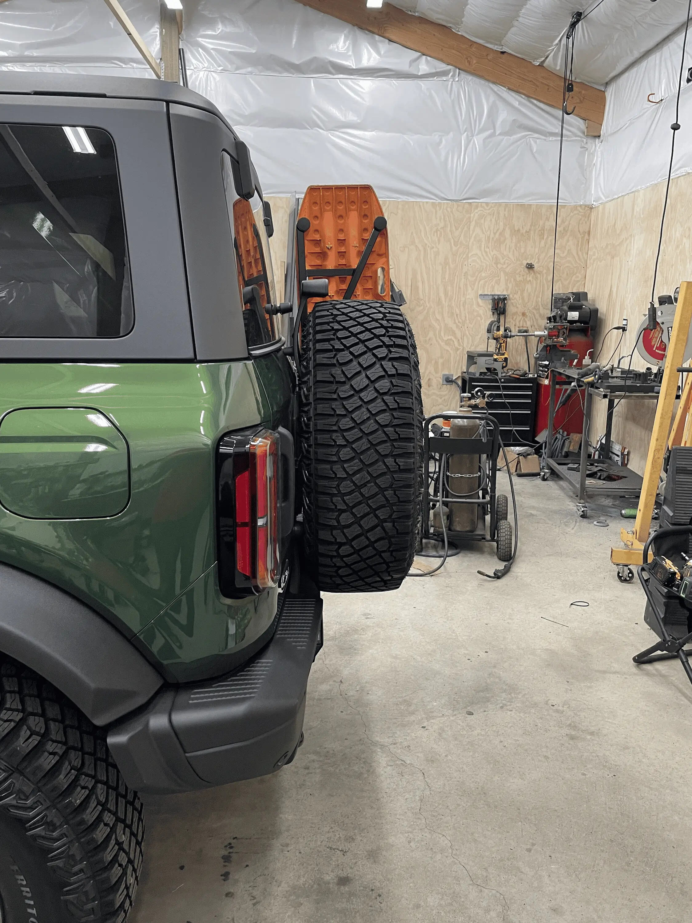

I have been pretty happy with this setup, as it mounts the boards solidly to the tire with easy access if needed. The roof wasn't an option, both kids, and myself, prefer to explore the state forest by us with the roof of.
This is how I mounted them. I didn't want them horizontally across the top of the tire, although that would have been even easier. I drilled new mounting holes to lift the boards and give clearance to the bumper. The plate was designed around Maxtrax boards so the pins bolted right on. I have been out in the woods and mud holes a few times, they haven't move moved and they don't rattle at all.

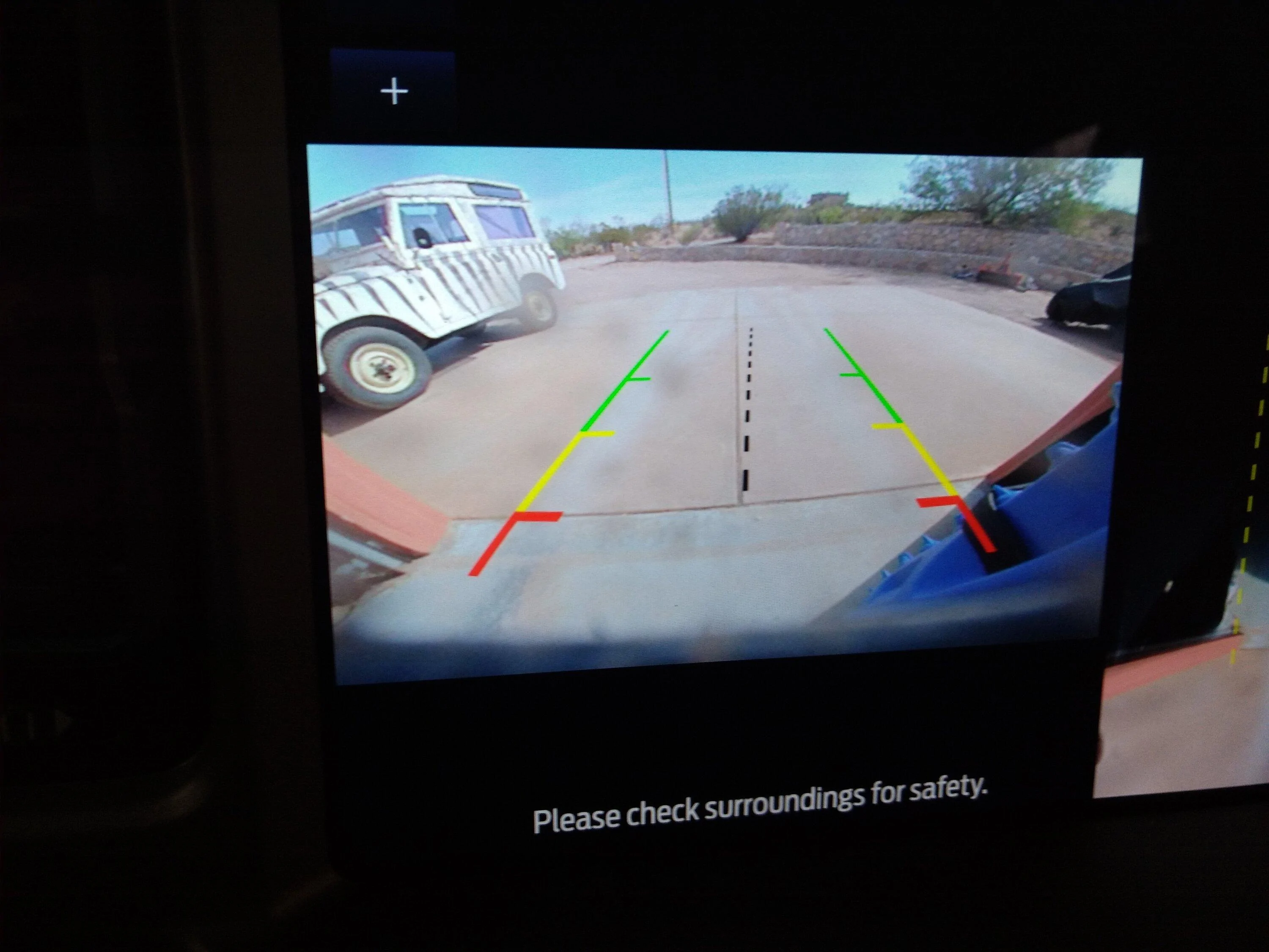

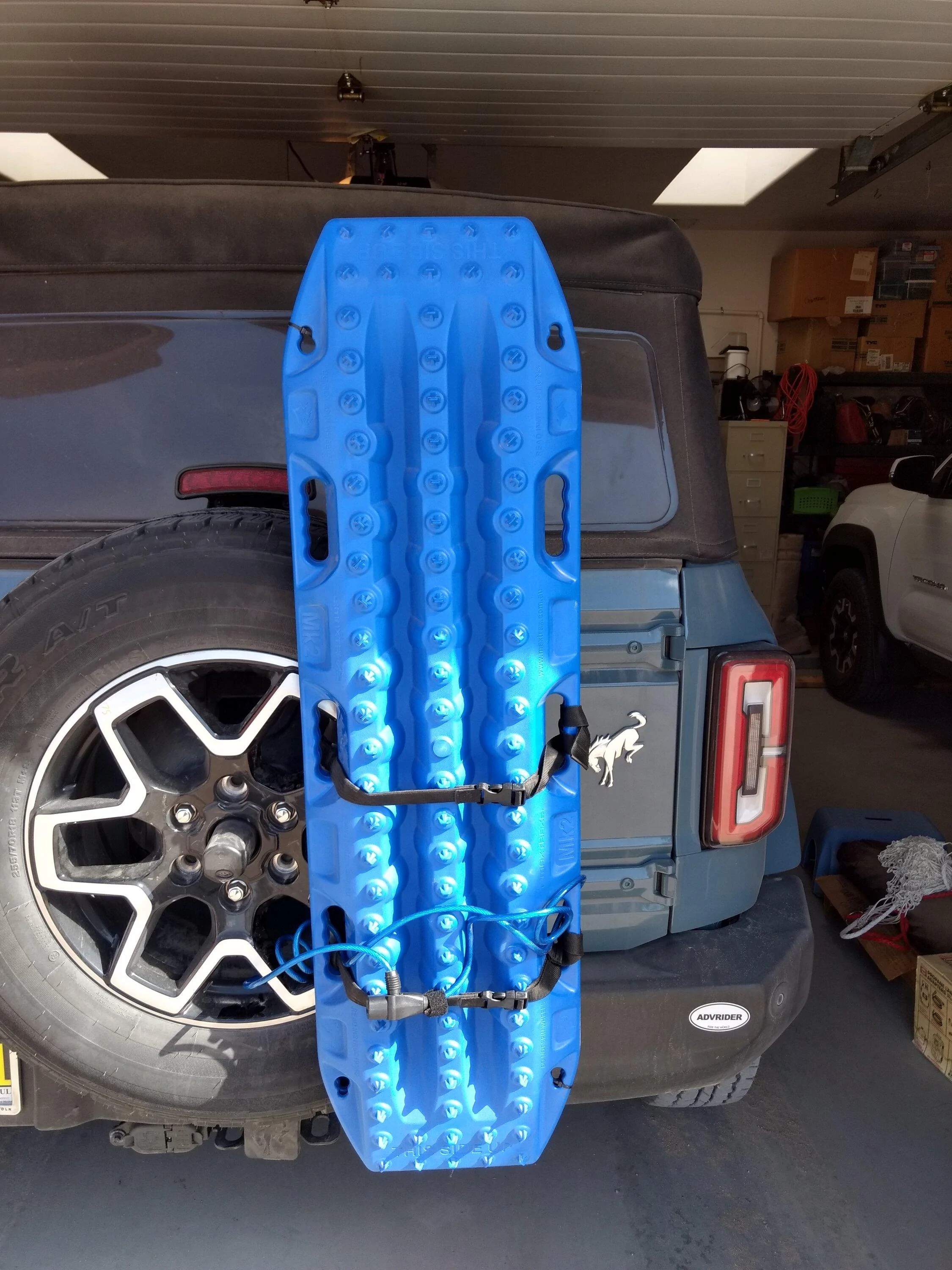

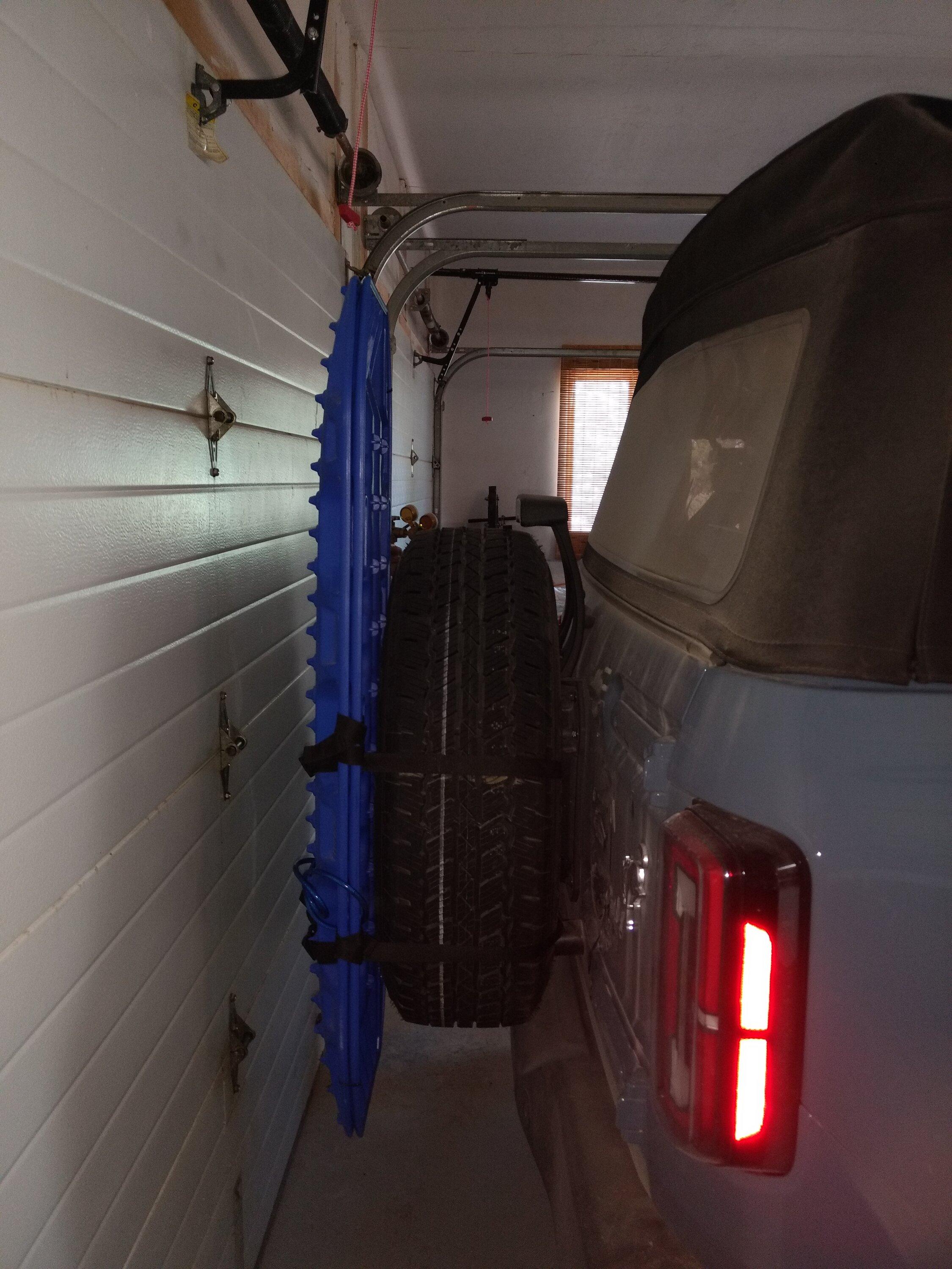

The OBX stock wheels have spokes in good places to mount the ROK Straps so the Maxtrax's are off to one side. Attached just like the Jeep video but located off to the side so the camera still works. You only see a small part in the camera. You have to mount it as high as possible or the backup sensor beeps every time you put it into reverse.

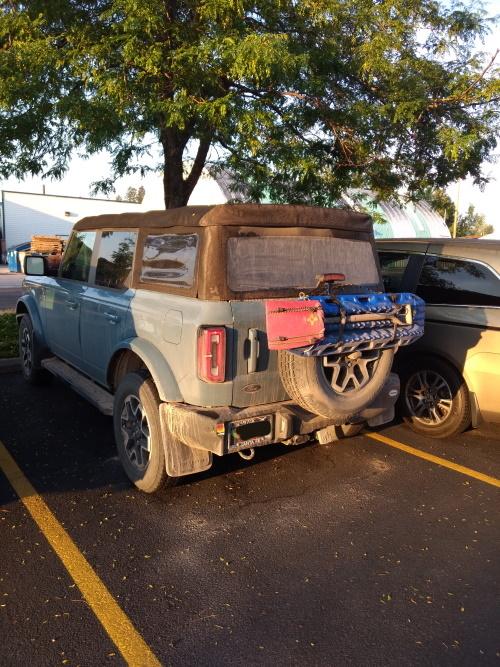

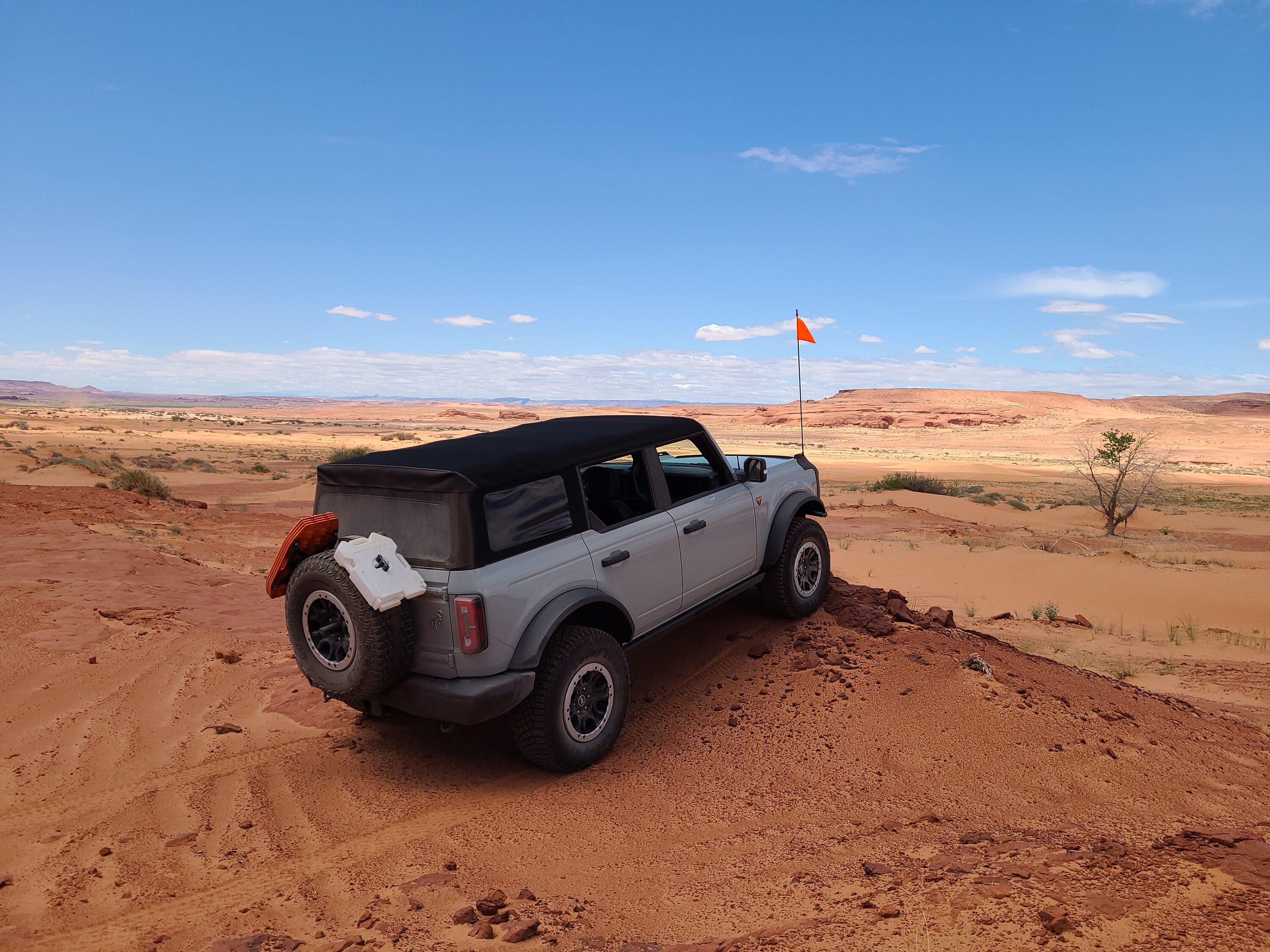

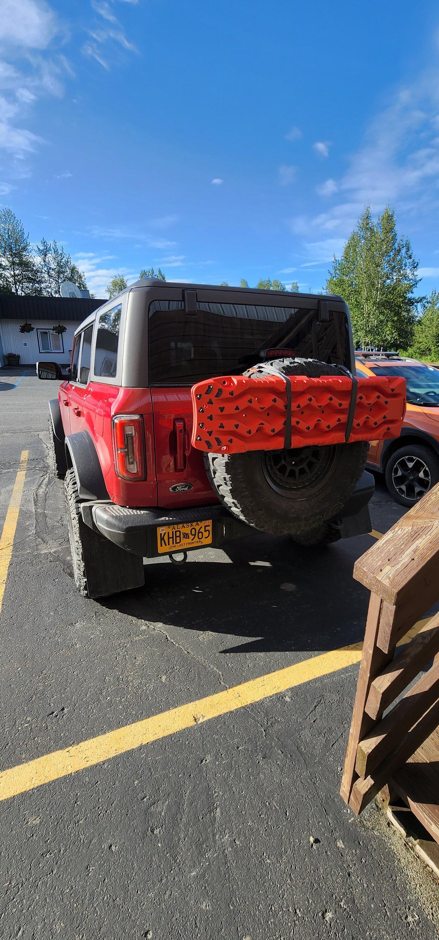

Were you thinking horizontally against the wheel face, above the camera? This is what I'm envisioning, just waiting to see someone else do it and if it fits.
It's not the easiest on and off and we'll see how well they stay put on rough roads but imma find out.

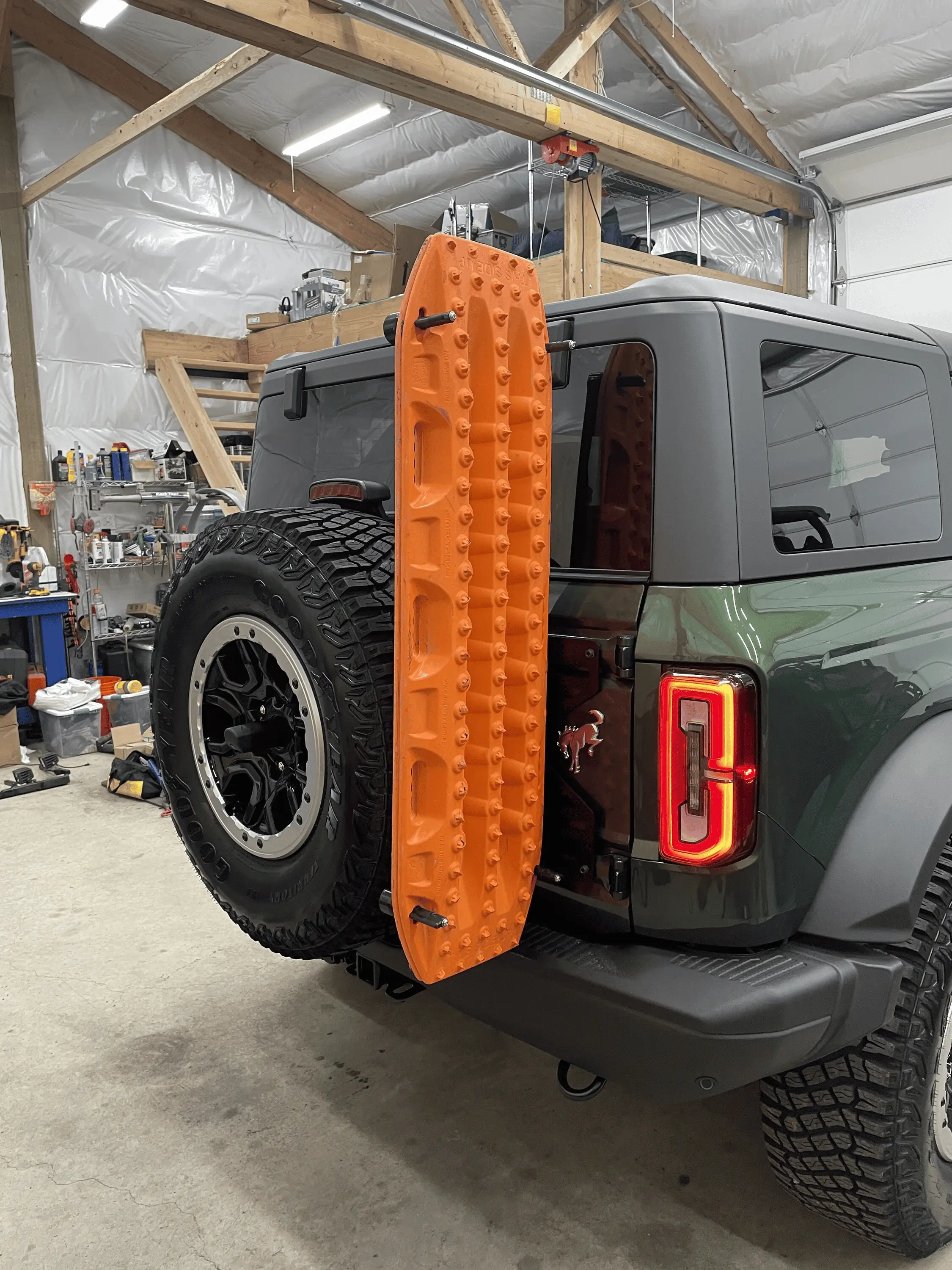

I added the Hammer Bilt reinforcement kit with the Maxtrax plate ordered (still in R&D. While waiting for the Hammer bilt plate I was able to mount the RacksBrax plate for now.

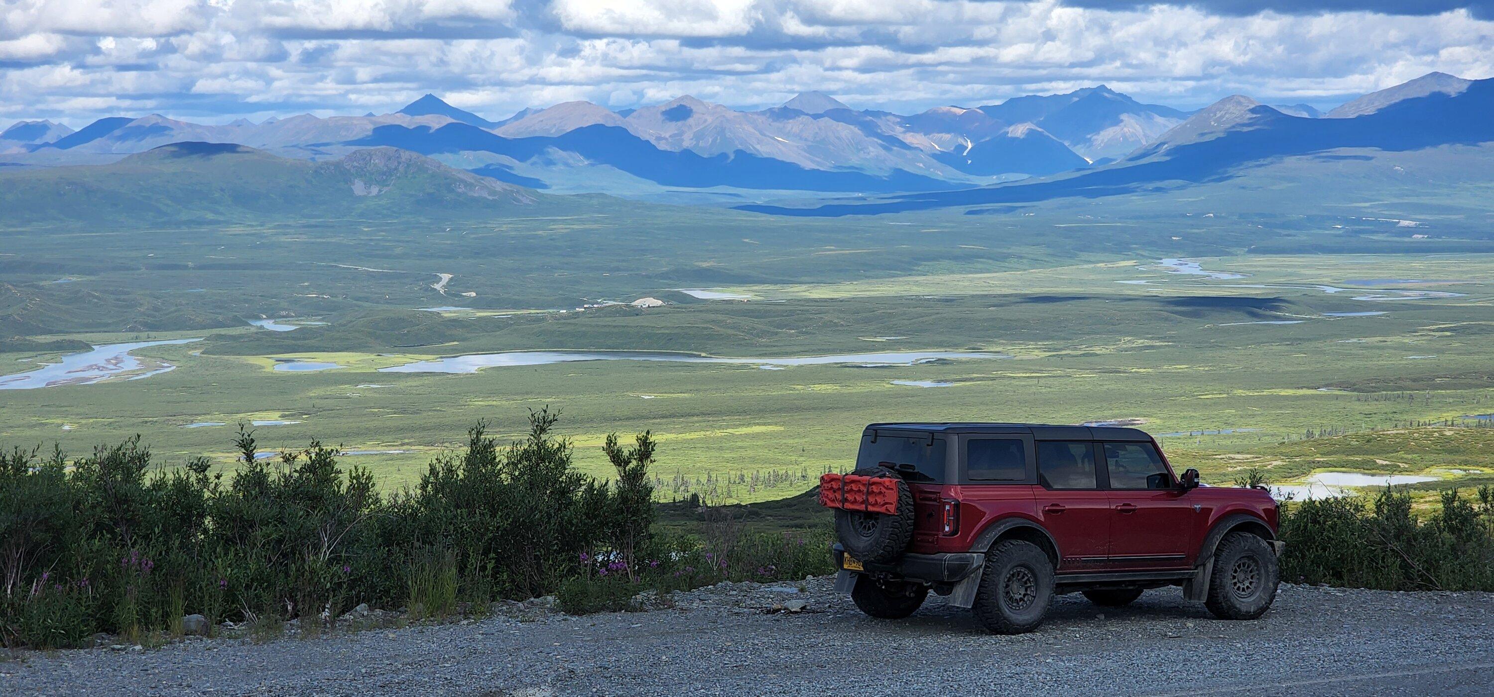

4,400 miles on the CDT and the freeway home and no problems with ROK Straps.

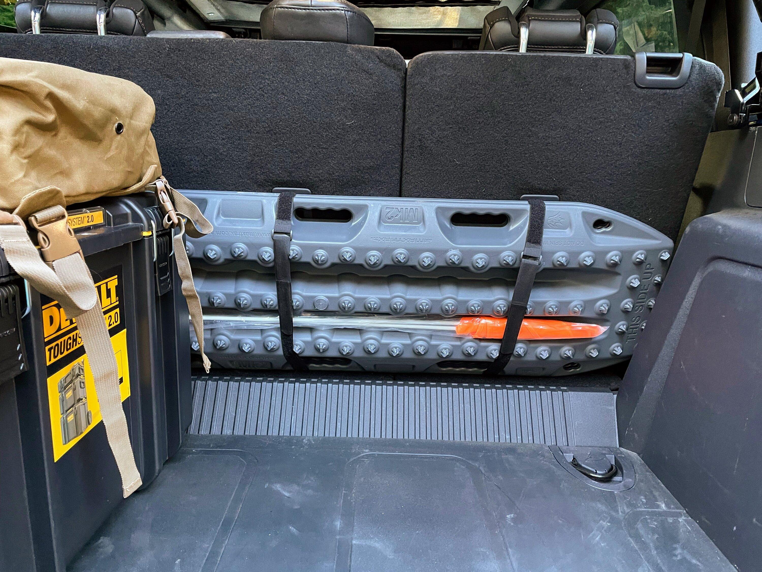

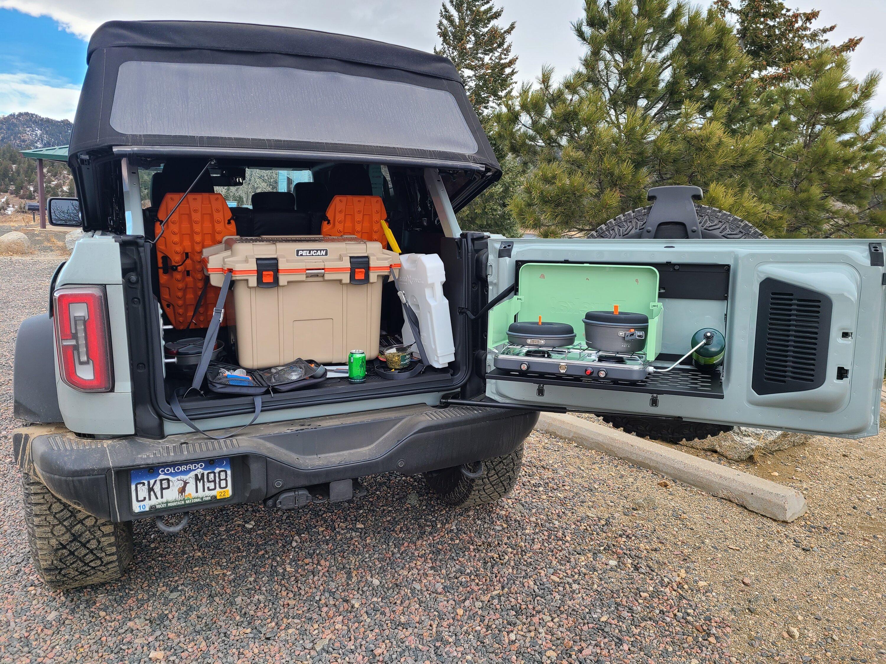

Also fits snug, right between the back seats and the wheel wells
Ford Bronco Maxtrax mounting options with a soft top Bronco C3BC7653-CB24-4DCF-B353-EF5E948732E5
