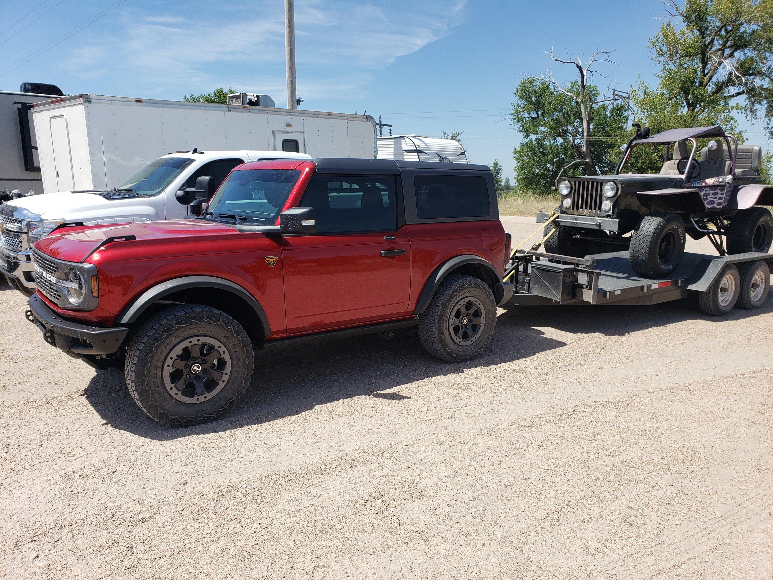

Almost 11k on my badlands no issues, and she's pulled some weight
Ford Bronco Manual Transmission in for replacement! IMG_20220814_011955_596
Thank goodness you have a trailer that you can use when your transmission goes out...plus a chevy to get it to the dealer!
