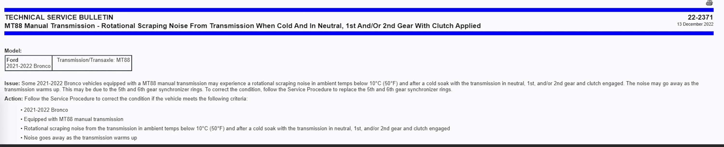

Someone sent me the TSB, here it is: 22-2371
I've been told service is:
