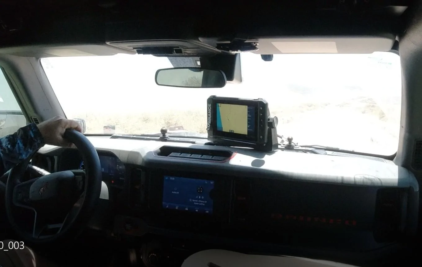

I have an Archtype Racing rail in my bronco and stick it on there. I was concerned about it bouncing around when I went down to Baja but it worked like a champ, no problems.
Ford Bronco Lowrance GPS Mount? ScreenHunter 1570
Did you bolt the bracket to the rail or use a ball/arm?

Yes, I bolt the Lowrance bracket straight to the railing. And yes, at higher rates of speed, the internal antennas on the lowrance and the other GPS units (Garmin-that others were using during our Baja trip) said the internal antennas couldn't keep up with their travel and they would miss crucial turns. I never had a problem like that since I have the external mount.
We are headed out to Baja in two weeks and will use the same setup and shouldn't have issues. This week I plan on connecting my Starlink dish to the top of my bronco giving me internet the whole way. I'll try connecting to an online map and seeing how that works but the Lowrance is a cheaper way to go and less aggravation.

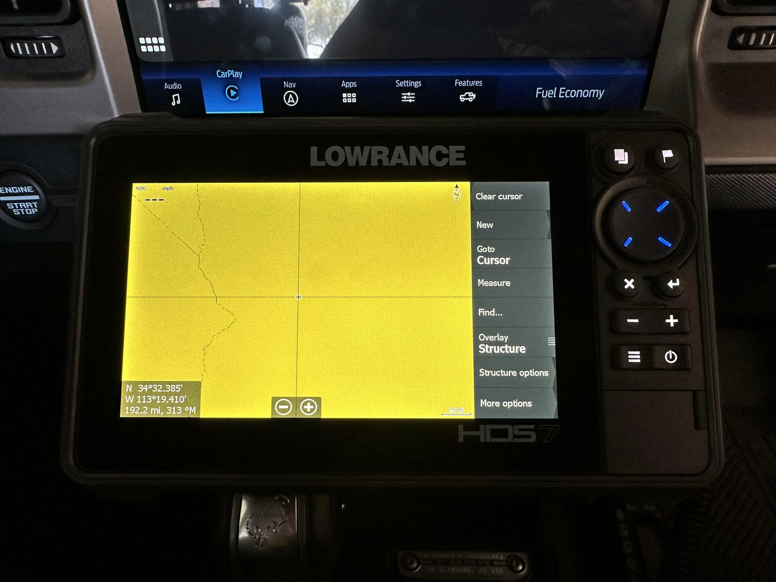

Just saw this thread. This pic is on my build thread. HDS 7.
Ford Bronco Lowrance GPS Mount? 131E5641-854D-4A00-A249-6202790F4FE3

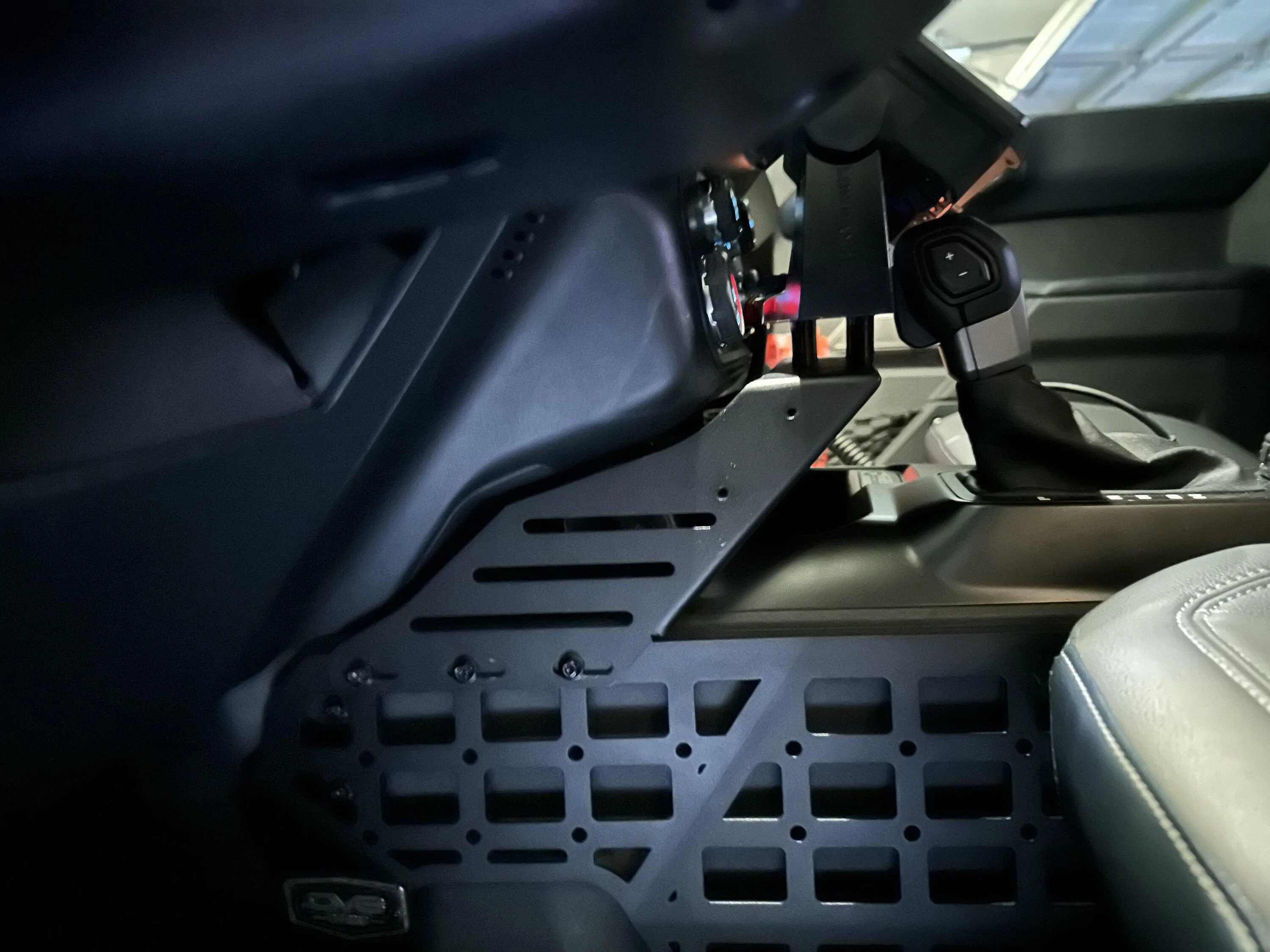

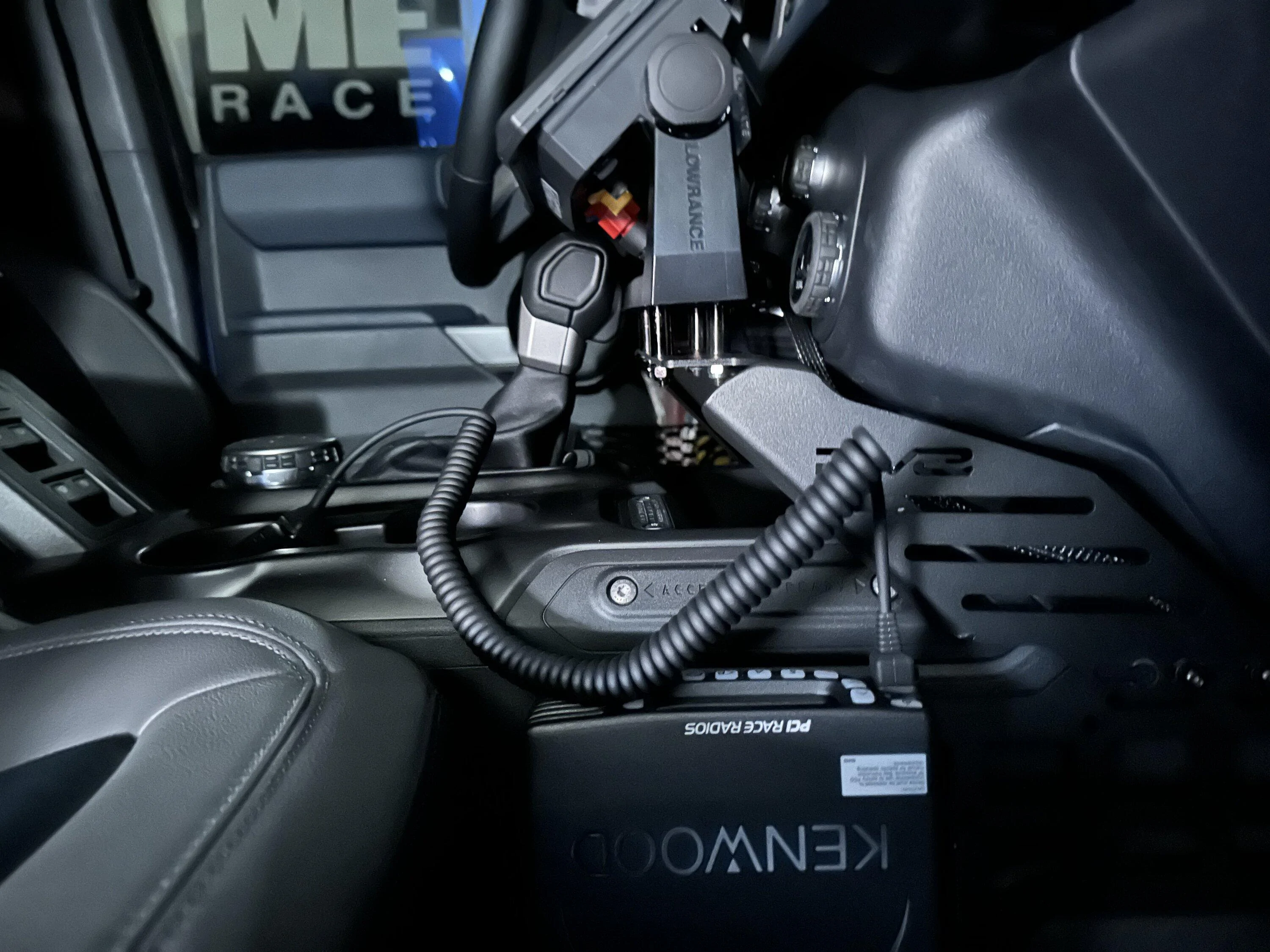

How is this mounted?
The DV8 bridge, I’ll take some side shots, post them up. Couple of issues, when I put it together. Had to drill out 4 new holes, then the first time, shifter didn’t clear. Bought 4 inch spacers, fits now, no rubbing.
Ford Bronco Lowrance GPS Mount? 7439A60B-11B4-44C3-9EEB-A0A11AB851BA
Ford Bronco Lowrance GPS Mount? 931DB26A-DCF2-4021-BD8B-504AFD60FB8E
