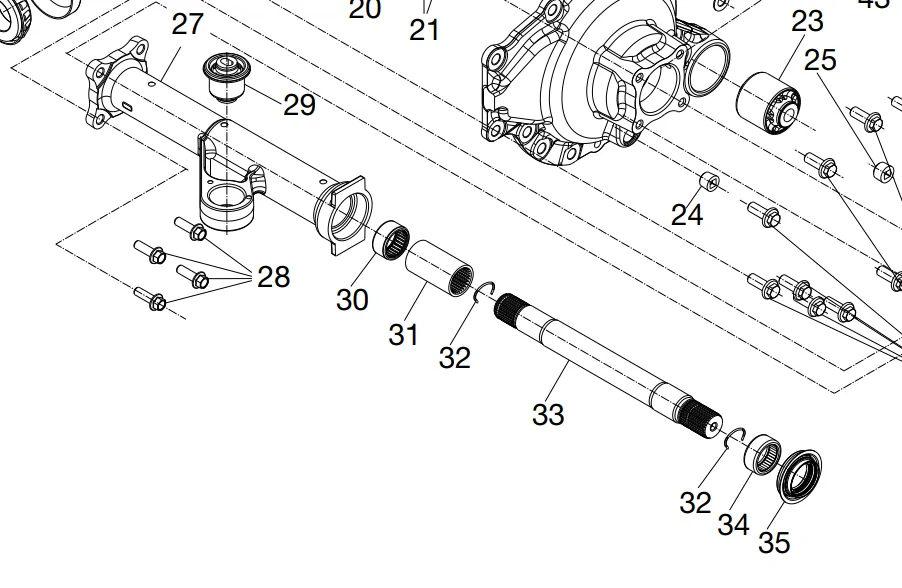

I don't think i would worry to much, at least with respect to the FDU. There isn’t a lot in that axle tube - the axle extension just has a couple of roller bearings and a cheesy axle seal, and it's only held in with a collar with a circlip on it. It's pretty loose by design - everything designed to be installed by hand without needing a press or anything, so the bearings are not tight and the axle seal is pretty loose.
The FAD m190 is a bit tighter, but only because it has a bit more going on in there.
Ford Bronco Passenger side sway bar link (issue resolved). 1783802693845-pd
I'd agree with Popo - probably the CV, but I wouldn't change it out until the noise becomes non-stop (or it finally breaks)
