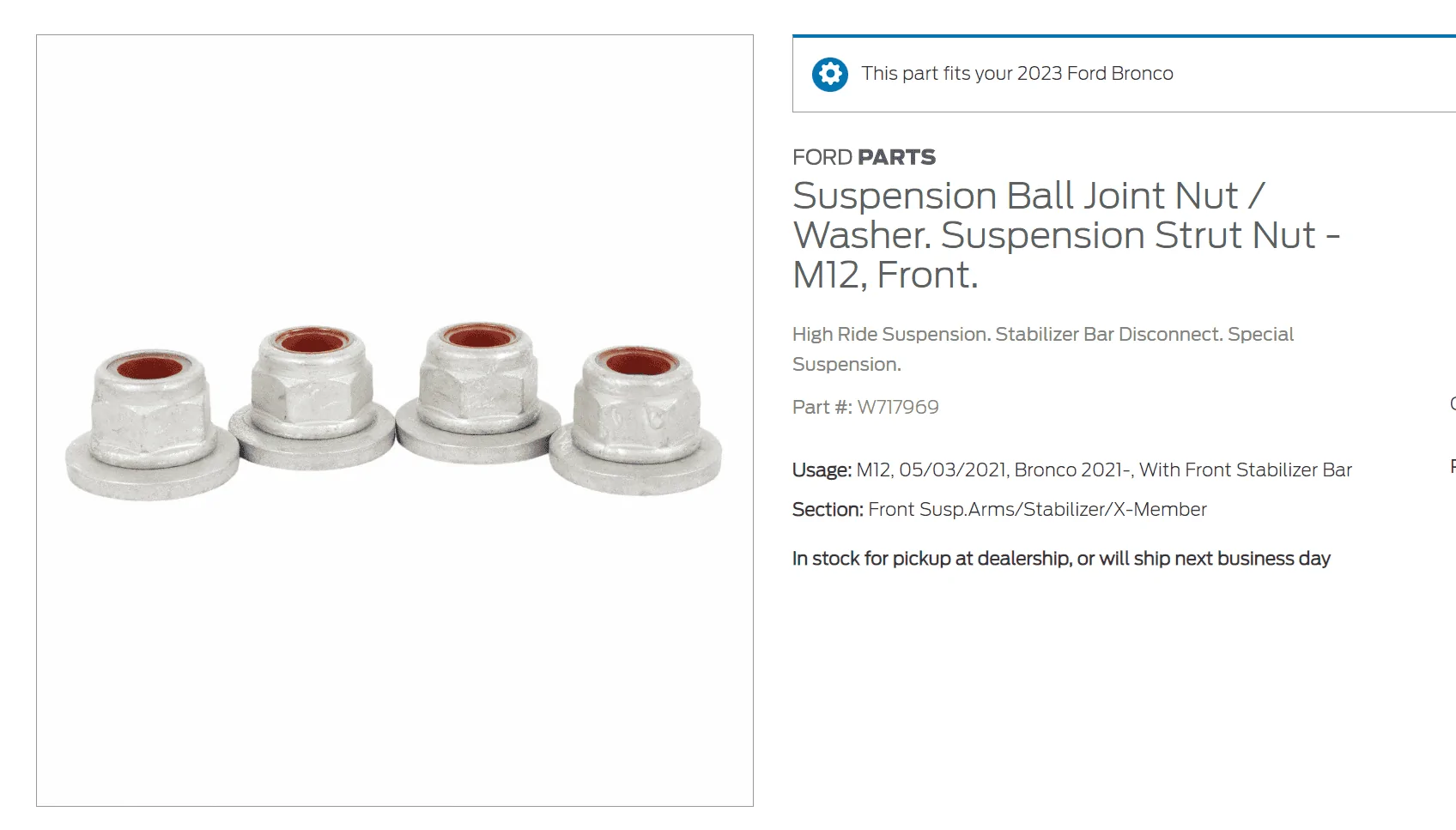

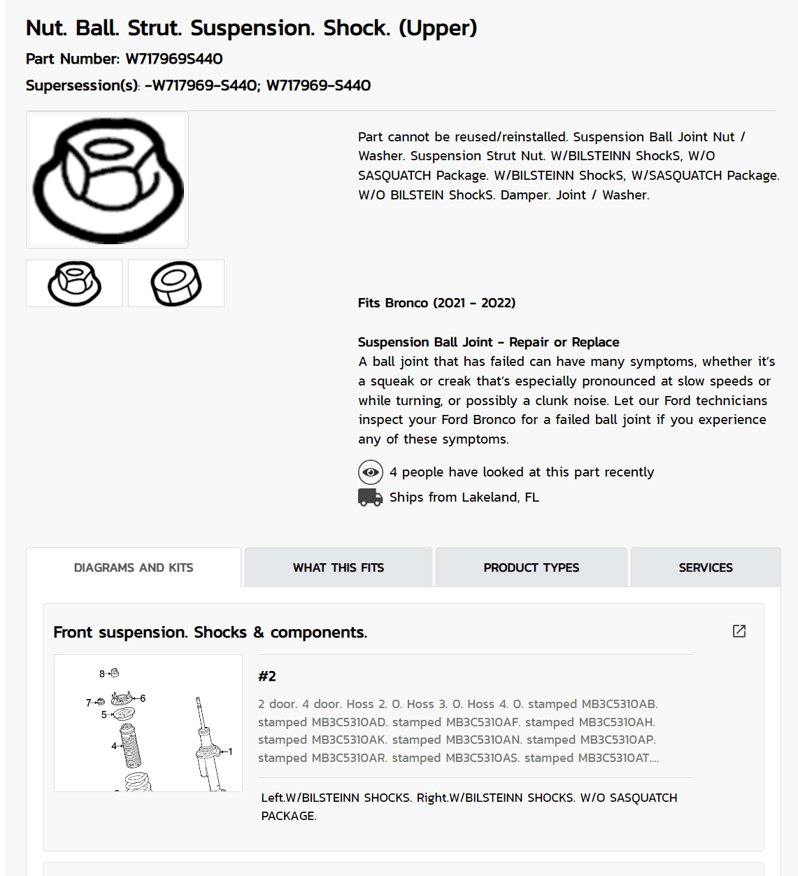

I believe this is the part number; W717969S440. They look correct. I've ordered a set and will update once I confirm.
Are you sayign the bolt on the bottom of the A arm is single use or is this on the upper control arm? I have mine I am about to put on but I want to avoid using a bolt over it thats not its intent.
The nuts that attach to the strut on the lower control arm are listed as single use. The RCI lower control arm skid attaches to these bolts. Even though I bought replacements, I reused the nuts and added some Loctite.

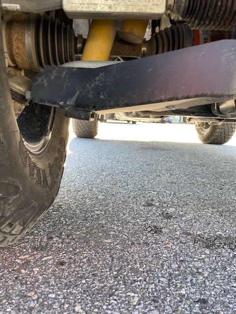

Do yours happen to rub or contact at full lock? Mine might have in a parking lot today… need to investigate more
Did you figure out what the rub was with the Rci A arm skid when you turn the wheel full.

I had the same issue Rci an arm skid plate touching the wheel. I had to create a notch in the skid plate to prevent it.

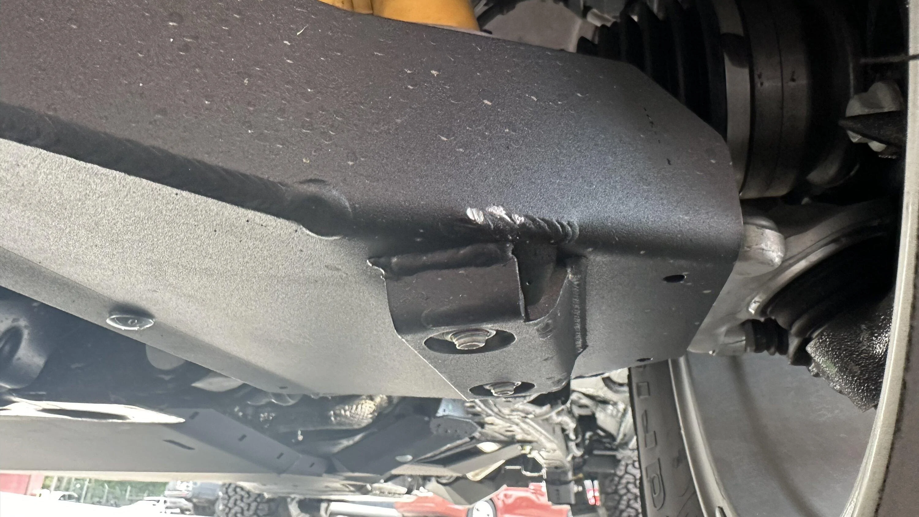

I am, after having them on a few months. The skid hits the control arm a little. On the outer most edge (closest to the tire), there is hardly any clearance. I haven't hit anything or bent it, but now I am hearing a little clunking noise when I turn and am going over bumps. I think they updated their page after I had issues with the rear skids not fitting, they added the HOSS 3.0 that day as not compatible. They work just fine, but make some noise.
I'm looking at other options just in case. I don't want to wear a spot off the control arm if it rubs there.

Nope. And actually after looking at the part number for a lower control arm, same on all Broncos, HOSS does not seem to make a difference. Not sure what the next step is.
