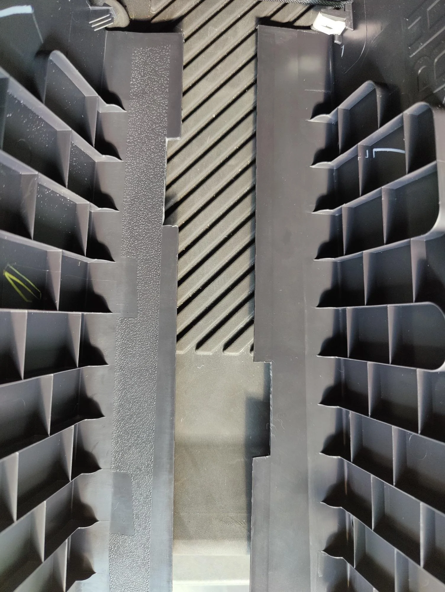

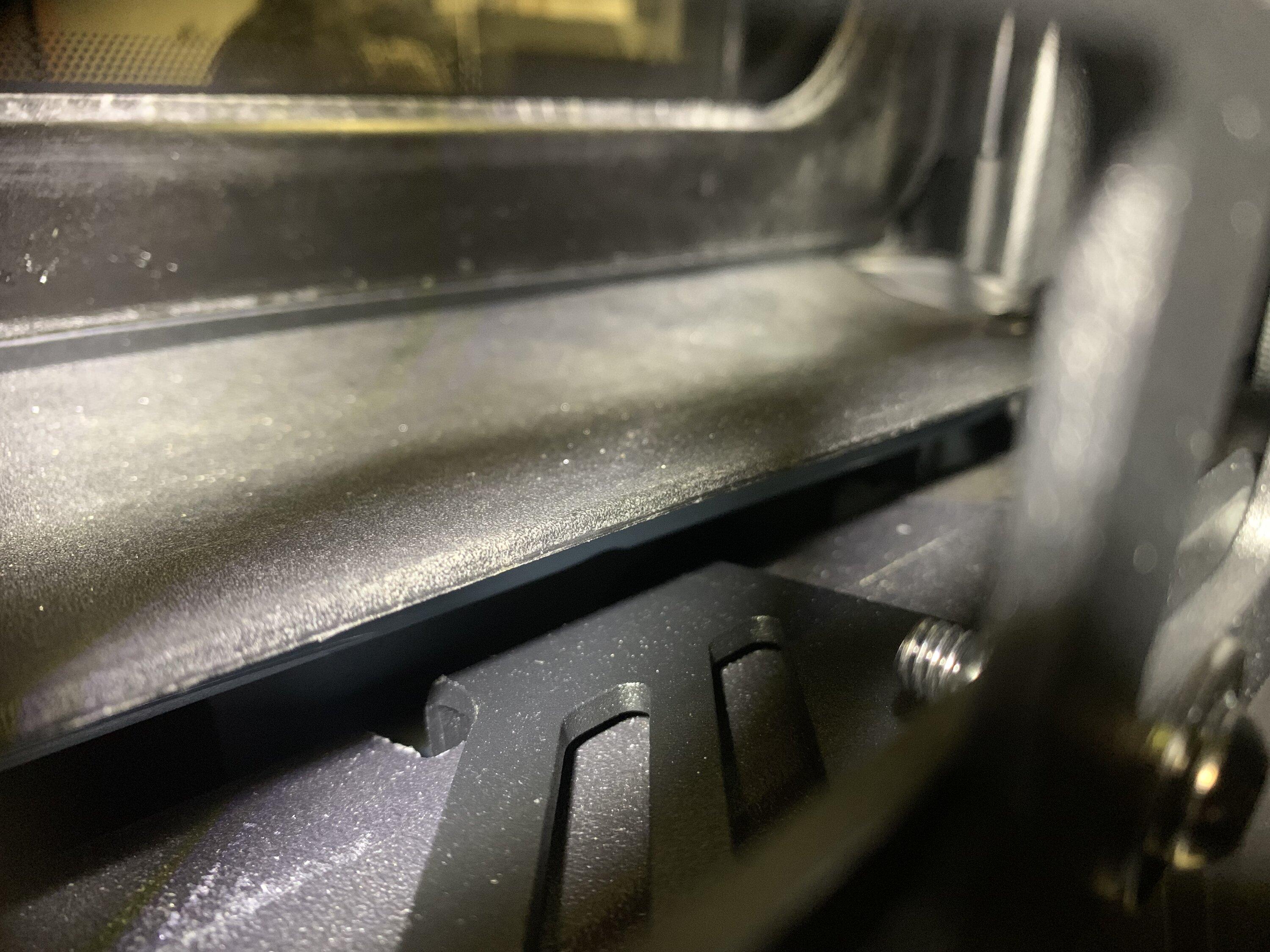

Welp, I answered my own question. At the end of the install I put the trim panels back on as far as they'd go then marked the width of the bracket. I tried a metal tool file first but found a razor blade utility knife much quicker. The left trim panel has a bumpy section on its reverse side and, as luck would have it, it's the perfect depth to cut to. The right trim also has a slightly dark line on the back around the same depth, which also worked great.
Ford Bronco Looking for molle panels for rear windows IMG_20230909_164345-2
Ford Bronco Looking for molle panels for rear windows IMG_20230909_170501__01-2
Ford Bronco Looking for molle panels for rear windows IMG_20230909_170553_01-2

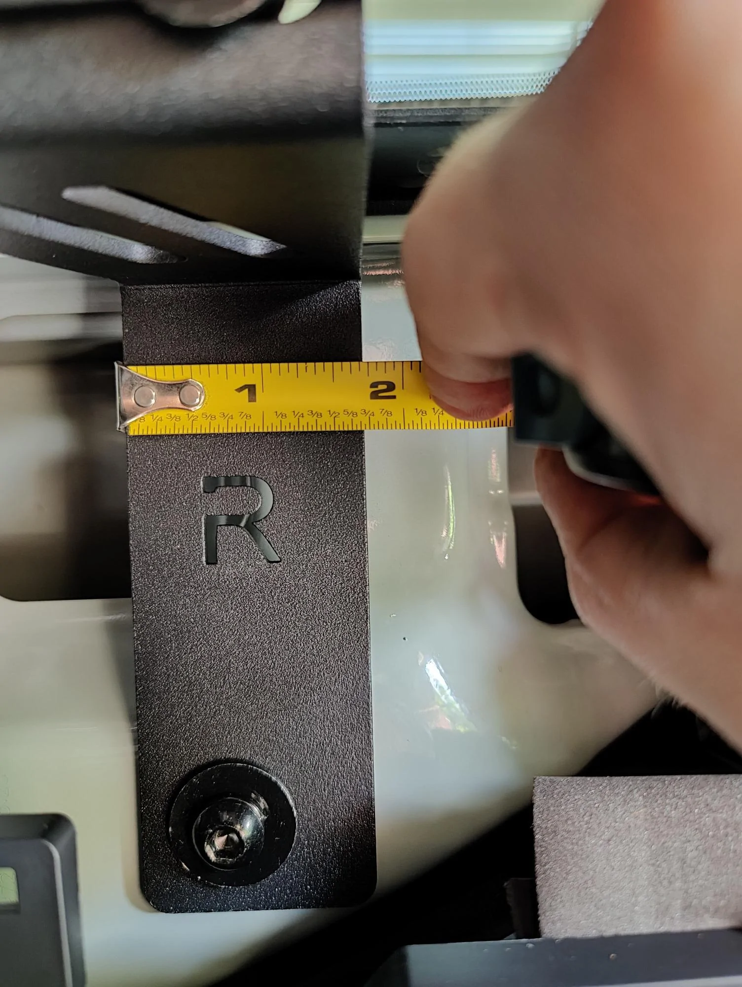

@Turn Offroad, I followed along with your Youtube install instructions but it differed a little for me. The instructions and hardware you send must be for soft tops only. I used the supplied two larger allen bolts for the bottom bracket without realizing I was short so had to rummage through my spares to find another set of bolts for the rollbar mounts. The bolts I had that threaded into my rollbar were M8x1.25. Maybe you could note this on your product page or supply the two 13mm bolts for those with hard tops?
I went to orient the bottom brackets and thought I was high. I could not rotate my brackets in any way to match what I was seeing in your video. Realized you must have revised the brackets after the fact.
Ford Bronco Looking for molle panels for rear windows IMG_20230909_141446-2

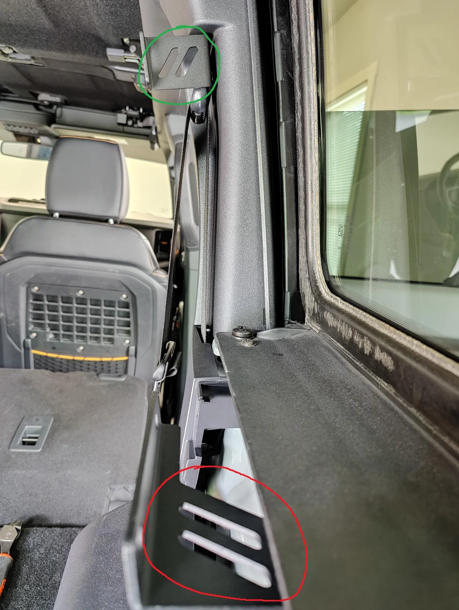

Minor nitpick is that not all four pieces with the slash cuts can be installed with a consistent pattern. If only the right bottom bracket slashes were turned the other way... Also cutting the locking washer from the seatbelt bolts wasn't necessary. I have a '22 and the washers spun right off easily so maybe Ford is using a different washer already?
Ford Bronco Looking for molle panels for rear windows IMG_20230909_145425-3
Ford Bronco Looking for molle panels for rear windows IMG_20230909_145346-3
I did the install without removing the top so I appreciate that. It wasn't too tedious. Reaching my arm and wrench between the rollbar and window was easier than trying to figure out the bracket orientation from your video! Anyways, good and sturdy product that I'm excited to start using. Thank you!

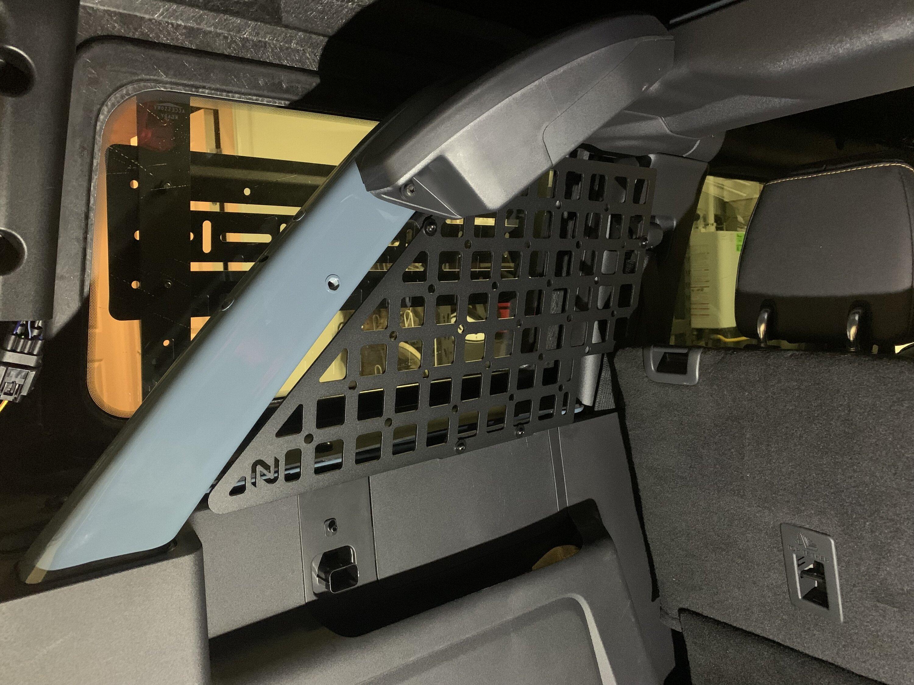

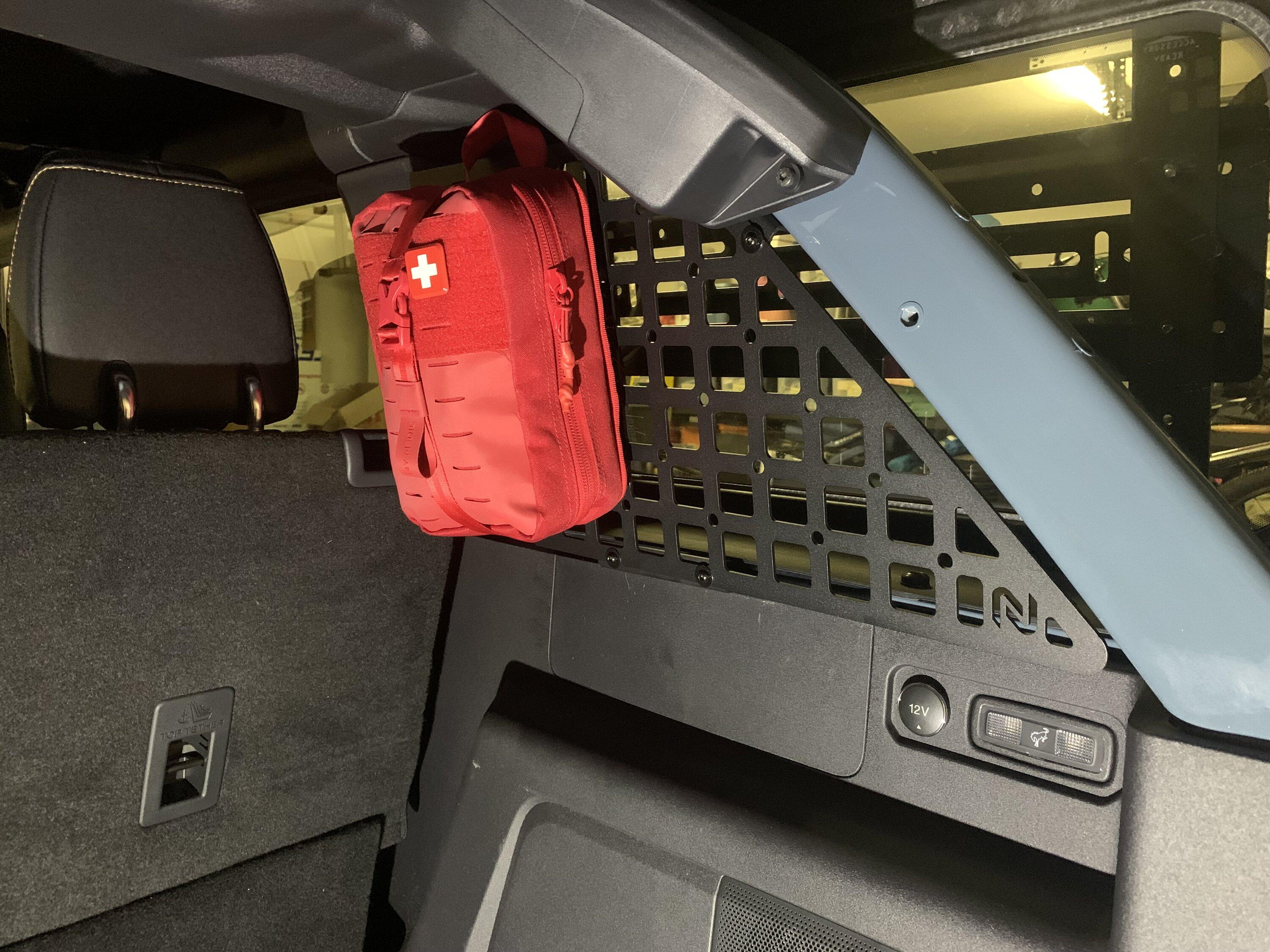

All in all, very happy with how they turned out. Now I just need to figure out how to organize all my gear on them!
Ford Bronco Looking for molle panels for rear windows IMG_8623
Ford Bronco Looking for molle panels for rear windows IMG_8622
